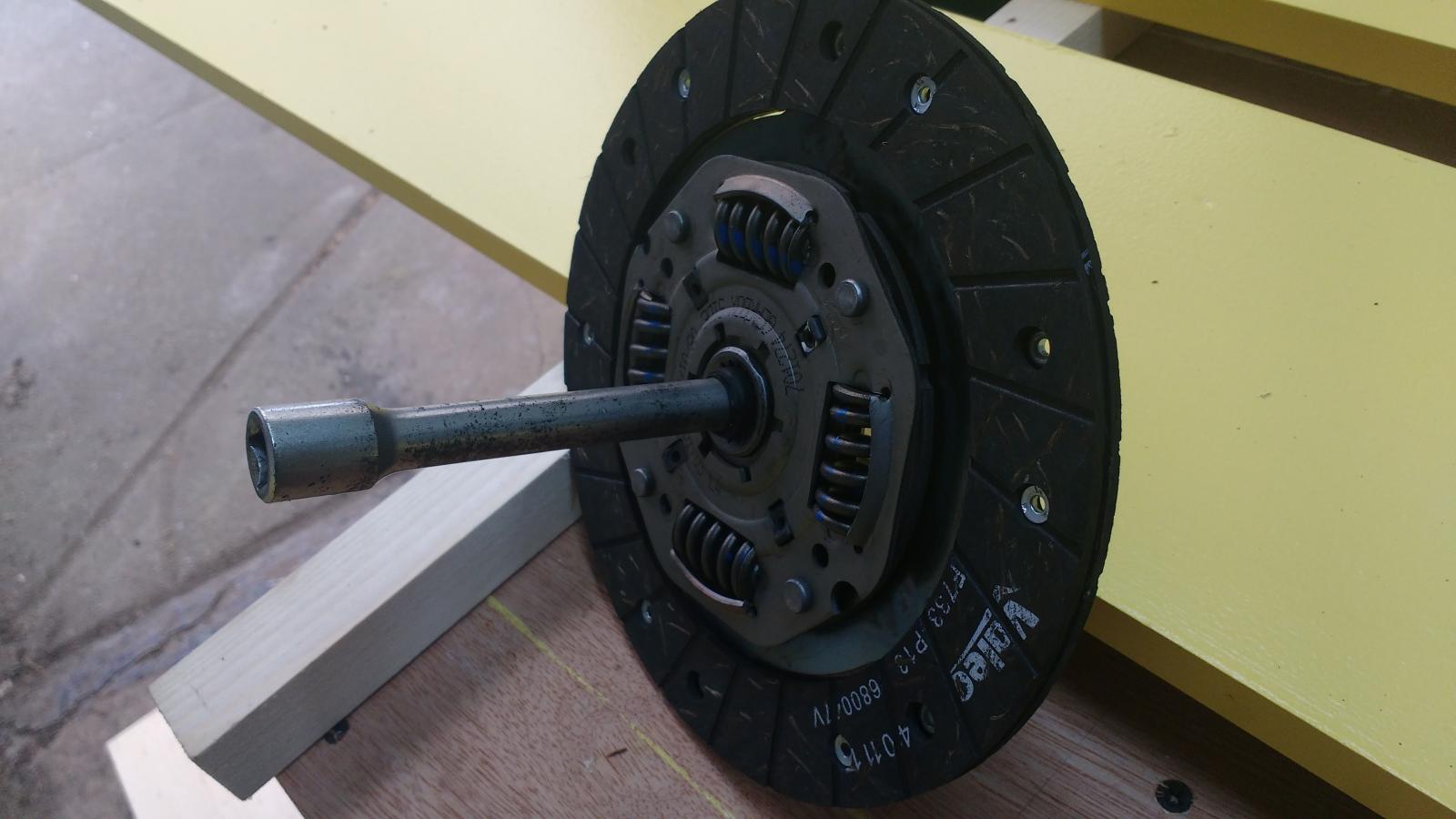

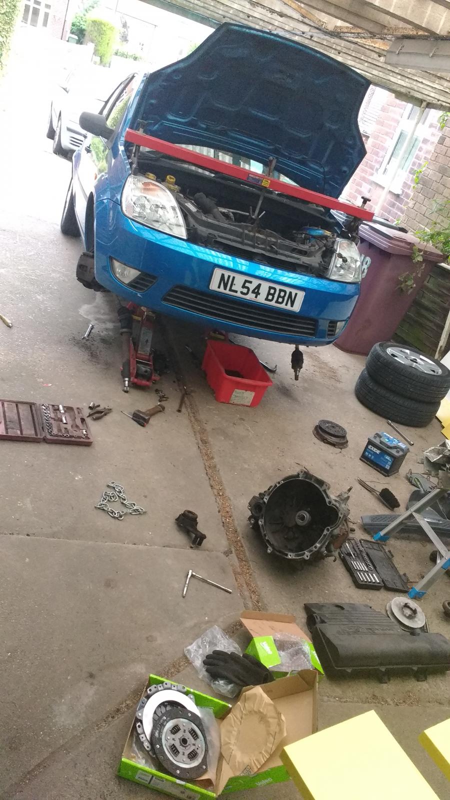

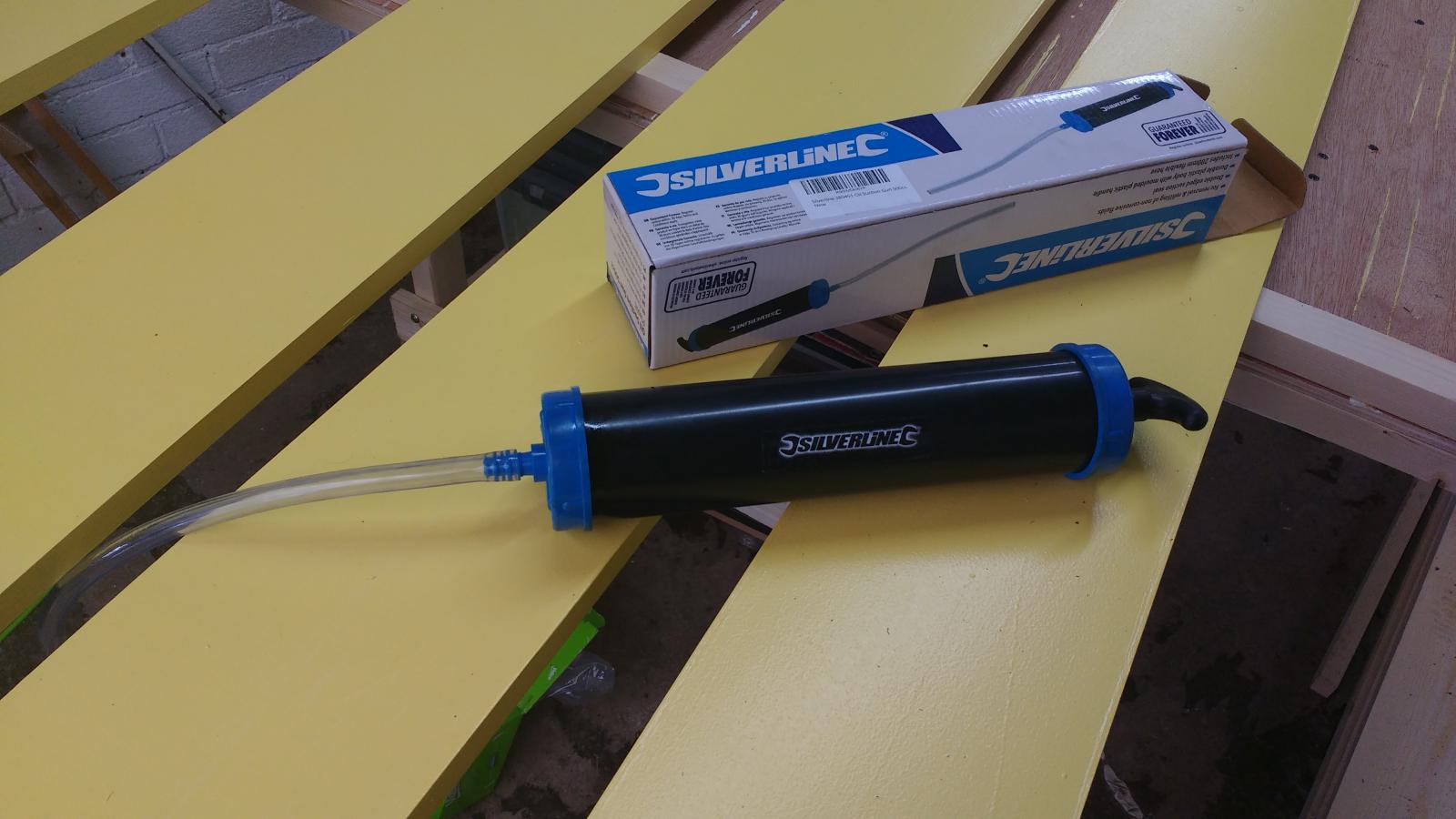

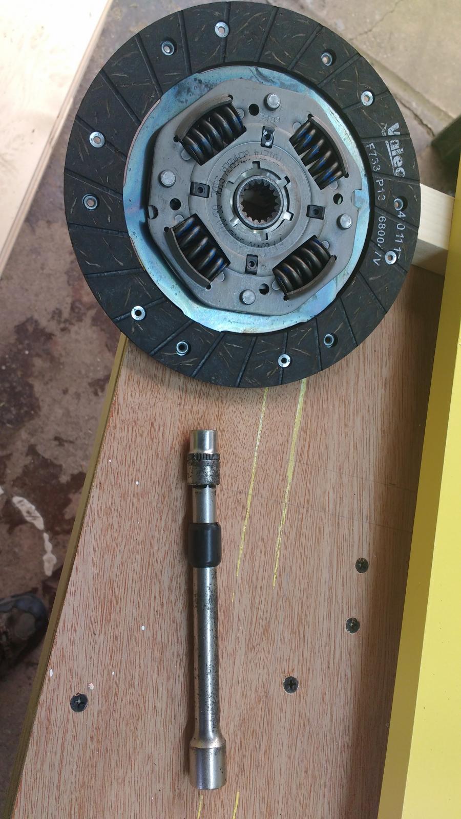

Well this thing is back in the game thankfully. Bought two new suspension pinch bolts from the local spark plug shop, one stripped its thread with like 2lb/ft on it and had to be chopped off again! Wanker. Also used my new oil syringe which was a bloody marvel for refilling the gearbox. Overall fairly painless, I just wish I was a bit more RIPPED for lifting the gearbox back into place, but I did get it back in with not too much profanity. Used an 'alignment tool' made from a 3/8 extension and insulation tape which did the biz thankfully.
Now the clutch is MEGA light, it's quite disconcerting! Mrs Nuts kangarooed off down the road on her first drive. Still, she's well happy that the car is fixed for £100 or whatever. Win!
Clutch Alignment tool for winnaz.
You could get a job down on the farm with a syringe that big.
