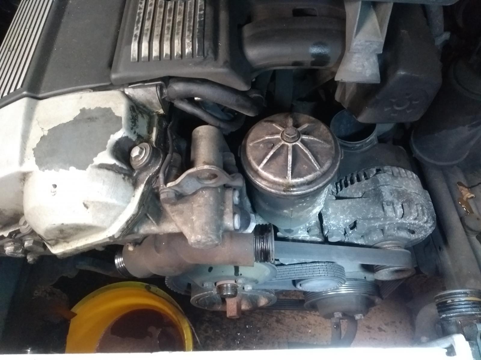

I think the thermostat is stuck open though. It gets up to temperature at lower speeds, but at NSL it stays quite cold.

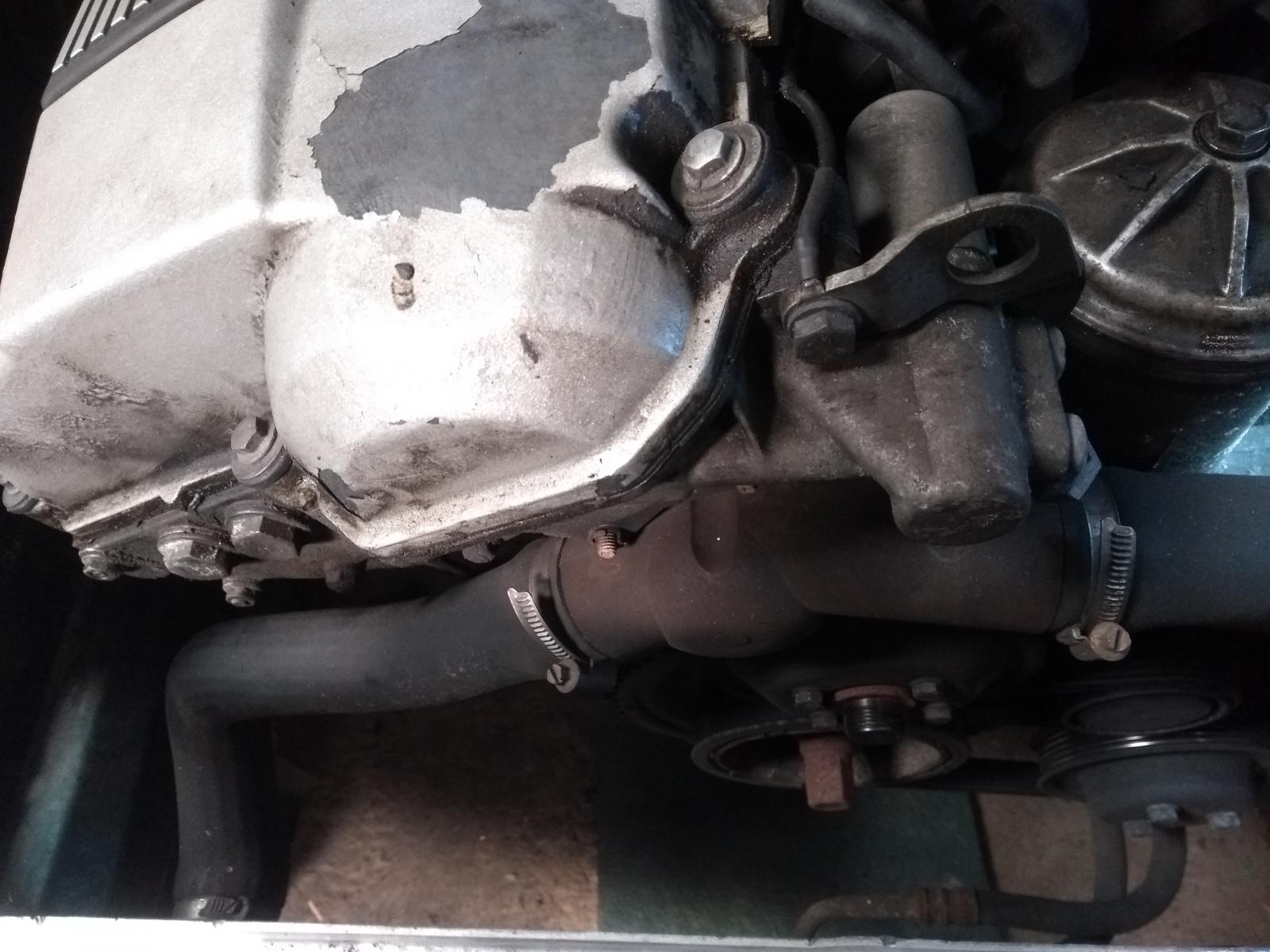

Decided to have a quick look at thermostats on GSF. They list three, with different opening temperatures! 80 Celsius, 88 Celsius, and 92 Celsius! Gah!
Fuck it, my local ECP has one in stock with an opening temp of 82 Celsius, with a new gasket included. They also have a discount code active at the moment that brings it down to £6. I'll collect that on my way home later!

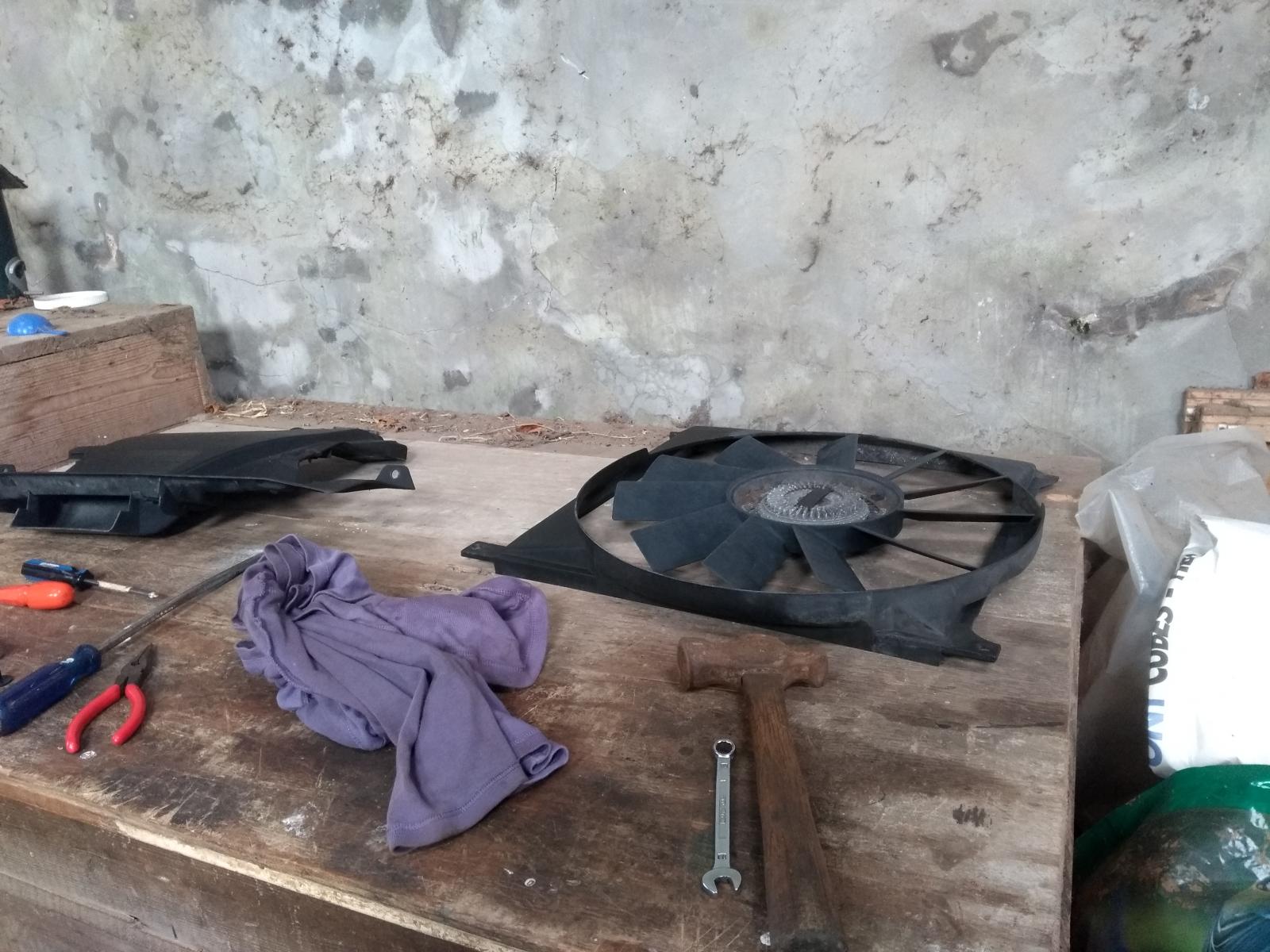

Today I replaced: the oil, the oil filter, the air filter, the thermostat, the coolant, the auxiliary belt the front discs and pads, and the radio.
It's properly sorted now. I then took it to a car meet and lowered the tone. Found some prime shite though!
It feels like a different car to how it was when I got it. It's quiet, wind-tight, drives in a straight line, holds its temperature properly, and brakes without juddering all over the place. :D
Oh yes, cross-use of tools occurred. I used a bicycle headset spanner to remove the fan from the front of the engine.
Excellent work- especially not damaging the thermostat housing:)

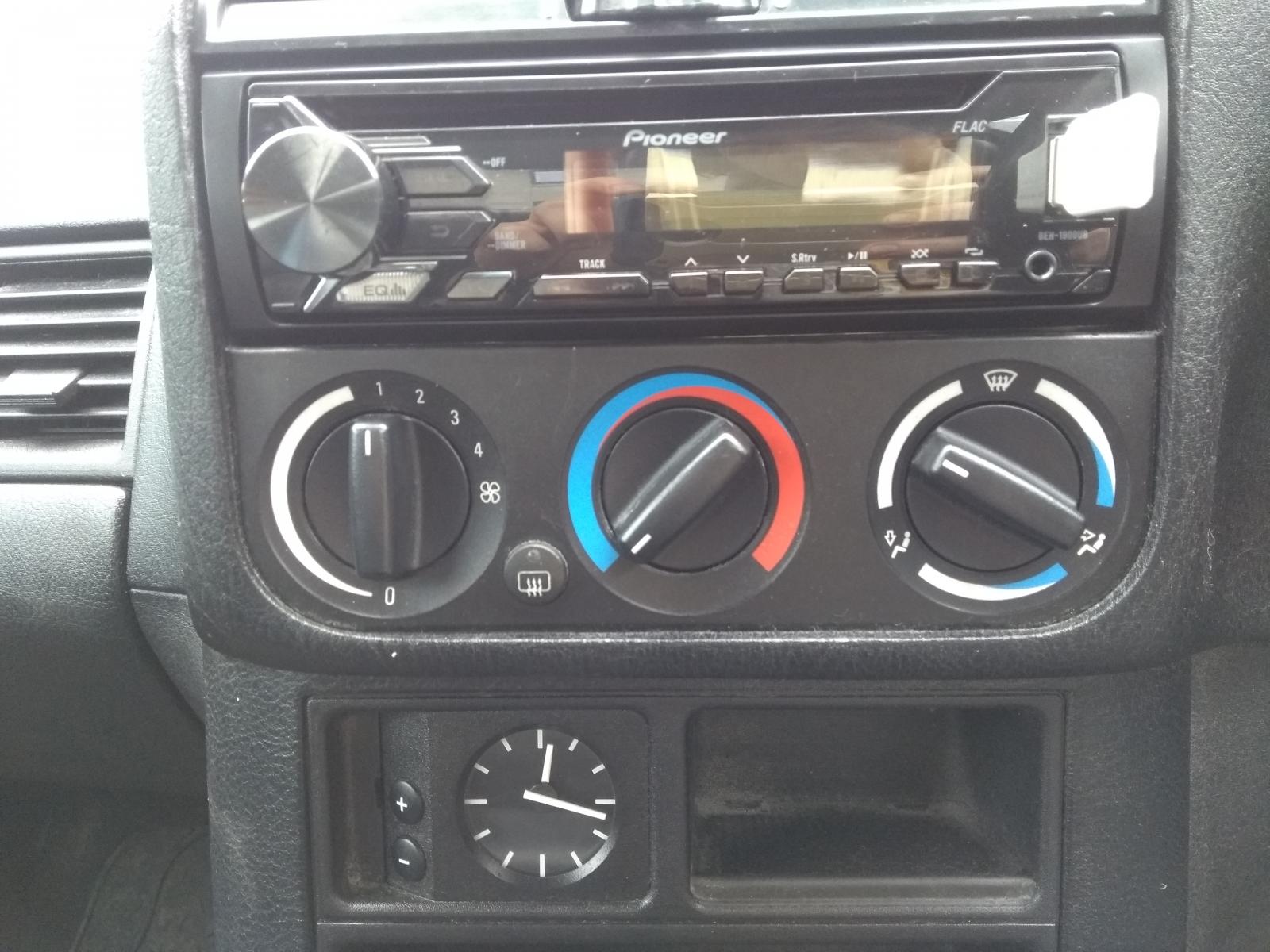

Today I also noticed an interesting quirk with the heating and ventilation in this car. Observe the below photo.
In this photo, it is set to fan speed one, ambient temperature, and it is directing the air through the face vents.
Yep, the dial on the right does the exact opposite of what it's pointing at. The dial itself comes off easily enough, but will only attach that way round, it won't go back on the 'correct' way round. Ah well. At least I know what it's doing now.
