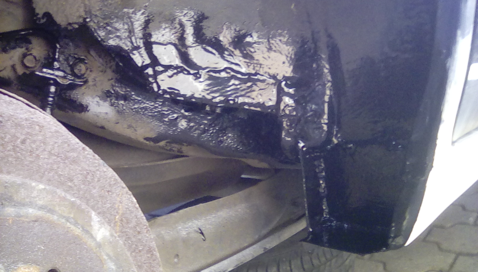

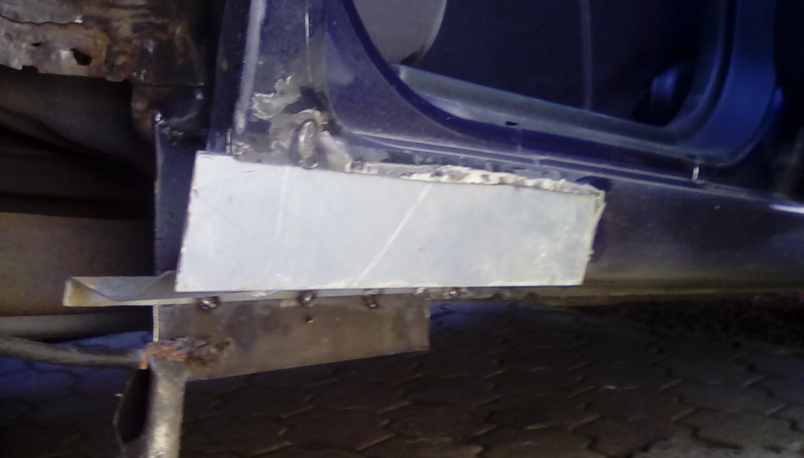

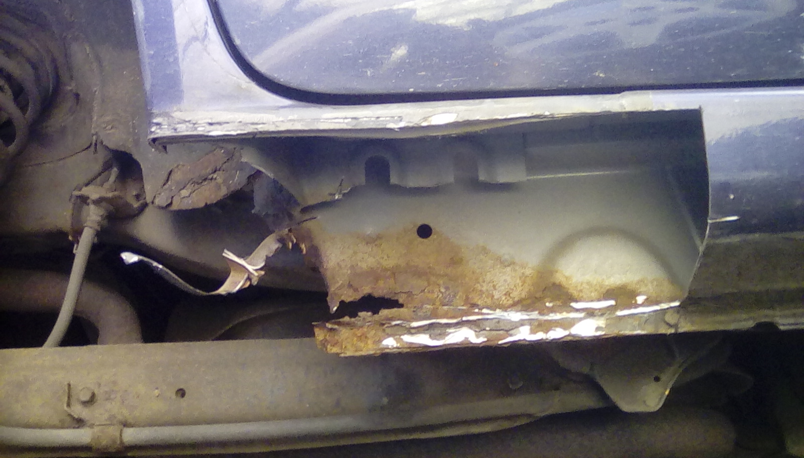

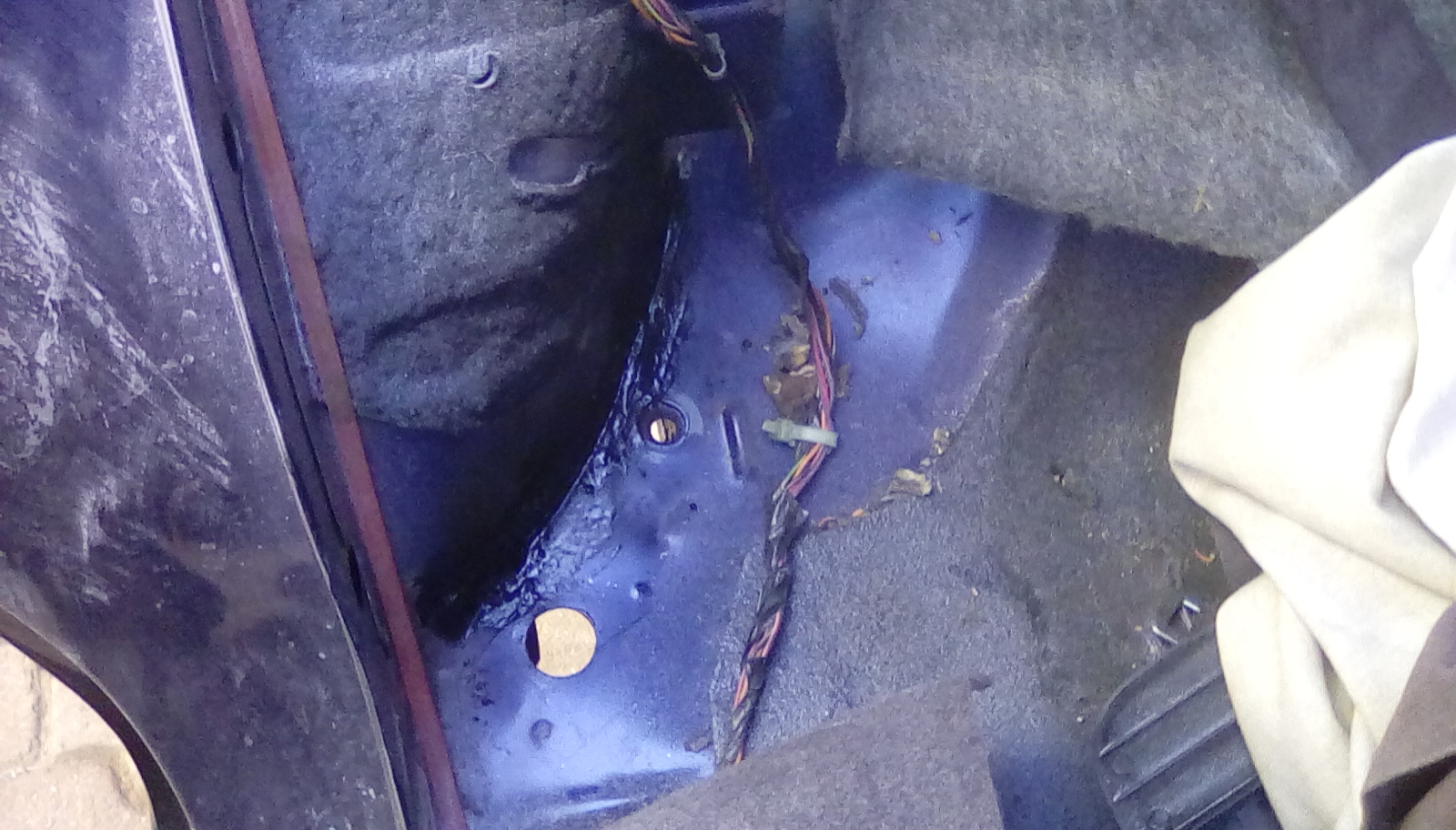

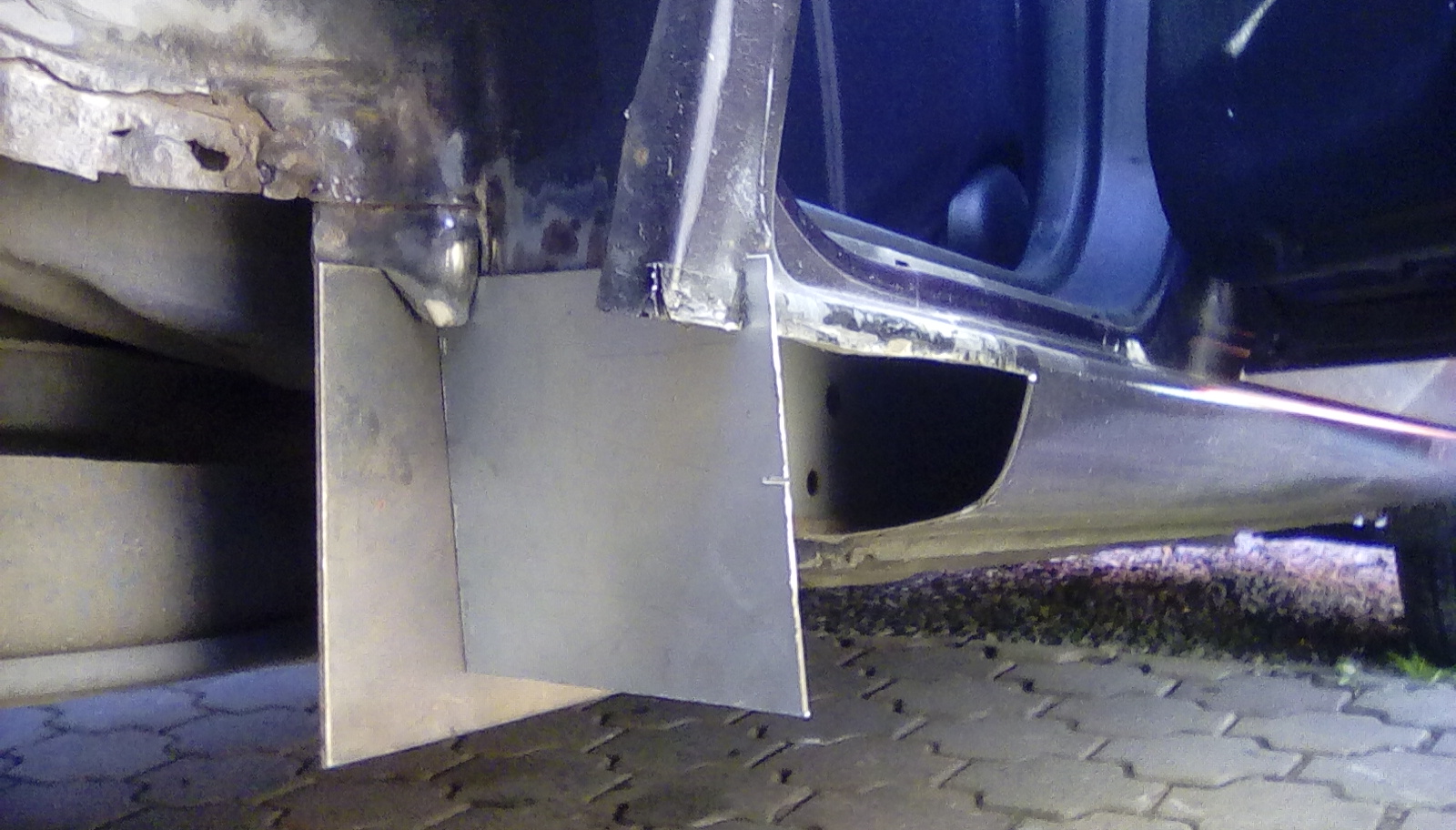

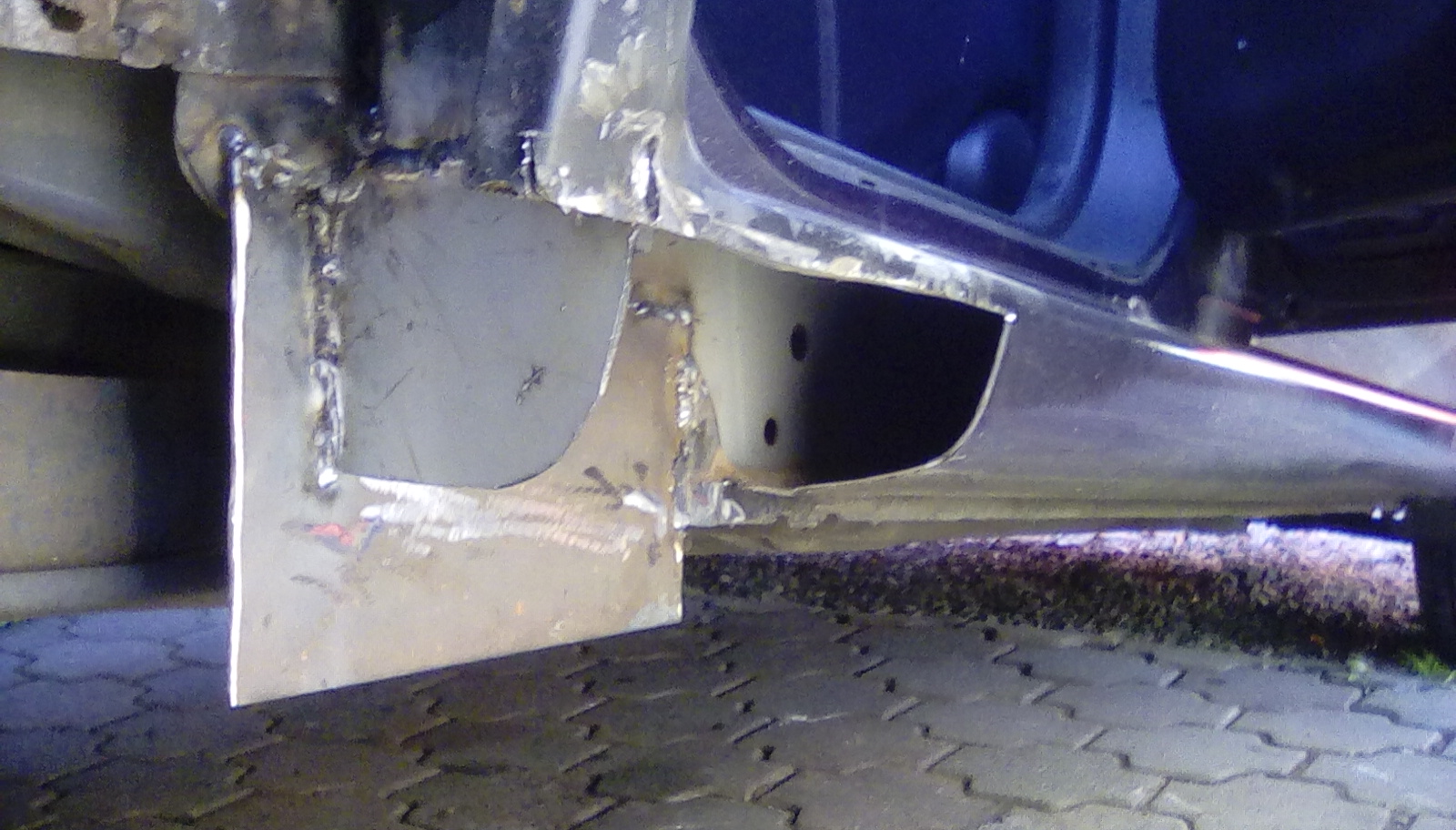

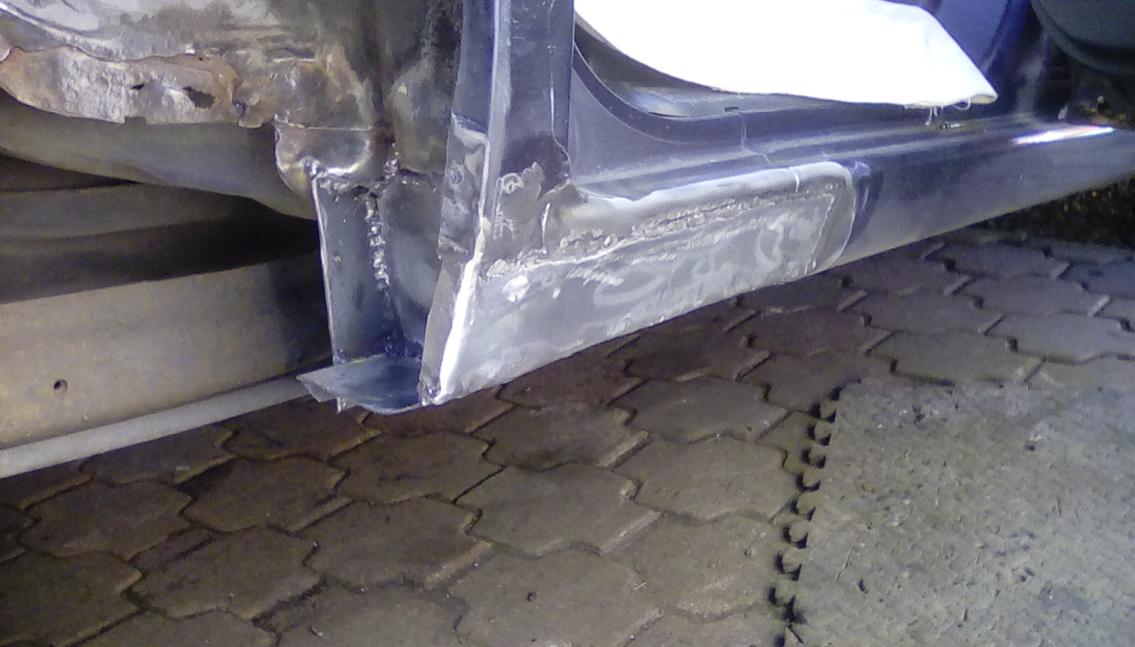

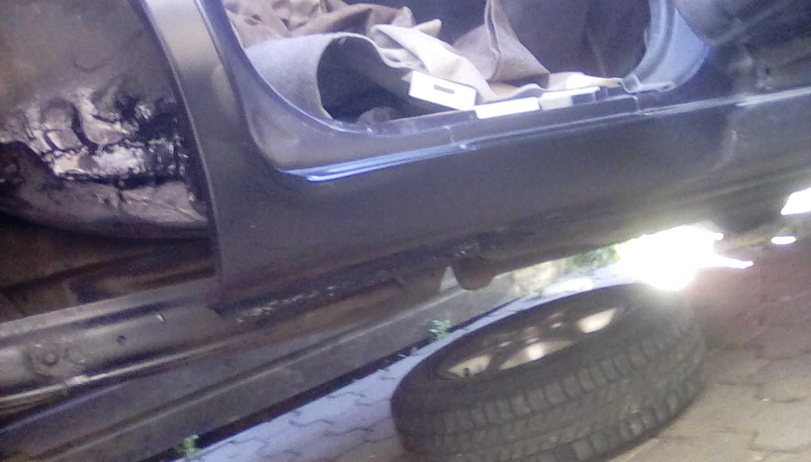

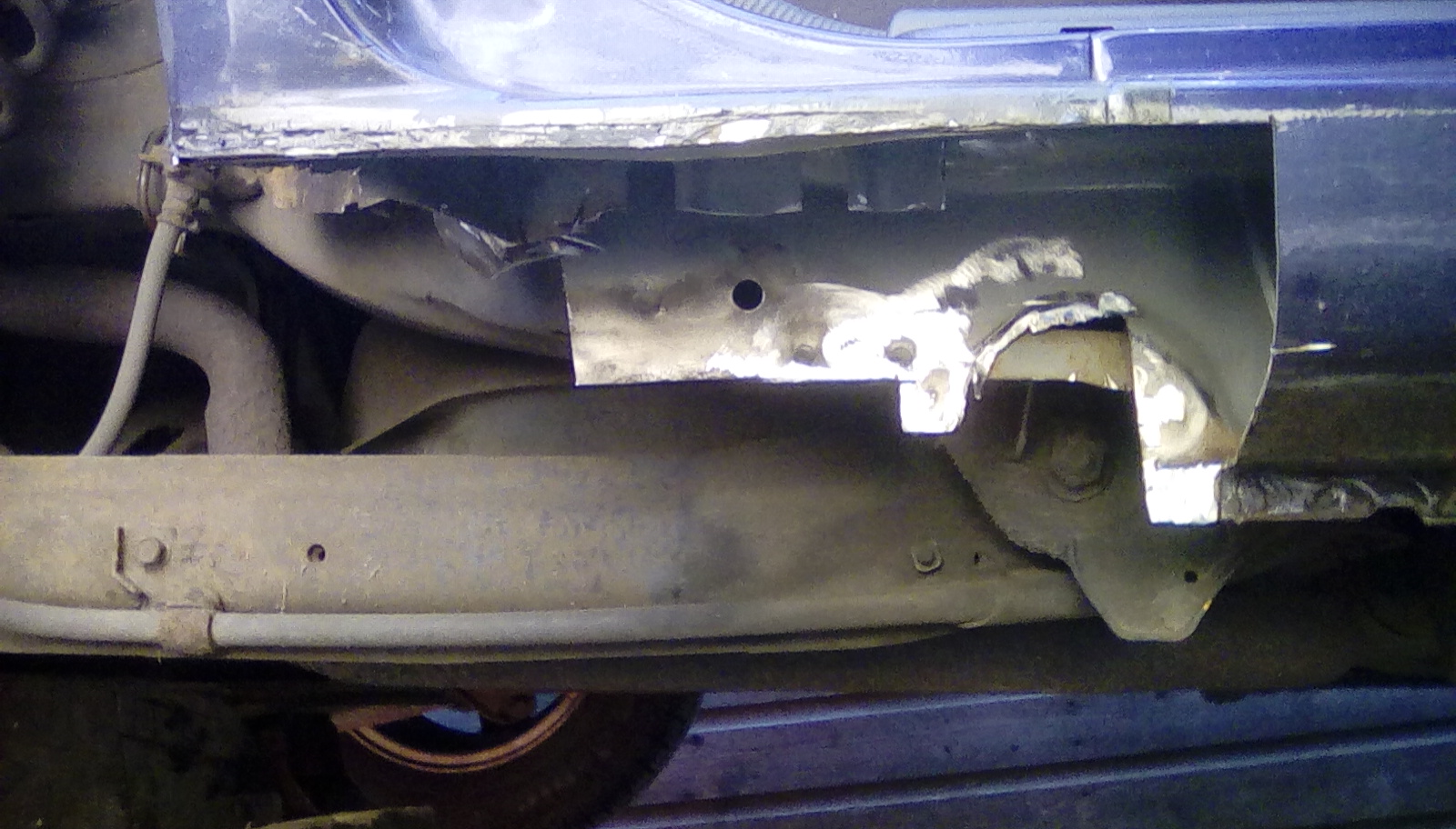

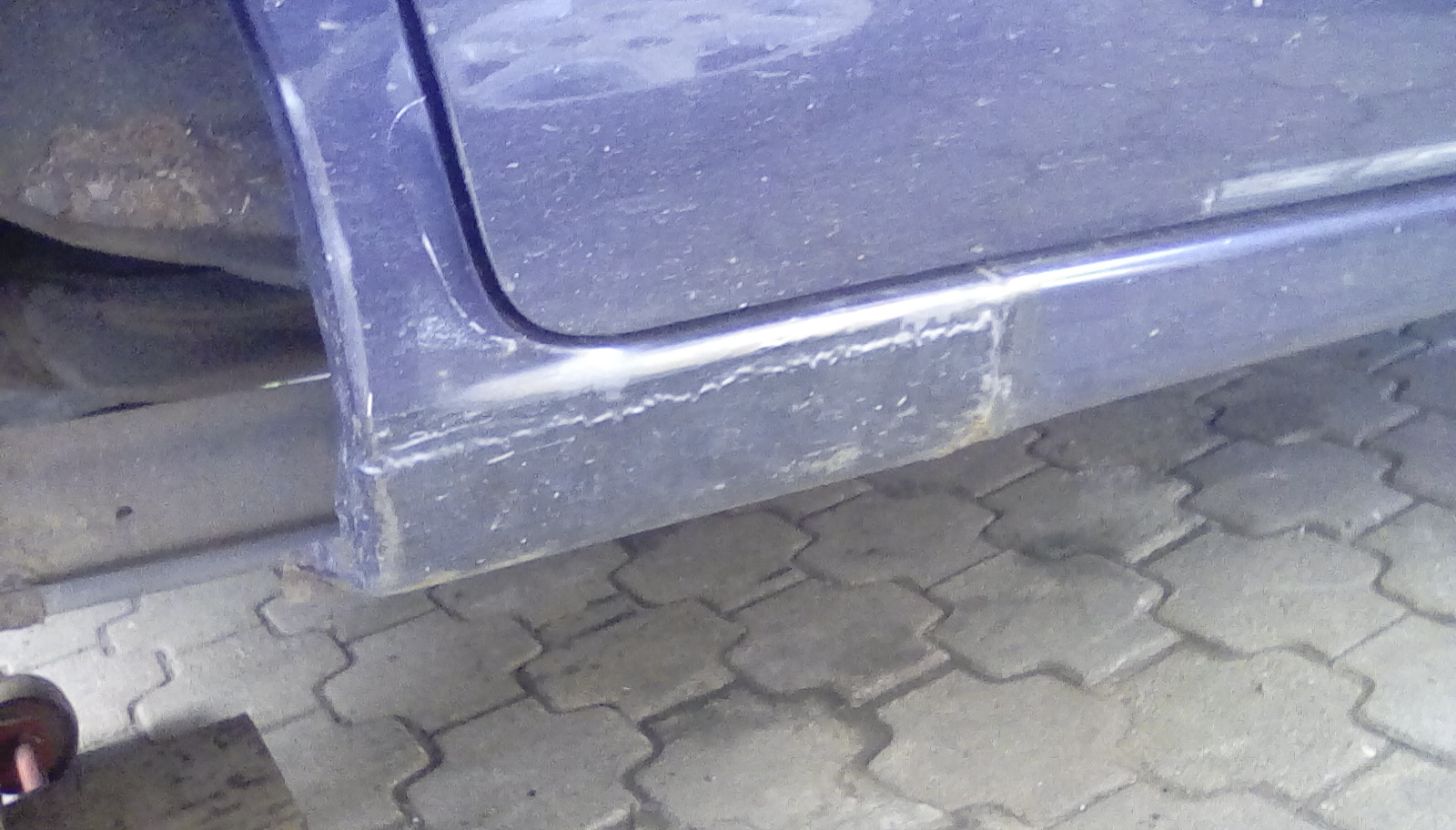

D Spares & Tyres Posted September 26, 2018 Author Posted September 26, 2018 Had a look at the other side. It seemed slightly better initiallyBut after I had attacked it with a grinder it turned out to be worse...Another Y tho. But I killed himNow where do I start the rebuild? One step at a time. Have used much thicker metal than it left the factory with. Easier to weld and stronger.Had to remove the back seat and some trim in case it caught fire for this bit!Looks a bit better nowTomorrow's job, small plate on the front inner wing then wax the whole underside and box sections! ProgRocker, The Moog, mrbenn and 3 others 6

sierraman Posted September 26, 2018 Posted September 26, 2018 Very tidy work there. Well worthwhile for piece of mind.
D Spares & Tyres Posted September 26, 2018 Author Posted September 26, 2018 Very tidy work there. Well worthwhile for piece of mind.After all the hassle involved in replacing the green one I want this one to last as long as possible. These are such good cars though, I think that once the rot is sorted, this thread will be over.
