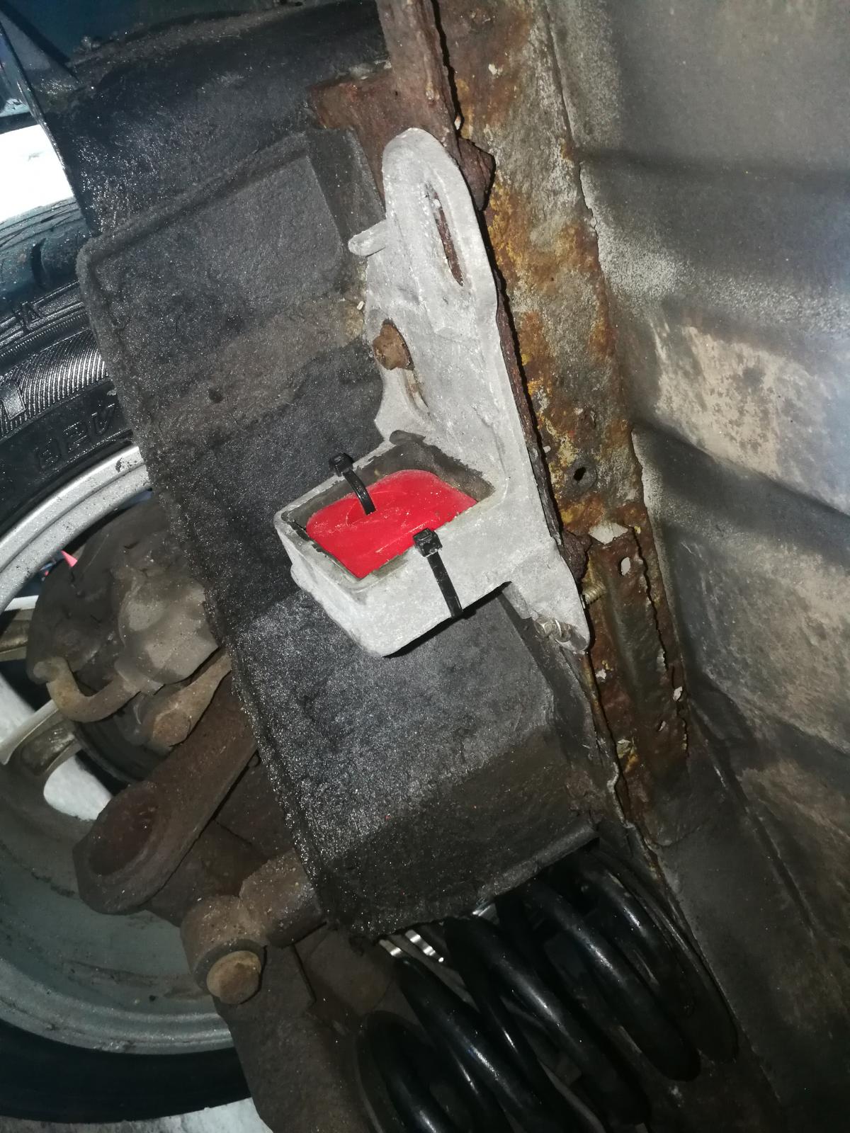

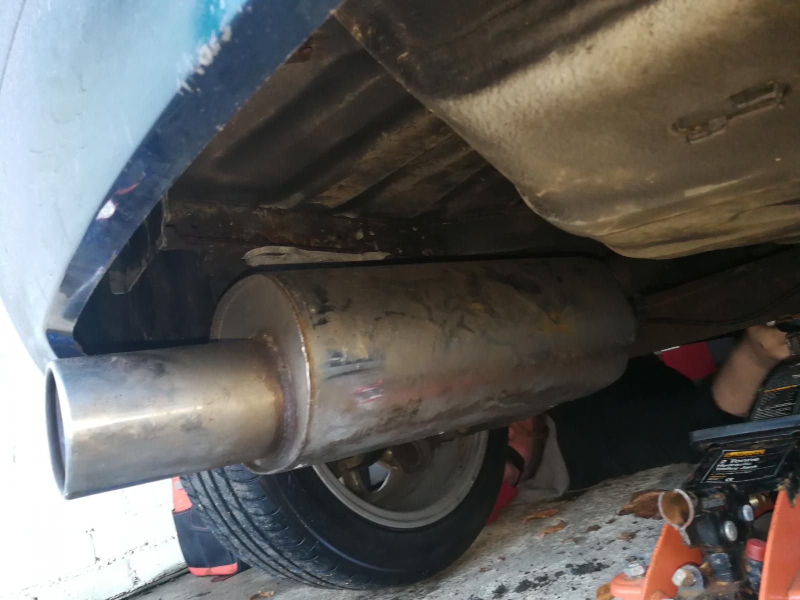

Having dropped it's backbox on the way home from getting the drivers driveshaft replaced, it's only had an exhaust to the rear axle.
I'd scooshed the mount bolts and the nuts on the c clamp for the sleeve join with Remonstrating fluid earlier in the week and had high hopes..
This was the sight that greeted me - it'd obvious had at least 1 replacement mount before as it was fixed with a mix of 13mm and 8mm headed bolts.
All the bolts came out cleanly, and a new ' uprated' mount was fitted. The stock rubber aftermarket ones fail far too easily, so polyurethane was the way to go!
Happily, the c clamp nuts loosened off fine, and the backbox mated right up. 10mins start to finish.
Good to see that fixed.
But that rusty rail it attaches to is what I hate about cars. How do manufacturers get away with it?

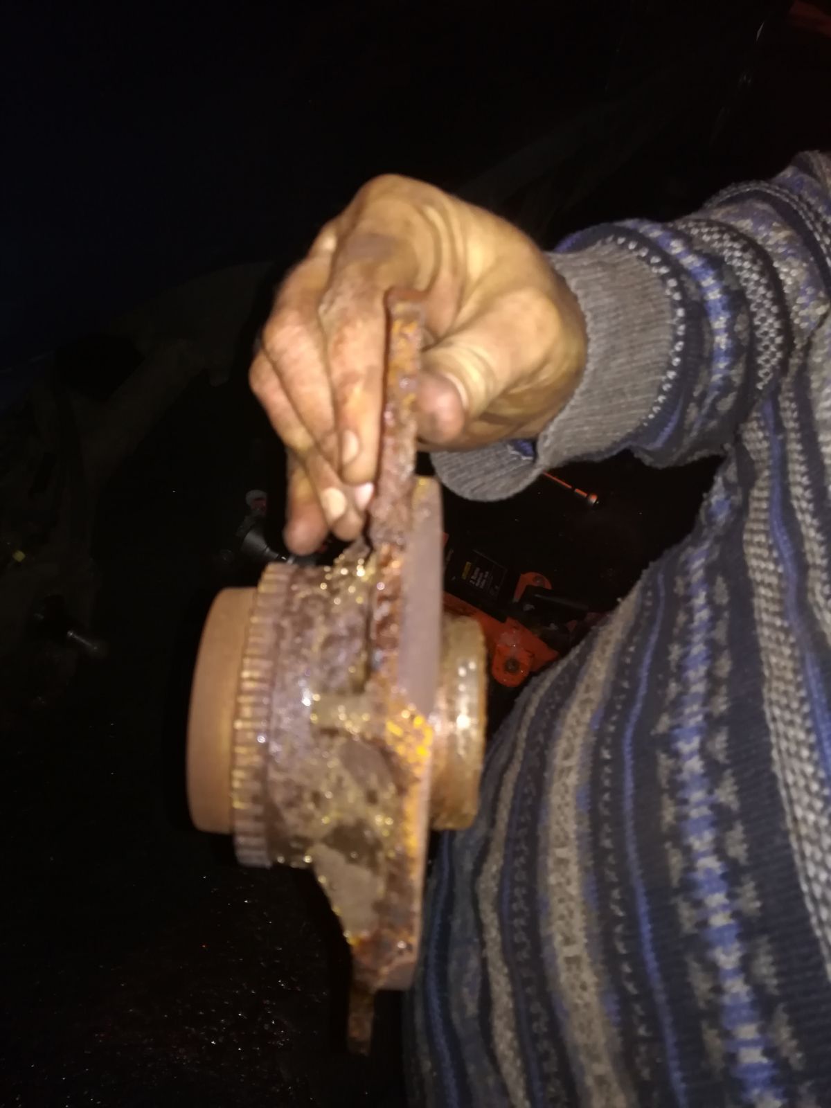

Mrs said, " a big bang then the car stopped"
That's the only working* car out of commission now.
Well, fuck. Ive never seen a disk do that before. Scary. As long as the Mrs is ok though, Ill bet she got a fright!
Jesus Christ!! atleast it a cheap and easy fix, as above never seen anything like that either, that's crazy!!
The fun thing is the RAC man's computer says he can't rear tow a Clio..
We're awaiting a truck soon - flatbedtastic
It has been towed home.
I shall order some disks and pads as soon as s I can face it
Of all the - bang and then stops - I suppose it's among the easiest of fixes (trying to be positive here)
I've seen some (and been responsible for) fucked discs...... but never had one do that whilst in use.
The noise must've been phenomenal!

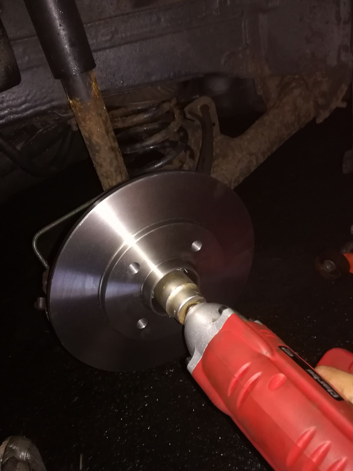

The aim was simple this evening - get some semblance of an actual disc on the driver rear of the Clio.
First thing to do was hit up the hubnut with the 30mm socket on the buzzgun.
We got it in the air and got the wheel off.
The disc pulled off easily, and the disc spacer stayed put:)
Time to inspect the damage - looks like quite the failure!
We took the seal off the piston and cleaned it up. Luckily the sliders were working freely.
Then it was wound back in, and the new disc was fitted.
The new pads were fitted and we tested it. It seems to be releasing ok, bit I'm going to check it over in the daylight tomorrow before taking it out for a drive.
