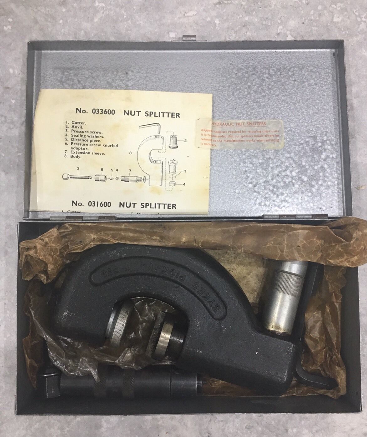

What exactly is the grease doing? A pic of the implement would help.
I'd respectfully suggest maybe the old stuff was like cheese because it was very old and dried out, rather than being a specially high viscosity originally.  Well perhaps anyway.
stole a pic off google....
bolt works like a plunger to push down a snug fitting metal rod with a nylon bush at one end ...with grease between bolt and plunger to crack the bolts

can get own pics in morning
