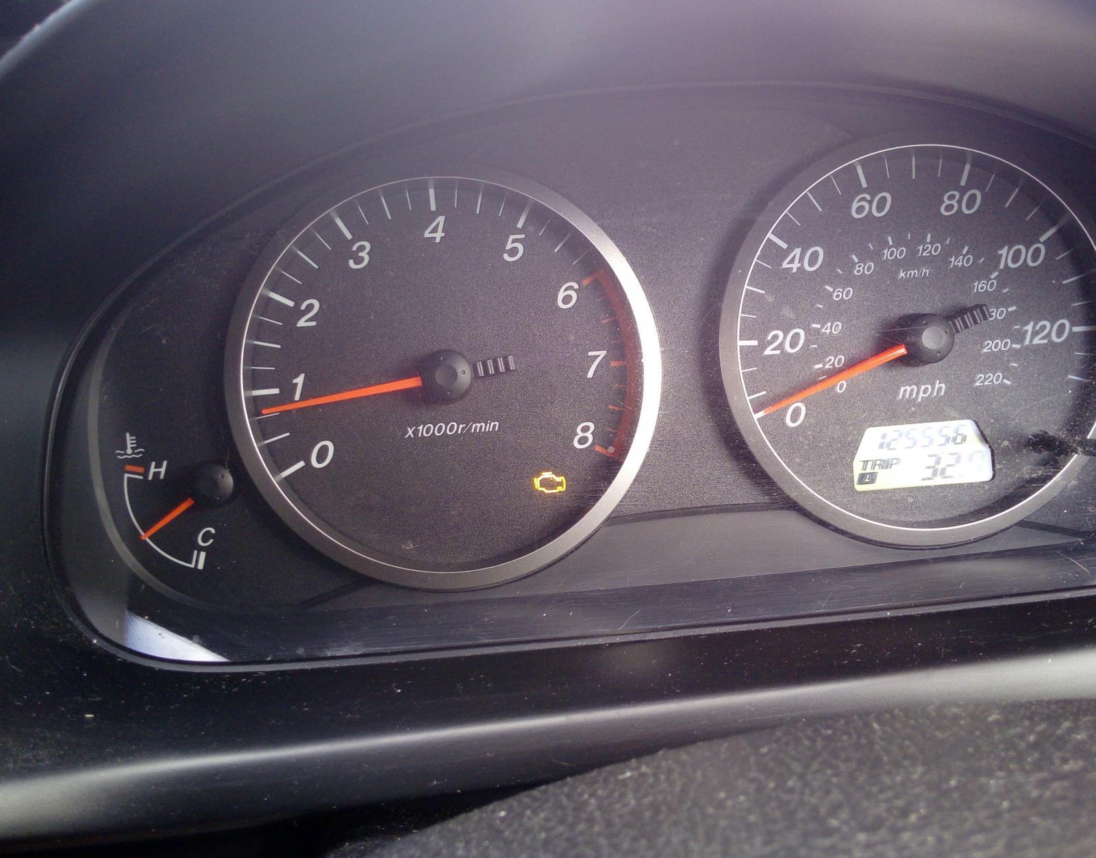

I collected this on Saturday and as detailed in the other thread it drives well and is ideal for my step-mum to replace her written off polo. I do have a couple of problems/questions though from the more knowledgeable amongst you.
The yellow engine light came on after a few miles so I pulled over and lifted the bonnet. I stated at it for a few minutes not really knowing what to look for. The engine was ticking over fine so I proceeded on my way, about another 250 miles, without drama.
My step-mum took it to her garage today. They've told her it needs a new cat and they will complete this work for £470! A bit disappointing as more than the car cost. My usual garage will do it for £300 which is better. I could save a few more quid by buying the cat off eBay for £100 and they will fit for £115. The other option is to try and fit it myself but that doesn't always end well and I am a bit time limited.
I'm just wondering if it's worth getting a code reader to make sure it's the cat as I wondered if it could be the oxygen sender? I could also try disconnecting the battery to clear the code and see if it comes back on. Any advice appreciated.

Code reader is peanuts so probably worth getting one anyway. Then team it with Torque App to read it all.
I assume the garage will have read the code to come up with that conclusion.

90% this will throw up a P0420 code about 02 imbalance. It basically means the cat is performing outside it's parameters according to the difference between the two figures it receives from the pre and post cat O2 sensors. Doesn't necessarily mean the cat has failed, just performing outside its 'accepted' parameters. I'd chuck a Cataclean in and give it some real cosh for a good half an hour. Then knock the lamp out. It might come back on again but I'd ignore it. Mine does this from time to time and it hasn't failed the emissions.
The oil might just have settled. I'd monitor it, if it's smoking or using a quantity of oil could be the rings, which in turn would cause emissions to be out.

Re the eml, as others have said, I'd get a scanner and check the codes first. Car certainly ran OK when I had it - almost sounds like a lamda sensor not reading right or something like sierraman said?

I'll start by saying that this is just an old car issue and could be nothing as the light has now gone out! I'm going to get the fault codes read myself and see what's going on. I'm going to suggest that she doesn't rush to get the cat changed at the moment as it's running fine. Also, the mot isn't due until April 2018. A slightly non functioning cat can't damage anything can it? Will try the cataclean stuff too.

And a if it's a p0420 code then it's 100% the cat . The fact that it's pinged that particular code itself means the sensors must be working ok

If it runs OK, drives fine and fuel consumption isn't excessive.. just leave it as it is until any other symptoms pop up. It's easier to make things worse especially with cheap Ebay sensors and exhausts. If it had been parked up for a bit it might have been running a bit rich and thrown the lambda readings out temporarily. If it does come on again..by all means then chuck some cataclean down it and then give it an Italian tune up!

Light itself isn't an mot fail . If cat is really poorly then it will fail mot but the cars inbuilt emissions limits are much tighter than the mot so it will most likely be fine come test time

Any of any quality should read and clear the P0420 code if that's it. The light won't fail but it'll be an advisory usually. If it bothers you just turn the lamp off prior to testing it, then go and get it nice and warm for the MOT.
If your step-mum is only doing short journeys, it may not get ran long enough for the light to come back on. Most need to be upto temperature, over X rpm for Y period (X & Y vary per engine) before they decide if the cat is a bit weak. Might also be a bit weak if not gone on long runs enough and the blast down the motorway has got it toasty and burnt off old crud.
If the fuel economy is alright, I'd only worry about it again when it's MOT time.

A genuine Cat will turn the light out for good, providing there's nothing underlying.
A £100 Cat will only last a couple of years tops and as mentioned, they often aren't all that good so can still bring the "P0420 catalyst efficiency" code up now and again even if they do function just well enough to pass the MOT.
Try some Cataclean and just buy a cheapo code reader to reset the light and keep an eye on things - You might find there's another issue that's buggered the cat up like a misfire or something, but if it's just sticking up a P0420 then your o2 sensors are working OK at least.
If it does fail the MOT down the line, you can put a cheapo cat on then and hopefully it'll do a few MOTs before it needs replacing again, rather than half wearing it out before it's first test.
Running it with the light on won't cause any issues other than slightly increased emissions.
