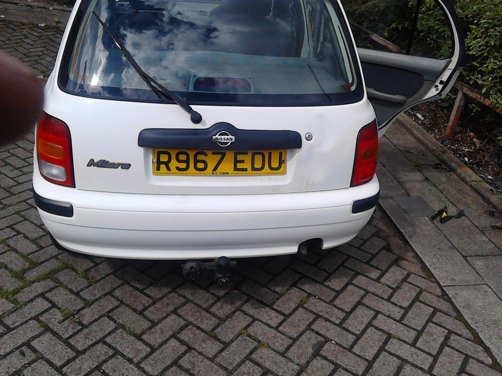

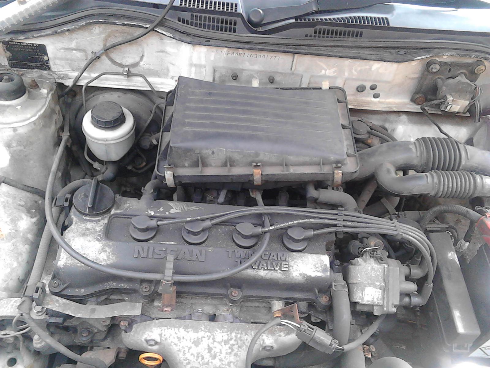

has a towbar,made in sunderland,noisy waterpump,but drives as they all do, :-D poverty spec,no radio,fag lighter,windup windows,drivers windows goes down than tilts,has pws,and only done 132000 miles,,
two winnerz vintage k11,pictures tomorrow,pissed it down,its the usual white....

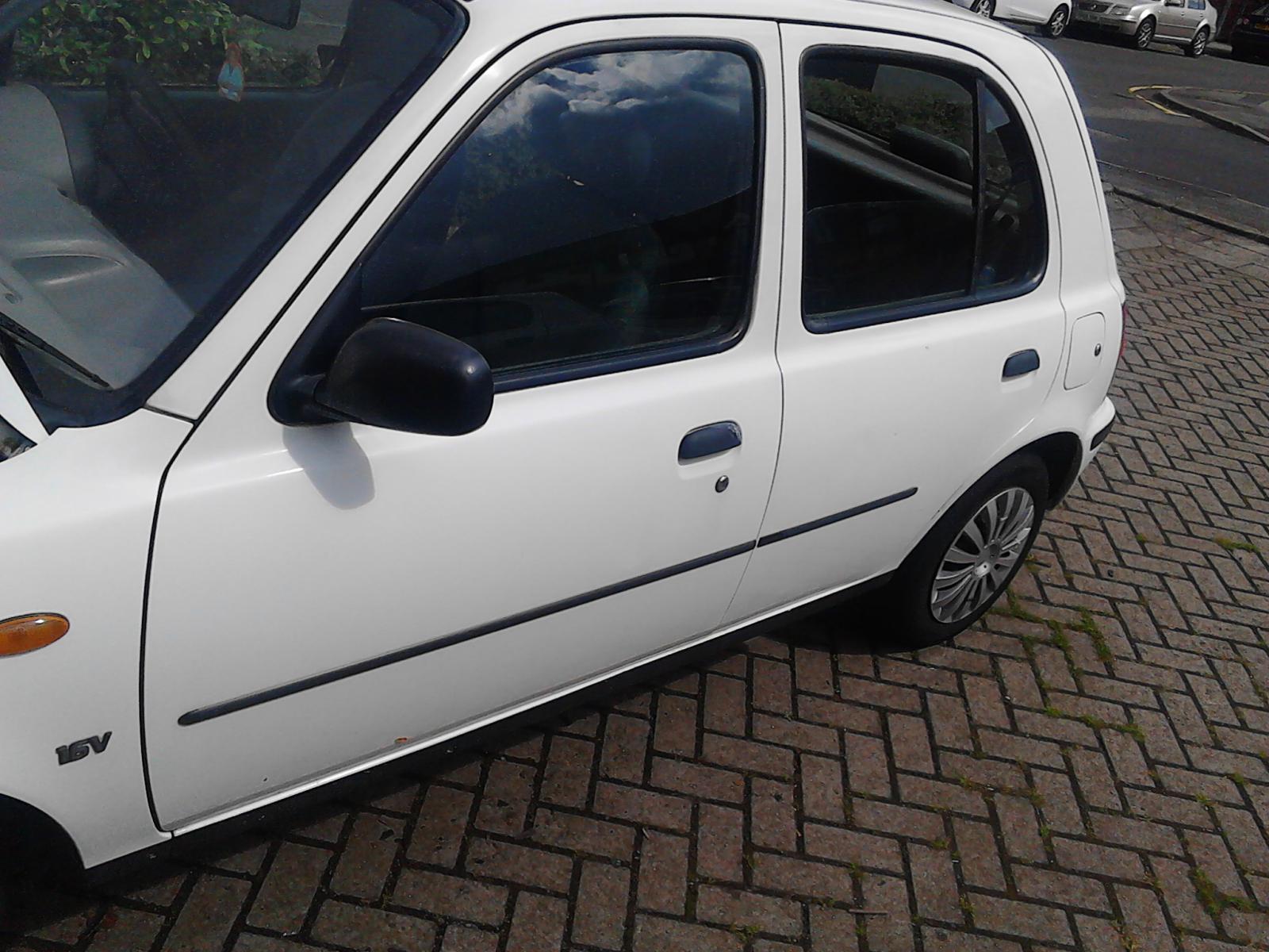

front crossmember ok,has had usual on rear sills,have found a hole under rear passenger floor, drivers side,will dig out my no gas mig welder sunday,if it stays dry,,,

new picturespost-19591-0-23257600-1501865720_thumb.jpgpost-19591-0-76997200-1501865739_thumb.jpgpost-19591-0-22423400-1501865756_thumb.jpgpost-19591-0-96282000-1501865775_thumb.jpgright got the no gas mig welder out,lidls finest,undone battery,no frazzled ecu,lifted up rear seat,found a pound,moved carpet,undone seatbelt,got my 4.99 sheet of metal,cut two pieces up mig welded in place,than for extra strengft welded underneath to new plates above,sprayed with baurfix red primer,than a lovely baufix hammered finish blue,no seam sealer yet amazon failed to deliver,..
