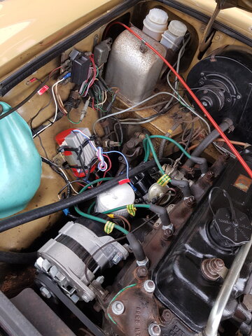

SiC Posted May 5, 2019 Author Posted May 5, 2019 Went up to try getting the MGB running this afternoon. Fusebox gave some grief. Realised that one position isn't actually wired in (one set of side lights), so I guess others have had trouble before here. One circuit actually stopped working after disturbing the box the other day. The one that did the always live, which caused some confusion when the interior lights didn't after connecting the battery. Anyway here is me waffling on attempting to start it. mrbenn, LightBulbFun, GrumpiusMaximus and 2 others 5

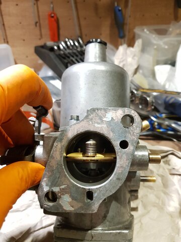

SiC Posted May 5, 2019 Author Posted May 5, 2019 Couldn't help myself not to get this started this evening. Weather is reasonable and it's not too cold. Cba to clean it tonight as not too much light. Easier to spanner by torch than clean by street light. Carbs off. I left the linkages attached. Doing this I'm hoping it will mean minimal fiddling required once back all together. Carbs in bucket. Carbs on bench. Offending poppet valve. Carbs are a bit moist inside. I think I might have been running a bit rich earlier. Probably running rich generally as the air leaking through the poppet valve meant that it would have to be set a bit richer maybe. Time to get these flaps in. purplebargeken, Skizzer, Dick Cheeseburger and 6 others 9

SiC Posted May 5, 2019 Author Posted May 5, 2019 Throttle discs now on. Buggered putting some of the new screws in. They have a split section at the end, the idea being it makes them less likely to rattle out. Unfortunately I was over zealous splitting them and snapped the ends off. I used some of the original screws, split them and also locktite for good measure. Old poppet valve discs 2 hours ago, Dick Longbridge said: Great to see the GT liberated once again. Age is a funny thing, isn't it? When I was a youngster, there was an old fella who practically lived at the local chippy, and he drove one on a K plate, in the same shade. At the time, I thought the colour was bloody awful. Something seems to have happened now I'm older and wiser (in my forties) and I'd almost say the old thing looks pretty dapper in that period shade. Who'd have thunk it?! I'm not entirely convinced this is actually Harvest Gold! It might have been when it left the factory, but when ever it got resprayed (you can tell it has been at some point) I wonder if a slightly different colour was chosen. Either that or it has faded. I bought a Harvest Gold touch up paint pot from Moss and the colour looks a lot darker. I have painted a small offcut of fresh metal and tomorrow I'll give it a compare against the car and see how well it matches. Also bought a can of Sandglow from Halfords that I used to paint the 1100 cooling fan. I will also use that as a reference to see if that is closer. I suspect it may be neither and is somewhere in between. Hopefully it will be some sort of standard colour as it could do with a respray on some small sections like the front offside wing. Also removing that wing, for when I get around to welding the bits under it, will mean the lead shot join at the top will need repainting too. LightBulbFun, danthecapriman, Dick Cheeseburger and 3 others 6

Joey spud Posted May 6, 2019 Posted May 6, 2019 Back in the day when S.U carbs were still cutting edge tecnology it was a common modification / bodge to remove the spring etc from the poppet valve and just solder its disc securely to the butterfly flap. I did it on my old Range Rover and instantly cured its erratic idle. Also saw this honey out and about at the Strood branch of Aldi back in February. The Moog, Dick Cheeseburger, richardthestag and 2 others 4 1
SiC Posted May 6, 2019 Author Posted May 6, 2019 22 minutes ago, Joey spud said: Back in the day when S.U carbs were still cutting edge tecnology it was a common modification / bodge to solder the poppet disc to the butterfly flap. I did it on my old Range Rover and instantly cured its erratic idle. Also saw this honey out and about at the Strood branch of Aldi back in February. If that had my plate on, I'd never know the difference between that and mine! Literally identical. Looks so utterly different to modern cars it's staggering. Both style and size. I'm hoping she'll be more behaved with these new discs. I'll be happy if the idle is stable enough that it won't vary between stall and fast idle, depending on how she feels! If it wasn't for the fact that I have a Moss branch about 200 metres from the bus stop I catch to get home from work, I'd probably have soldered them up. They were £10.50 each but that included all the gaskets (2 lots in each pack too) and screws too. I put hylomar gasket sealer on the last set, so will need replacing anyway. I tried keeping the linkage as undisturbed as possible, so hopefully won't need too much of a retune today either. Set flow rates and idle speeds, then double check mixture. Maybe a slight tweak on the mixture maybe needed as the discs no longer leak?

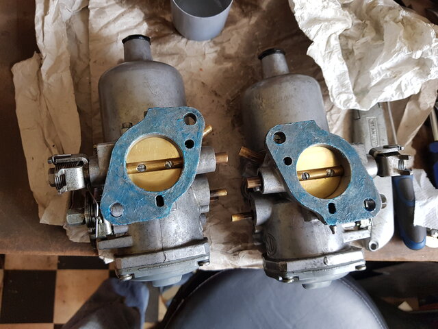

SiC Posted May 6, 2019 Author Posted May 6, 2019 This car is such a bloody time thief. You go to fix something and then you find something else urgently needing sorting. Got the carbs back on. Put new gaskets and hylomar on the engine side of the carb. Buttoned it all up and swore a lot at the inaccessible manifold studs. Started up and retweaked the idle. I did fiddle with the mixture but tbh I either got it to the same or just worse! Probably close enough now. Replaced the cork gasket on the rocker cover. Old one isn't actually that old but I think I way overtightened it previously. Also stuck a new cap on. Wasn't too expensive and gives me a chance to pull the original one apart to give it a good clean. Then went to investigate the fusebox. Top two fuses are supposed to be for the lights on each side. However it looks like someone had problems with the top circuit and connected both light sides to the one. After sanding down the fuses and contacts the top one appeared to work again. Anyone got any suggestions on what cleans up these contacts well? I could carry on using abrasives but I seem to remember some household chemical is excellent at cleaning these sort of things up. Decided to give a Sparkrite ignition amplifier ago. Already stripped this one down and fixed it to get it just about acceptable electronically. In doing this I found several issues with the ignition system. Firstly was shit quality modern parts again. Another bbclassic poor quality special here. Never heard of the cap posts turning around like this before. Luckily I already had bought a decent quality cap with brass terminals from Moss the other day. Secondly was the coil power wire had split. This is infused 12v too, so not ideal. I was pretty hacked off at this point so I decided to run a fresh wire directly to the coil and fusebox, then zip tied it to the loom. I'll sort it out properly eventually. Fired all back up and she ran ok. Still a bit lumpy and checking the plugs they're pretty black. Yeah I know she needs a good run to clean them. To give a headstart I cleaned them down with a brass brush. Might actually just get a chance to wash down the filth, dust and dirt car tonight... At least the evenings are lighter now, so if I don't get a chance for a run tonight, I should get several chances during the week. timolloyd, mercedade, vulgalour and 6 others 9

1970mgb Posted May 6, 2019 Posted May 6, 2019 The Burlen/SU branded gaskets have a sealant impregnated in them that will activate the first time they are heat cycled. They are not supposed to be used with any gasket sealant at all. I prefer the plain rubber ones, but I still avoid the use of sealant and instead put a thin coat of grease on them. SiC, The Moog and LightBulbFun 3

SiC Posted May 6, 2019 Author Posted May 6, 2019 2 hours ago, 1970mgb said: The Burlen/SU branded gaskets have a sealant impregnated in them that will activate the first time they are heat cycled. They are not supposed to be used with any gasket sealant at all. I prefer the plain rubber ones, but I still avoid the use of sealant and instead put a thin coat of grease on them. TIL. Never heard this anywhere else and I wish I knew they were. Would have saved me a lot of time. I did notice they are squishy and thick. Just thought it was to give plenty of give to absorb any imperfections. Can't imagine a thin layer of hylomar will do any harm though tbh. Just be more of a bastard to remove. Which I'm hoping won't have to be done for a good while.
