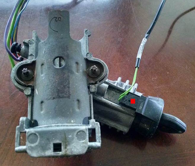

Dreaded barrel roll ignition issue
 20 minute free fix.
Drop the lower plastic cowling.
Twist the plastic EWS ring around slightly so that you can access the flat area directly under that sticky out bit where the EWS wires plug in. With a small drill, drill up into the lock on that flat. You'll feel the drill going in once, twice but not three times a Lady. Insert a small self tapper and wind it in with the key in but in the off position where it can be removed or inserted. A few turns of the screw and you'll notice the lock spin has stopped and the switch works as normal. Too far and it will jam up so back it off. I wind the screw in until it goes stiff and back off until it's perfect.
Job done. Fixed. FOC.
The red square marks the spot for drillage.
20 minute free fix.

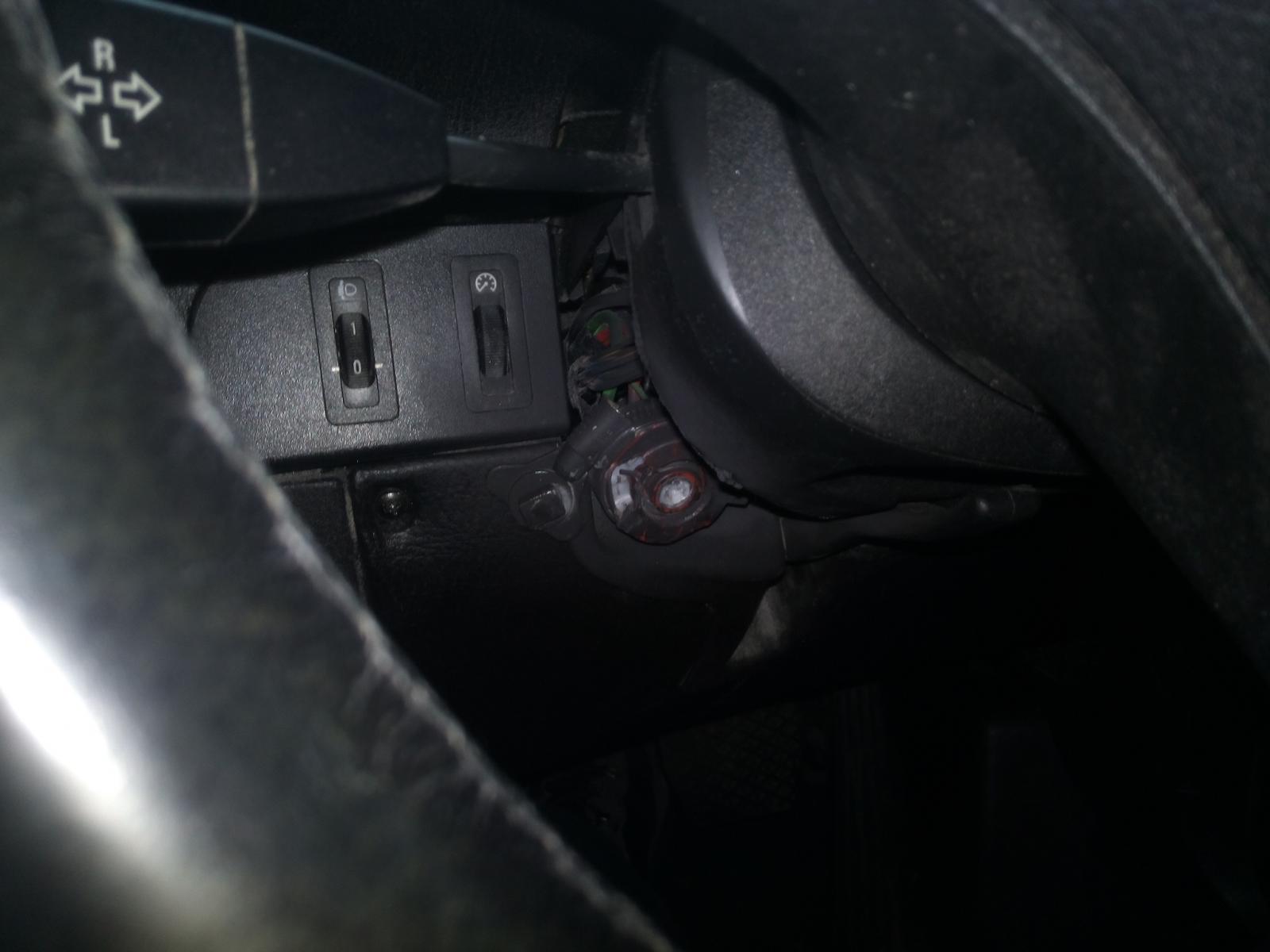

Cheers for that I'd already scoped out that, and am waiting for a day I don't need the car to try:)
Will it be complicated by the fact that the back of the ignition barrel (the actual switch) is mounted here:
Or will that just pop back on the barrel?
It it works, don't fix it!
You car is Jan 95 and it may not have EWS as that was changeover month. You may find it has the plastic EWS ring but no wiring to it.
Lol! Spoken like a true BMW owner;) its a PITA as immob is other side. I shall check for EWS wiring when I get the chance
