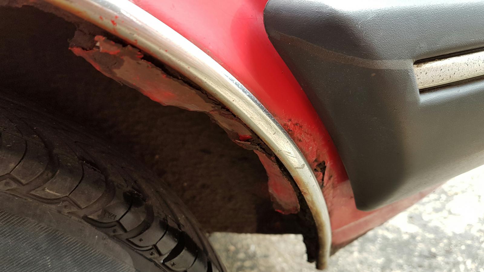

It's a weird car. German made so a lot better metal then the others and no rot underneath (apart from two very small bits I had done a few years ago) but just the outer edge of the back arches are starting to go.
The front is another story. Battery box is a mess and the inner wings have a few patches. Them and the wings could do with replacing but seeing as I don't trust anyone round here to do it (got mega ripped off with the xr2) it'll just have to be bodges for now

I s not looking good for the back arches. As can be seen on some other pics there's some silver bits of plastic round the them.its all that's keeping the back passenger one together...
Will have to just fill it or something for the test and get saving for the welding as its way above what I can do

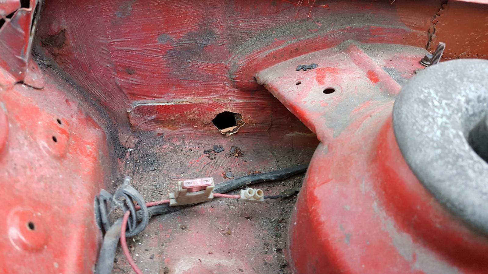

Well today was super bodge day as instead of actually attempting to weld anything, getting pissed, break something and not be able to fix or have any money to pay someone to fix it.
Anyway filler it was on a small hole in the inner wing. 'what's that near the indicator?' shit another hole and another but smaller, it'll be a horrible place to weld.
So a bit more filler and a lot of underseal later they're all gone* went all the way down the sill edges with underseal too. Most of the sills are excellent apart from the beck ends I had done about 3/4 years ago. They're coated in some very thick black shit that looks like it's bubbling so they'll need doing again.
I'll either have to get good at welding of start saving as its going to need quite a bit of work very soon. Luckily 99% of panels are available.

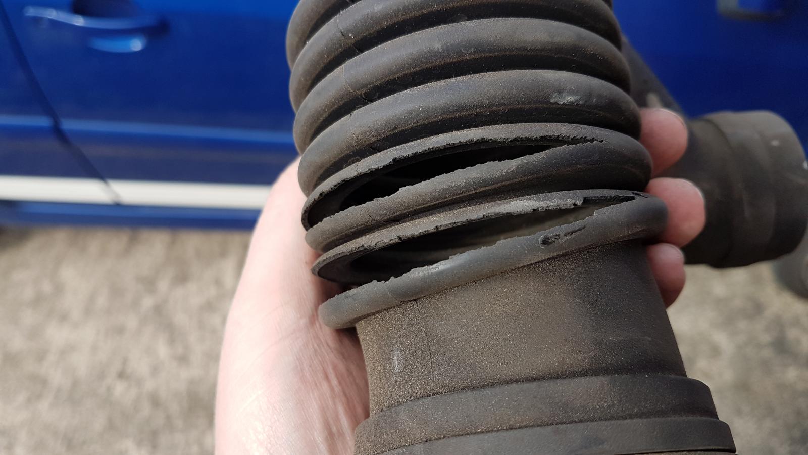

Anyway in other bodging news the mk6 ST has decided it wants to have a lumpy idle and a strange thing where when your coming to stop, off the accelerator and on the clutch the revs jump from 1500 to 2000 for a bit then settle back down.
Been doing it for a bit and now it's got worse. If you're not moving and just touch the gas it does the same with the revs.
Took a video. Was doing while I sat there but it doesn't look like it??
Took the air intake tube off as it was all split and taped it all up but it made no difference.
Ordered a scrap one off ebay that's only got one split and I'll see if I can melt if back together.
