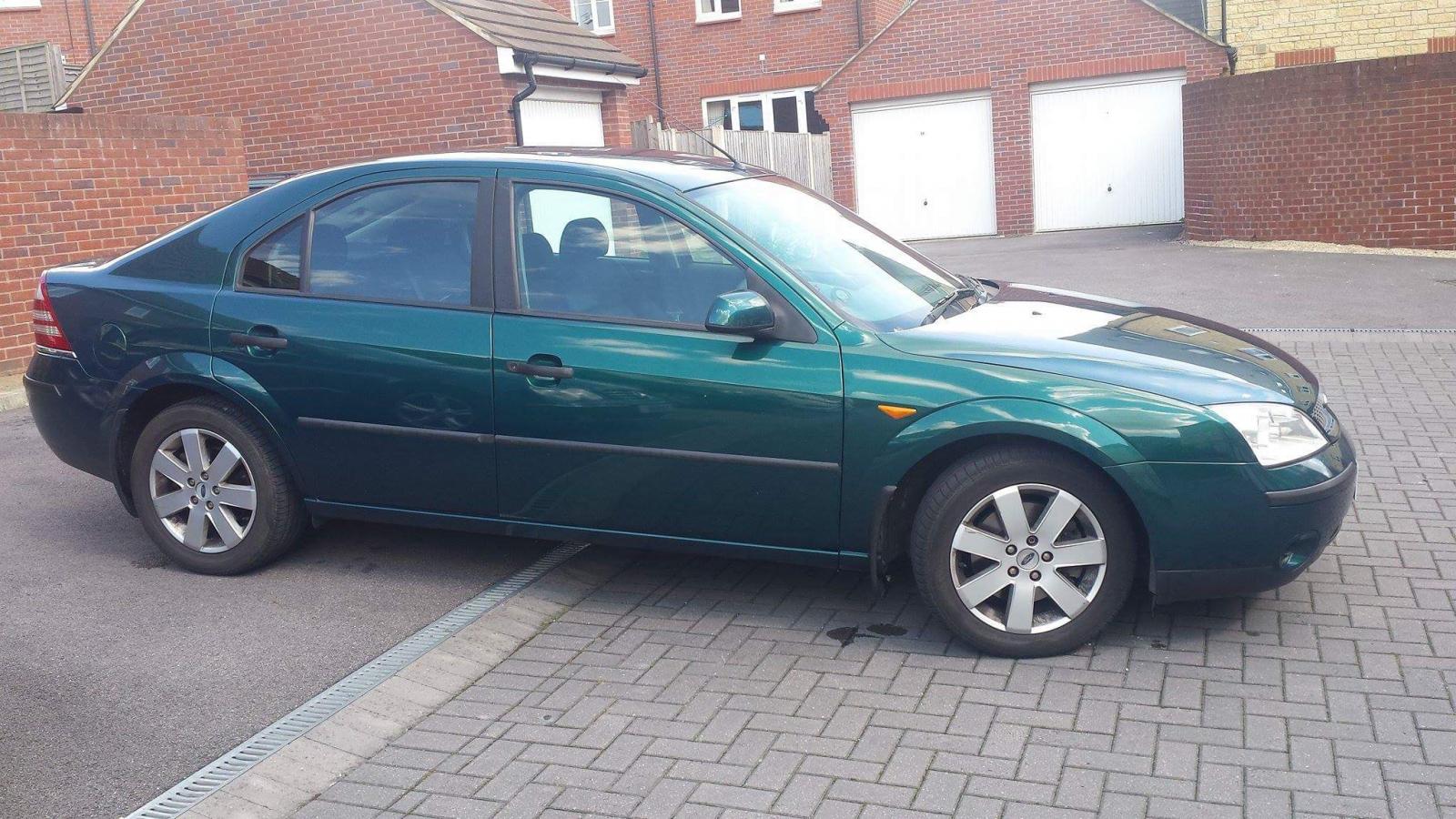

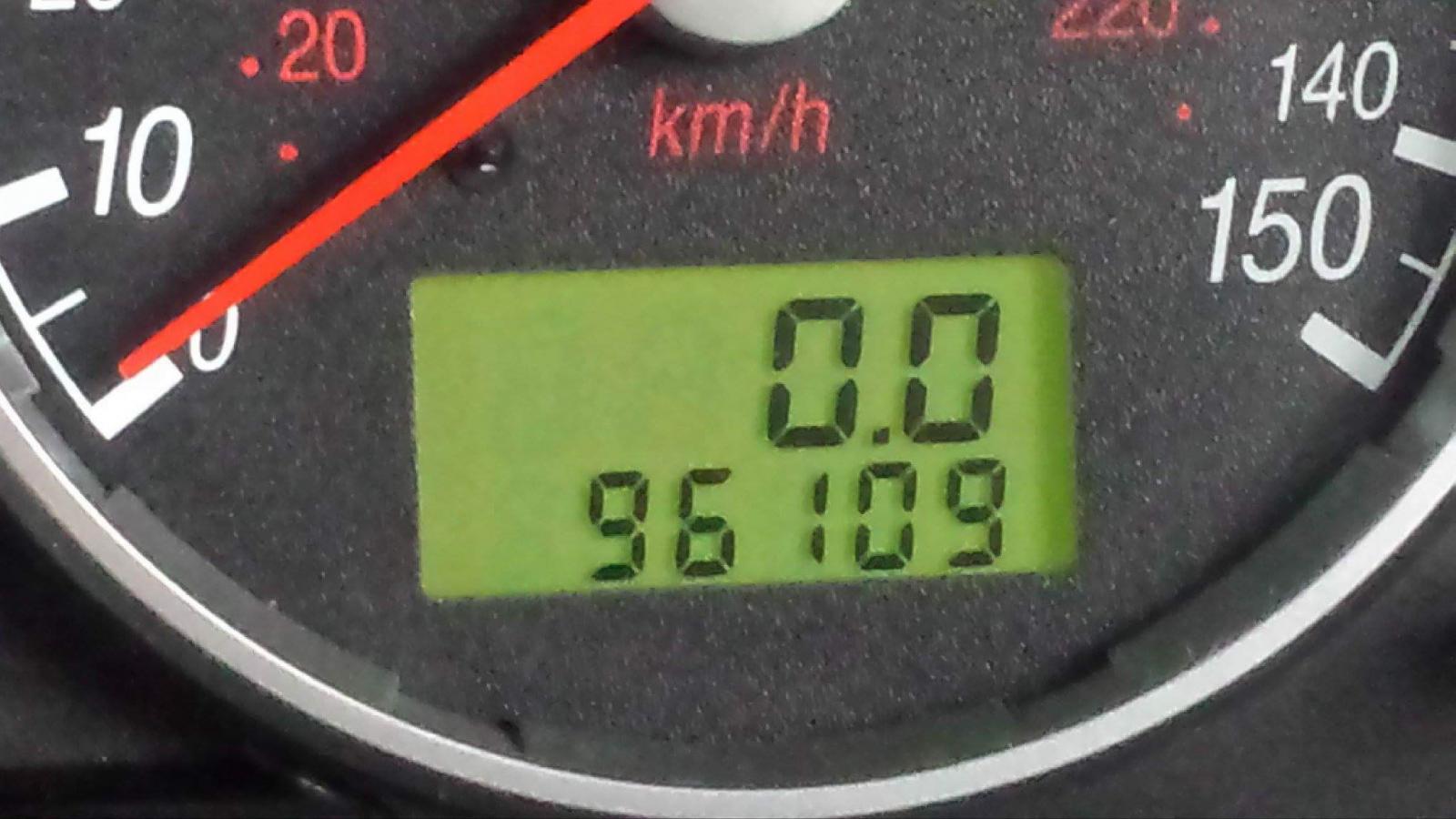

Not mine but a work colleagues friends car, looks ok in the pics, shade under 100k and price is definitely ono as the gent selling is on long term sick sadly.
Will endeavour to post pics asap but I'm at work till ten so most likely after that.
Nice cheap auto with a years ticket for under half a bag, seems ok to me.
Contact details available to interested parties.
Location would help :)
I think it's Hungerford. Taken from a previous thread.
Swindon is correct, apologies chaps and good detective work!!!!
Genuinely as much as I know about it is above,a figure of £450 has already been banded about so there's definitely room for negotiations.
Good, comfortable, solidly built cars these, lx is a decent spec too. Someone has added facelift rear lights at some point.
Often these mk3 Mondeos are maligned for being scrap with faults that are more expensive than the car is worth, I'm not sure about the 2.0 pez or autobox (dad's old one was a diesel manual which is still going with a shiter), guessing should be fine if looked after and it seems to look good body-wise in the pics.
The 2.0 Pez is a Mazda L-series engine, same as the Mazda 6. Mine was unburstable, it was manual though so can't comment on the autobox.
Parts for these are silly cheap. The only expensive job I came across was the rear subframe bushes, due to the labour involved. Someone has put facelift wheels and lights on that but it looks really tidy, they drive really well these cars - completely changed my opinion of them.
Averaged 37mpg in mine over a mixture of driving, steady long runs 40-45mpg was achievable.
Nice but as you would expect with auto a bit gutless and thrashy - drove one regularly.
Still for under £500 it looks a good buy....

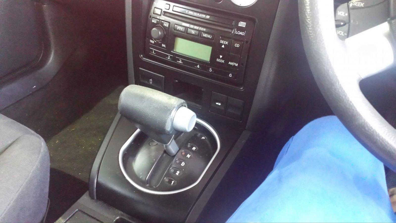

These had a big knob didn't they  :shock:
They really do don't they. Is it just me or do most auto transmission selectors look like huge clunking lumps of fisher-price plastic shite. To me they often look like they have been specifically designed for use by someone whose left hand/arm do not work properly. This one is particularly awful I must admit although the idea of a 2.0 auto Mk3 mondeo hatch is quite appealing overall.

I was wondering how good the auto boxes were on these, and similar aged other Fords as Mrs_Carlo has her and my eye on a 2004 Fiesta 1.6 auto.
They seem to be conventional torque converter boxes until the Powershift came out, am I right?  And the ones as on this 2.0 LX one seem to have only three speeds on the selector so one presumes there must be a button on the shift somewhere for the 3/4th overdrive option?
The auto boxes are I think, quite good as long as the fluid is changed on a regular basis. For the MK3 Mondy auto, Ford specify Mercon, the name is on the stick at the top.  Dexron 3 is also good, its just the specification you must always check before adding fluid to an auto box. Make sure it is compatible with what is in there.already.
The overdrive on the MK3 Mondy is on the right of the T handle, underneath. When the overdrive is in, it shows a"O/D" in the window where the information is shown when you press the "info" handle on the left of the column. It should kick in on a light throttle around 40 mph and one can observe the revs drop as it engages.
I am planning to do a partial fluid change on my gearbox this weekend. I use a transfer pump with the pipe down the filler tube.and suck out 4/1/2 litres. Then I add the same amount of Carlube-U which is a full synthetic AFT. I shall do the same again in 2 months. This way, the fluid will be renewed over time. On the C4DE trans, the fluid filter can only be replaced when the box is torn down for overhaul.
As for Powershift gearboxes, then sorry, I have no experience with one. Whatever auto car you are thinking of buying, make sure the test drive is long enough for the gearbox to warm up, as this can show problems like slipping, hard shifts, flares and clonks. If a car drives like this, you have to be brave to take it on. You may fix it but you may not. Any gearbox can have problems. But make sure its the other guy who is stuck with the problem and not you!
