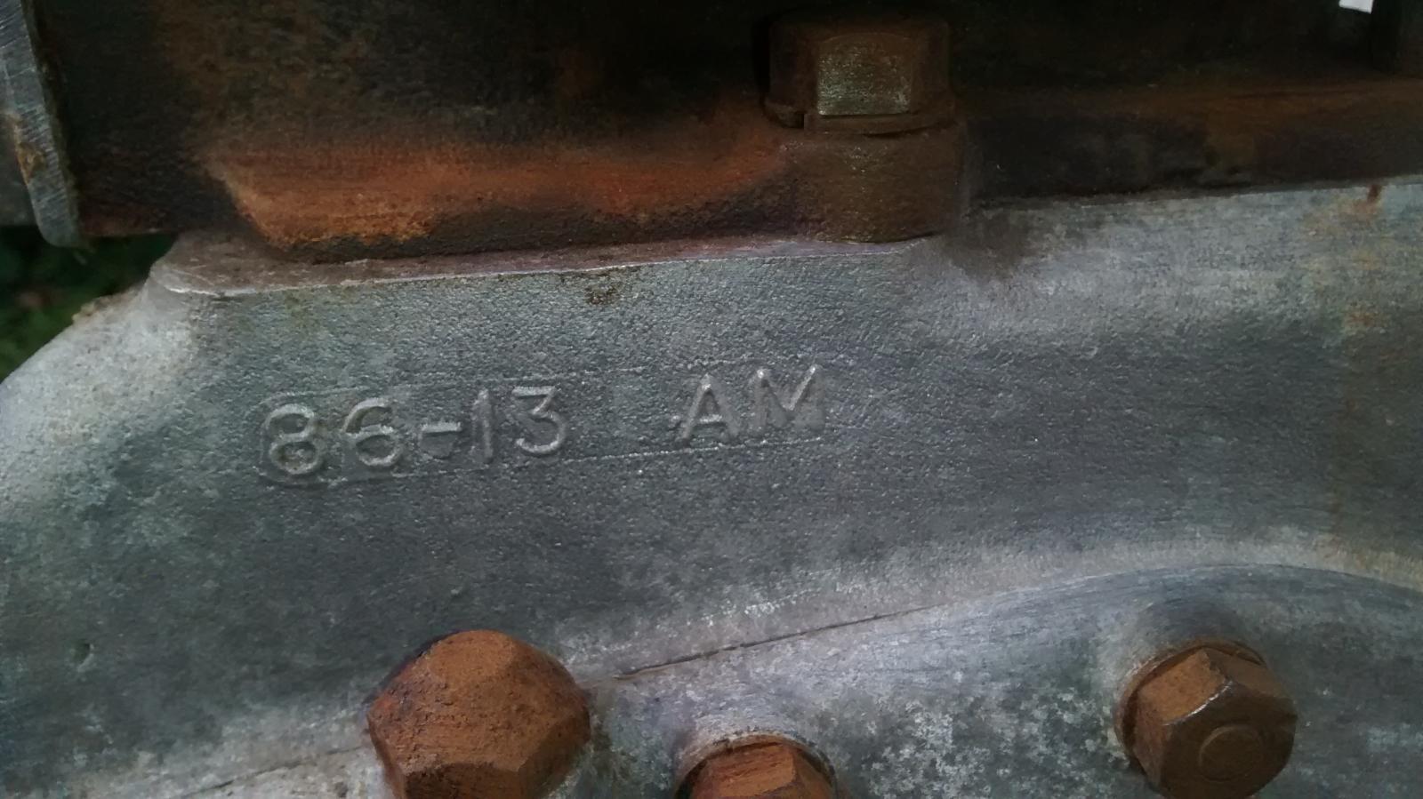

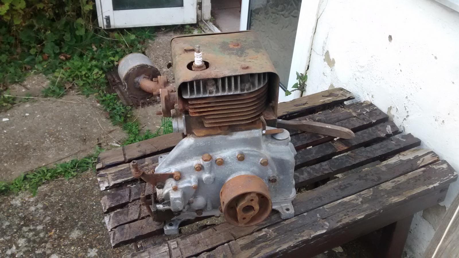

For the princely sum of ONE ENGLISH POUND my local council tip were more than happy that I take away this fine piece of engineering today (along with three mowers, two of which fully working and one TBC for £3 each)

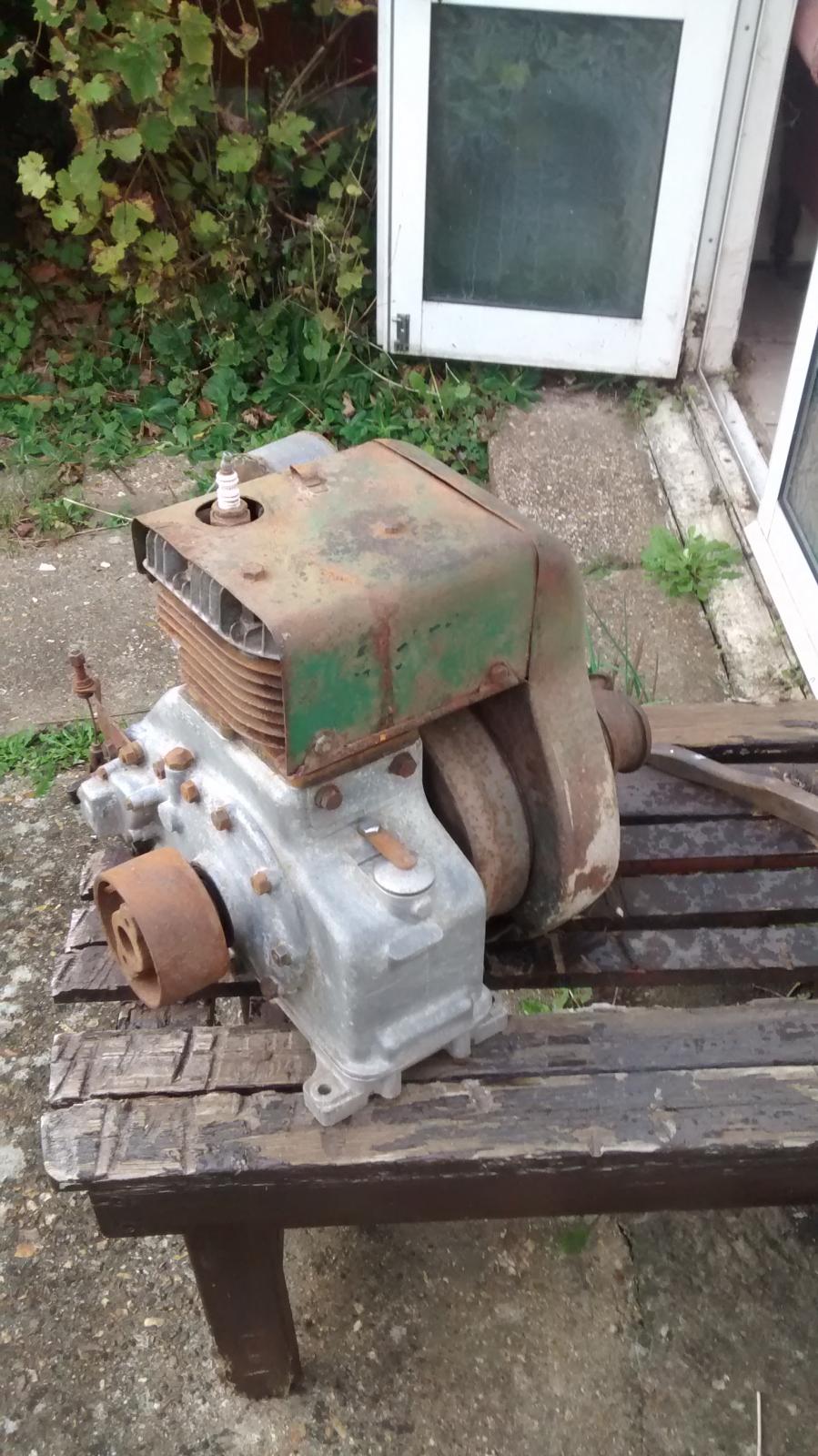

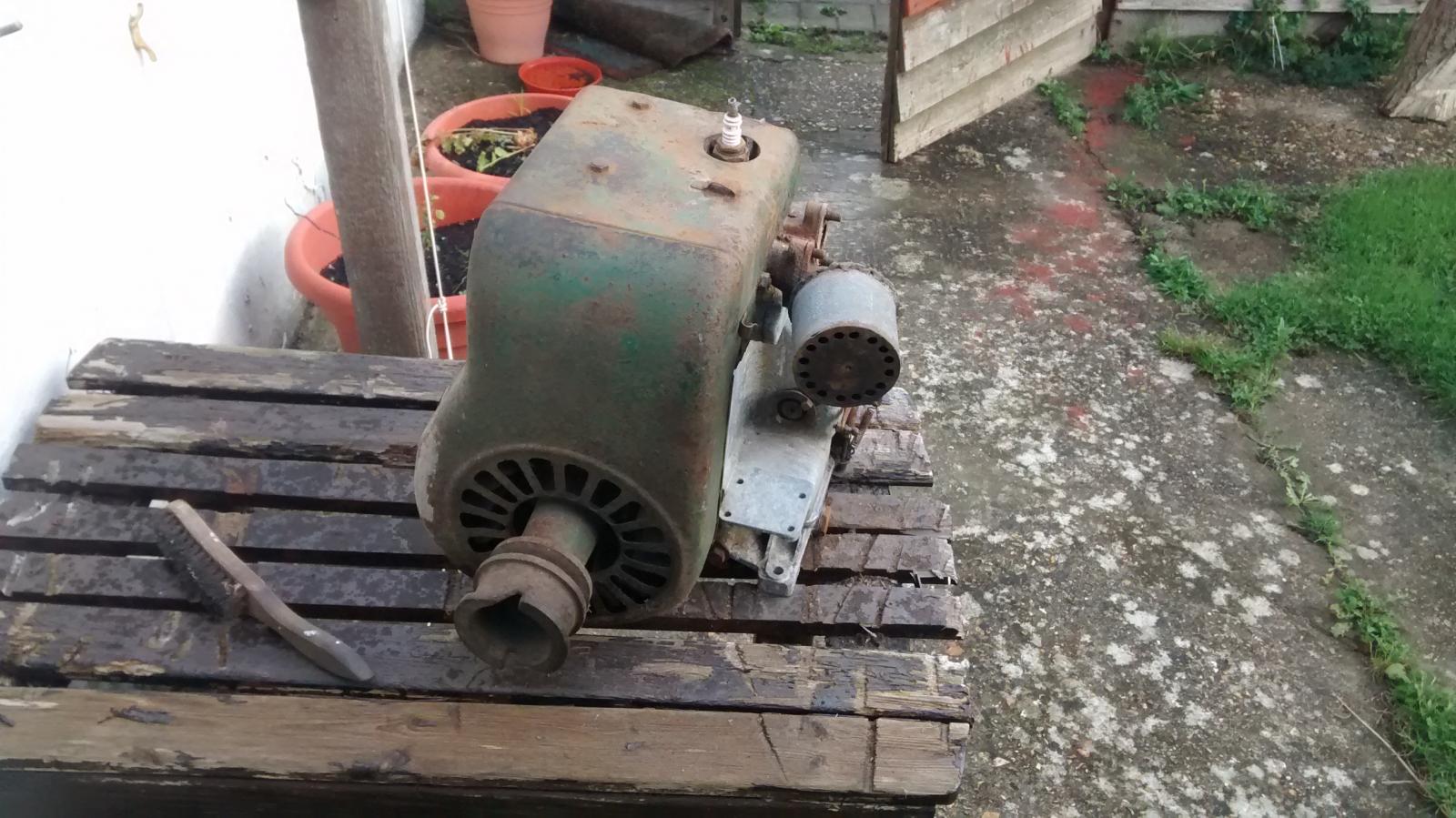

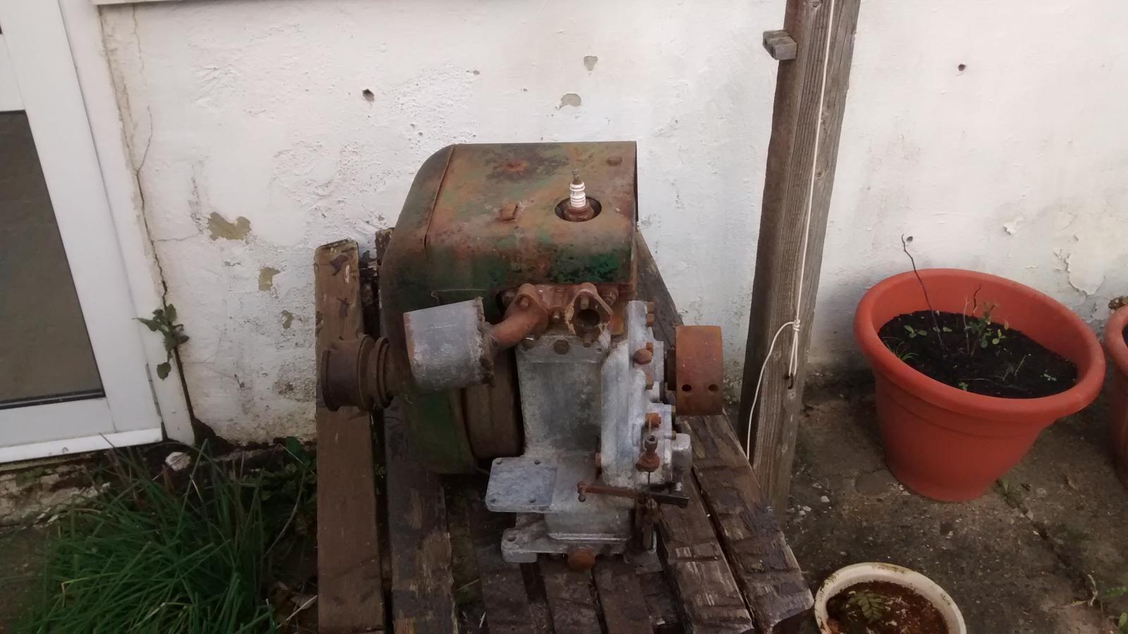

I tried to join a stationary engine forum but the email is taking forever to come through, in the mean time anyone here know what it is? The only marking on it says '86-13 AM'. It clearly lacks a carb, fuel tank, magneto, and possibly other things but turns over fine by hand and does have some compression after holding my hand over the exhaust and feeling the pressure on the exhaust stroke. Oil is clean and up to the mark.
I cleaned it off with a wire brush and its sat in the garage now. I'd like to fix it up really. Weights a flipping tonne though - easily 40kg and half the bits are missing. Step 1 will be looking for something with wheels to mount it to.
...it says '86-13 AM'...
The only help I can provide is that the clock isn't working correctly.
Neither is the radio up to date....
Seriously, though, AM could refer to Air Ministry (RAF) if it looks non-factory applied.

Thanks, looking at Google image results you may very well be right!
I have always been a fan of little industrial engines like this.
When I saw the photographs I thought it looked like a JAP to me, but would expect to see those letters cast into the crankcase somewhere, so may indeed be a Villiers, but not sure of the model. Looks bigger than a C12 or 15.
There is a little platform under the exhaust outlet on which a magneto might have originally been fitted. Is there a drive coupling visible on that side?
Squirrel2
Ok so assuming it is a C12 or similar then there is a missing fuel tank on the not-spark-plug side which mounts to a little bracket and has check straps that go over the top to keep it in place. Then there is a magento under the tank with an HT lead to the spark plug on top.
Finally, there is a carb which may go on a intake pipe to keep it away from the exhaust and a fuel pipe from the tank to the carb.

After help on a stationary engine forum it turns out it is a BSA 320cc Model A and is missing the carb, magneto, fuel tank and straps. I've been told what I need to source, so now the process of assembling the bits I need before fitting them.
I'm quite looking forward to it really, once running I think I'll set it up to run a little generator or alternator or something electrical.
