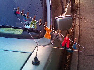

My Hyundai rocked a coat hanger when the electric job snapped off.
This is compulsory in Australia if you are coat hanger-ing:
