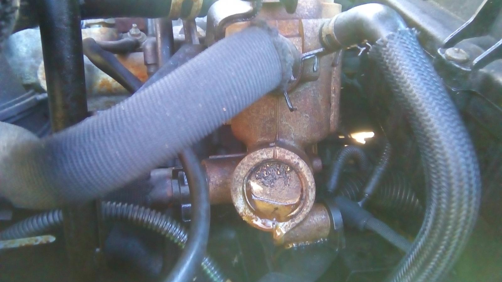

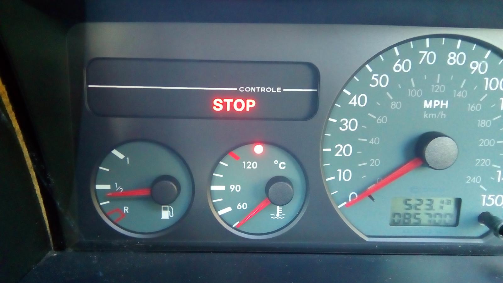

Supernaut Posted August 8, 2017 Author Posted August 8, 2017 After over a year of trouble-free motoring, I fired it up earlier this evening to be greeted by this: Hmmm... I then decided to open the bonnet. Oh, shit! On closer inspection, there seems to be a pinhole in the thermostat housing. I think it's been leaking very very slowly for the past couple of weeks. When the engine is up to temperature, a fine spray comes out of the left edge of that indented circle. I've currently got a big bottle of water in the boot, and it seems happy enough once topped up. Obviously not a long-term solution though. Liquid metal time?
Supernaut Posted August 8, 2017 Author Posted August 8, 2017 Is the thermostat housing part of the head? I don't think so. It looks removable. I know where you're going with this. Do it properly and replace the housing. I'm thinking short-term to get it going again, liquid metal, if it would help, while in the meantime trying to source a thermostat housing. The fine spray of coolant has made a lovely mess though. It's hit the top hose and then completely covered the engine bay side of the radiator in brown sticky goo as well. Beautiful.
SiC Posted August 8, 2017 Posted August 8, 2017 Why not just buy another one rather trying to bodge up a bit of your cooling system?It's a bit excessive buying a whole new car because the thermostat is leaking. They_all_do_that_sir, The Moog and Dave_Q 3
Supernaut Posted August 8, 2017 Author Posted August 8, 2017 Hmm, thermostat housing just seems to be the top part. http://www.ebay.co.uk/itm/Thermostat-Housing-Citroen-Xantia-Xsara-Evasion-Peugeot-206-306-406-806-2-0-HDi-/301374403699?hash=item462b507473:g:9i4AAOSwF1dUUqEZ The bit that's leaking is below that.
Supernaut Posted August 8, 2017 Author Posted August 8, 2017 It looks a bit like a core plug. Aaaaah! So, how does one replace a core plug? Never done one before.
Supernaut Posted August 8, 2017 Author Posted August 8, 2017 Ordered! Might end up borrowing my brother's Civic to go to Glasgow at the weekend. I've already asked and he's ok with it, as I'm a named driver on it. Woo!
Supernaut Posted August 9, 2017 Author Posted August 9, 2017 Core plug due on Friday or Saturday morning. I need to be in Glasgow on Saturday evening. Train ticket? Naaaah. I've been told on the French Car Forum to put a meaty self-tapping screw into the old core plug then use a claw hammer to pull it out. Then clean up the mating surface and tap the new one in with a block of wood and a hammer. Easy! As mentioned before, I can fall back on brothernaut's Civic, but where's the fun (and waft-factor) in that? Dave_Q and The Moog 2

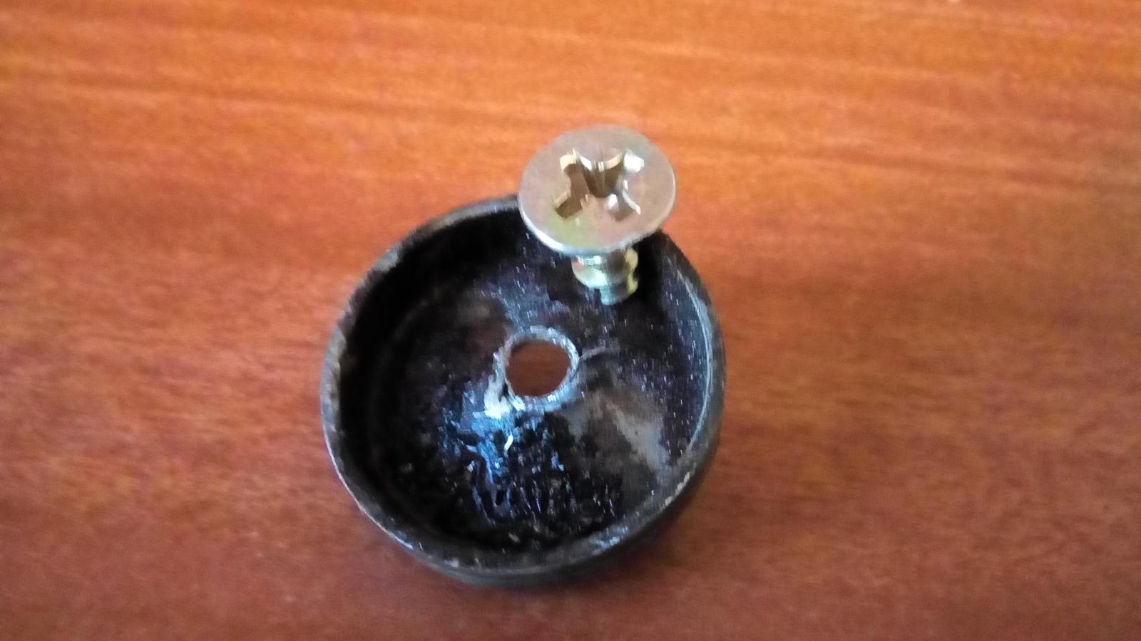

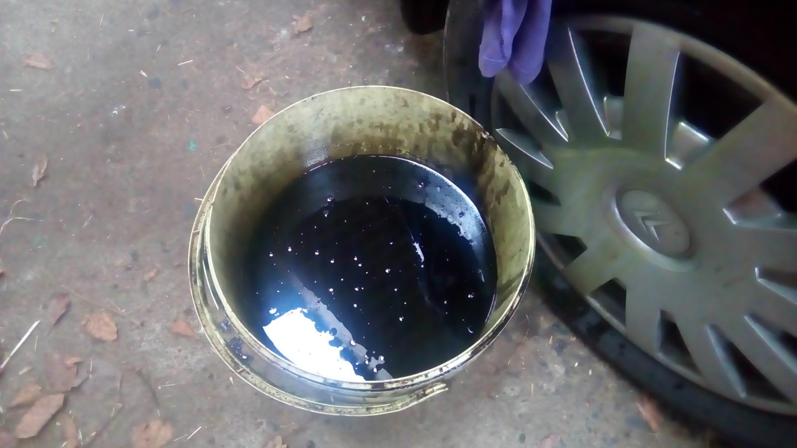

Supernaut Posted August 10, 2017 Author Posted August 10, 2017 Lacquer Peel has just left my house, with his intercooler and air filter. He gave me a hand with the job on the Xantia. We got so close, yet so far.... Firstly, we drained the coolant: Fucking grim! Then we removed the old core plug by drilling a pilot hole, driving in a self-tapper and pulling with a claw hammer. Woo! Well, a couple of pilot holes. The first was a bit too loose, so I used a smaller drill bit for the second one. We then found out that the core plug I bought is 25mm, the core plug I need is 30mm. Shit. It seems a fairly common part so surely a local motor factors will have one in stock. Once I source one, bash it in and fill with coolant! Now, LP did suggest I run it with just water for a few days to flush the cooling system. Would I be ok to do this from Aberdeen to Glasgow and back at the weekend? Then I could drain it on Sunday and fill it with proper coolant. Lacquer Peel and somewhatfoolish 2
