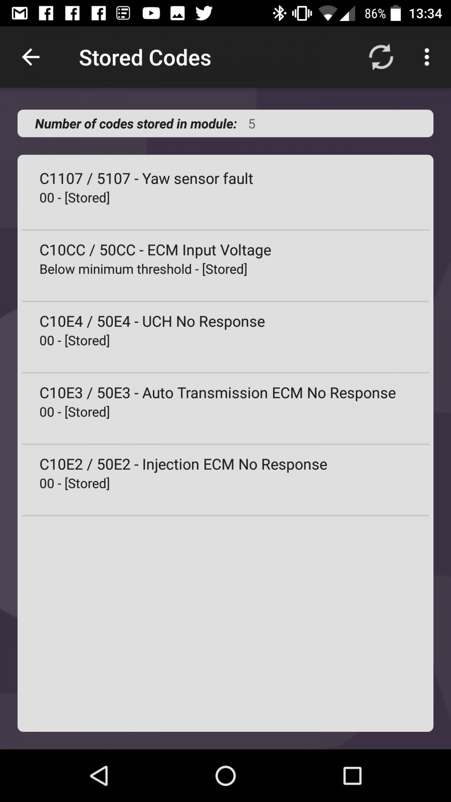

beko1987 Posted July 19, 2017 Author Posted July 19, 2017 So, just been out at lunchtime on mums drive for one last ditch attempt! It seems the handbrake lever on the new second hand caliper is sticking (a common fault apparently). Eyeballing it properly after teaching mum how to work the handbrake revealed it sticking. A quick tap with a hammer had it ping open and the caliper not grab. So 20 minutes and 1/4 a can of wd40, a small screwdriver and a cable tie had lots of crap flushed out, and the lever working OK.. Then the handbrake fault warning came up on the dash. buggar... So, I tried my OBD reader, and after I worked out that I don't connect to it first then boot up torque, I have it showing on available devices (and turn the headunit off so it doesnt connect to that instead), torque connected fine, and found 3 error codes which were nothing to do with the handbrake, but I cleared them anyway. Then I rememberd SIC's oh no renault, so downloaded it, and it fugging worked, and connected, and bought up about 8 handbrake module errors. I paid a quid to get 14 days use, and it bloody cleared the lot and took the warning off, result! Also, after all this, plus a few extra pulls of the lever has the handbrake holding much better, so as long as the caliper doesnt catch fire again tonight it's going in for it's test tomorrow, and if it fails going to 24vv6turbo's home for elderly fucked renaults! But whilst I was there, I had a better play with OhNo! I can't remember which was which now, I think this was the engine This was the auto box and this was the headlights I chickened out of trying the airbag module, forgot to take a smudge of the handbrake screen before I cleaned it and it wouldn't connect to the UCH. I think these are historical, so will leave it a day or 2 and re-check! Ace app SIC! cpjitservices, barefoot, The Moog and 2 others 5
