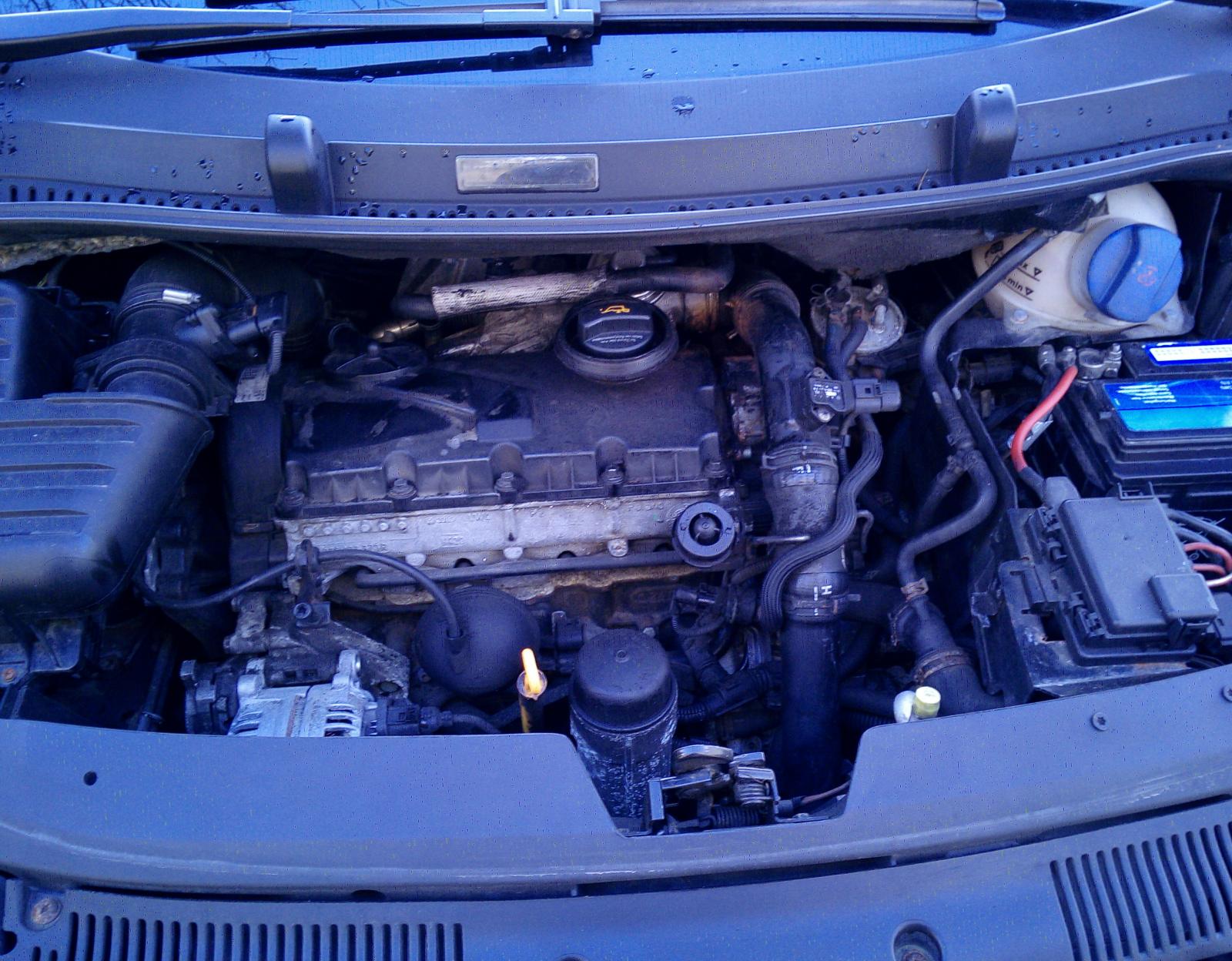

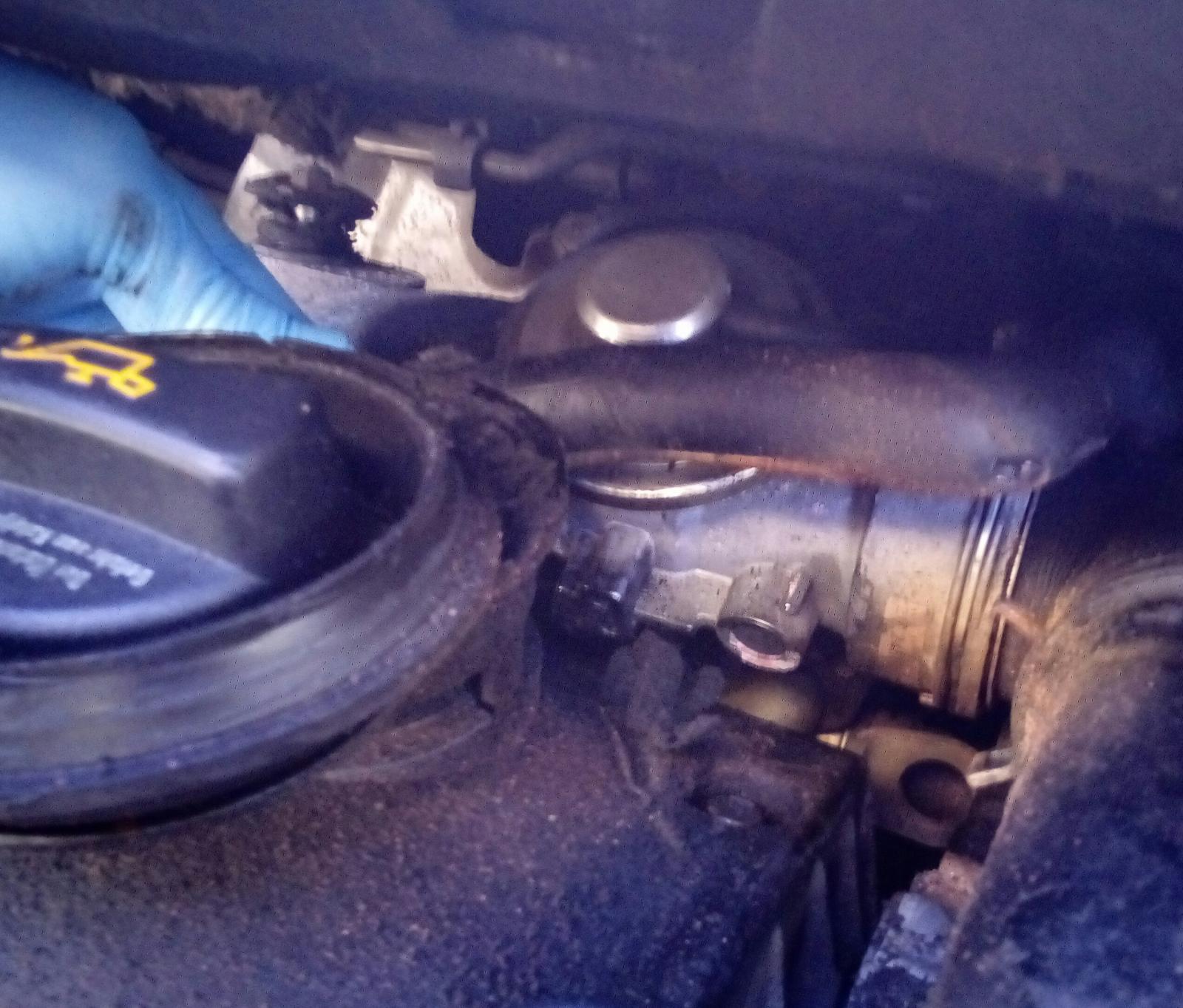

Managed to get some time to look at this. First impressions are that the engine seems quite far back. I haven't even found the turbo yet! The egr looks quite difficult to remove. The fuel filter looks a bit old and manky. I've found a hose with a hole in it though (photos 2 & 4). Haven't got a clue what it's for but I might try a temporary repair to see if it makes any difference.

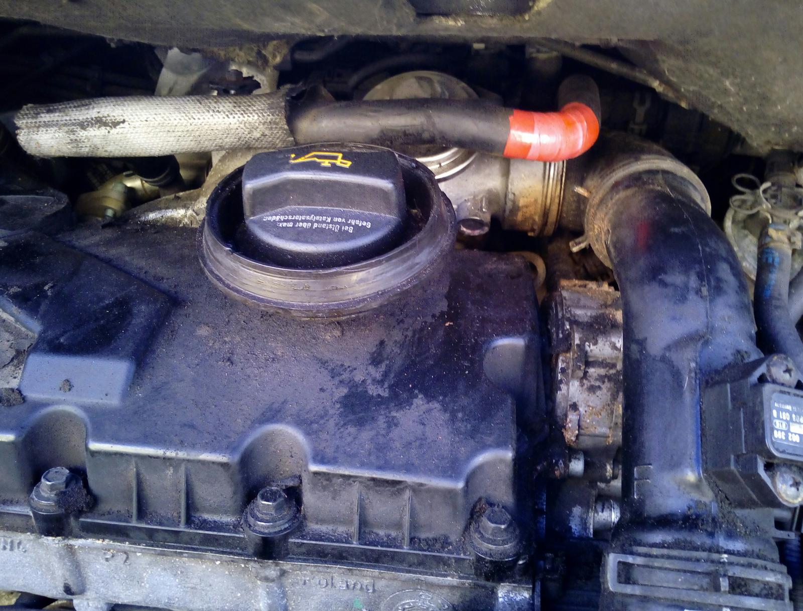

Spot the invisible repair to whatever pipe this is.

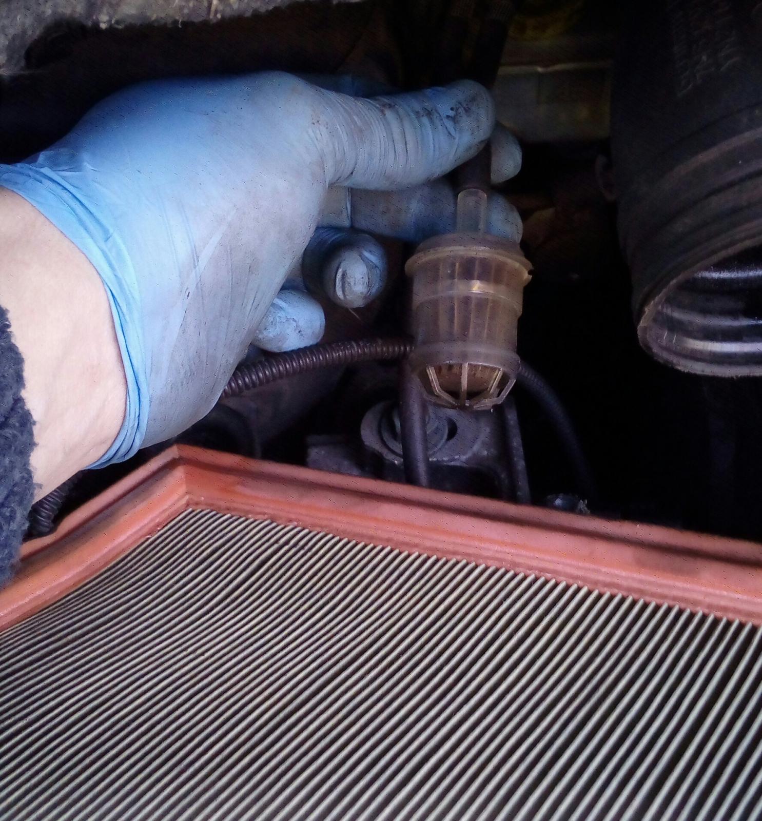

Does anyone know what this little thing does? Looks like a filter but is open at one end. Something to do with the aircon?

I'm also told the egr valve and boost control valve for the turbo are the same so swapping may give you a clue.
Turbo will be towards the top left of the engine as you look at it.

Your invisible repair is invisible.
If that's a canister type diesel filter, it looks bloody prehistoric!
I'd get that changed, they're probably only six or seven quid delivered from ebay.
Right, the taped hose is (I think) an engine breather, could do with replacing but is unlikely to be causing your issue.
The small fuel filter looking thing is bit odd, never seen anything like that and the pipe is of the correct size to be a vacuum hose. Your turbo and EGR are controlled by vacuum.

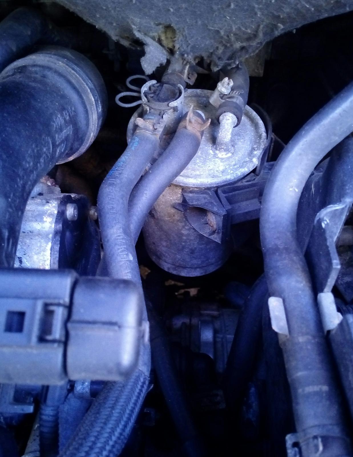

I would check/replace all the vacuum hoses, start at the sphere looking thing on the front of the engine, follow that hose it will take you to a valve block with 4/5 other hoses (possibly near the l/h strut top as you look at it), follow and check them. One is for EGR which is the UFO looking valve on the inlet manifold. One is for the turbo which is down the back of the engine. Possibly best accessed from underneath.

Check/replace all these hoses, a couple of metres of silicone hose should do it (4mm internal I think).
Leave it alone if it isn't connected to one of the hoses in the pic below, otherwise summit else might start giving bother.

Think the EGR / boost valve swap still applies, they don't look quite the same but they should both be 3 port solenoids.
This is the control valve that is a smallish box with 3 vac hoses and an electrical connector, not the physical EGR valve if that makes sense.
They look something like this.
