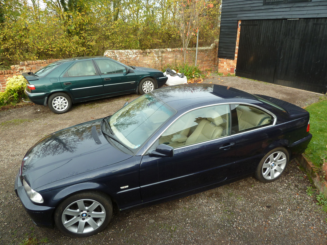

We have an E46 330CI SE Coupe Auto which has only done 60k, we have had it over 10 years and bought it from the first owner.

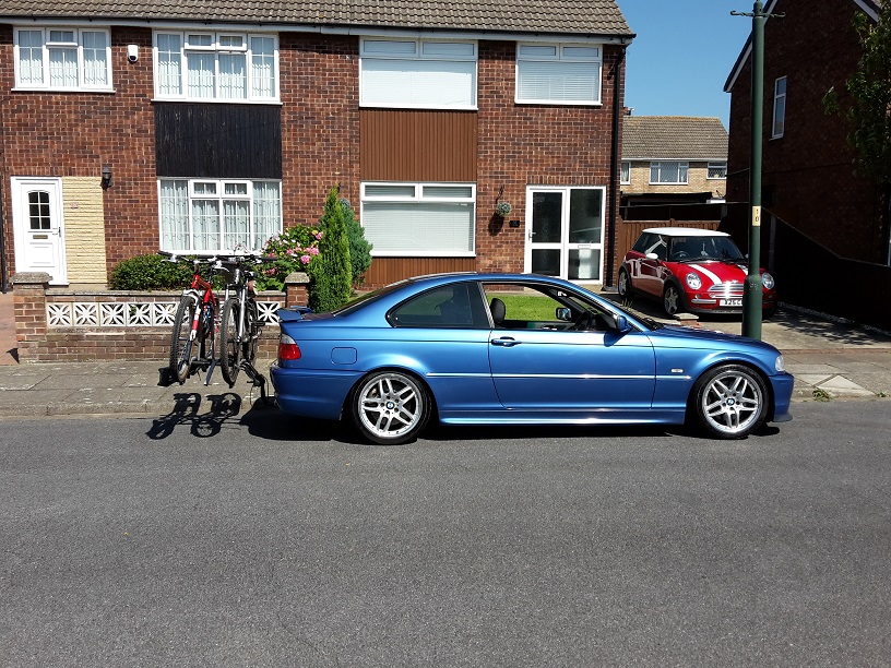

I've had my 330ci Clubsport for nearly 5 years now, and done 46K in it, I flipping love it. I'd definitely recommend a manual as that's what I have experience of, it's a nice box.
 Mine has had an alternator, battery, thermostat, front wishbone rear bushes and front discs and pads in the time I've had it, apart from oil and filters etc.
They do use a bit of oil as previously mentioned, and the front wishbone rear bushes, and rear arm bushes, but that's about it. I get about 28mpg combined out of mine, not bad for a 6.2s to 60 155mph machine. Unplug the vacuum hose off the rear silencer for maximum burbleage :D

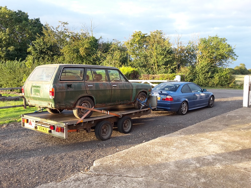

Here's mine earning its keep..
If I had the money that's exactly the spec I'd like, in the right colour too.
However, I'm looking at the sub-grand cars. I really would prefer a manual but in that price bracket they all seem barried/borked. Good tidy autos seem much more attainable.
28mpg is about what my E38 is returning overall, so I can live with that. I was going to off the E38 but seeing a Clubsport with a tow bar means I might sack off the Transit instead!
