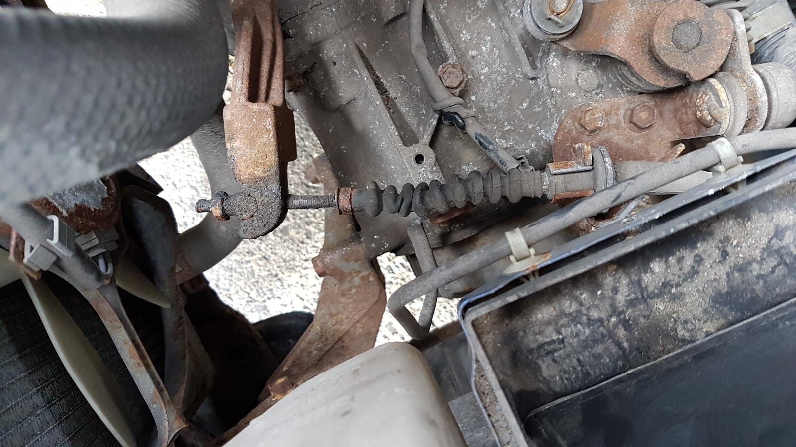

Bouyed with enthusiasm, I decided to have a go at adjusting the clutch cable. Quick fiddle of the nuts and the bite altered very favourably on the pedal end.
Result. I didnt break anything.
