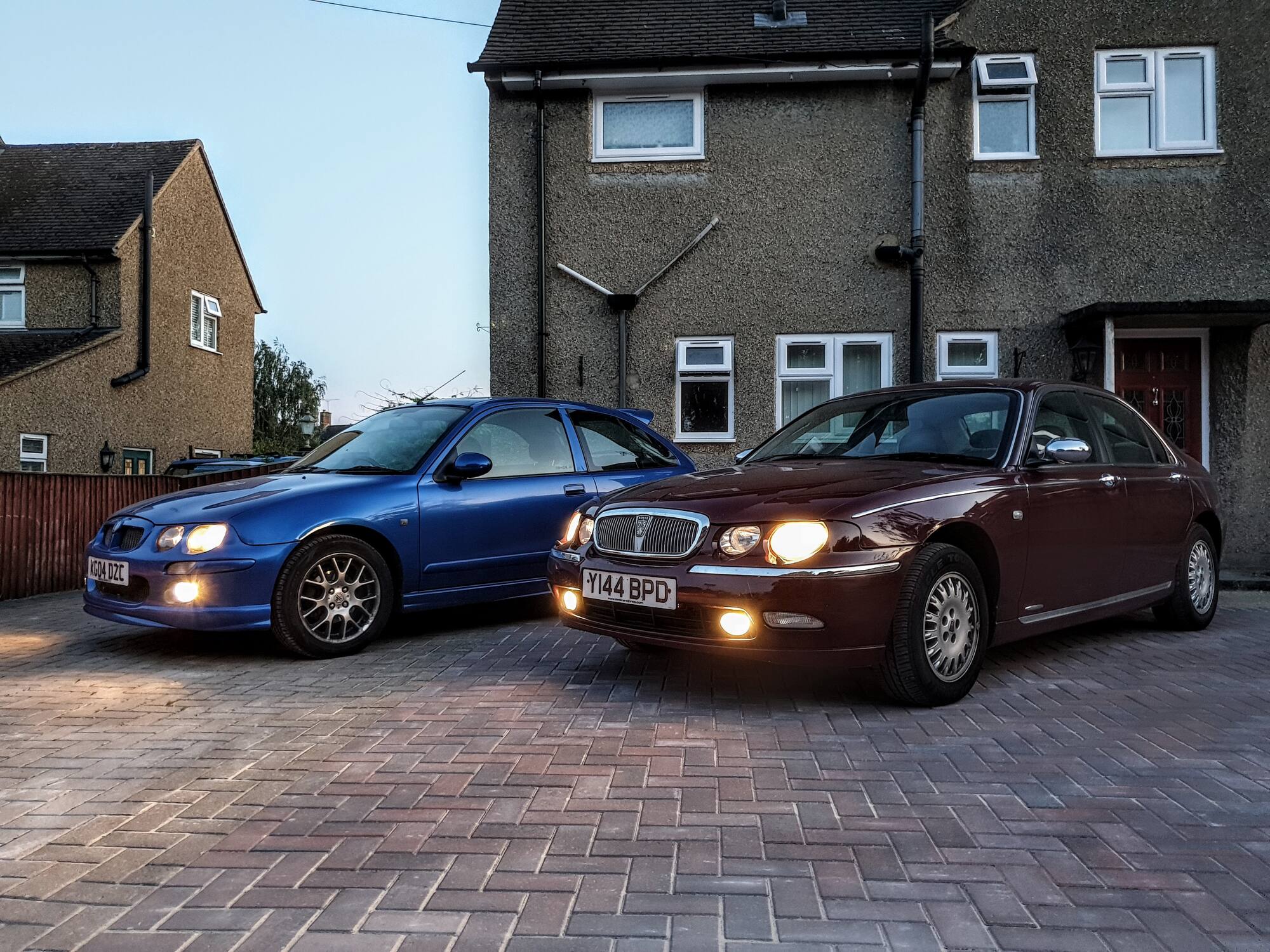

Also here's a photo I took of Bob (the diesel 75) probably around 4 years ago, not long after buying him:

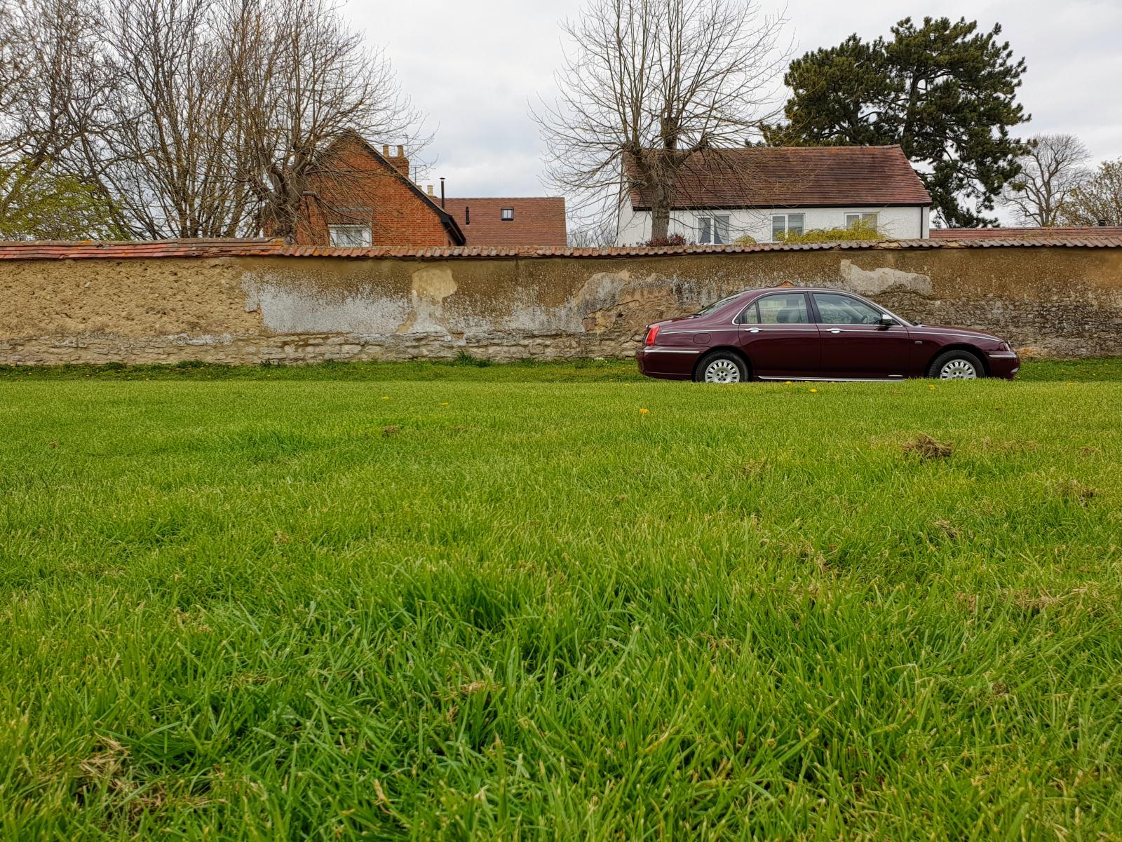

Well, after meaning to do it for ages, I've been out today and tried to do the same photo with Bertie (the V6). Not quite the same angle, and much more foliage as it's a summer vs winter shot!

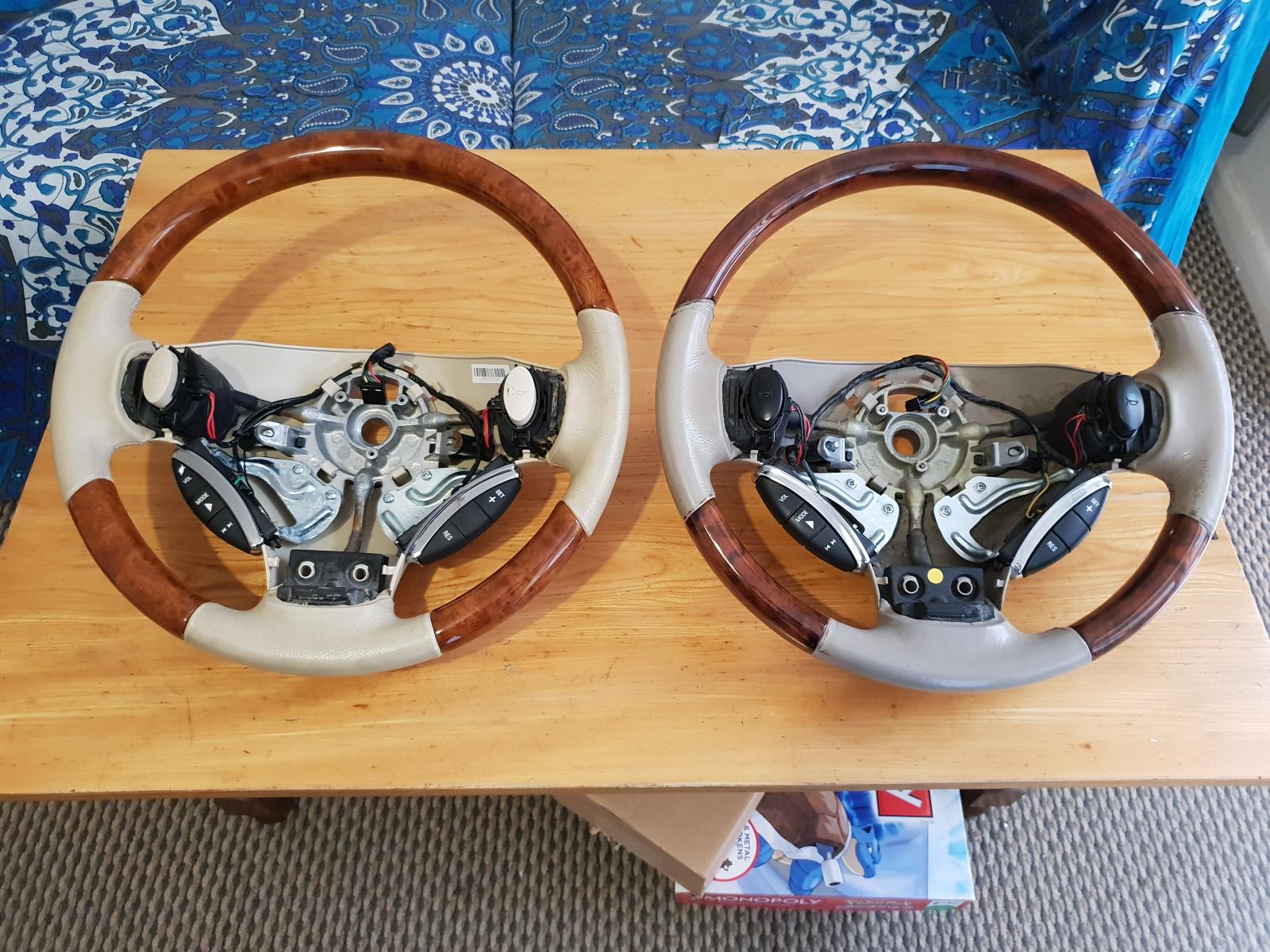

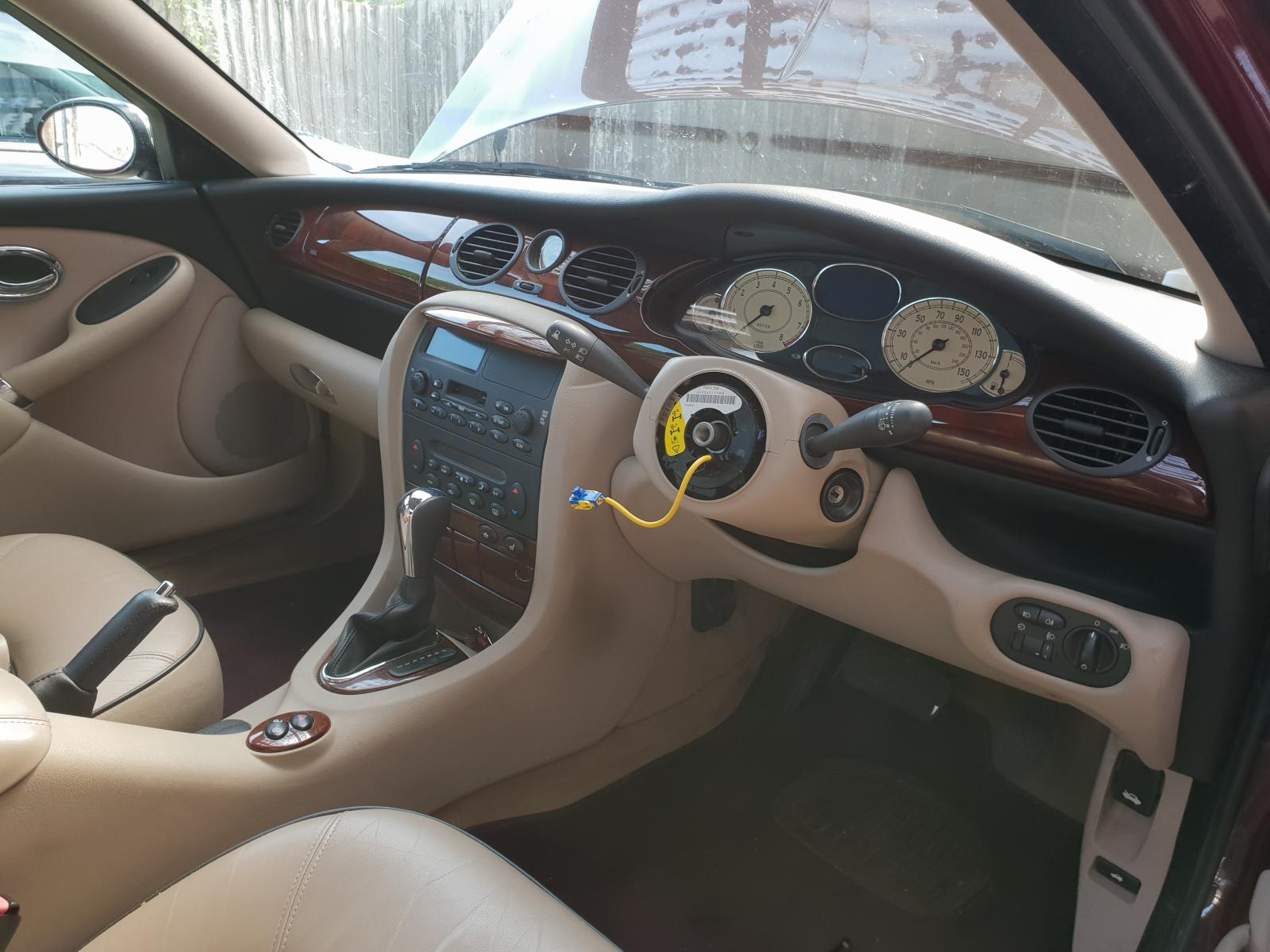

Little project on this morning while I've got some time off work. My dad bought a 75 tourer last year which came with a walnut / sandstone wheel that the previous owner had bought and then realised it was wrong (his car is smoke stone trim). He gave it to me last year and I had it fitted to my 75. However it was one of those Chinese imported ones from SAIC and it showed. The leather didn't match, the wood was plastic & the quality was abysmal.
Today I finally got round to fitting an early genuine Rover wheel (ashamedly stolen out of my diesel 75) to make everything match.
Before:
During:
Check the quality of the Chinese components:
And the difference in colour between the two wheels:
And finally, the finished article:
Much better. I think the old wheel would look ok if the horn buttons were black.

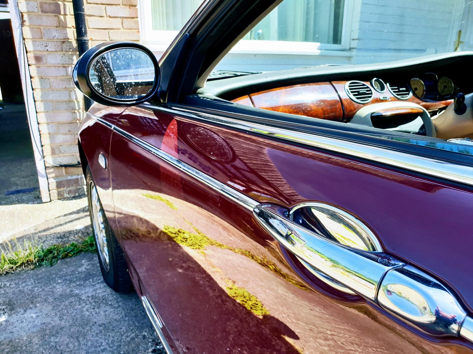

Nice, love the door finishers. How did you attach them?
They came with some tape attached to the rear - it's almost like a continuous bead around the edge and is VERY sticky.

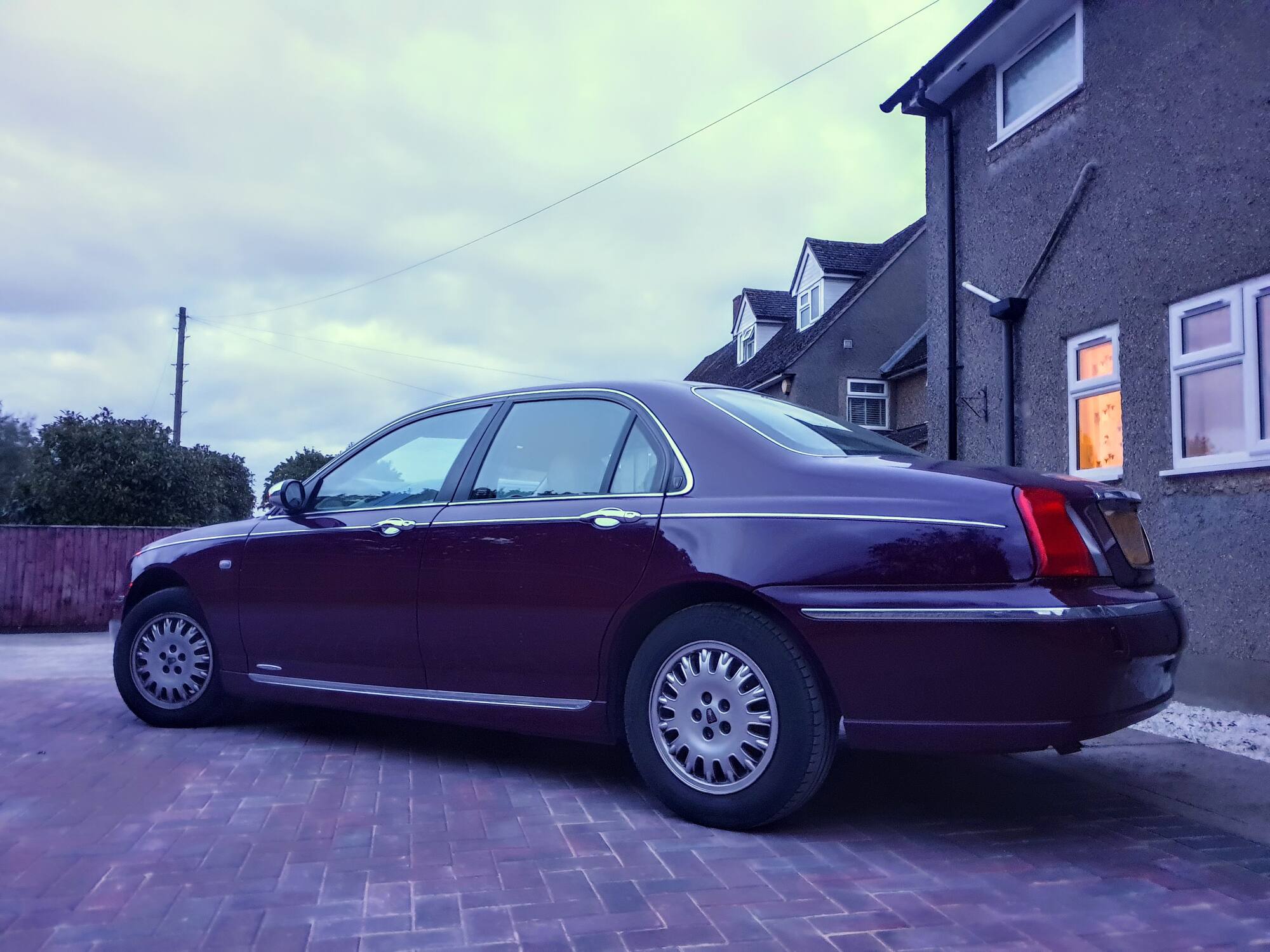

On the whole, I don't think he's looking too shabby...
Stunning cars. And that colour really suits it
Sent from my TA-1012 using Tapatalk
Yes crown alloys
For me this is the perfect spec of 75. Pre project drive (although Longbridge built), Connie SE with all the toys and the 15" crown wheels. I've had 17" serpent wheels on a previous 75 but they really do affect the ride quality.
Sent from my SM-G960F using Tapatalk
That is a very nice 75, colour and spec.
Cannot beat an early connie V6 on crowns
