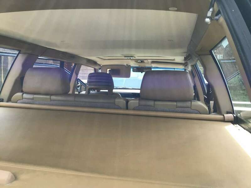

Had a few decent days so I’ve cracked on with this.
The headlining backing board is now covered. The material went on ok, used proper automotive interior spray glue rather than cheapo spray glue, which has worked very well! It’s very strong and heat resistant too so shouldn’t be prone to losing its strength when in a hot car.
Basically, as you’d expect, glue it from the middle and work outwards from there, gently pushing the fabric down and smoothing out any air pockets.
I did get a couple of small creases into it where the fabric had to go around some tight bends/corners but you can carefully smooth these out, or, as I had to, lay a kitchen towel over the material then use a hot iron with steam function to warm it up and iron out the crease. Just got to watch out for getting it too hot or too wet!
I’ve cut out all the big openings leaving a little excess so it can be glued and wrapped around the edges of the sunroof opening etc as it was originally.
It’s drying now in the shed so hopefully tomorrow I might be able to fit it!

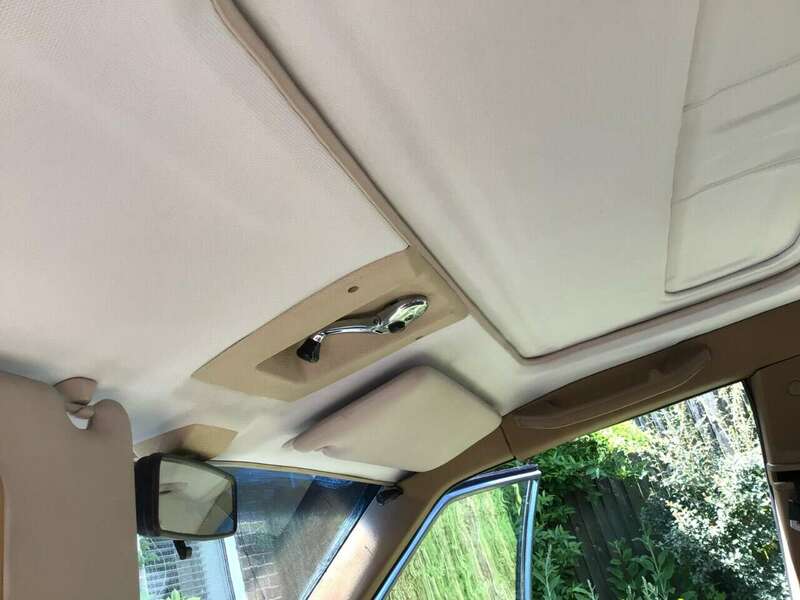

In the meantime I’ve used some offcuts to re trim the inside of the sunroof lid itself.
This doesn’t really have a back board, it’s got a metal panel inside the lid which the material just sticks onto. It’s in two sections though annoyingly. The smaller section is for the sunroof tilt open part.
It’s not exactly 100% as it was when new but it’s a rough approximation of that! And I think it looks pretty damn good!
The little section originally had an embroidered pattern type thing to it, so I got my mum to do something similar on her sewing machine. Just makes it a bit less plane!
This actually took longer to do than covering the big board did but there’s lots of tight corners and poor access to certain bits.

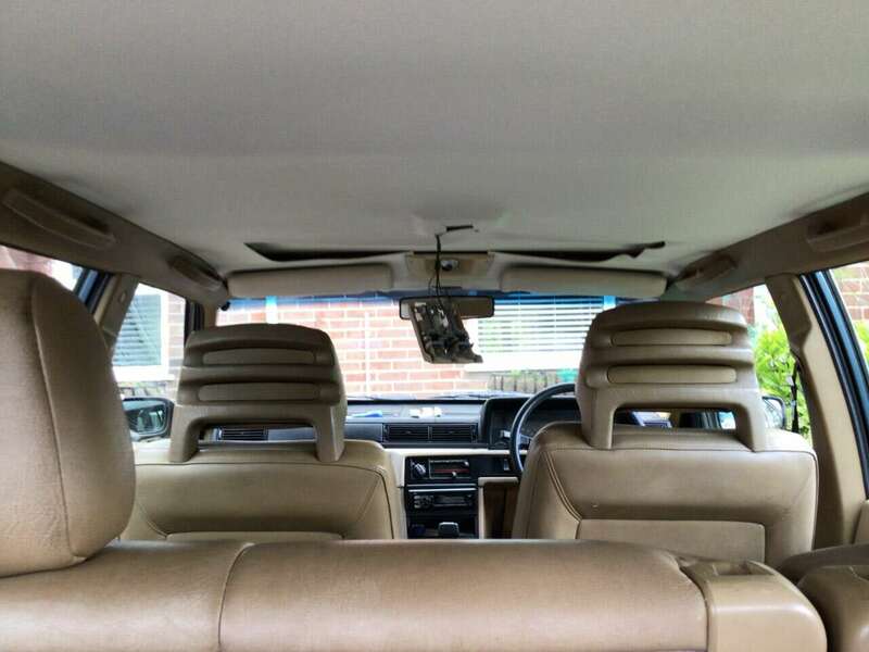

Now I can refit the main headlining board.
  • Like 8
Still dodging the showers and getting this done, albeit slowly!
Main headliner board is back in the car. All the roof edge plastic trims are back in to hold it. Rear view mirror, sun visors etc back in too.
Just having trouble now with the big plastic trim that goes at the end of the headlining in the roof above the tailgate.
The plastic trim is quite big here and actually covers a big bit of the end of the headlining.
Trouble is, the headlining is now heavier and thicker than it used to be which is pushing the plastic trim off the roof and clips that hold it up.
It’s so bad that the original plastic retainer clips are either popping straight back off or, in some cases the plastic they’re made of has become so brittle they’re shattering under the force of the headline pushing against them.
To help I’ve added two screws and penny washers up into the rear roof crossmember box to pull the headlining up and take a bit of the pressure off the plastic bits. It’s still not enough though!
So, plan B is to do what Volvo should have done and not make the retainer clips out of the worlds most brittle plastic and I’m making replacement clips, as close as I can, out of nuts and penny washers welded together!
These are a few of the destroyed plastic ones!
Hopefully this will hold the twat up!🤬
Several other bits of plastic trim (predictably!) have suffered broken clips etc so have either had to be replaced or glued in the hope it’ll fix them.
Volvo’s materials choices with these interiors were absolutely terrible though! Whatever plastic they chose to make the interior bits from is utterly utterly shit. It’s not helped with the sun/heat/old age but they just crack and shatter so easily. I don’t think there’s a single piece of trim in this car now with the correct amount of fixings or clips left. Nothings loose or rattling but it’s so annoying.
It’s looking pretty good though imho. Last job will be to tuck the excess fabric in the sunroof hole up around the metal edge of the sunroof, trim it to final size and push the edge protector/retainer trim on.

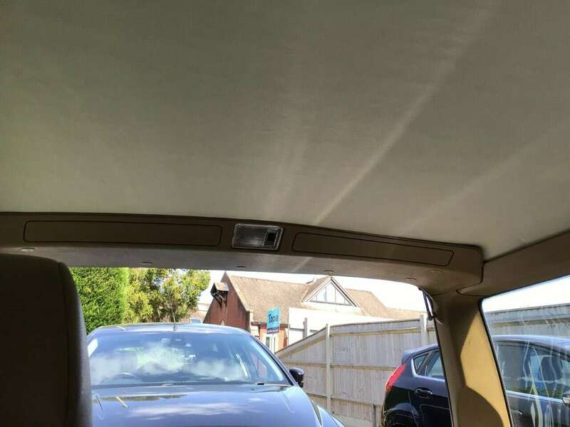

Another day and it’s a step closer to completion!
I managed to get the plastic section of trim above the tailgate opening to fit properly. The headlining back board was responsible for it not fitting properly before. Possibly a combination of the board getting wet and it being out of the car now for some weeks made the rear end of it lose its shape so then it was pushed against the plastic trim panel and forcing it off. It’s been pushed back to shape and held with double sided carpet tape now (all fits conveniently under the plastic trim panel when done!) and the panel is now back in.
Even this was a pig though, behind the tailgate courtesy light unit in this big plastic trim is a metal cross member in the cars roof. To fit the trim there’s a square hole in the cross member which has a plastic clip pushed into it, then a big plastic peg basically fits through the roof trim and into this clip to hold it tight.
Naturally the peg snapped off! I got a replacement and then when fitting that the square clip also snapped! By now this was really pissing me off so I ripped it all out and had a think about how to replace all this shit plastic rubbish with something actually fit for purpose.
Problem was, the cross member is solid and inaccessible so you can’t use a nut & bolt. Cable ties would have worked but you can’t get it to go through the hole and back around again because it’s all enclosed.
Then I had a brain fart!
I bought one of these a while ago for a job on the Capri…
A riv-nut tool!
It basically acts similar to a rivet does but it inserts a threaded tube into whatever you fit it to so gives you a captive nut. Ideal for inaccessible places like enclosed cross members etc.
Once one of these was fitted into the old square clip hole it was solid and could take a bolt & washer. Which worked perfectly. So well in fact, one wonders wtf Volvo were pissing about at with these shit plastic clips!

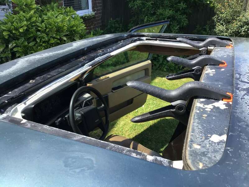

Next job was to fit the headlining material around the sunroof opening ready for the edge trim that goes over that. Simple matter of gluing it and trimming carefully around the sunroof rim.
The clamps are because I used some leftover contact adhesive squeezed into the gap between the roof and headlining back board. I just used it up tbh but figured it’d at least help take some of the weight off the material at the centre.
While that’s drying I’ve scraped off any rusty flaky crap off the inside edge of the sunroof surround and painted it with some rust converter. Might at least help slow things down if nothing else. It’ll need doing properly really but since the roof desperately needs repainting I’ll worry about it then.

Headlining is now finished! At long last!
Centre courtesy/dome light is now refitted and everything has had a hoover down to get rid of the remaining old foam dust. It’s looking pretty good in there now.
The whole interior has been hoovered out and given a good wash with a bucket of soapy warm water and cream cleaner. Just needs some cockpit shine buffing on now to shine it up again.
It’s not perfect and it’s not absolutely the same as original but it’s 100% better than it used to be and looks so much nicer inside the car now. Plus, the sunroof is now fixed too so it shouldn’t happen again!

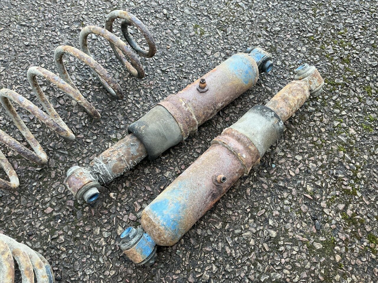

Old parts.
The springs themselves aren’t actually too bad but you can’t use them with standard shocks as they’re considerably softer to allow the air shocks to move them up & down. The new uprated heavy duty springs are much thicker, and I doubt those air shocks could ever move them. Even trying to compress the new ones a bit by hand is difficult!
The shocks though are finished.
Im 99% sure that’s where I was losing the air pressure, somewhere. I did try testing the gauge and air lines with some soap ages ago to see if any bubbles came out from a leak but all that was ok. I think the leak(s) are internal from worn seals or something inside the shocks. Either way, they’re quite well worn and rusted, and they don’t seem to have a great deal of resistance anymore like a shock should, so the scrap man can take them.
