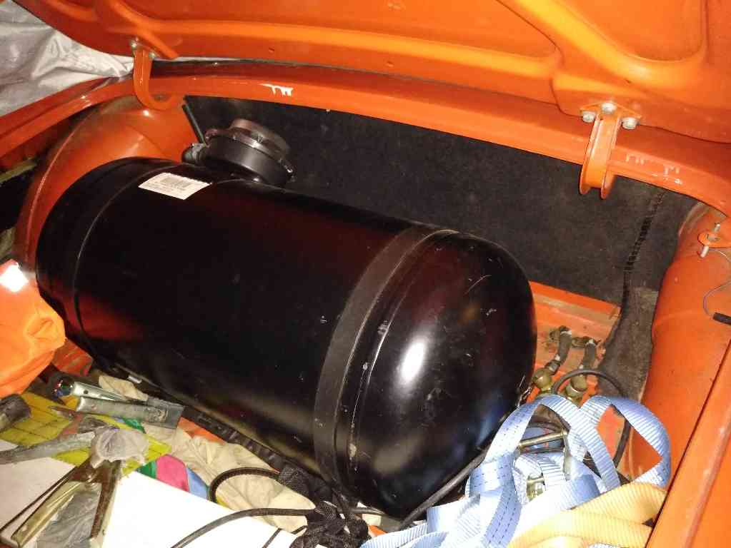

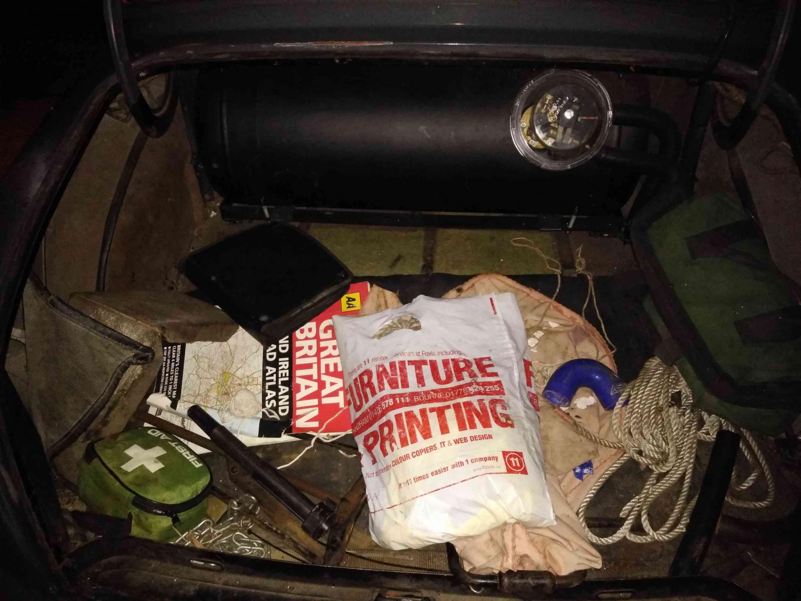

Agreed on tank location. The Rover has a lousy design of boot whose floor slopes towards the back so that everything tries to fall out. It's hard to spoil it, and I got a nice big tank squeezed up at the front. I did a quick photo, couldn't be arsed to clear it out.
Normally MGBs keep their spare wheel in the boot, and substituting it with a tank you actually get more usuable space. Which I've filled with rubbish.
The Petrol pump can now live on the boot floor protected by the tank instead of the stupid factory location hanging out under the wheel arch where it used to get covered in shit. Ironic really as it's now very rarely used.
