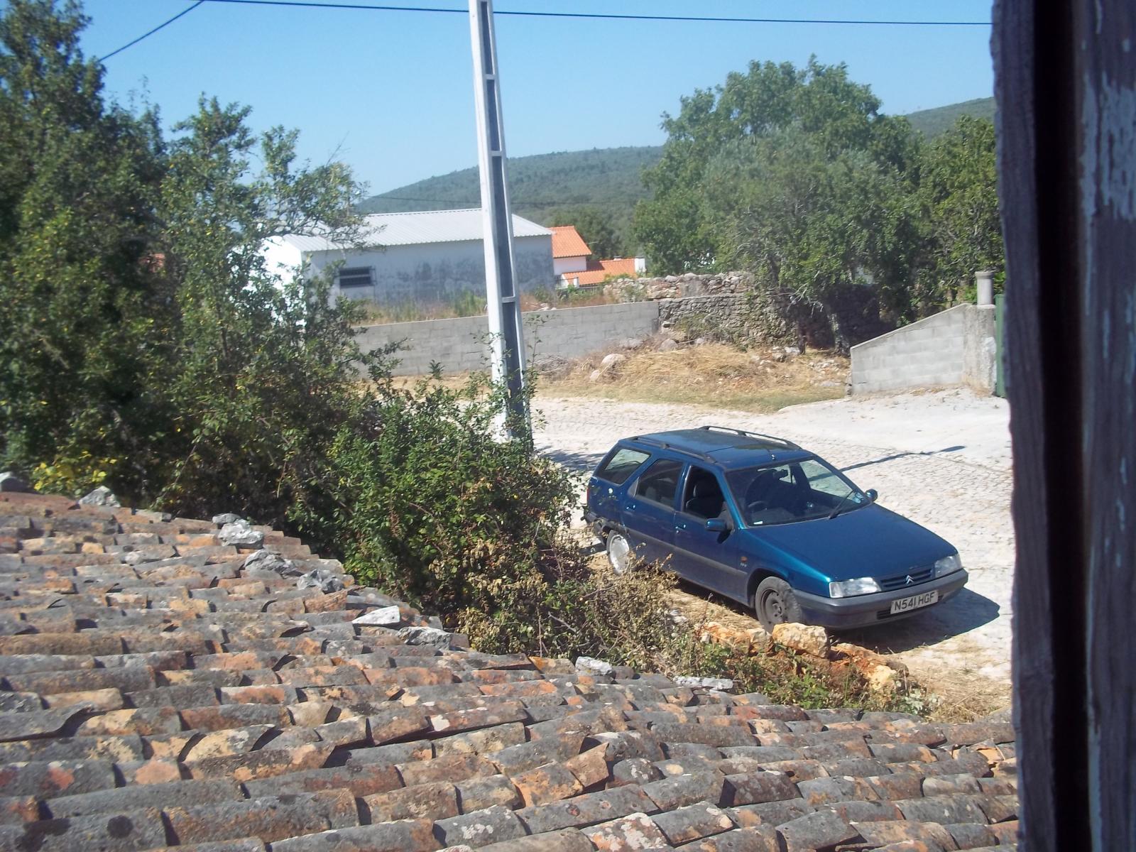

ZX 1.9D na estate, one of the most comfy relaxed long-distance load carriers, here's one I fitted a new starter/cam belt/water pump/tensioner and  drove UK/Frogland/Espain/Portugal with a cement mixer in the back.  NOW returned to Blighty and available in Surrey for £100. With towbar - no radio and interestingly modified glovebox.
My experience of them is they get you to where you need to go in comfort, with rarely any drama. Ideal backup fleet member!
