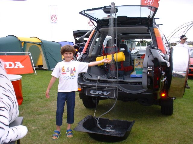

Iirc some of the mark1 trim levels came with fridges in the boot as an option/standard.
If you were really lucky, you might have got the shower attachment too :)
clever use of the spare wheel tray but surely showering in your own dirty water makes no sense at all ?
What like a rover 75.
I hope not!!!!!!!!!!
