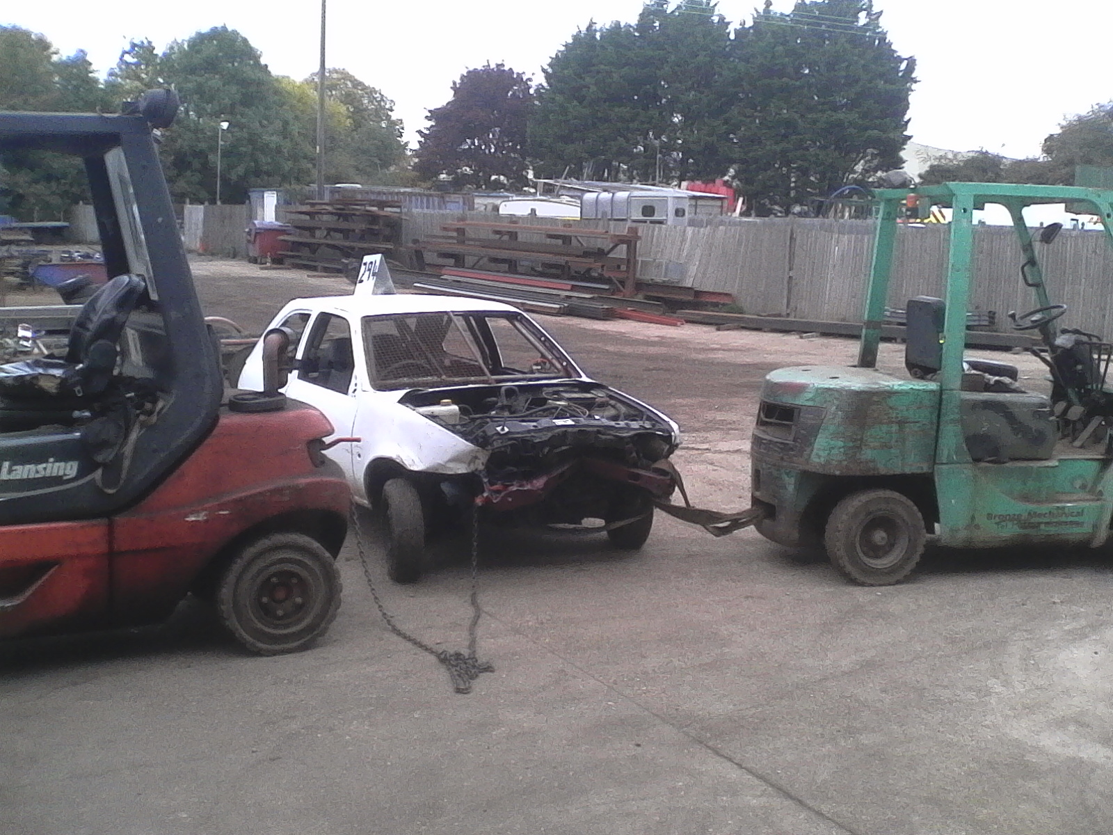

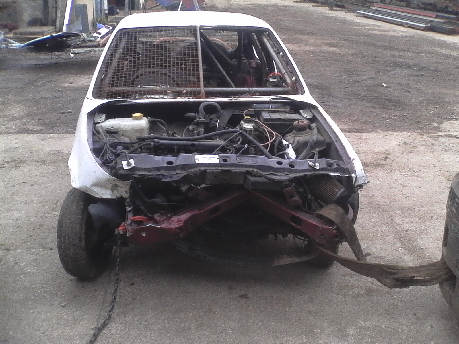

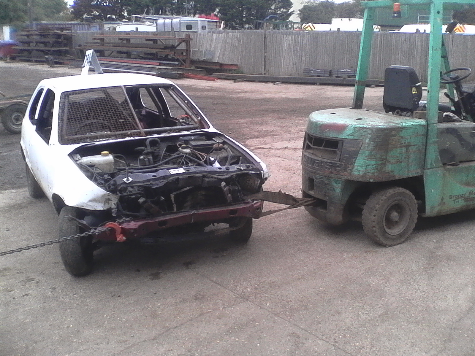

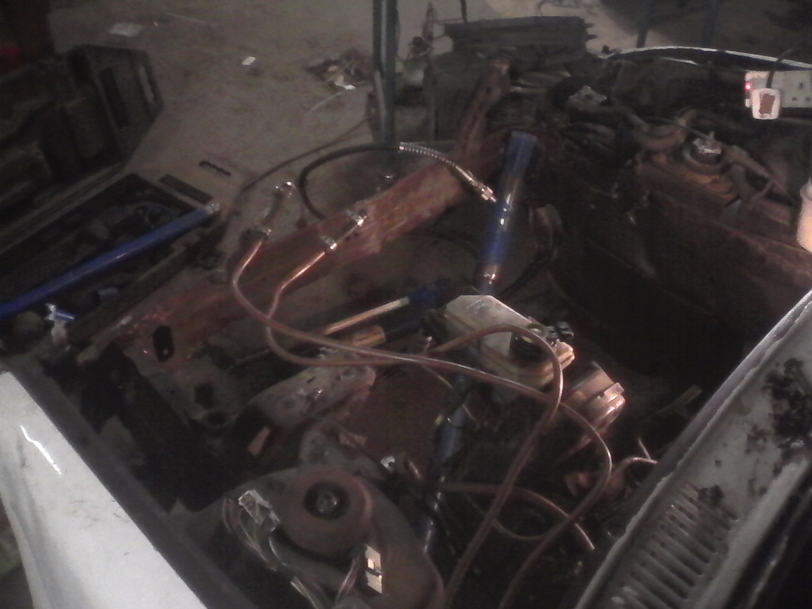

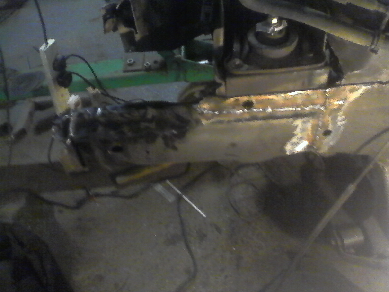

This thing is well caged, so plenty of good points to work from.
sadly i still needed a portapower
and a chassis leg
and an engine  :blink:  :D

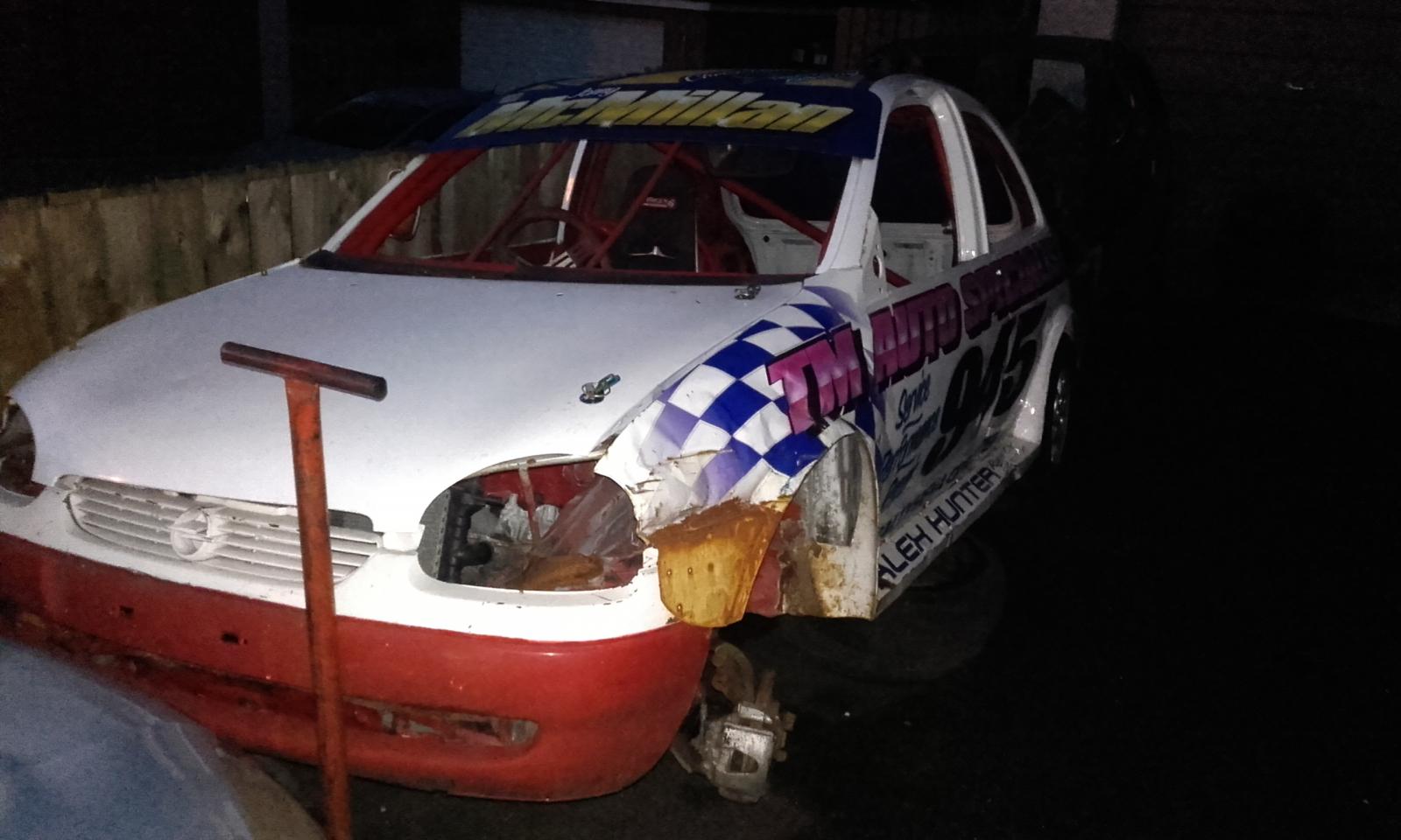

Damage to drivers side. I'll get better pics. Any of you lot got a carb for an sr nova?
