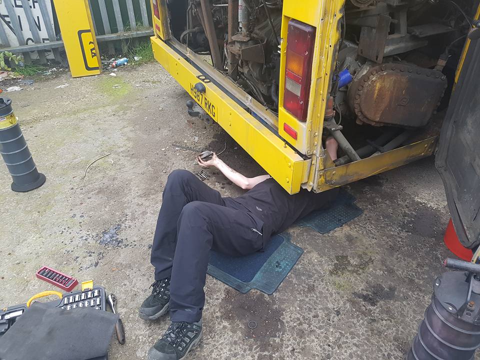

Gearbox oil filter on a ZF 4HP500. Mostly because the sump plug has corroded and I had to tip 17 litres of oil out the filter housing (seen in hand) by loosening the 4 bolts and letting it dribble out.
Note: ATF Dex II makes not for good shampoo
