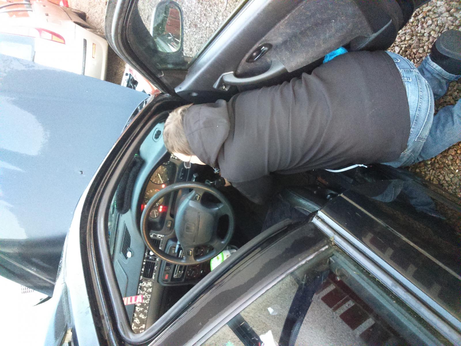

While that was happening we decided to get to cleaning the inside, so acquired a pack of baby wipes from my mum's Punto. The half leather seats had started to get surface mold, as well as the dash & steering wheel. For the record, the seats are ones I fitted from a VTi.

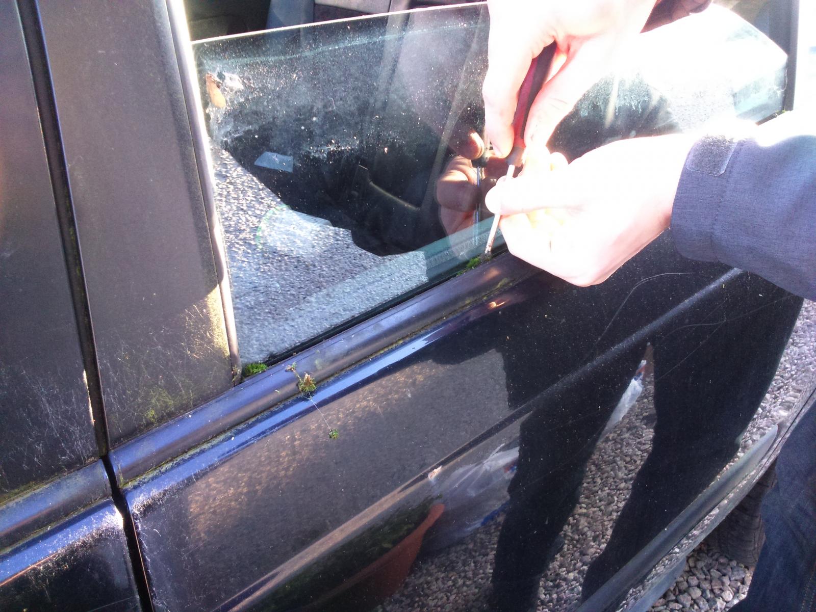

After that It was removing the jungle that had formed in the gab between the windows & seals on the side windows. It seem's to be a common Problem on the M-Series Civic's.
When working with on something as delicate as glass, It's always best to use something that won't damage it...so a screwdriver is the idle specialist choice of tool.

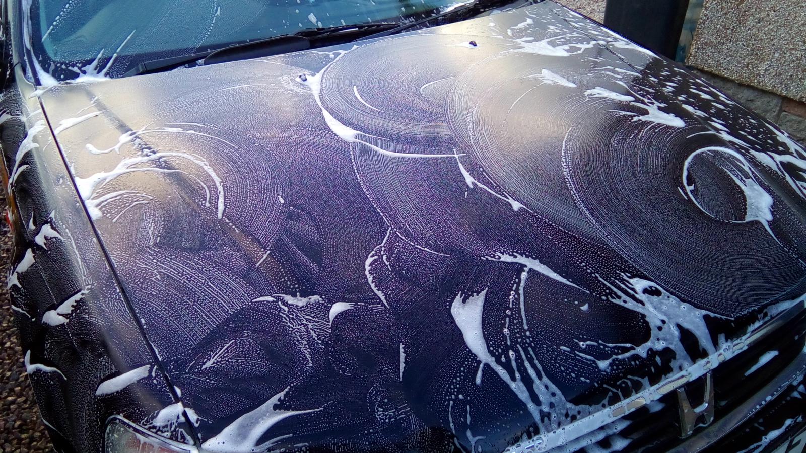

With that out the way, it was time to give the car a proper wash, so I got the hose pipe out...
Properly* cleaned.

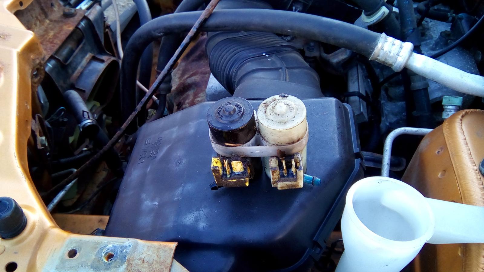

Turned out attention to doing the basic MOT checks, so lights, etc. All was fine until we tested the screen wash...which never worked. Not a case of topping up the water, as no sound from the pump. Oh Cock.
Cheeked the screen wash anyway, only to be greeted by black sludge. Double Oh Cock
So decided to jam the hose pipe into the screen wash reservoir and flush it out, which worked fine but sadly there was still the matter of the washer pump. A quick check of the fuse lead us to think It could be that (although okay, did look a bit off/burnt)

Once done, we changed the fuse for the screen wash only to find out what we suspected, the pump must be borked. A quick look online and we found it its rather easy to access and also cheap to buy.

If the bottle was full of gunk you might find the pump works after flushing it out.
This uses a separate pump for the front and rear. If we were to remove the rear pump we'd be left with a hole in the screenwash reservoir.
I'll take contact cleaner and wire brush along, and we can at least take the motor out, flush the reservoir, and clean up the contacts.
Just swap the pipes and tell the tester to use the rear switch. The pump will be buggered, they always are on post 1986 cars.
That's an idea!
However, not sure about the health of the rear pump either...
Yeah, either swap front and rear pumps, or the pipes, or the wiring and pipes.
It only has to wash the front screen, it doesn't have to be the control it left the factory with to do so. You've got a working pump and a switch so just make it up :-)

I managed to retrieve a pair of pumps from a Honda HR-V for the princely sum of £5.
I had to do this to it to get to them though...
They were mounted on the back edge of the washer reservoir, which is inside the front wing. At least on the Civic the reservoir is in front of the wheel arch, and all you need to do is pull away the arch liner to get to it.

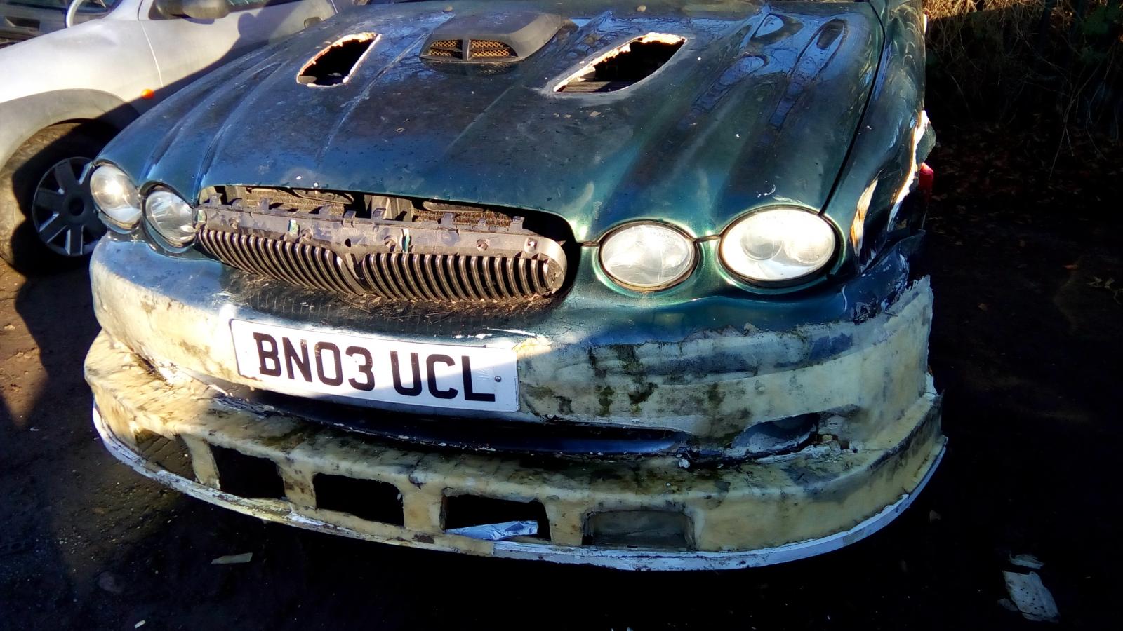

While I wait for 17-Coffees to come pick me up, here are some photos of a barried X-type for you to enjoy*.
SCRAP IT.
Oh wait, they did. Good result! That's horrible, utterly rancid.
Jeesus, that X-type! Looks like they've tried to fashion side skirts from actual pvc guttering.
Jesus wept. What an abomination...
That X-type is special, shall we all cub together & buy the bodykit for BV72?

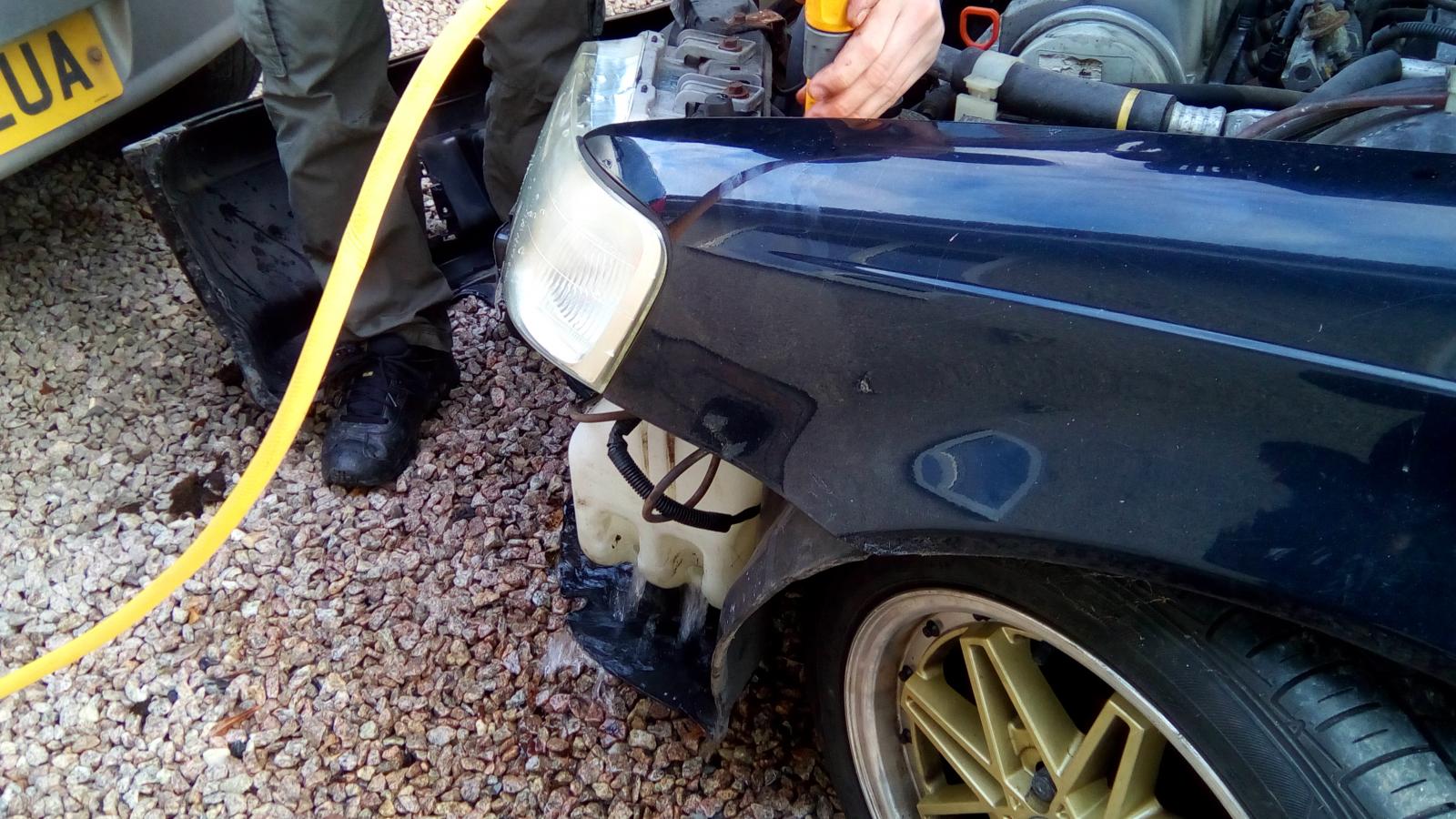

We decided to fit the pumps from the HR-V, and to do this we first needed to remove the front bumper.
Then, we had to remove the old pumps and flush out the washer fluid reservoir.
Once the replacement washer jet pumps were fitted, we re-fitted the bumper really professionally* (the other fasteners are still in place, but that one was missing to start with).

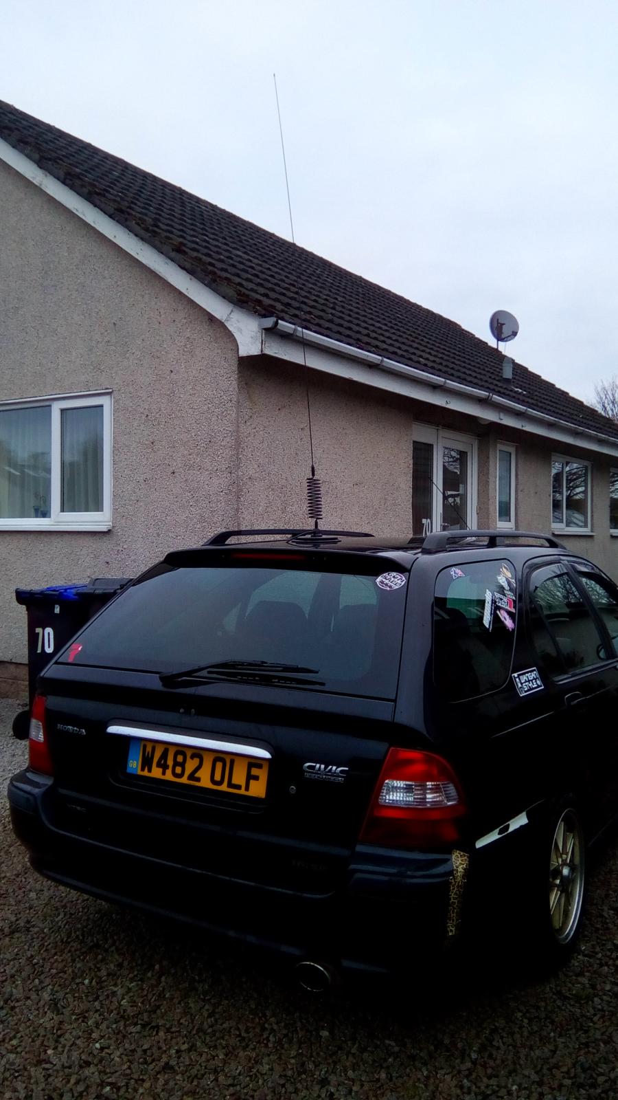

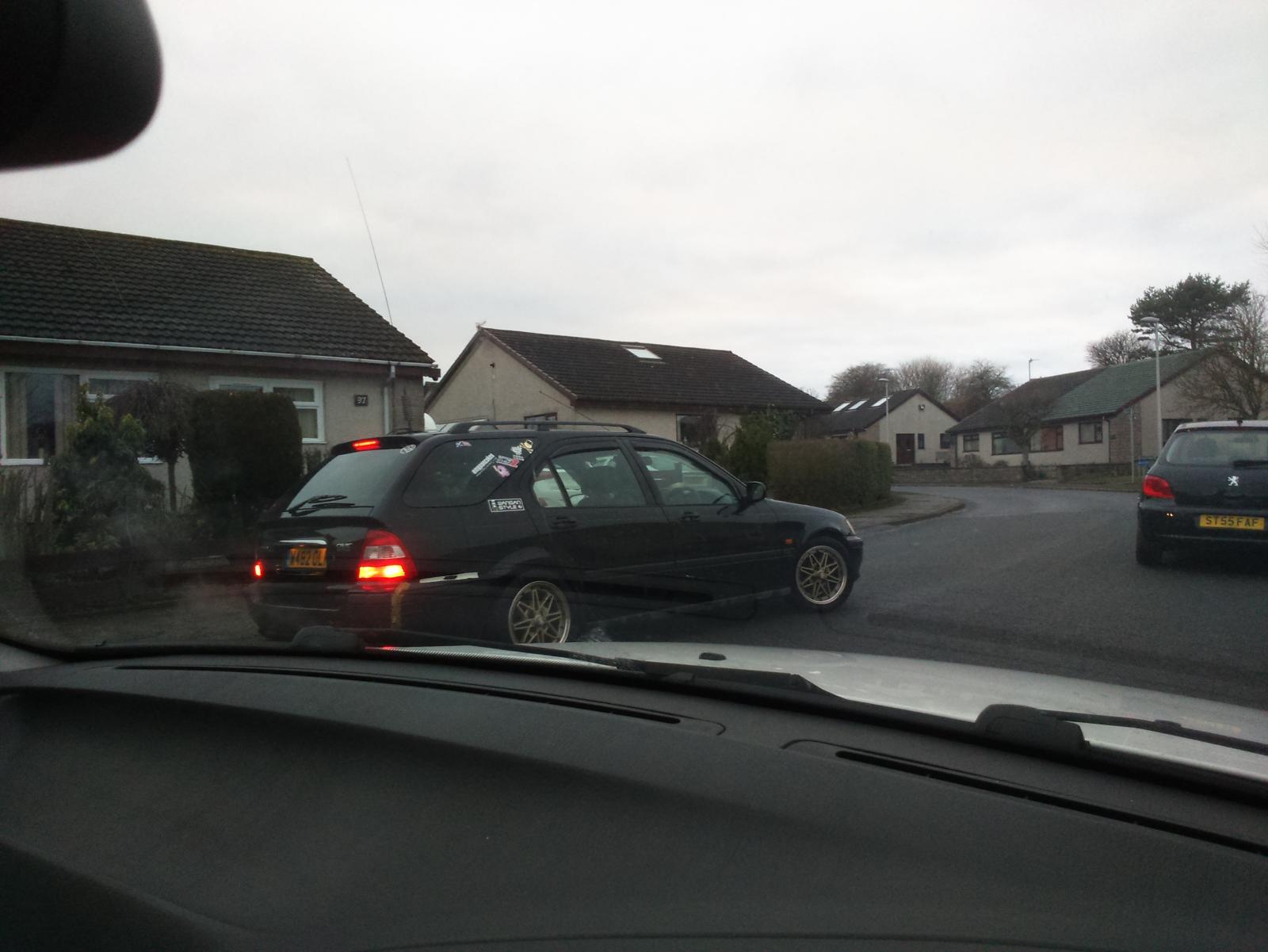

Then, I slapped the CB kit on haphazardly and we set off to the garage!
It was about a 20 mile drive to my friendly local garage of choice. Verdict? MEGA FUN! It responds very well to having the arse thrashed out of it. I left 17-Coffees for dead a couple of times, as he was in the BMW 316. It goes from 30mph to 80mph in 3rd gear very nicely. The Civic needs an alignment though, as the steering wheel is somewhat off-centre when heading straight ahead, and I think the rear coilovers need turned down. We had the fronts set to full soft, but the rears were probably mid-way. This meant it felt like an unladen pickup truck to drive. By fuck, does it handle though! I really want it to get an MOT without too much pain. I reckon it'll need the new cat fitted (sitting in the boot) and maaaaybe a track rod end or something silly and minor like that.

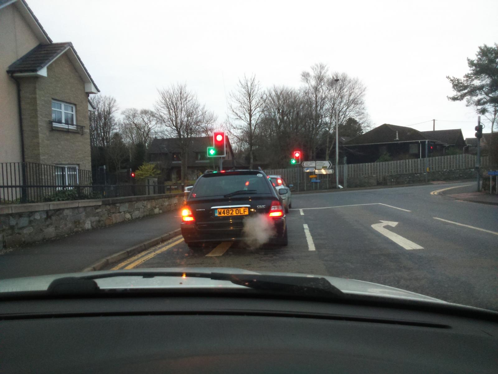

A mile down the road, note the smoke. Could really smell the car still...

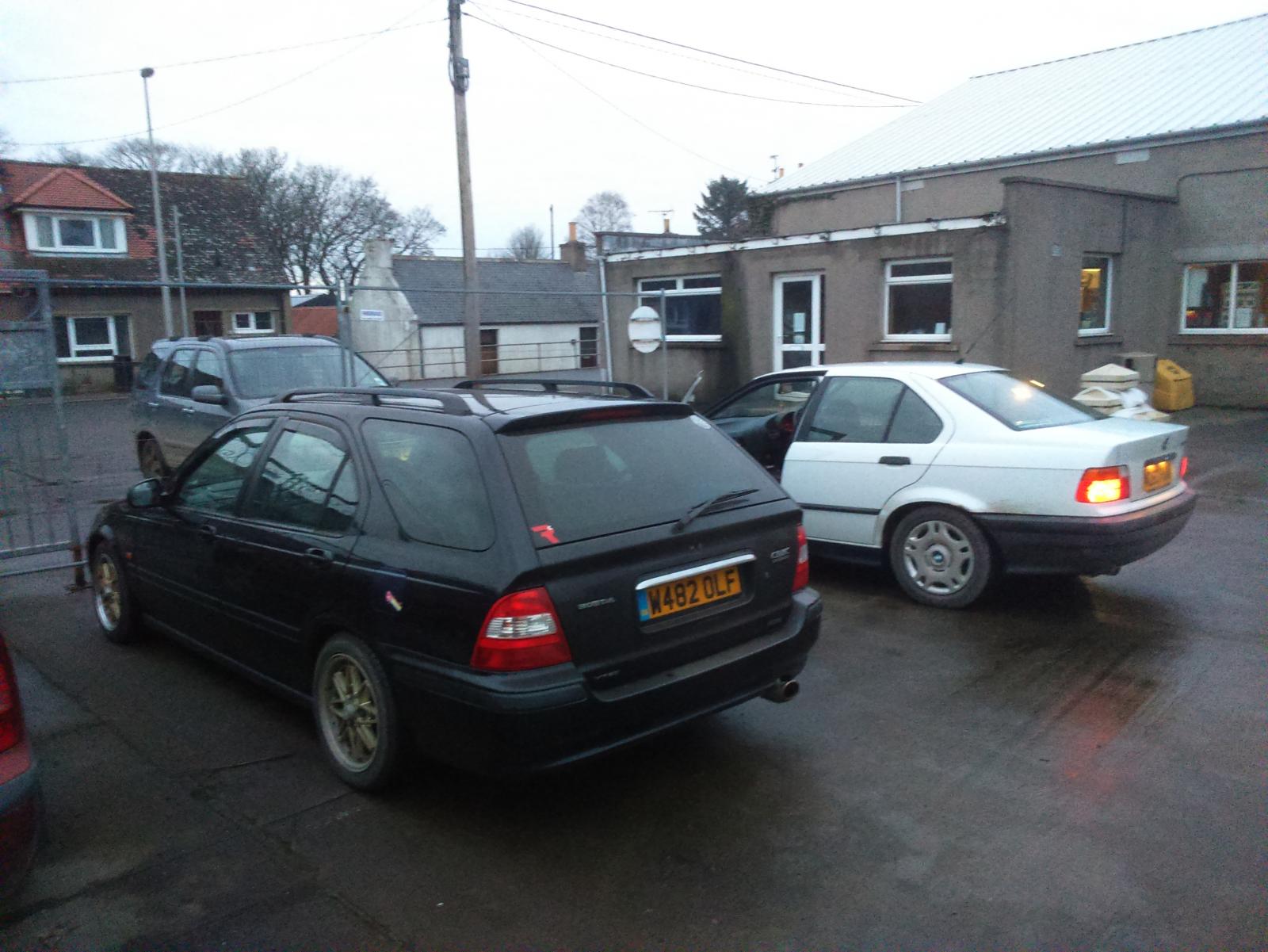

At the MOT garage!
Part of me will be really pissed off it it passes the MOT first time, and another part of me amazed.
Here's hoping.  8)
