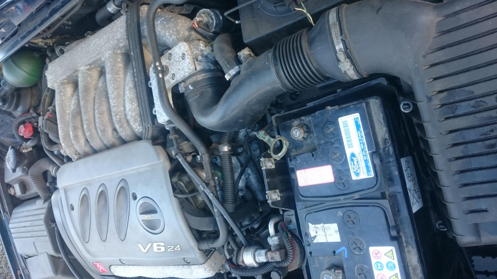

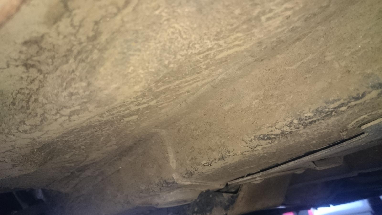

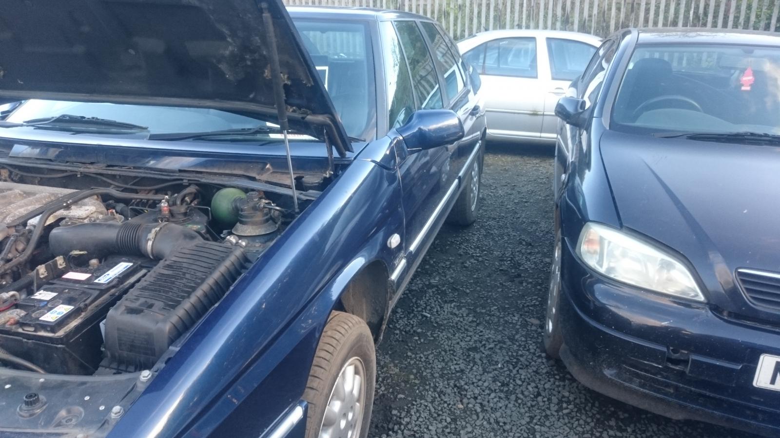

dome Posted September 16, 2016 Posted September 16, 2016 Your Northern correspondent checking in. First, a qualifier. I tend to buy cars on judgement and cursory glances. With varying success. The thought of using my hit and miss approach for someone else is quite daunting I went to the location which was a scrapyard. They had rescued the car from a judge and felt that it was too good to scrap so they are trying to punt it on-this seems genuine. The yard was quite interesting and I wasn't at all eyeing up the E32 735iSE they are also trying to save. In general it looked like it had been looked after in a previous life and then stored for a long time. It was sitting in the yard blocked in (apparently thieves will take anything not secured and they were about to close) so I couldn't do more than move it back and forth. It fired up although the battery clamp is borked and sounded healthy. A little white smoke from it. Coolant seemed OK from the very brief glance. Oil (dipstick at the front of the bay) was fine and honey coloured. Under the oil cap was clean. It raised up to its normal height OK and when I set it on high it seemed fine. No sign of any leaks underneath. I only lowered it down after I switched it off and the front went down quite quickly but not the back. Still no leaks apart from water from the sill/doors with the car sitting at an angle. The photo of the LHM level was taken with it at full height. The ABS light was on. The guys thought it might have been because it had been towed with the front wheels of the ground. Equally something expensive could be borked... Rust wise-check the pics. Sills seemed OK if a bit crusty around the edges. I tried to take pics of the rear end. I couldn't see anything front end wise My gut feeling? If I was really after one it would be an early diesel and not from a scrapyard then I'd be tempted to take a punt. It could be hiding horrors though. If I was to try and get it MOTd several hundred miles from home however then that would be a different thing entirely... It could be driveable on a short section of road outside the yard, also a viewing of the underneath is possible, however it would be by the medium of a fork lift. The yard guys had said it looks OK from underneath, I only have their word for that.... I'm happy to head back when I have more time-I need a nosy round a scrapyard anyway and it's only 20 minutes from my house. Pictures are below and then I'll take questions from the floor... Cleon-Fonte, Coprolalia, RobT and 7 others 10
beko1987 Posted September 16, 2016 Posted September 16, 2016 oooh those strut tops look a bit crusty... and their pretty unobtanium and take the bonnet out with them the rear not sinking will be the rear height corrector, easily solved. the rust and those strut tops though? you'd have to really want one/fancy a challenge... I look forward to the shitely collection thread!

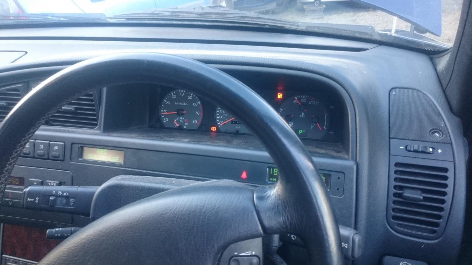

Junkman Posted September 16, 2016 Author Posted September 16, 2016 Hmmmm... It's the strut tops that worry me too.The rest looks actually quite okay. How scary is that ABS light thing?
