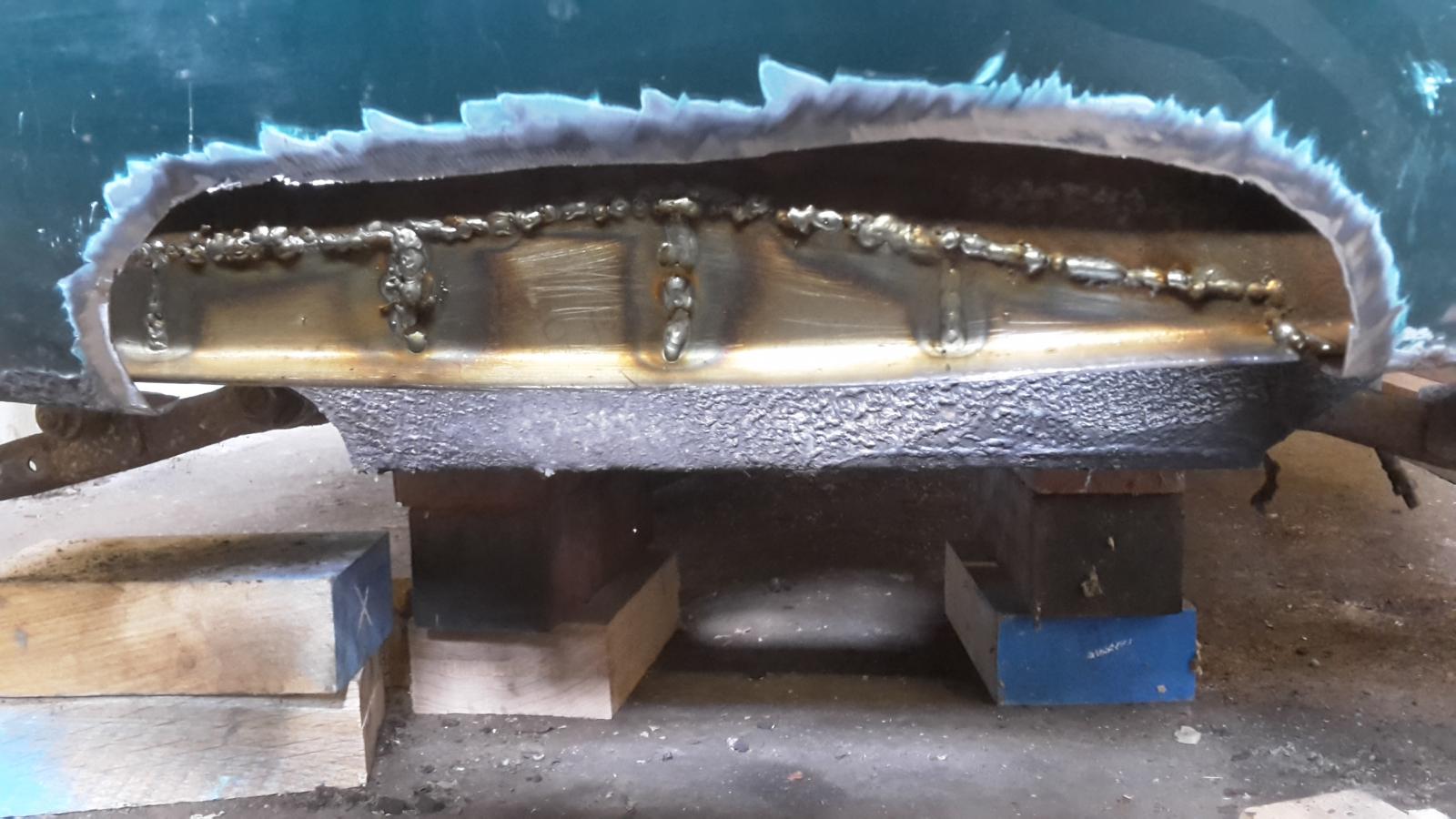

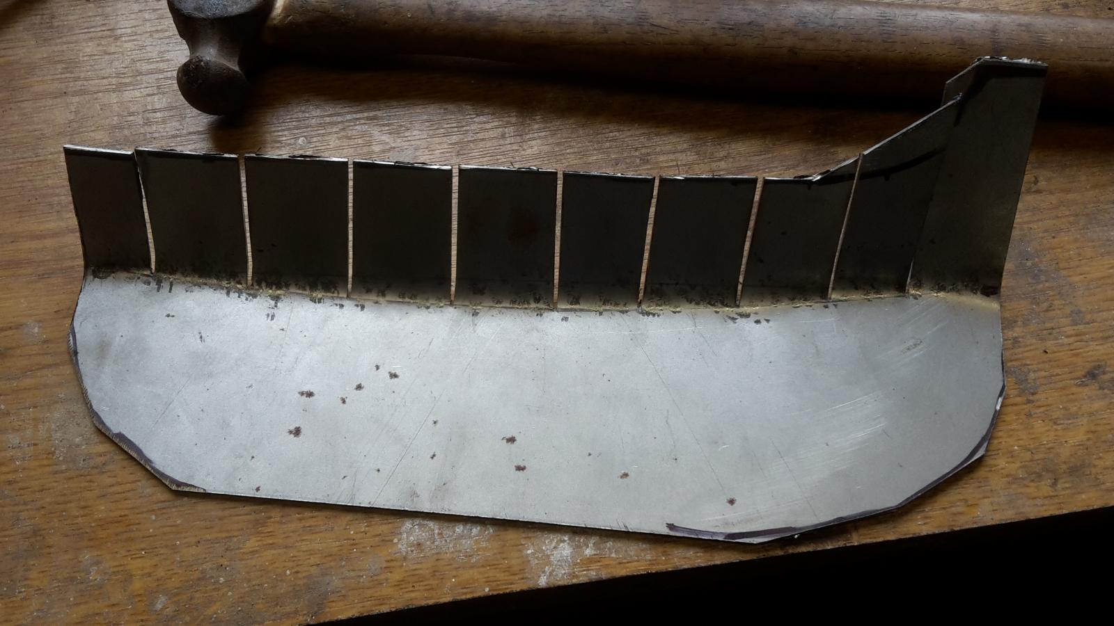

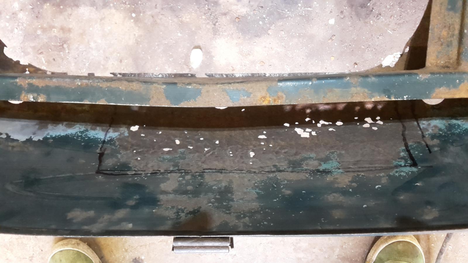

A bit more progress this week; the front valance and section which supports the engine were worse than expected (surprise) so had to be chopped out.

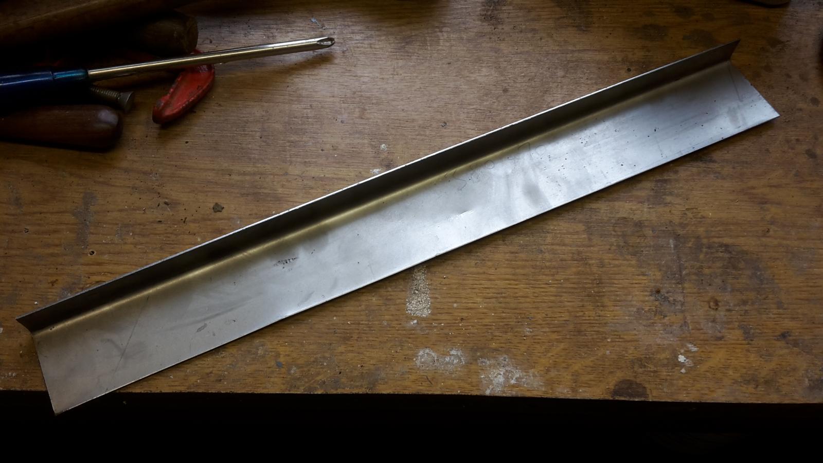

Steel is approx 1.4mm thick, Saab used heavier gauge stuff than most. I have no English wheel or stretching kit so have to make do with pleating stuff to get some curves and using whatever comes to hand in terms of blocks of wood, steel and hammering to get the right profiles. I do have a sheet metal brake which struggles to do the thicker stuff.

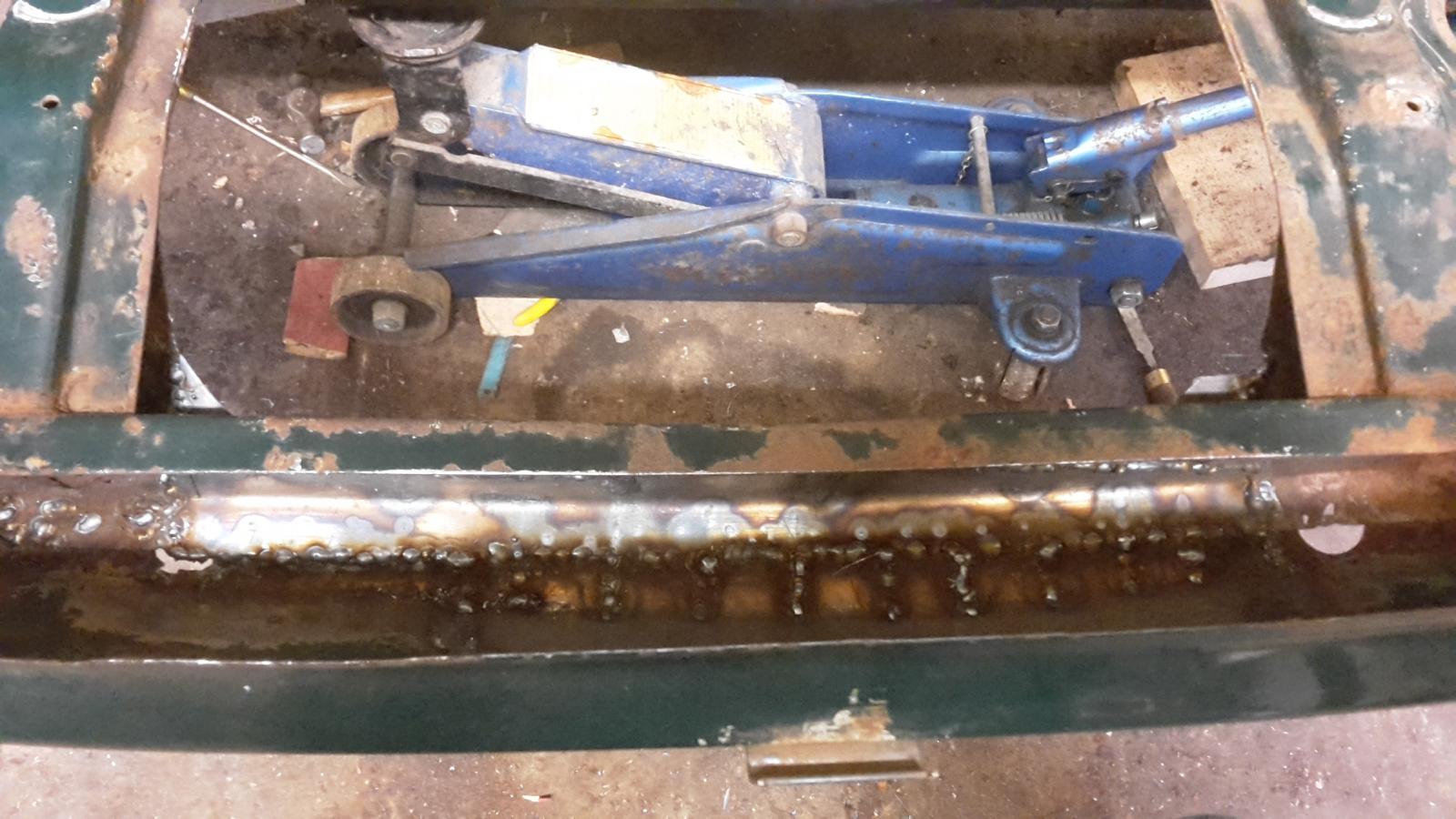

The trolley jack and a block of wood came in handy for pushing the base of the valance into place, I plug welded the individual bits underneath, then seamed the cuts together, a lot of toil but very satisfying.

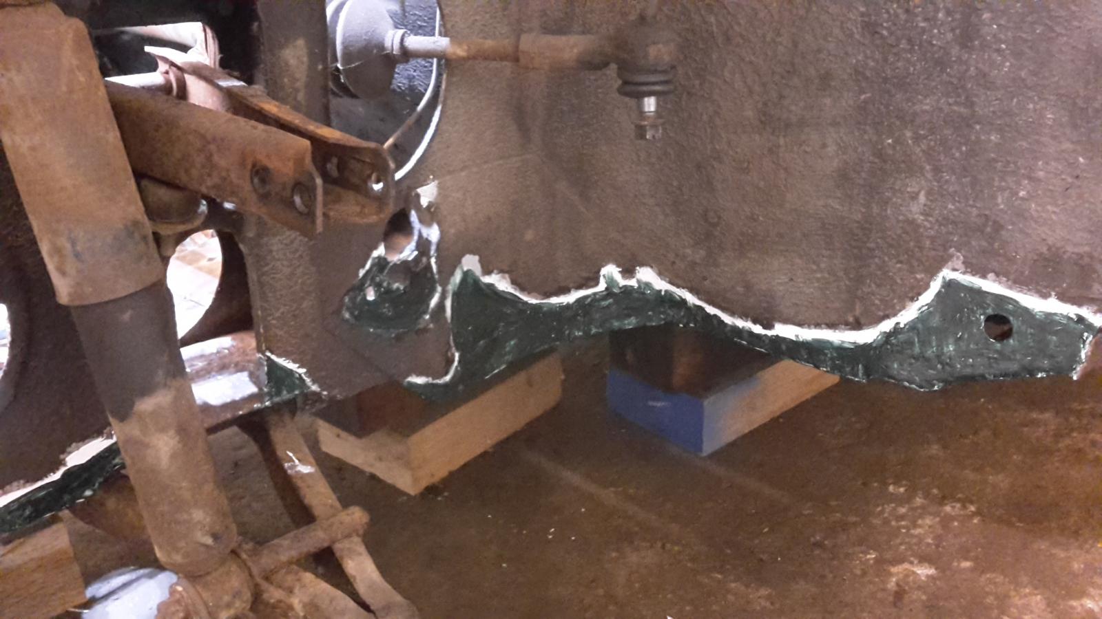

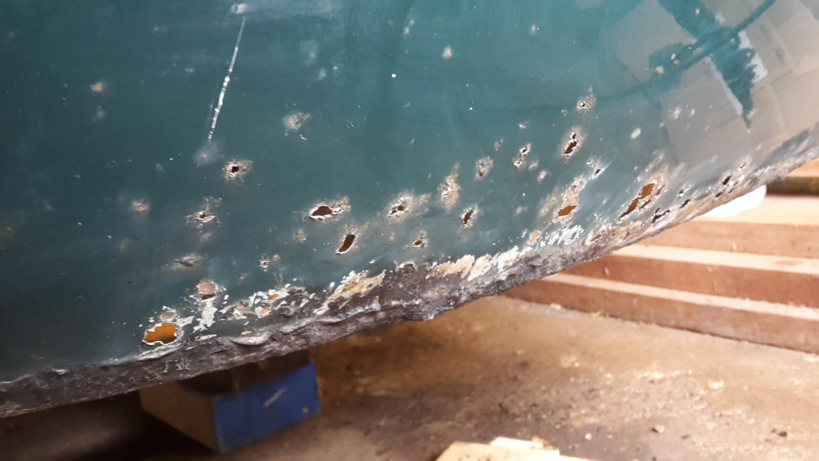

Finally got around to working on the Saab again, made a couple more patches to the base of the inner wings and around front ends of the sills.

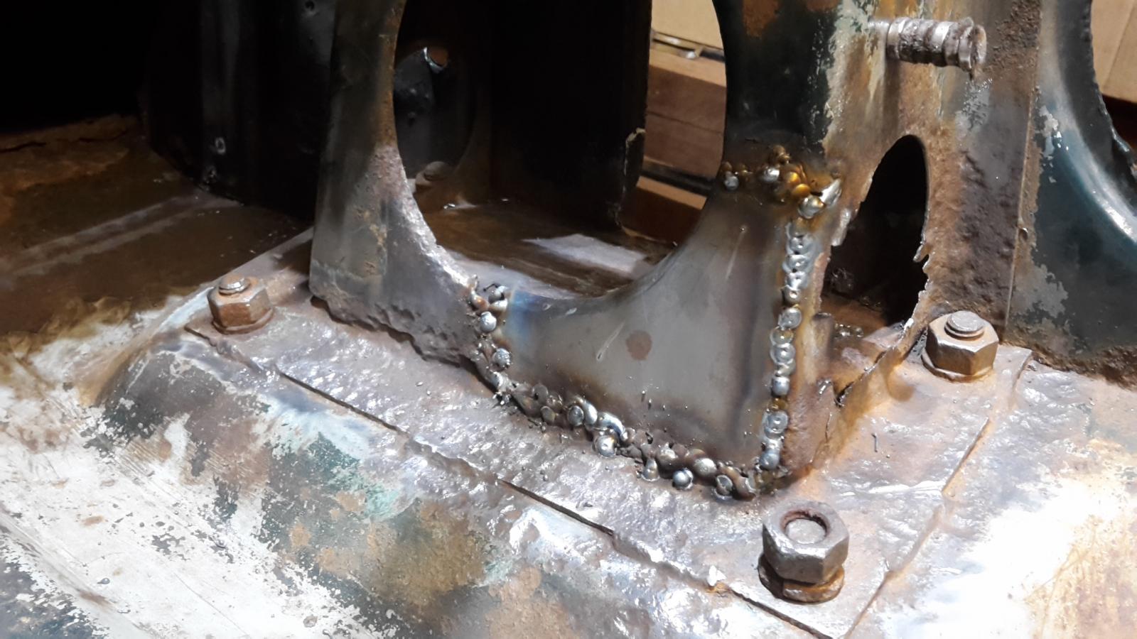

Then got to work on the box which surrounds the nearside front suspension.
The offside is very good but the nearside is heavily pitted and areas rotted out from around the two cutouts. One welded up today, will cut out and replace metal around the second later next week.

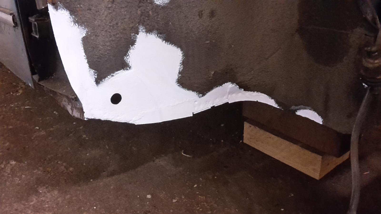

The last* bit of welding done to the engine bay/inner front wings area completed. No work today or tomorrow so time to do a bit on the ugly Swede and fixed the nearside indicator on the W124 which mysteriously ejected itself out of its home orifice on Sunday. A soldering iron and some bits of thermoplastic from a power tool carry case and the tabs were back in place :)
The extra strengthening strap which the suspension bolt passes through is a pretty accurate copy of the other side; shows how 'handmade' these old Saabs were.
I recently found detailed photos of some of the homologation rally cars from the early 70s. I may copy some of the braces they added to them on my car, it's very simple stuff to make and tack on, in fact there was very little required to the Saabs to make them strong enough for rallying.

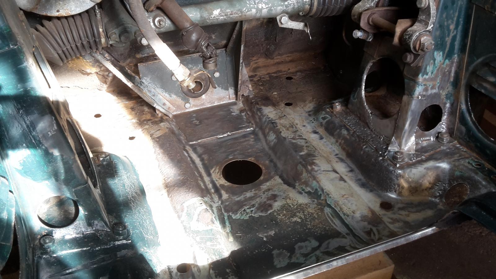

OK, done a couple of hours more today, wire brushed the hell out of the new bits and any rusty areas and then gave the lot a good dousing with some rust remedy, followed by a bloody good clean with some thinners soaked rags.
Finally a couple of coats of high build cellulose primer.
Thankfully there was only surface rust and some pitting at the bottom of the firewall, that's the one really nasty spot where these Saabs rot.
There's a lot of pitting on the floorpan in places which if I can be arsed I'll fill with some bondo tomorrow. Then a couple of coats of seaweed green and it's engine refurb time :D

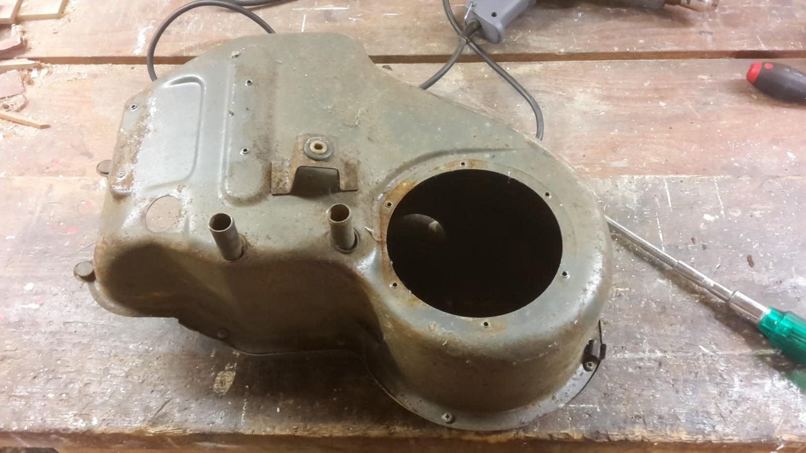

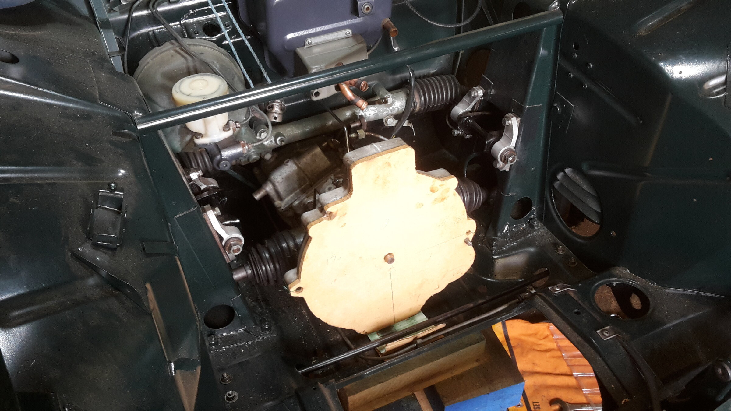

A chunk more work done, to the heater matrix, box and fan.
The steel box was very corroded in places so I welded a couple of patches and stuck the two halves in a water tank for some electrolysis. A few coats of rustoleum sprayed on and a reasonable result, I used the contents of a c1960 can of 'Dum Dum' to seal the two halves.
I love these little Saabs. Can't wait till this is finished.
  • 4 weeks later...

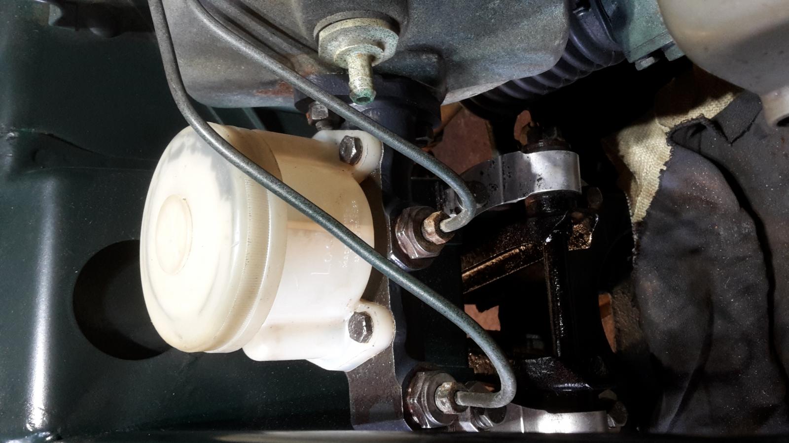

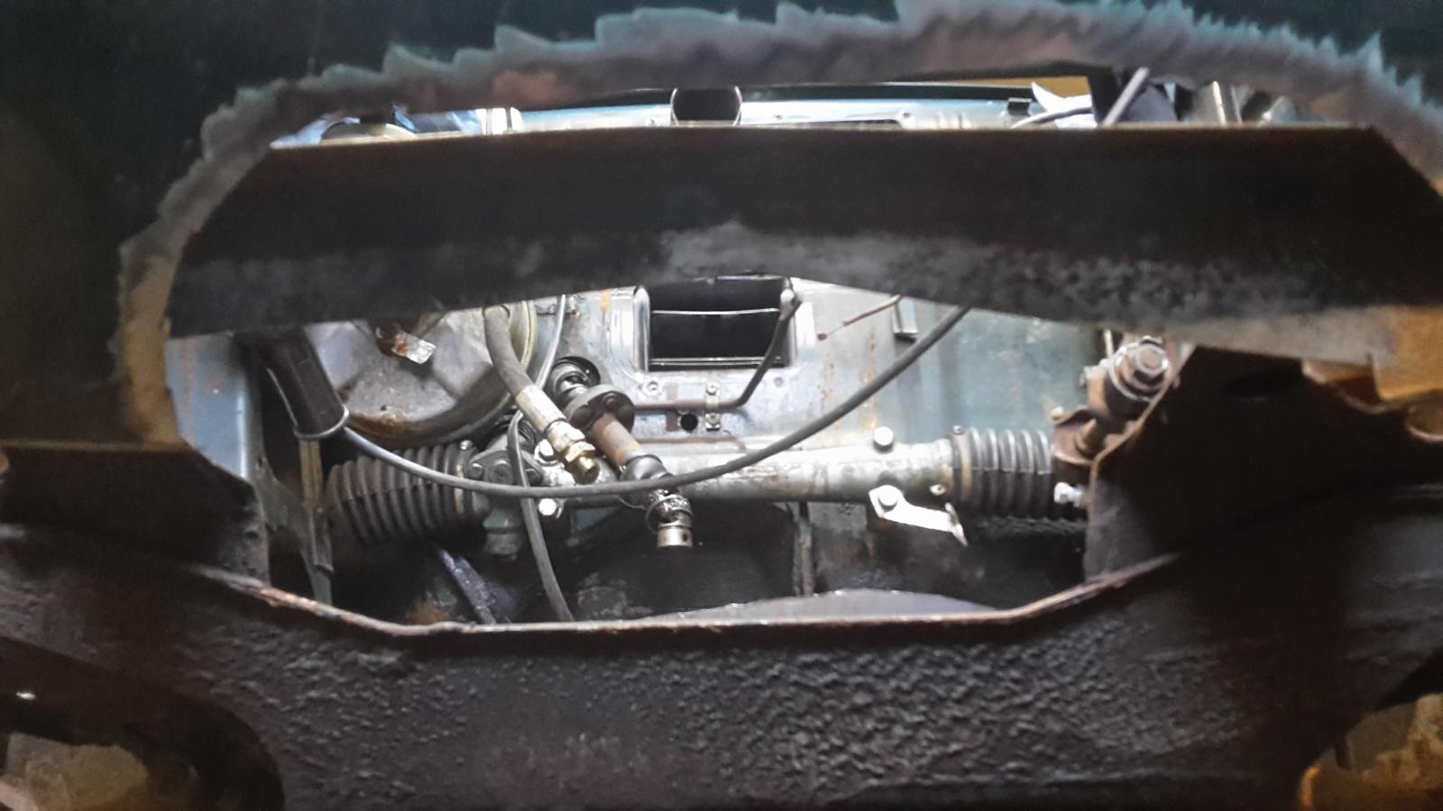

Bit more done yesterday, cleaned up the brake master and replaced and put the heater matrix back in place. Underneath the dash I discovered that the cable going to the blender flap had come off, the reason why there wasn't much hot air reaching the cabin previously.

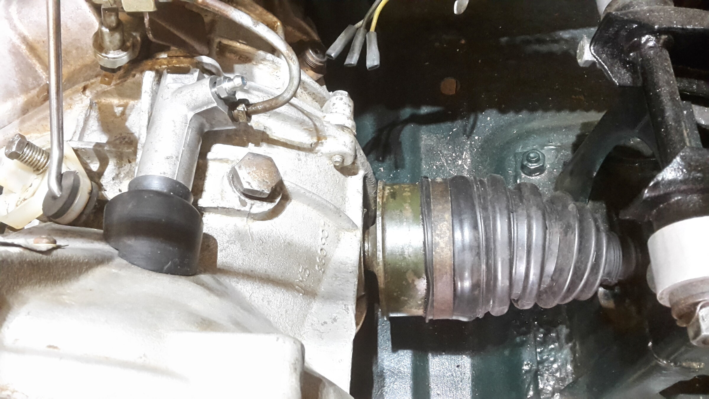

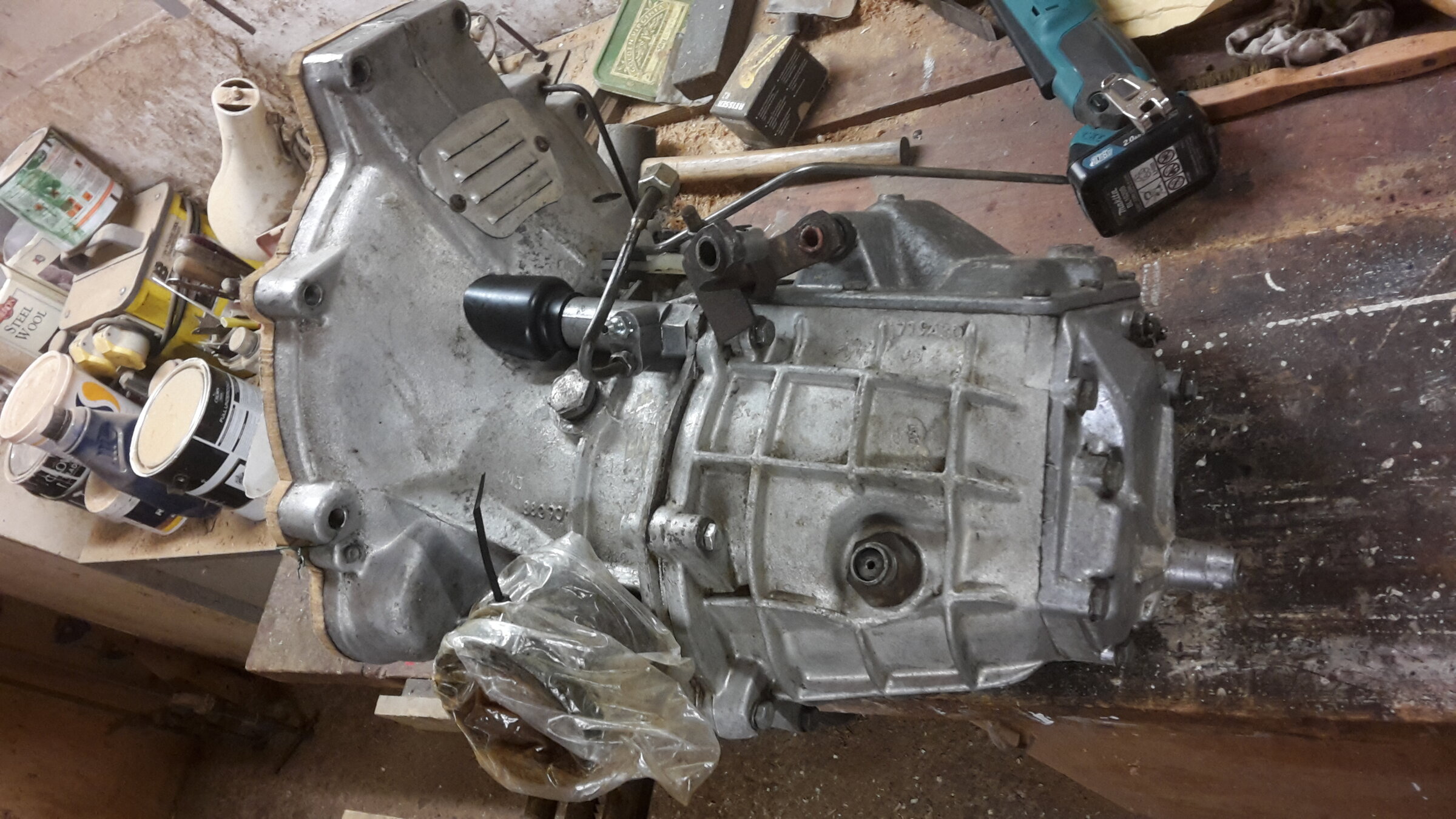

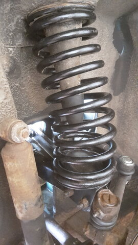

After a hiatus due to overwork I am back at it; done a fair chunk the last couple of days. The gearbox is back in with clutch slave re-bushed. The driveshafts are back in and front suspension and anti roll bar on. I believe I have my car mojo at least partially re-ignited. I'll post some more pics tomorrow.
'Box back in, driveshafts connected, top wishbones and steering arms on. Also got one spring back in situ today; not easy, they're very long, 391mm to be precise and needed to be compressed just about as far as is possible to get them in.
Will get the drivers side spring back in and get front wheels back on. Then it's onto the engine block which I'm now looking forward to immensely.
These gaiters weren't ideal, should stay on with the jubilee clips though.
