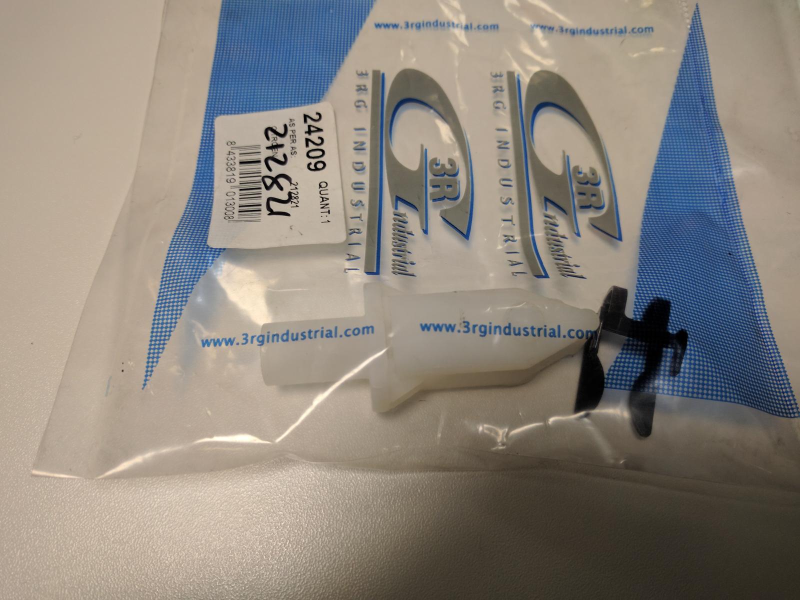

Yes! It even has the metal clip which is good as looking at my old one it looks broken now, it's not as long/big

Place bets on how long it'll last when fitted though, it's not genuine, that will upset alot of the xantia owners group...

If yours has already had a clip at some point in it's life it will come off easily.
