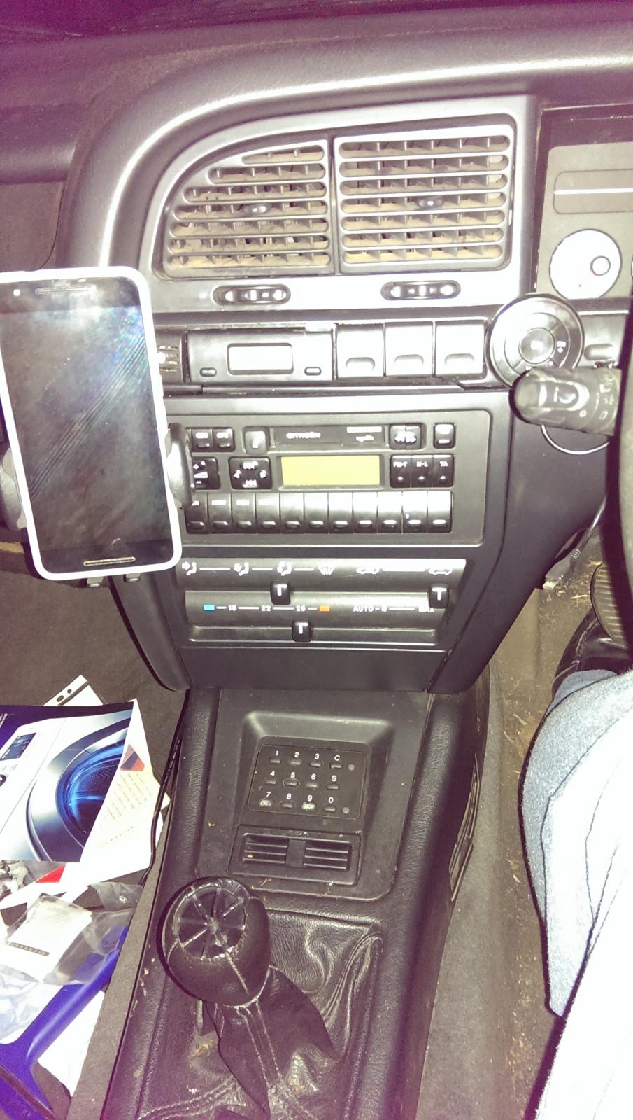

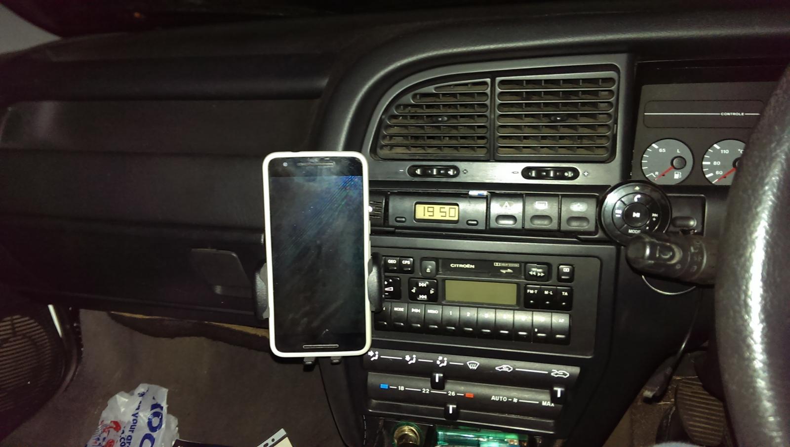

So far so good! Found another thing to take a photo with...
It certainly holds my 6p well, and could go bigger too. The ball joint seems a bit loose with no phone, but seems ok with a phone in. It's at a nice level too, didn't want it high/on the windscreen. So far, based on one journey I would recommend!
Here is the knob top. Bit loathe to glue it back on though as I did that with the zx's one then the whole knob crumbled, I don't want to tempt fate and end up having a knob_car
And here is the ashtray closed just for you vulg!
Probably, their all the same I imaging. Someone on the xantia Facebook group said he has a spare knob as he upgraded his to an s2 leather one, so I've probably got one if I want, although now I kind of want an s2 leather one, and before he mentioned it I was fine with my headless knob!
 my headless knob!
knobs are always better with head
