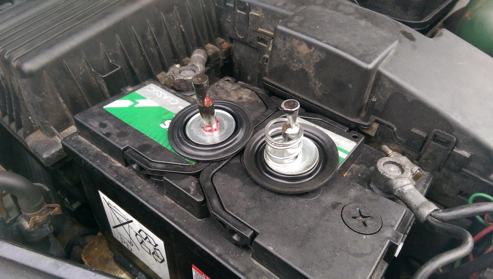

beko1987 Posted December 17, 2016 Author Posted December 17, 2016 Old pin New pin Danny also backed the fuel out alot apparently. And owns a white van with possibly the cleanest interior I've ever seen! oldcars, vulgalour, Coprolalia and 2 others 5
beko1987 Posted December 17, 2016 Author Posted December 17, 2016 Also, went out earlier to get some fuel for tomorrow, and the engine is alot less clattery at idle! Was stone cold too. A good oil change might do it good too. Does the wrong fuel setting make it louder?

Guest Hooli Posted December 18, 2016 Posted December 18, 2016 Bloody hell that is a modded pin, no wonder it had a no turny turny warning attached. beko1987 1
Dick Cheeseburger Posted December 18, 2016 Posted December 18, 2016 Why do people dick around with things that already work well? Buggering around with the pump and fuelling on these is equivalent to painting a decent car in Poundland matt black rattle cans. At least you see to be on the home straight and have managed to undo the Barry. AMC Rebel, jonathan_dyane, oldcars and 1 other 4
beko1987 Posted December 19, 2016 Author Posted December 19, 2016 It is more than a modified pin, it's custom made! I see all your sentiments about the barry, but tbh it was bloody quick! I'm impressed with the power it managed to produce, more so now it hasn't got it and is alot more wafty and slow. The clatter at idle has died down alot too. The fuel pump is still advanced though, but I don't think that's doing much now. I can't say I'll never have a go at flipping the LDA back again next year, although it's alot more frugal now, which given my current financial situation is very handy! Not tested it with a full tank though. The custom pin is sat in the rear footwell still if anyone wants it for a laugh? At least I know I can 'map' it now with a 10mm socket! The LDA it has now is half modified, so one side is ground out a bit, but the other side (the side fitted) is stock. Anyhoo, thanks to someone who I don't know if they want to be mentioned so I won't, a new MOT is booked in for 12.15 tomorrow at a place near to work (as I have no more holiday so can only take an extended lunch break, and will need a morning off to go back to the place in Aylesbury). Possible plus point is to get to the place by home is an 8 mile drive down a road you can do no more than 35mph down due to traffic, to get to this place tomorrow I can tear it down the A404 to warm things up nicely, then come back on myself. May still pull up around the corner and redline it for a few seconds, then go back to hoping. Does accidentally letting a crate of beer fall out of the boot whilst I'm there work? Dick Cheeseburger, oldcars, The Moog and 2 others 5

Lacquer Peel Posted December 19, 2016 Posted December 19, 2016 Why do people dick around with things that already work well? Buggering around with the pump and fuelling on these is equivalent to painting a decent car in Poundland matt black rattle cans. At least you see to be on the home straight and have managed to undo the Barry.It's not 'Barry' to adjust these pumps from their quite tame factory settings to improve driveability, loads of people do it. beko1987 1
Guest Hooli Posted December 19, 2016 Posted December 19, 2016 ^^^ What he said. I tweaked my Disco (same pump) to make it drive better & it improved the MPG.
