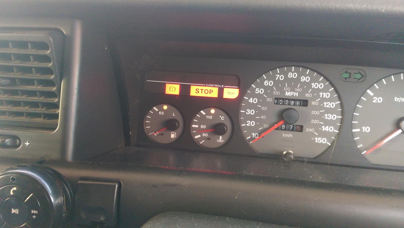

forddeliveryboy Posted December 10, 2016 Posted December 10, 2016 I have not alot of diesel left, the light will come in in maybe 20 miles... would I gain anything by lobbing 20l of veg in? That, combined with removing the air filter and backing the throttle off a bit, would that help at all as a simple fix? Or would the veg smoke more? You haven't a good record with mixing proportions iirc (didn't 2-3% petrol turn into 25-40%?) but 60/40 diesel/veg would defo have a good effect on emissions, I've seen emissions halve even with 30/70 diesel/veg. But the veg was good, well-polished and perfectly dry rapeseed. If things are still that bad you're worried about passing a gas test with an XUD, there's something seriously wrong, mind.
beko1987 Posted December 10, 2016 Author Posted December 10, 2016 no thats true,i have demonstrwted my awful maths skills before on these matters. how much fuel is left when the red light comes on? if I was to add 20l of new veg (or rapeseed if asda have any) to that, what mix would that likely be? i am worried about the smoke test. dont forget my pump is tweaked,and the last 3 owners have all reported narrow passes by friendly testers. my testers are not friendly,but I dont want to go tweaking fuel pump stuff that isnt stock anyway.The visible smoke has reduced, but I want all angles covered! forddeliveryboy 1
forddeliveryboy Posted December 10, 2016 Posted December 10, 2016 Perhaps 10 litres? So if you add 20l of oil, 20 litres of veg in 30 litres of fuel, so two-thirds or 66% veg. Pop in 10 litres of Shell diesel on your way to the test for best results. Since I'm slightly* inebriated, I'll suggest you add 0.15% acetone (99.9% pure) for the ultimate effect. beko1987 1

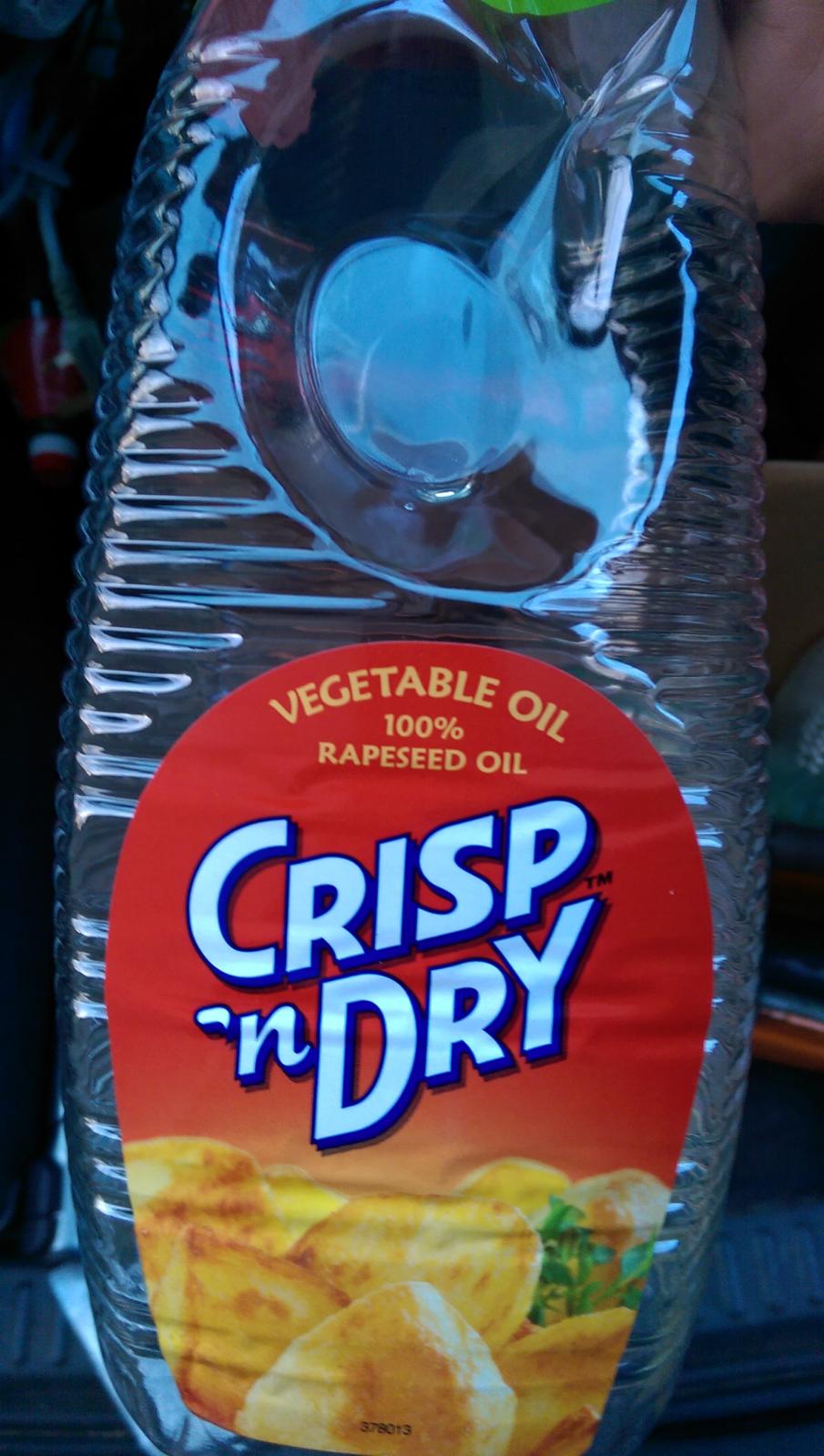

beko1987 Posted December 10, 2016 Author Posted December 10, 2016 Asda have crisp n dry at £1/l,how well does that turn into propulsion?
forddeliveryboy Posted December 10, 2016 Posted December 10, 2016 Apparently it's rapeseed. Like all vegoil, works way better when second hand. But rapeseed is always preferable to genetically-modified soya, whether from the perspective of the poor family turfed off their land farmed for generations pov or when thinking about injector grot. But at £1/litre, I'd be buying diesel instead. Unless for emissions passing purposes.

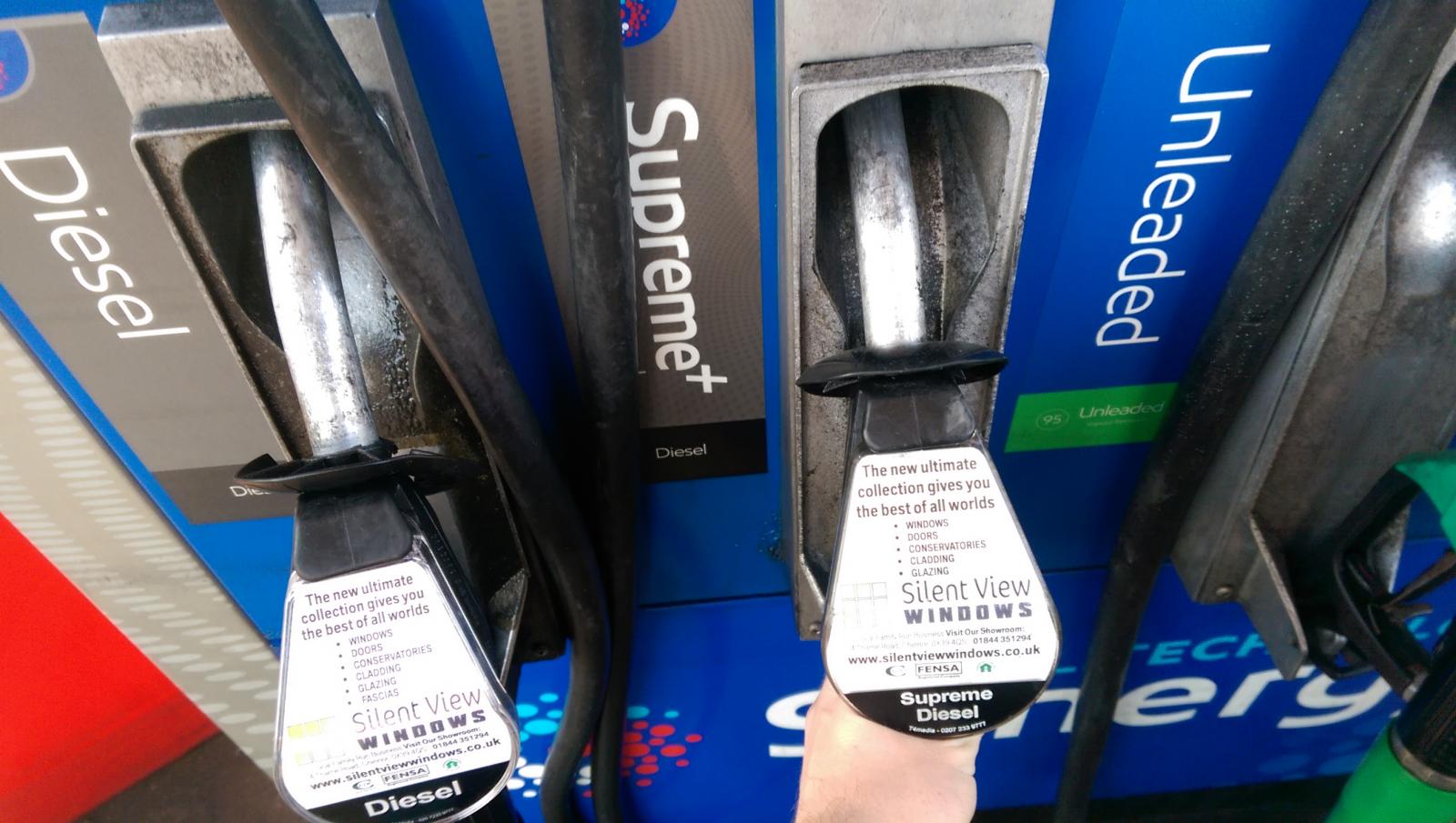

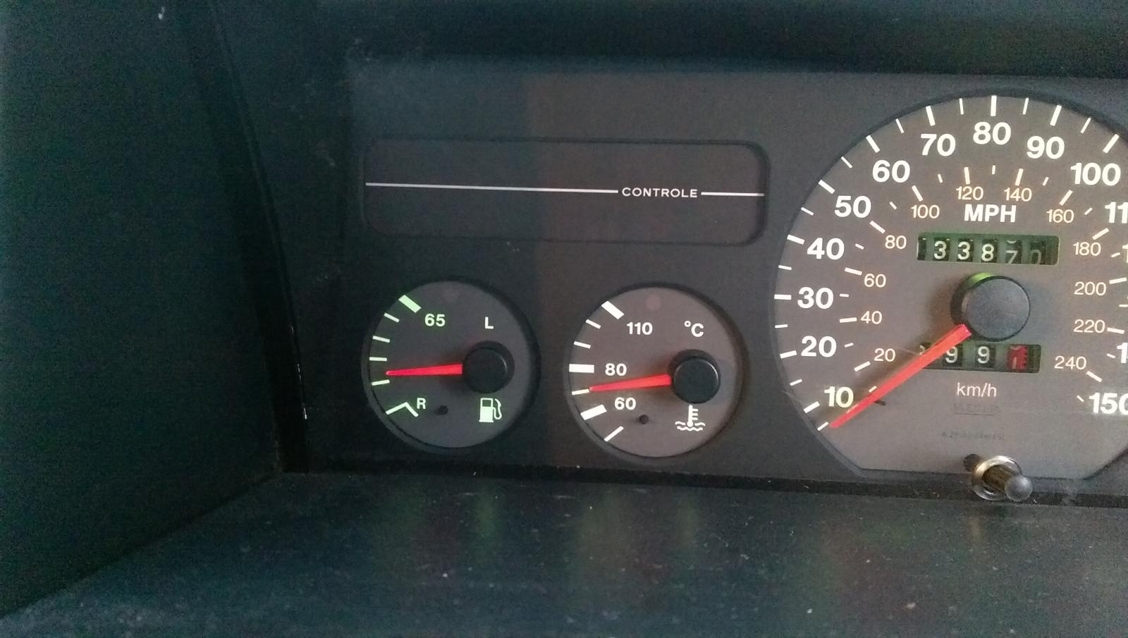

beko1987 Posted December 11, 2016 Author Posted December 11, 2016 So, operation mot emissions blag is on. Popped to asda Where the checkout lady and 2 staff stood by joked oooh, running your car on it are you? I waited for them to not sell it to me or something but they were fine with it, so I told them they were 100% correct. Laughs were had for 10 minutes and I was out of there. I can confirm crisp and dry is rapeseed That done, I popped to the pez station with the needle like this and put £10/7 litres of this unicorn spunk in I then came home and got the curtains twitching by putting 10 bottles of crisp and dry in. Those bottles are a right pain to empty quickly. Now we have this More tomorrow. This had better work, because I'm skint now. Need to get some repairs out the door to get my secret Santa posted next week yet. My remaining £9 is earmarked for bits tomorrow. More hooliganism on the way back from asda confirmed a distinct lack of smoke though, but obv I can't see the naughty stuff that made the mot machine laugh at me... Lacquer Peel 1

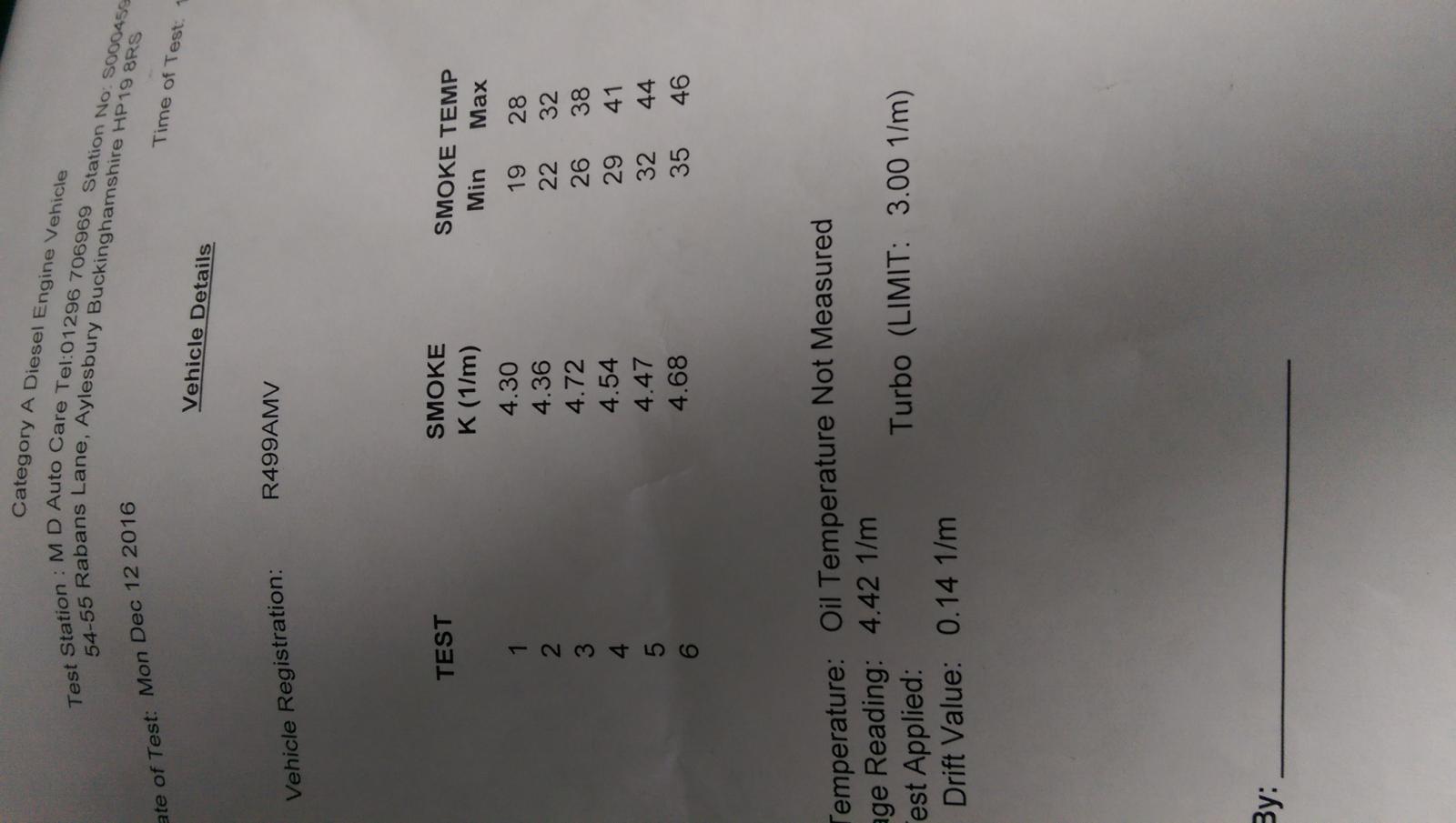

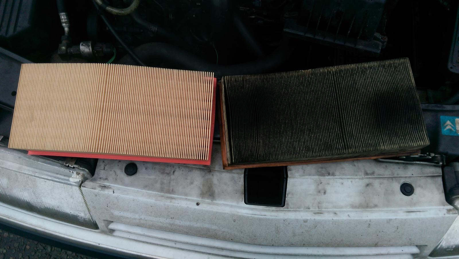

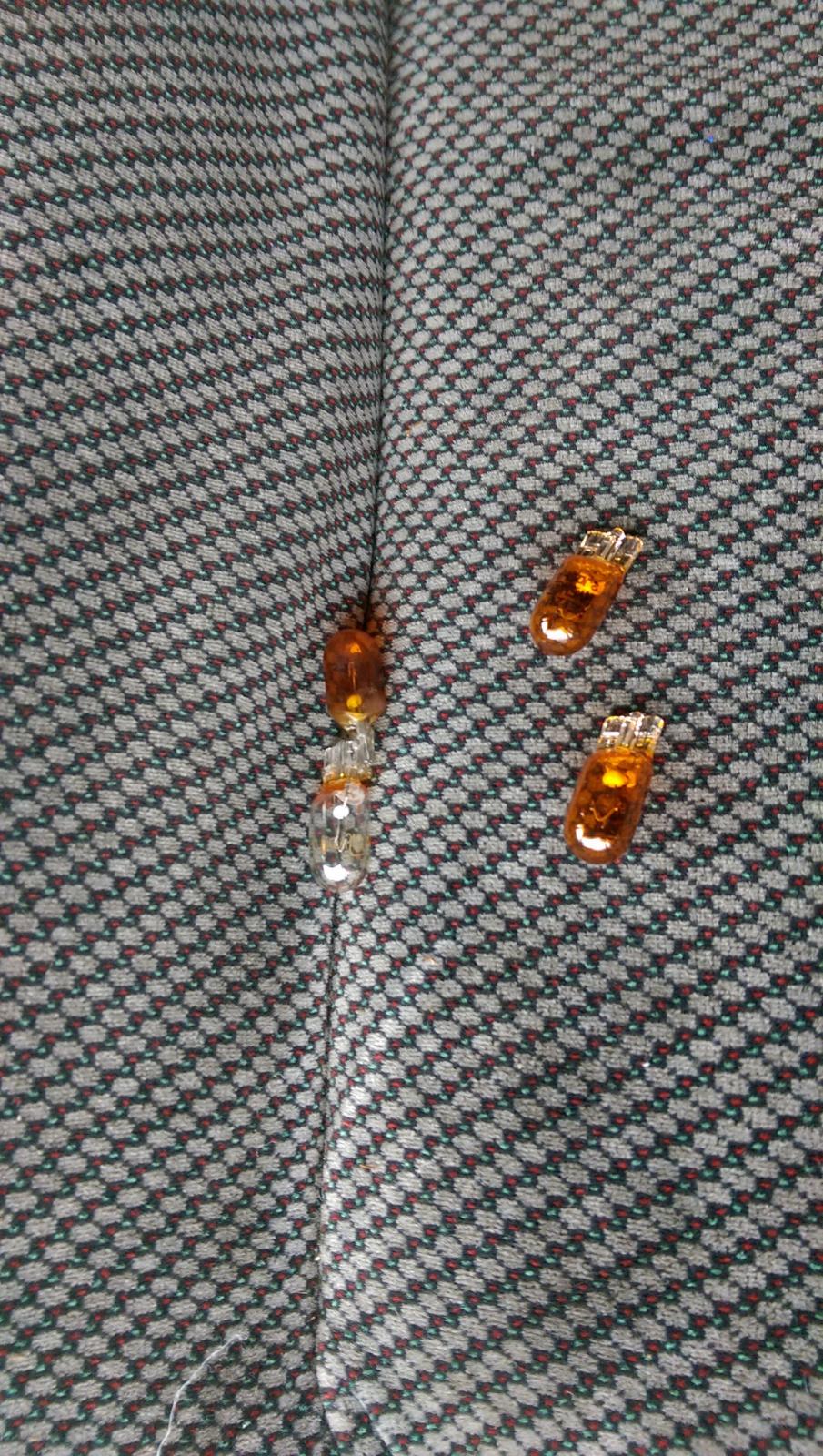

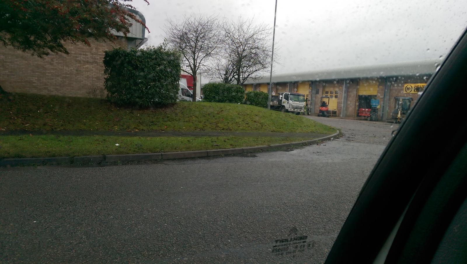

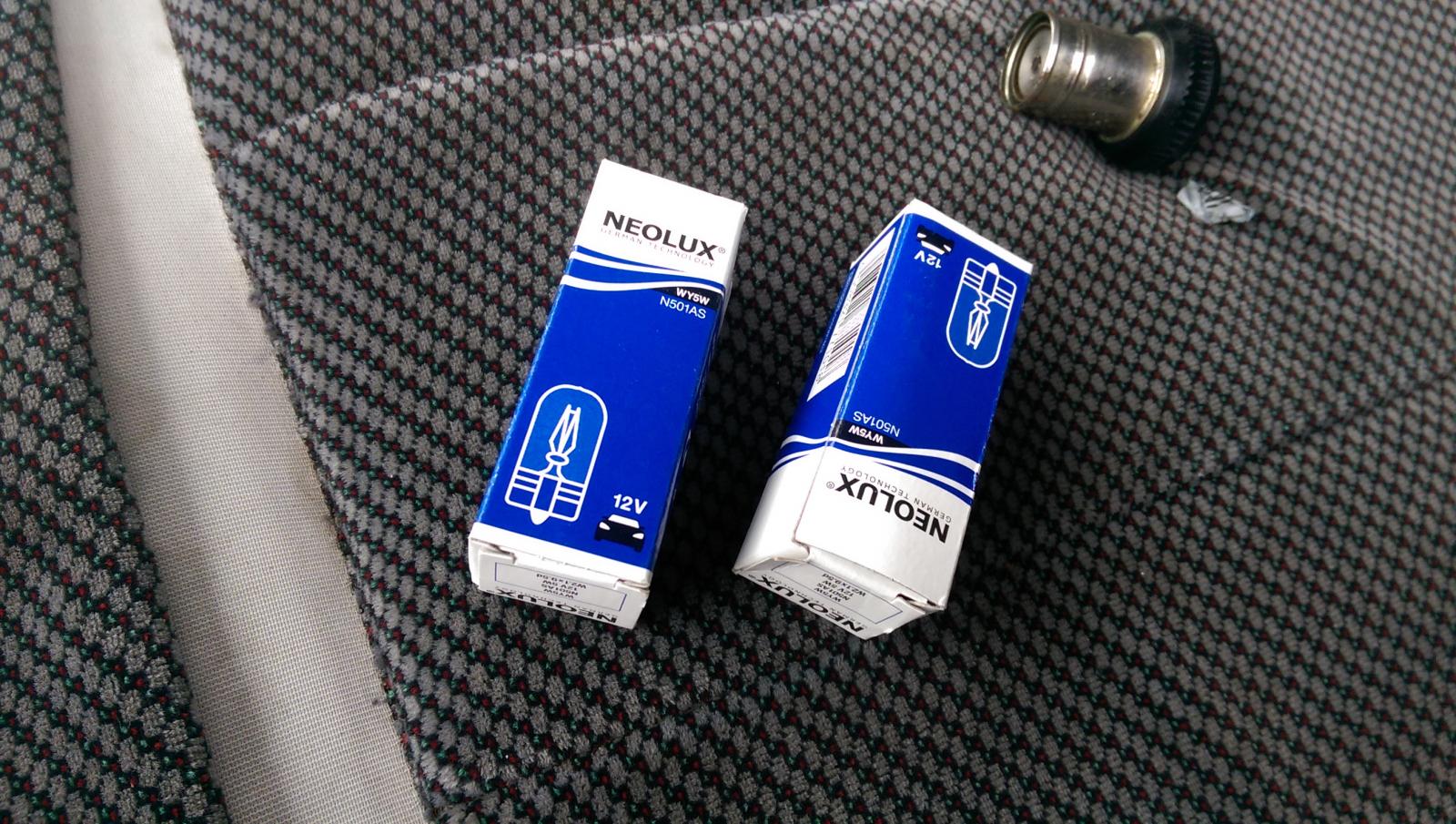

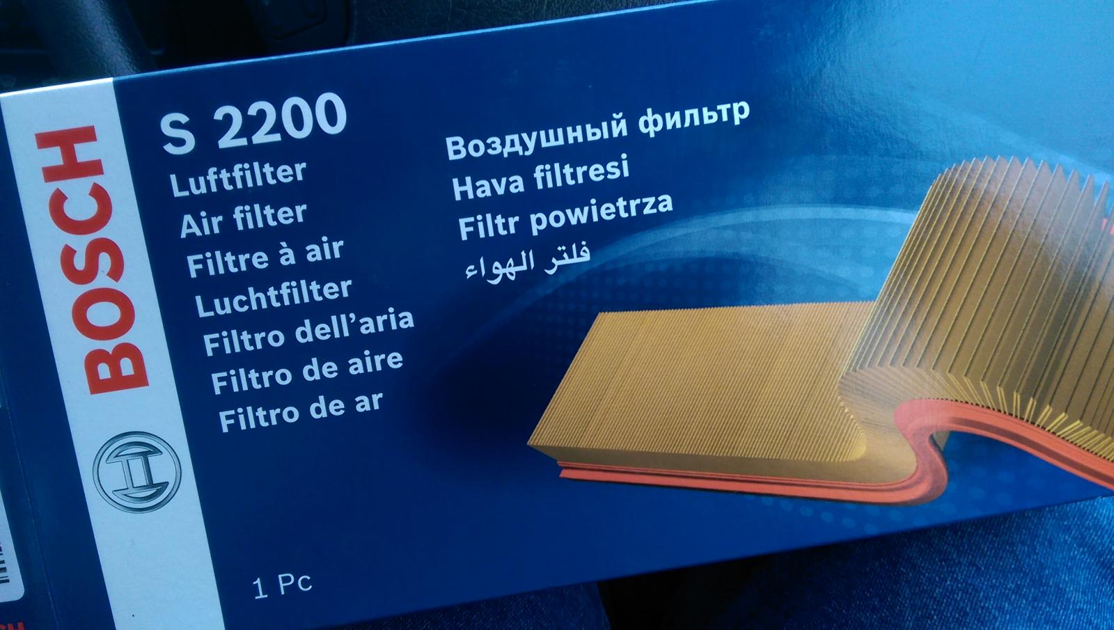

beko1987 Posted December 12, 2016 Author Posted December 12, 2016 Well that wasnt great. It started off with such promise. A quick trip to euro car parts to spend £6 on a new air filter which was needed and some indicator bulbs for the sides again, needed on one side, but I replaced both all done on the side of the road outside the MOT place I then gave it a good few hard revs, and held it just on the redline for a minute, then drove over. They took it straight in, straight onto the machine and... a straight fail. 6 black clouds came out too. To be fair they said they wouldnt count this as the re-test, so i still have until friday, but I have no more annual leave left now, so cant get back for friday. He did say the drivers seat and handbrake was fine though. WTF do I do now? Bit dejected now...
oldcars Posted December 12, 2016 Posted December 12, 2016 Bad news mate I think someone said futher back that the oil temp needed to be at a certain temp to perform the test, and this again says oil temp not measured. michael1703 1
beko1987 Posted December 12, 2016 Author Posted December 12, 2016 It does, but the car was very hot, I took the long way there with the fans set to cold, the needle was just above the normal line, even if they measured it I reckon it would have still been too smokey. May go out and have a fiddle, but I don't really know what to fiddle with, as the pumps been modified in the past, I don't want to fiddle the wrong thing and properly fuck it...
