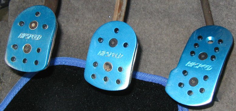

My daughter [of recent PIP notoriety!], bless her, found this Knob in a drawer full of tat... left over from a Barried Escort of dubious provenance/shady MOTability & Lurid Orange hue...!!!
... been in her drawers for many a year.....
... she gifted it to me and it saw sterling service in my Suzuki [not so]Swift 3potta... When I punted it in, against the Savvy, I swapped it off again for some cotton reel or the like (for the trade-in 'anything with MOT' deal).
So it has come, then to this........
Is the 'R'... Ripspeed?
It has a smooth bore and I got it to 'twist fit' tight down the threads by 'top hatting' some very chewy plastic [from a sweet pot] into the knob + heavy twisting. It came originally with 3x grubscrews but they are long gone....
I like the turquazz/poipill hue  8)
* Correct = Ripspeed (Halfrauds)
