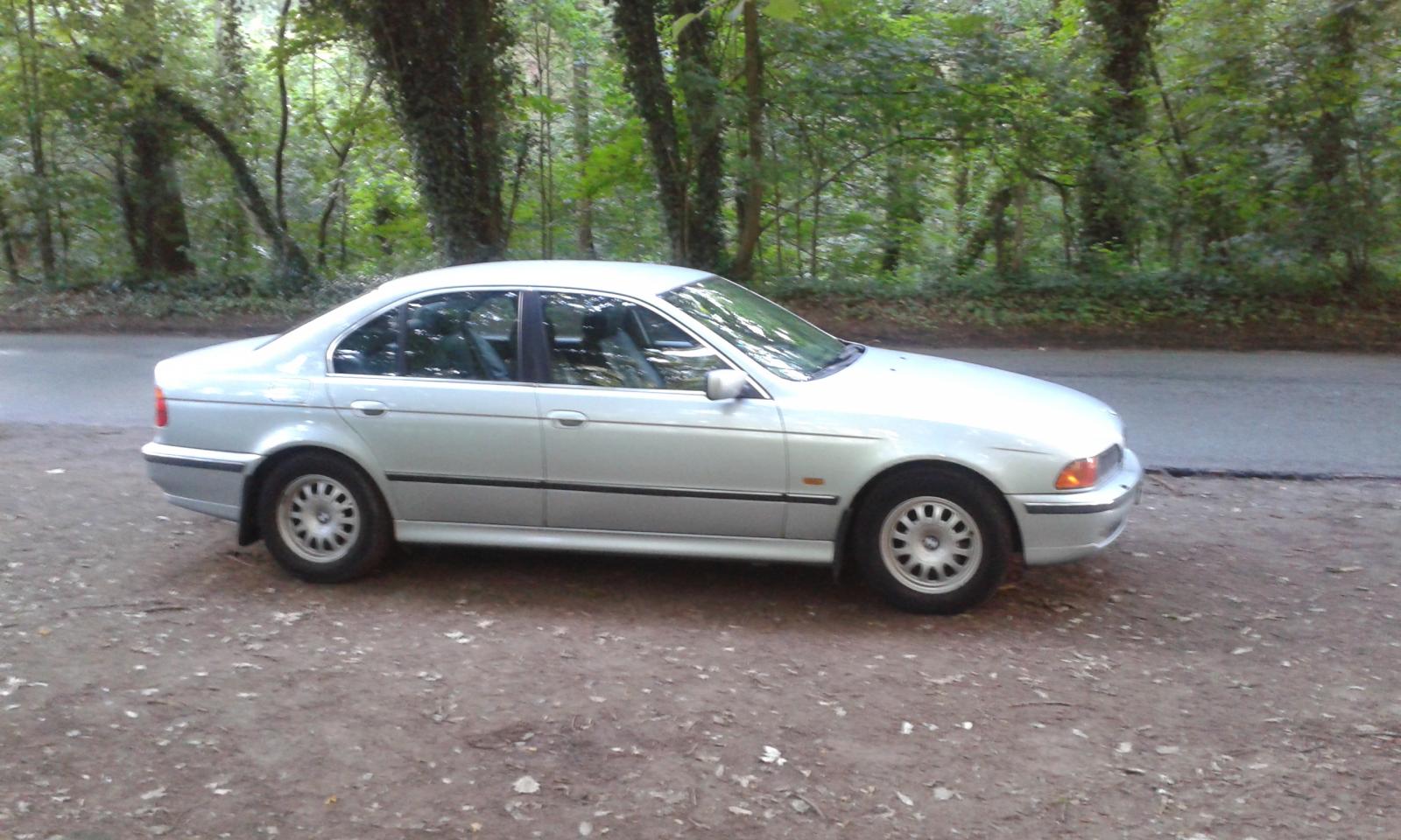

I am reluctantly putting up for sale my 1998 BMW e39 528i Manual for spares/repair
150k miles Glacier green
Good points.
Drives nice, decent power, smooth
Leather, cruise control
Electrics work, no lights on dash
Looks pretty tidy underneath
Manual box - good for skids I understand :)
Bad points
Bit of cosmetic rust arches etc
It overheats (after about 30 mins), have tried a few things but the problem persists.
Short MOT (13th August)
Would recommend a trailer unless you are live nearby or like to stop a lot.
Near Wolverhampton
