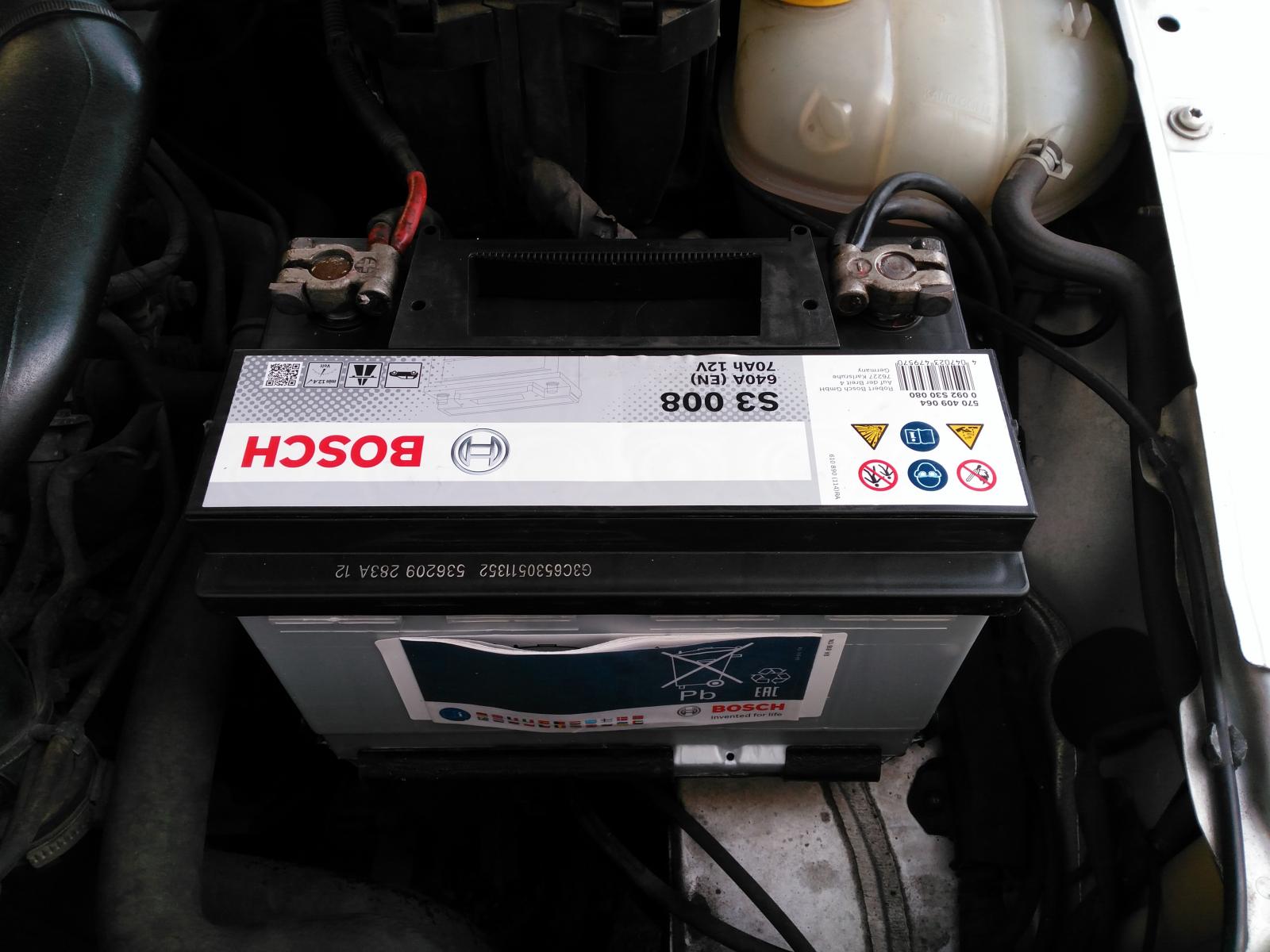

Discovered today that Euro Car Parts was running a 30% off everything promotion.  As I want to build reliability into The Aero, I took advantage of this and bought a new Bosch battery for £74 with a three year guarantee, as the one fitted to the car (also Bosch) was around eight years old and showing signs of weakness:
Replacing the battery was a straightforward ten minute job which only needed a 13mm ratchet spanner and a smear of copper grease to achieve. The car now turns over faster than Robert Maxwell's bank accounts ^^

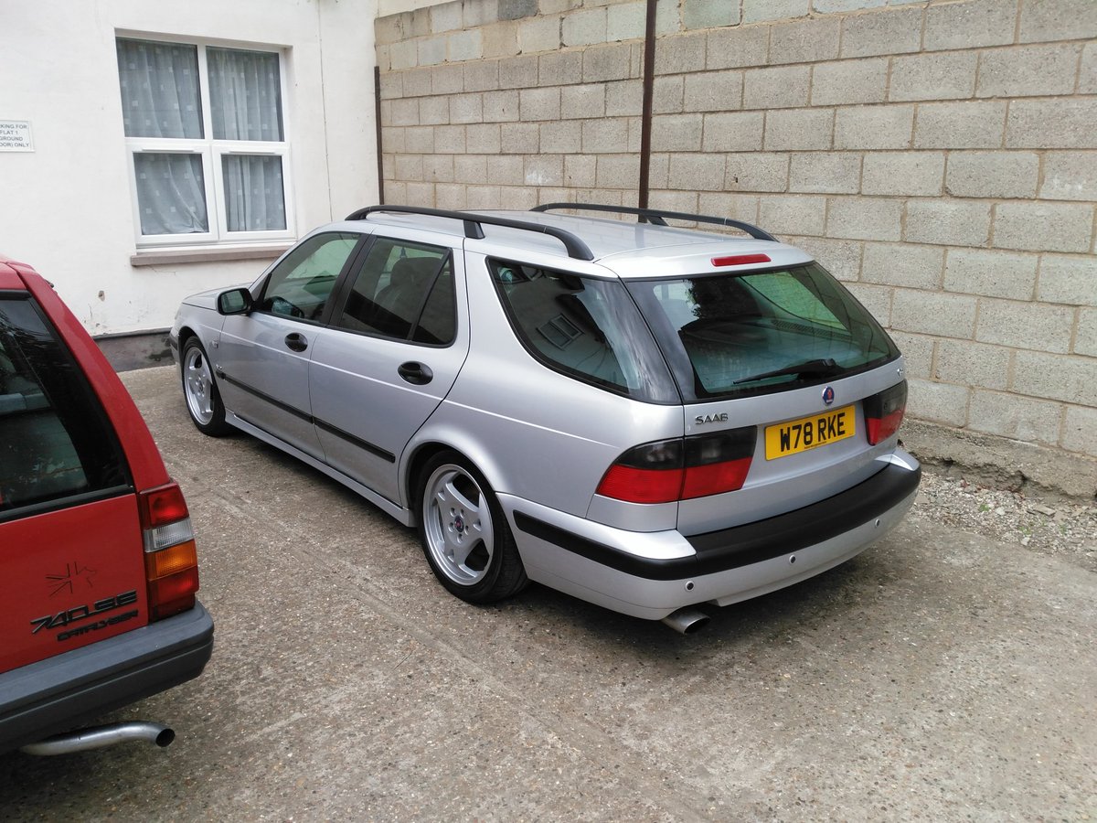

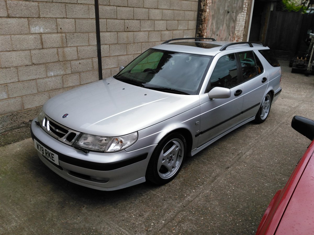

Over the course of yesterday and today, I attacked The Aero with some T-Cut, Mer, Color Magic and Autoglym Bumper and Trim Gel, which resulted in this:
Although its bodywork is nowhere near perfect, the car scrubs up quite well for a well-used, sub-£1000 16 year old car :)

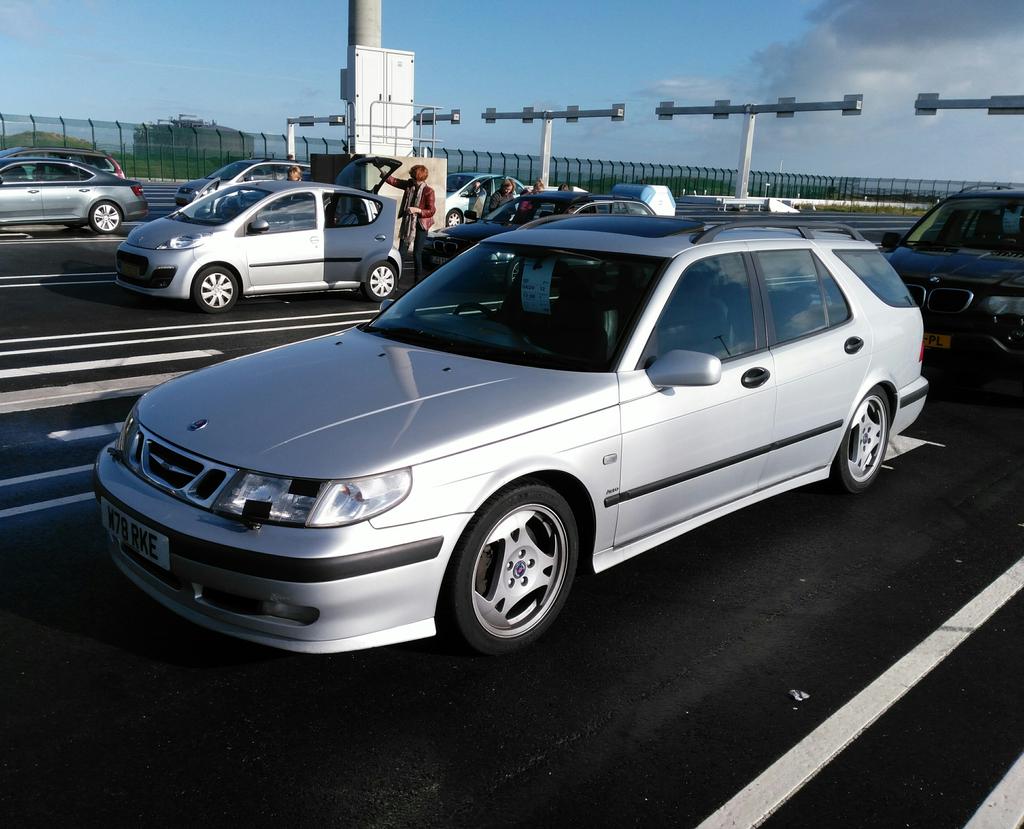

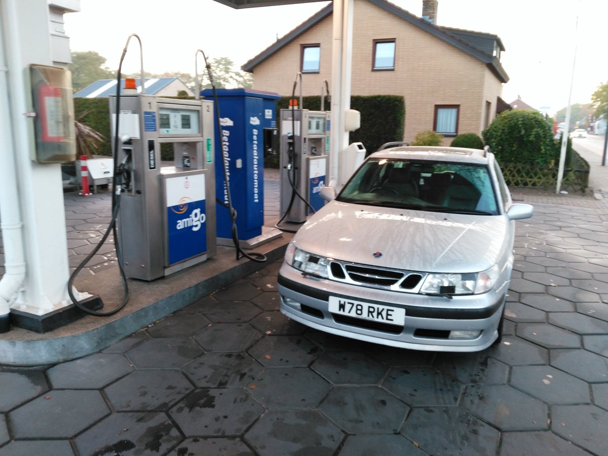

Drove The Aero to southwest of the Netherlands at the weekend, an almost 500 mile-round trip during which the car was faultless, which is just as well, as I have no European breakdown cover:
In particular, it cruises really well at 85 mph and is capable of giving drivers of brand new Audis a little something to think about  :mrgreen:
I really like driving in mainland northern Europe, as apart from the ones on the outskirts of the cities (the traffic around Antwerp is always hatefully bad), the main roads and motorways invariably don't have a lot of traffic, which enables me to get to where I need to be quickly and without undue hassle.

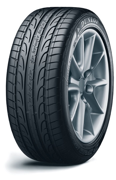

Just ordered a set of Dunlop SP Sport Maxx tyres from Blackcircles.com for The Aero, in order to replace the car's existing Michelins, which are now all worn close to the tread wear indicators, which isn't a great state of affairs with such a powerful car at this time of year:
I get them fitted on Wednesday at a certain well-known local 'motor engineers' :)
Had the new tyres fitted to The Aero this morning. The difference they have made to the way the car drives is phenomenal.

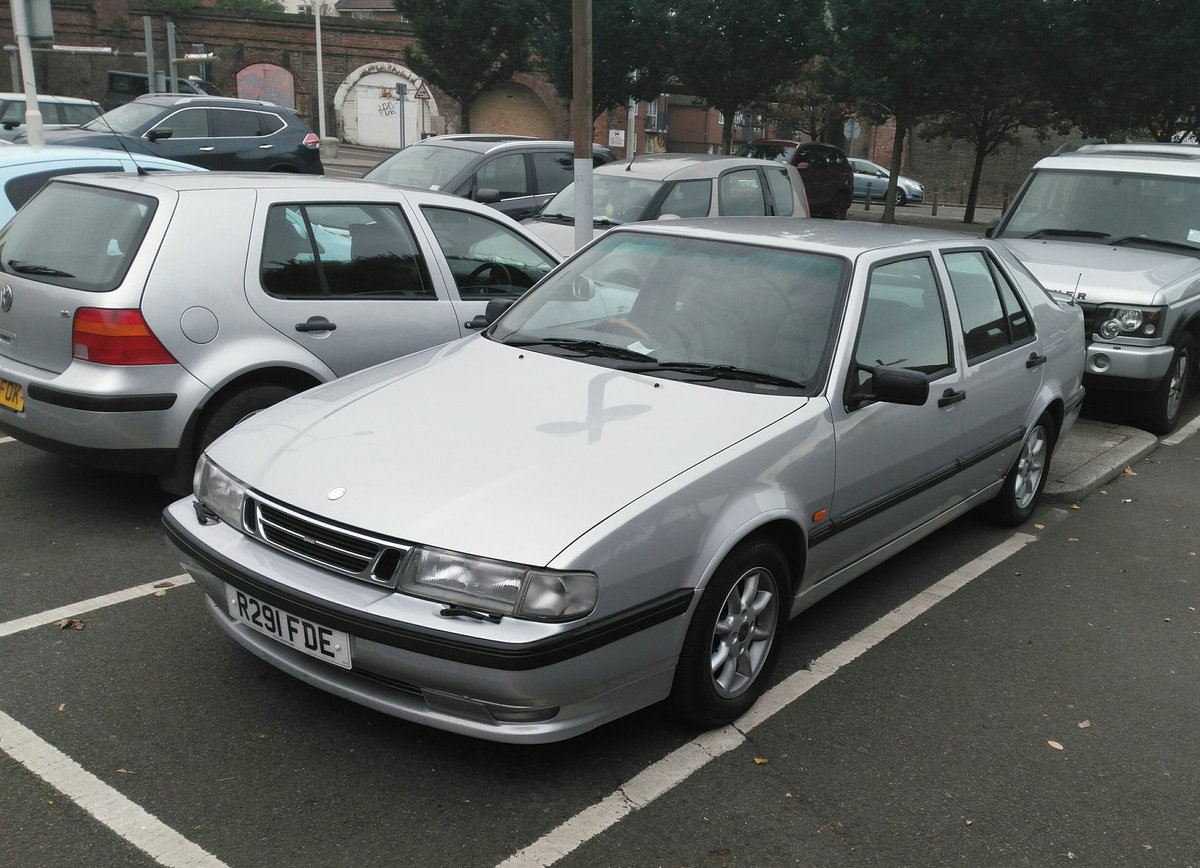

I really wanted to buy a 1980s 9000 about 15 years ago, but I was quoted £1500 to insure the £1500 example I was interested in. I'd still like one, but there are hardly any worthwhile 9000s of any type left nowadays. I did see this late model in Folkestone last week, though:
All things considered, the 9-5 is a pretty good substitute, especially in Aero Hot guise :)
Yeah I've fancied one in recent years. However in the last 5 years they have pretty much suffered extinction. A combination of owners scrapping instead of repairing, thanks to high scrap prices and just general wearing out of examples.
That's my old 9000,i sold it to the lads at my local garage who look after it really well.

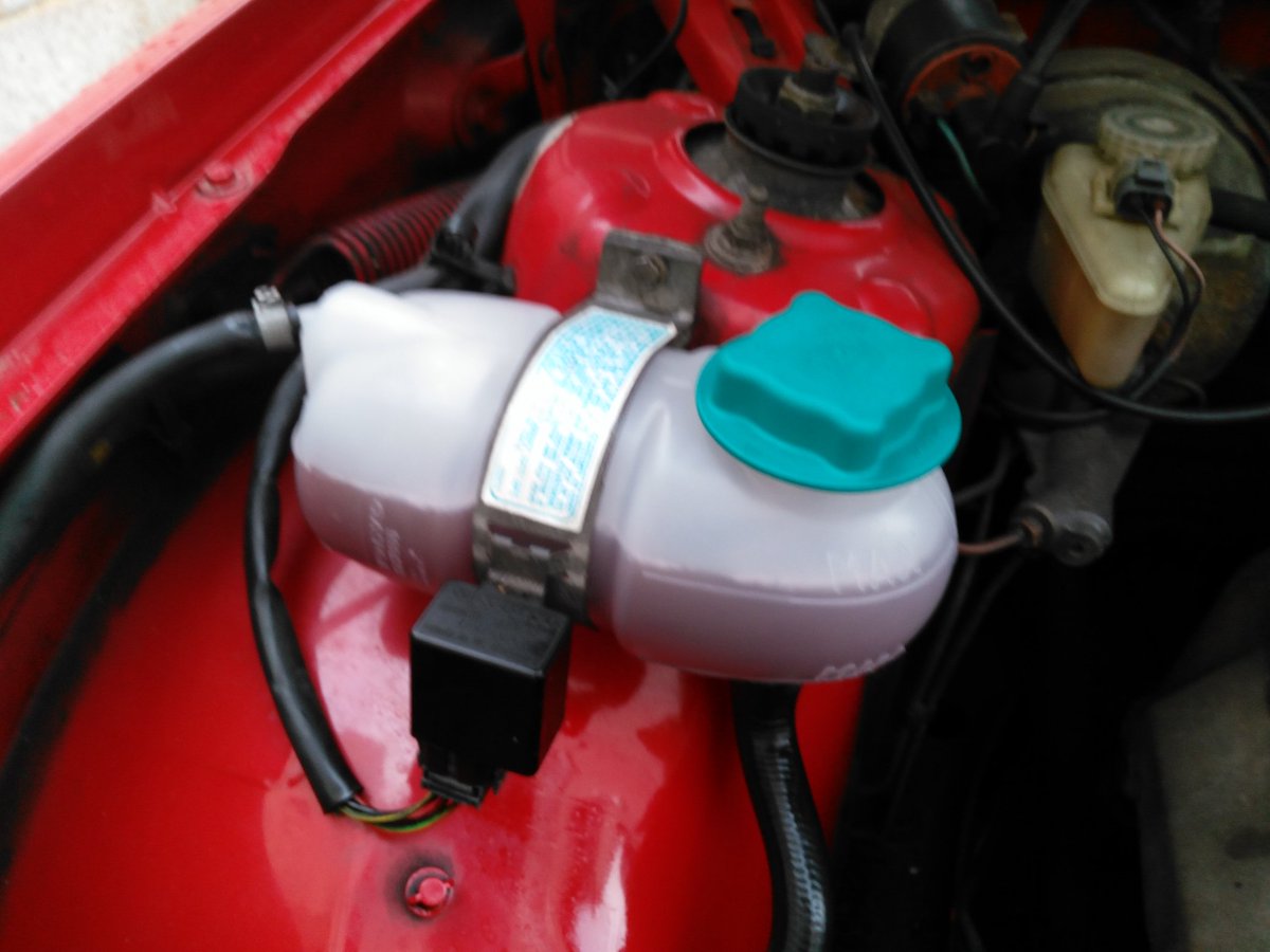

I fitted The Volvo's new coolant expansion tank and cap (genuine Volvo) this morning:

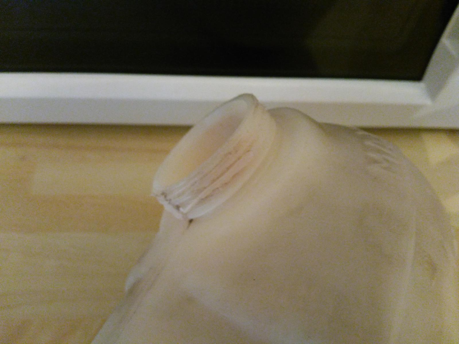

A nice and easy job which cured the car's tendency to chuck out coolant when warm, which was down to the existing (aftermarket) tank suffering from damaged threads on its 'neck' due to my accidentally cross-threading of the cap at some point in the past, meaning that the cap was unable to seal properly:
Hopefully the new tank will be more durable, as it's made from tougher plastic than the one I took off. As long as I don't cross thread the cap again, of course  :mrgreen:

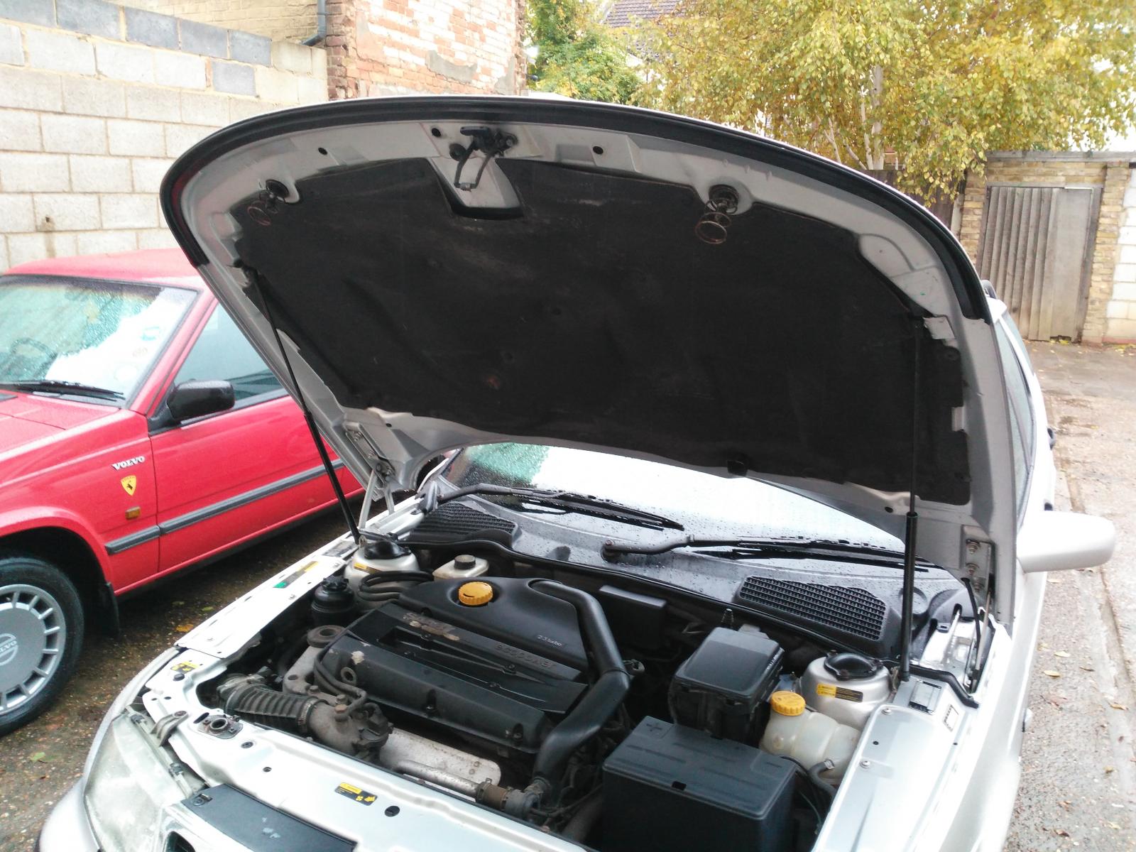

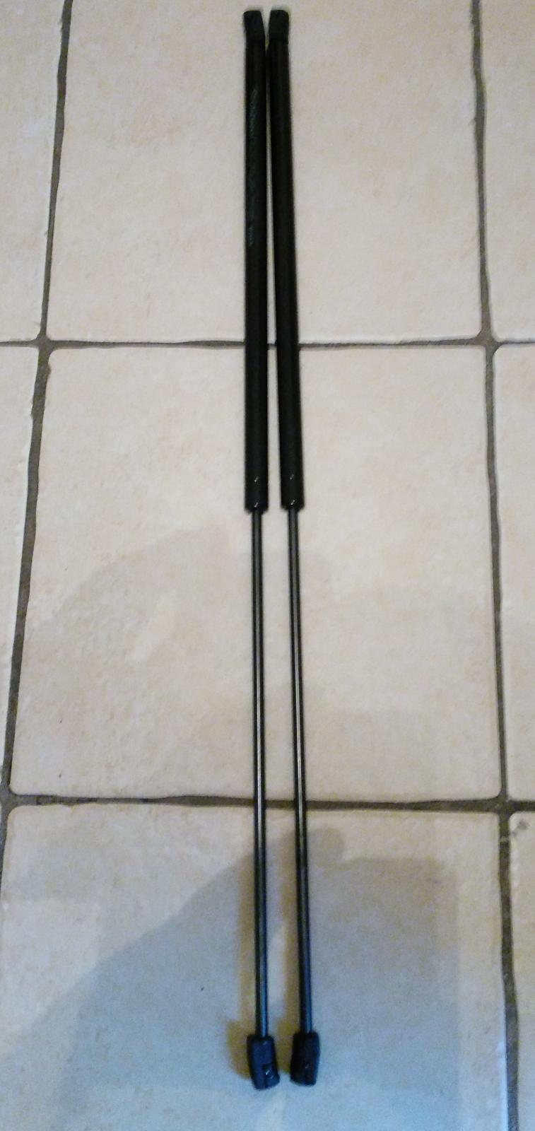

Discovered this afternoon that The Aero's bonnet support struts are weak and don't like doing their job in cold weather, a discovery I made when the bonnet lowered itself onto me heavily and without warning while I was fiddling around in the engine bay. Thankfully, they are readily available, cheap (£20 from eBay) and easy to fit, as I don't want to use a broom handle or similar to keep the bonnet up for for any longer that I have to.
A job for next Saturday morning, I think ;)
Fitted a new pair of bonnet support struts to The Aero today. They took five minutes to fit and make a huge difference:
The third picture shows the new struts holding the bonnet half open, which is something that the old struts were incapable of doing. Hopefully, being bashed on the head by a suddenly and unexpectedly descending Saab 9-5 bonnet will now be a thing of the past. No worries about The Volvo's bonnet doing the same, as it's held open by massive springs situated on the inner wings, which is a far better system in my opinion. I wouldn't want to be around if one of the springs broke or came adrift, though, as they look like they are under quite a lot of tension.
