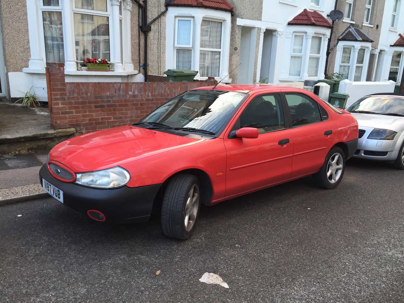

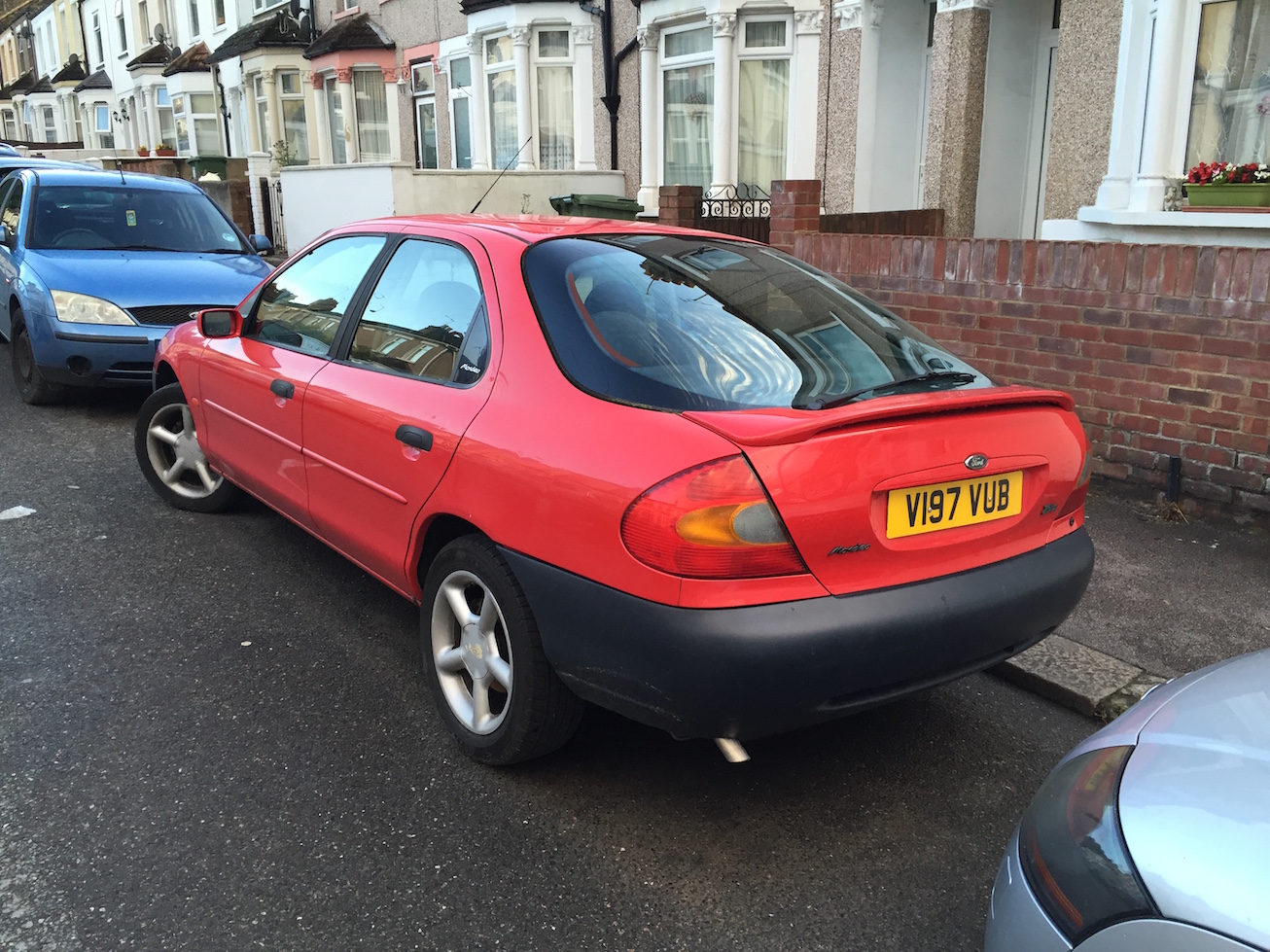

Introducing you to the father in law's Mundaneo 2.0 Zetec. Was quite a nice car new, now it's a bit minging.
They didn't do base spec black bumpers for this shape Mondeo (at least not to my knowledge) - but someone has had a go at recreating the look. I'm not sure they knew about the base sierra of Autoshite legend, so I don't think it's a 'homage'.

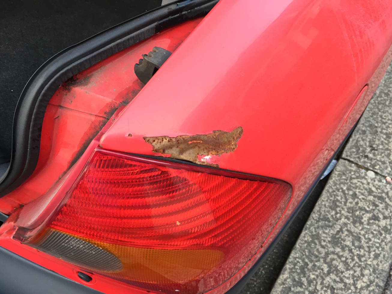

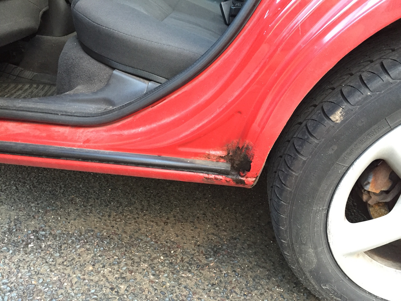

re: fix it - if I did, it'll probably be a bit of effort and I'd have to be invested in it, it'll need some fixing of the rust near where the sill meets the rear wheelarch (on both sides) which might involve weldage - I've not poked with a screwdriver yet and it looks crusty but not gone through - a good hard prodding will answer that...

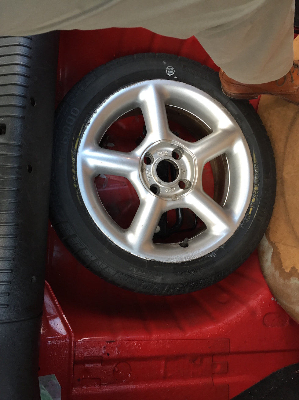

re: bungs - I have a couple of rubbish pics of the boot area - if you can spot them or describe them (I think any would be under the spare wheel or further back on the boot floor), I'll whip them out for you and stick them in a jiffy bag for you next time I'm over there (probably next weekend).
