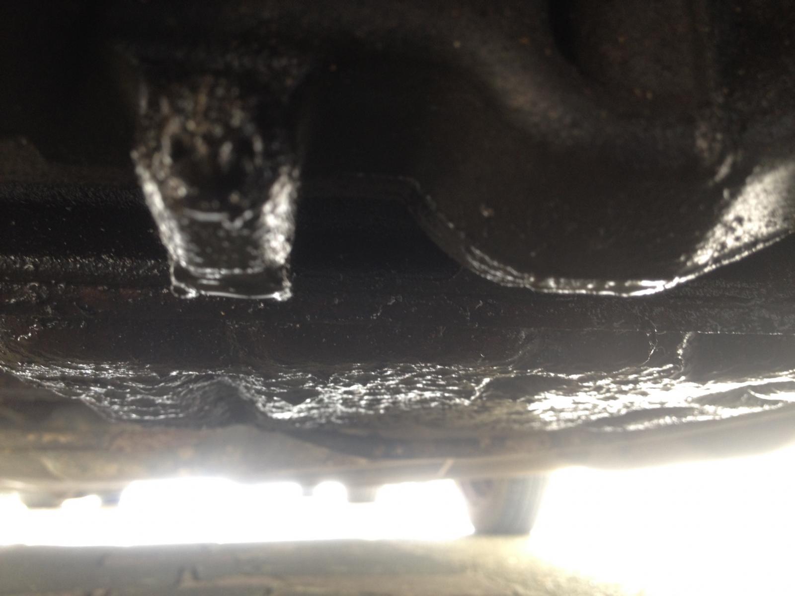

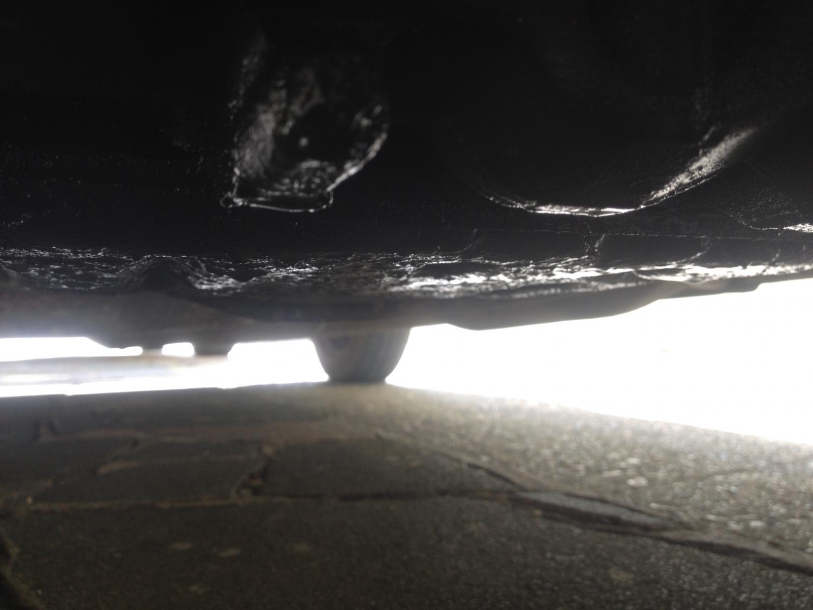

I've had my first little problem with the car and I hope it's not much.. But it looks like I've a bit of an oil leak ..post-9282-0-69367000-1461260667_thumb.jpegpost-9282-0-92449700-1461260726_thumb.jpeg
I just looked at the mot history and it said it had a rusty sump back in 2013 so in someways I hope its that as it's less than £30 for a new one.. But it might be a hose or a breather pipe as it feels a bit wet under the turbo..
I just hope it's not much..
Amusingly the only Smart I ever drove was stickered up to look like an A1 Motorstores oil can.
The sumps do rust through regularly I think there is someone doing them now in stainless with a drain plug; also I'm pretty sure I don't need to say to keep a close check on the oil level they don't hold much and are prone to cooking the engine if it's low

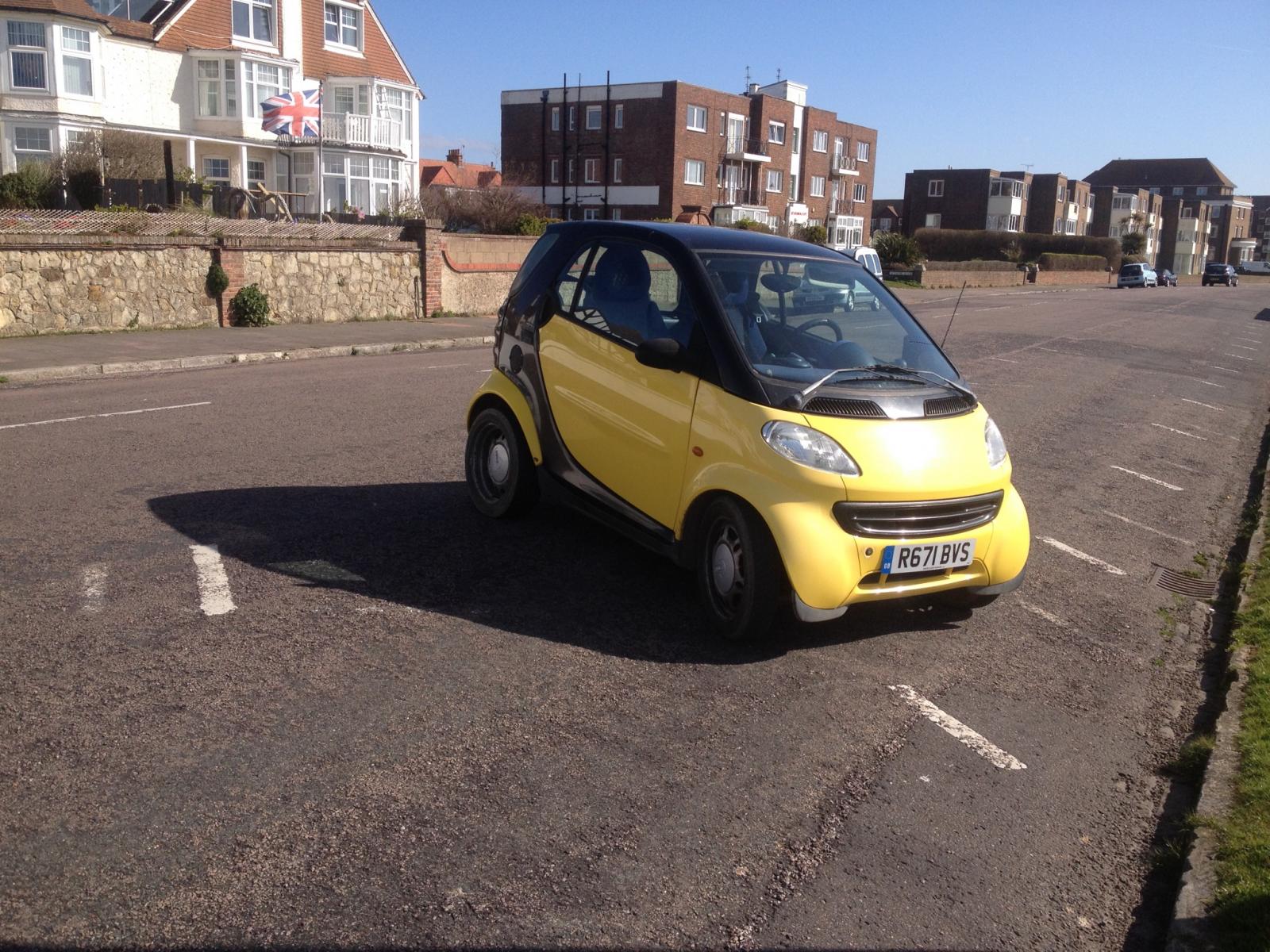

Well I don't know how I get myself in these situations on eBay but I've just won a very early smart car for £550...

I think your right I'm banning myself from the eBay motoring section from now on lol...

So the bits I've ordered so far are a new sump and the top breather hose and 6x denso plugs plus some mahle oil and air filters but parts are quite cheap for the car as it only came in at about £50 for the lot by shopping about and juggling postage and packaging costs and using discount codes etc.
I was going to have a go at the sump myself as it looks straight forward but I just don't have the room to crawl under the motor and would need to buy a set of chocks for the front wheels plus axle stands before I started anyway so I've entrusted it to my local garage to do that job.. I'm just keeping my fingers crossed its the sump now and it's not too costly for a sump change.
