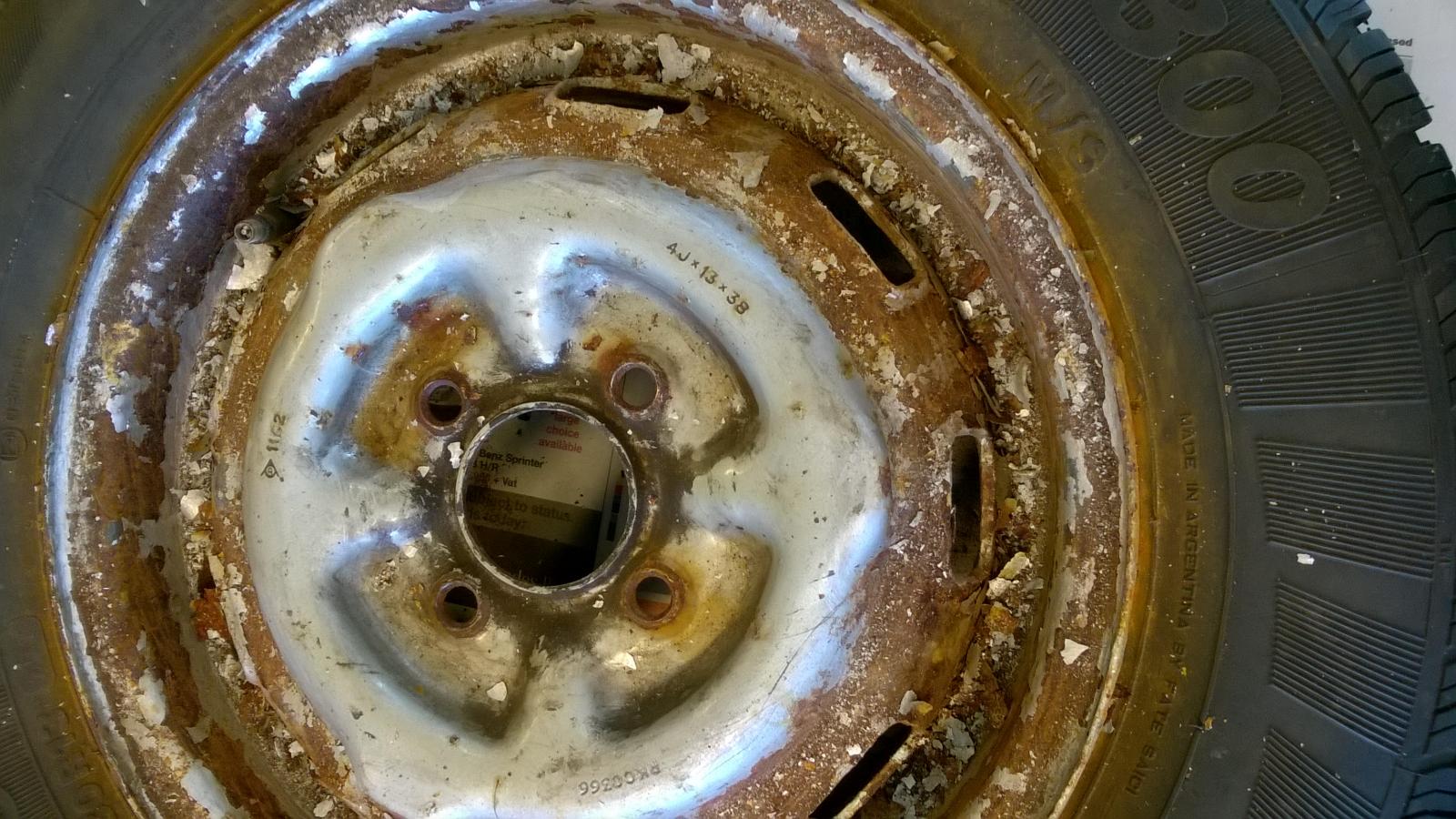

And thanks to dugong I have a spare set of wheels so get mine done up nicely. I am going to use pound shop silver as an experiment to see how good/ bad it is. In theory I think it could be done for a fiver for all four wheels, working on two cans of primer and three of top coat.
The poundland wheel silver is good. I did the Reliant wheels last year and the still look good under the trims.

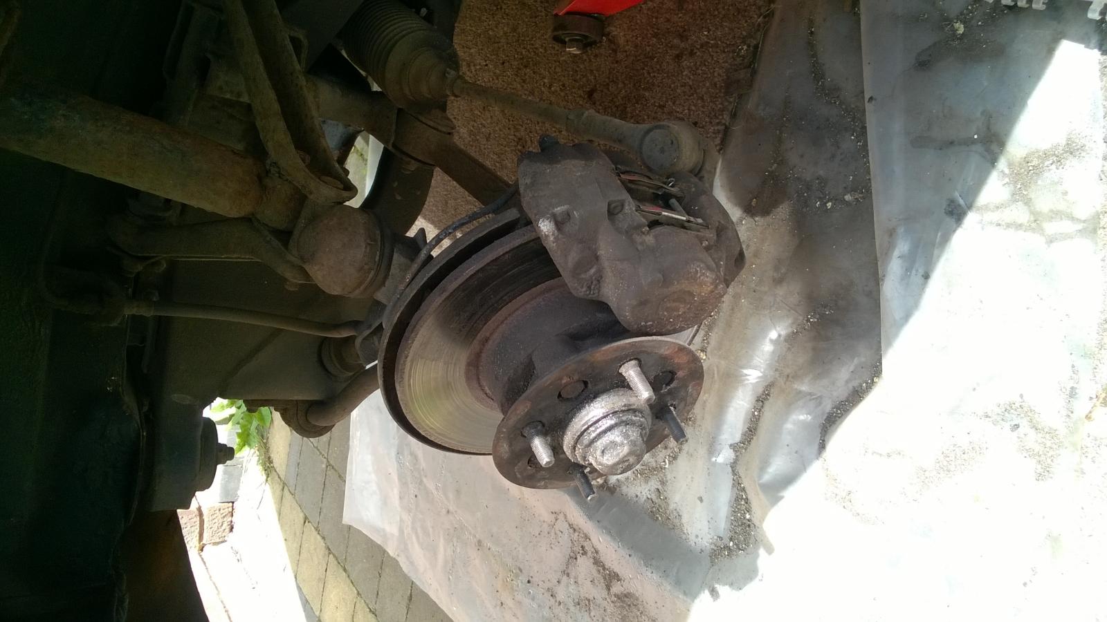

And here is the source of the hassle, the caliper took some cleaning up to get it to move smoothly. Still not 100% happy so trying to source a pair of calipers and will refurb them and swap them out. Got a bit more bodywork done as well but nothing major.

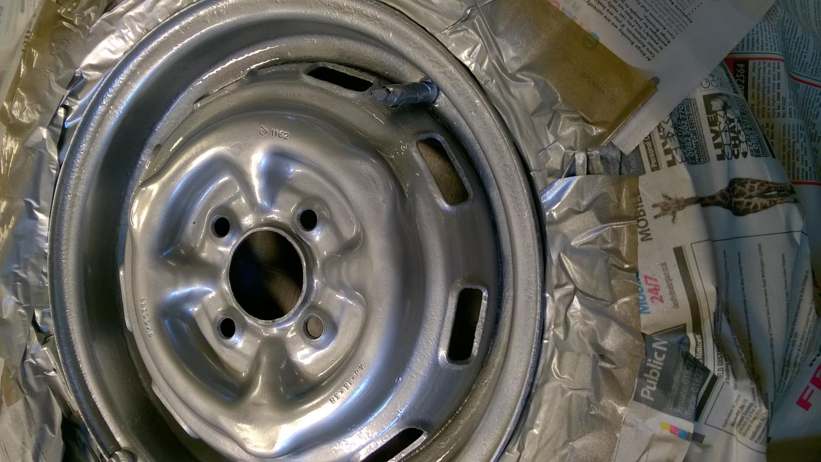

And had a go at the first wheel (the one in the pic above), presently cost about 70p in pound shop primer and silver. It still needs lacquer but looking OK to me.

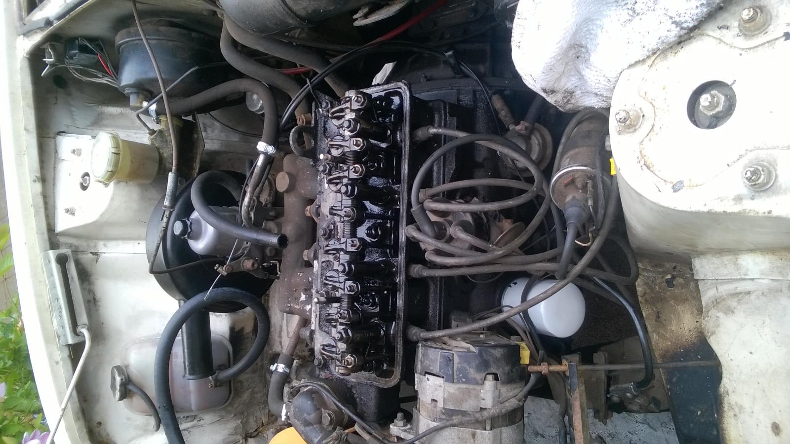

Dodging the showers again so not a lot done, but did get the rocker cover gasket changed. The old one was as crispy as a party at walkers.

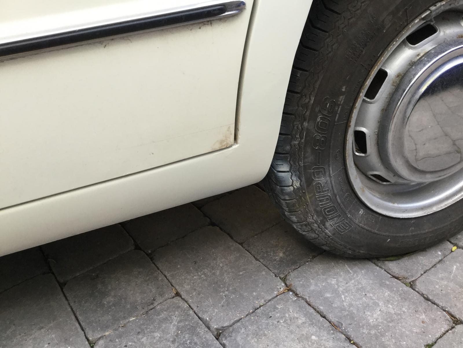

I forgot to take a pic of this side before I set at it but it looked similar to the other, or pretty crusty to put it another way. It still needs a coat of lacquer but the sky was looking very dark so I have had to stop for the night. For saying I hate doing bodywork I am pretty pleased with this.
That looks bloody fine and dandy to me mate. Nice one :)
Thanks Ken, I was pleased with it. I have run out of time on the other side but will get back onto it in a week or so. Just waiting to hear from Mick about the calipers, one tiny bit of welding and then it's MOT time! (Oh and the exhaust, went past a motor factors today and clean forgot to pick up some new mounts)
Pssst, for the non-fillered look there should be a groove that goes horizontally along that bit between the pointy edge of the door and the tyre ;)
I know but I bridged the area with a single replacement bit of steel for strength. I appreciate the purists will be writing to their MPs and demanding I be shot but I think it looks better as well. That side has about 1mm of filler as the whole sill has been covered in spray filler and lots of coats of paint so couldn't really avoid it. The other side is just straight metal with the tiniest skim of stopper .

Woo hoo! Finally sorted the knocking noise when cornering. It was the exhaust after all, a pair of cheap universal mounts and all is well. I also swapped out the calipers after getting a pair and rebuilding them. The ones that have come off are completely knackered so glad that's done. Brakes feel MUCH better but do need another bleed to be perfect. It's getting there.
Brilliant news! Are they refurbish candidates?
Just soaking in plusgas as we speak, all Pistons are stuck, they moved slightly when under hydraulic pressure but don't want to play now. I will see if I can get a grease nipple with the right thread and go that way if the plusgas fails. I think they will be a useful spare pair but will probably need new Pistons and definitely seals!
