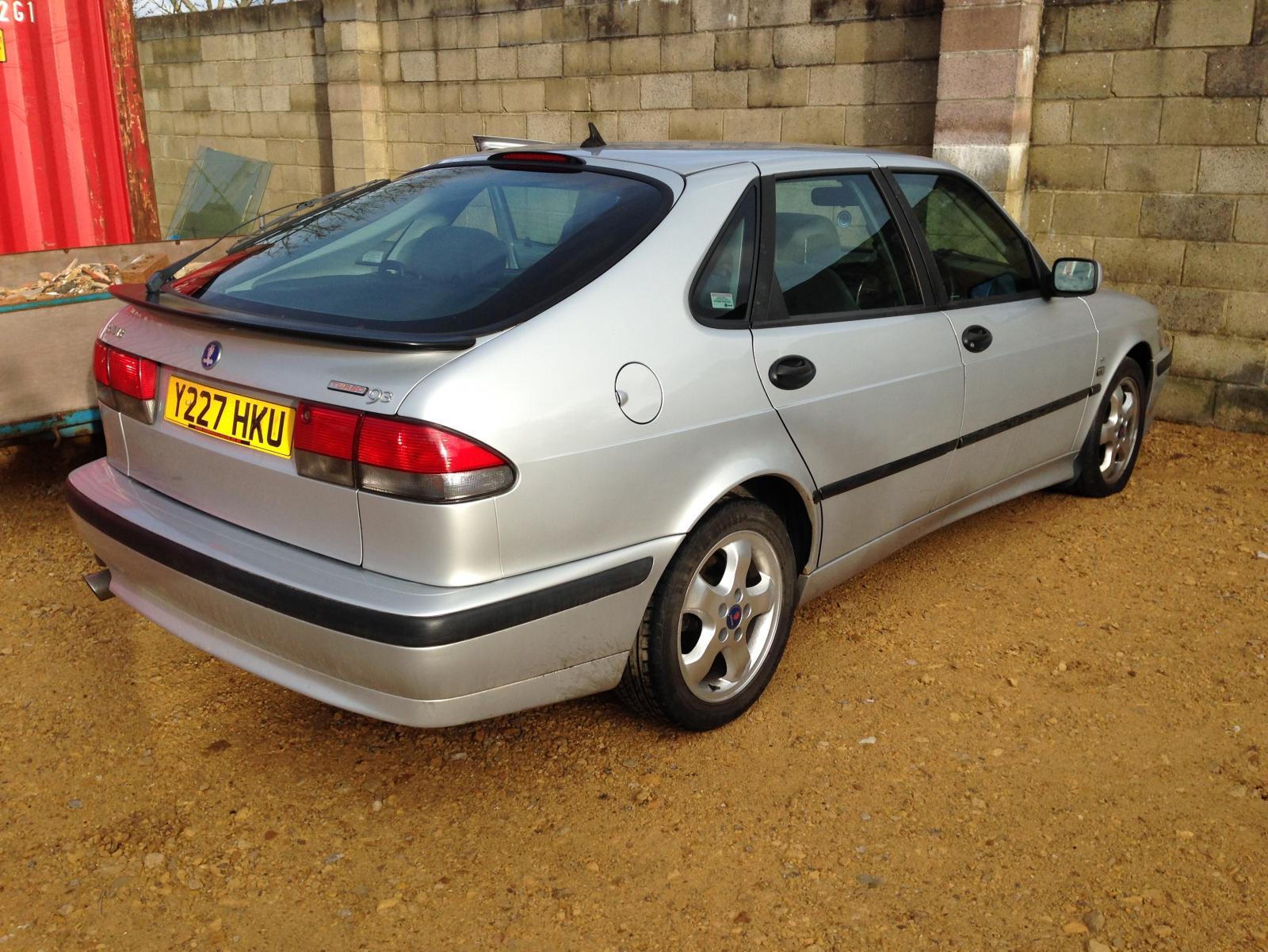

Soooo in the best turn of events ever my mate has just been given this!!!! Bottom end knock. If only he knew someone who needed a few Saab 9-3 bits. WINNING AT EVERYTHING
Ooh, lookds likee a 150bhp going by the wheels. I had one
it was shit.
enjiy stripping it:)
