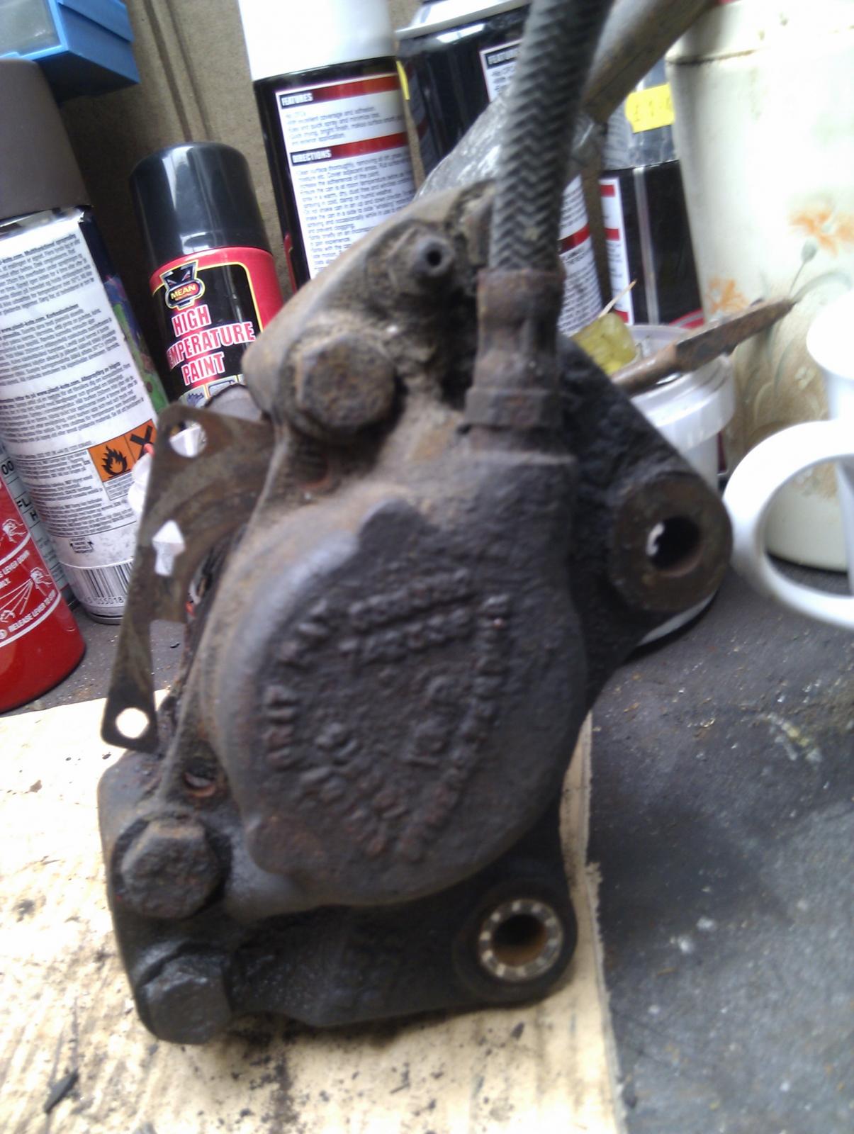

so early last year i decided to look at the front calipers as the were seized on solid. hours later i had 4 rounded bolts and knuckles like a bare knuckle fighter, but eventually after soaking with wd40, lots of heat, chisels, hammered on sockets, etc etc, i managed to get both the calipers off.
on closer inspection they looked completely knackered, and were seized solid, so after a quick wire brushing to take the big clumps or rust off, i had calipers that looked like this.
fifty year old calipers, that had sat on a car in a barn for 35 years

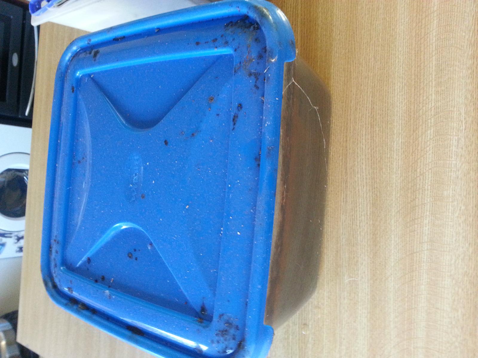

when i got home, i filled a plastic container with hot water and bunged both the tins in and gave it a good old stir, then grabbed the calipers and threw them in, banged the lid on, and plonked em in the garage,

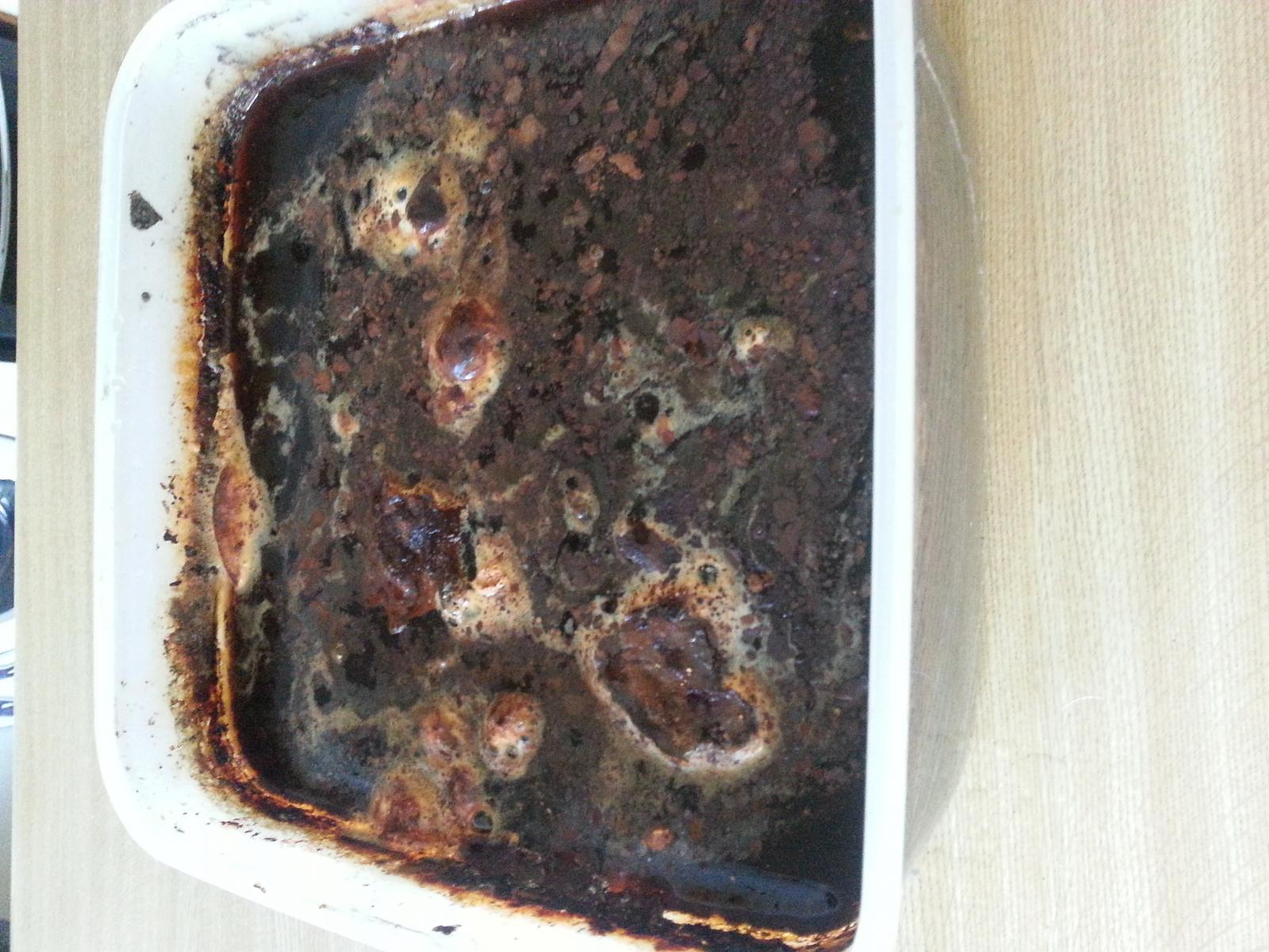

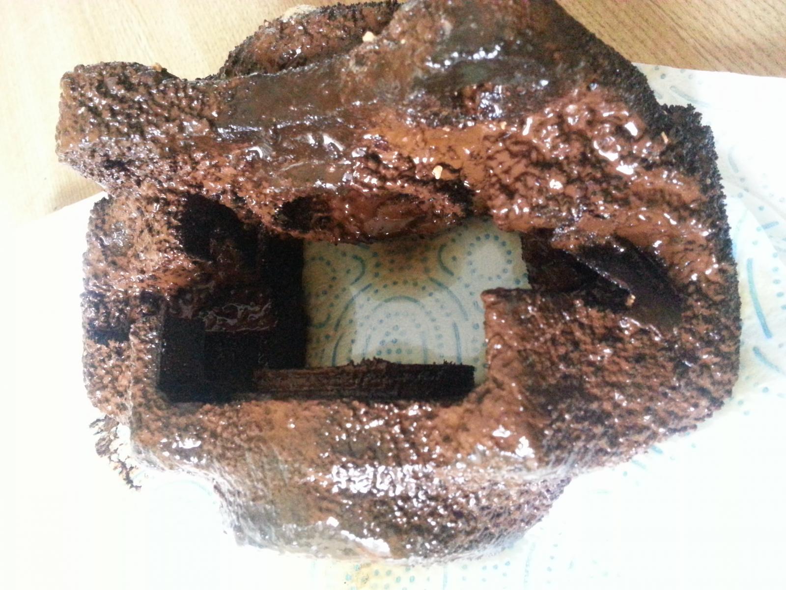

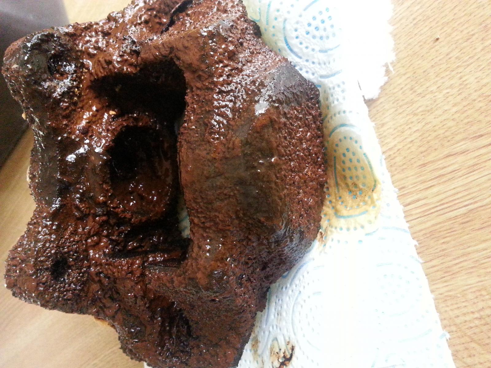

this brings me to today, a year later that i suddenly remembered my calipers were still in the garage soaking away in a bucket of treacle and water. so i decided to bring the bucket in the house and have a look. i was quite excited to see the state of them, that's if they hadn't exploded, or had been completely eaten by rust,

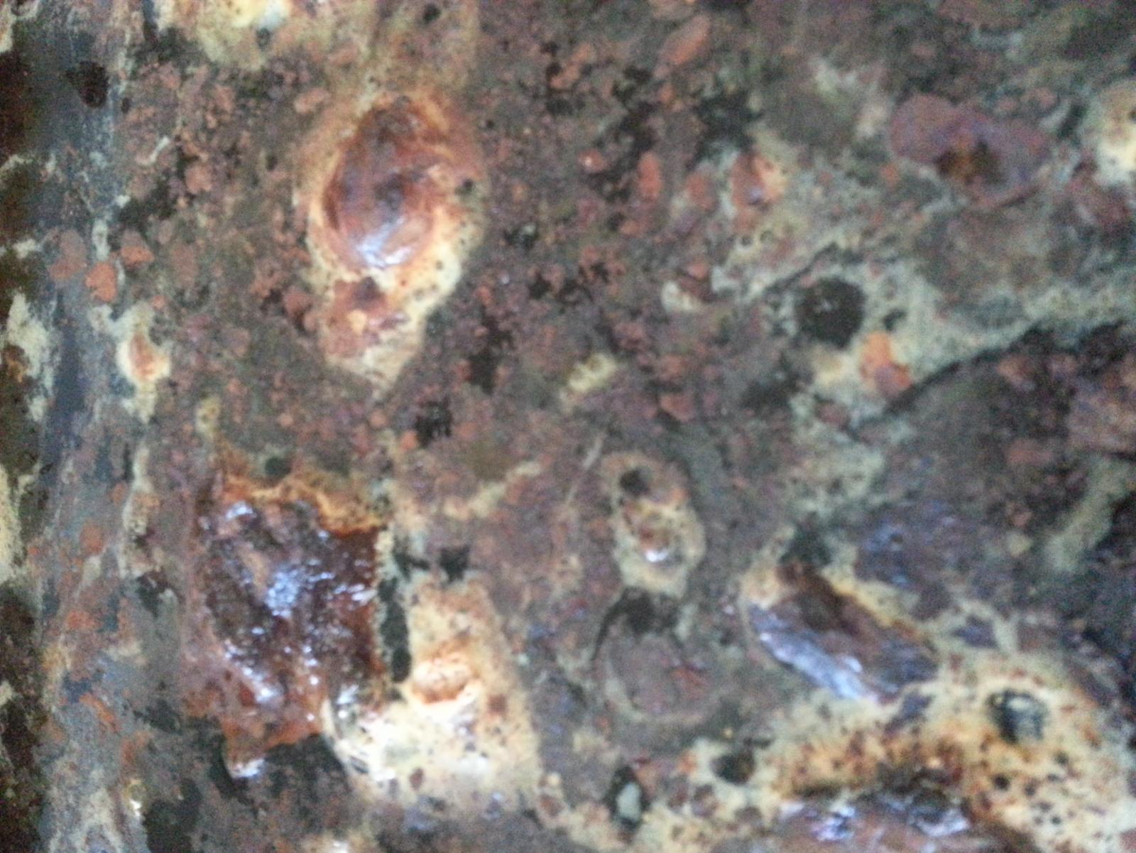

so off came the lid to have a look, and the stink was as bad as the old boy had told me, no, actually it was worse and looked like this !
it looked like some sort of chemical waste !
so i decided to put my hand in and grab one of the calipers,(that's if they were still there, and not dissolved away)
i was praying for some sort of miracle, but i got a bit of a shock. it reminded me of the documentary on the titanic when they located it and james cameron sent down a submarine, and the whole ship looked no different than my calipers. at this point i was swearing like a f###ing trooper lol,
the stern
the bow
starboard
portside

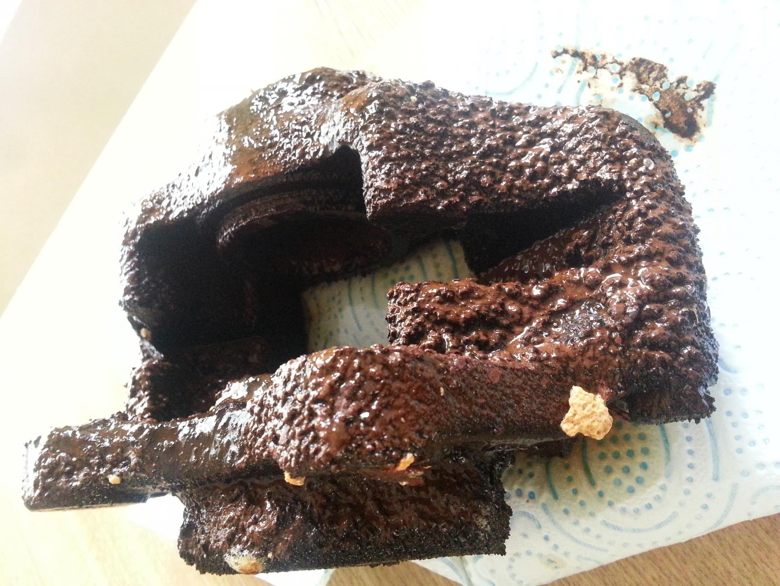

to say i was shocked is a bit of an understatement lol. but i remembered the old boy had said when i took them out i had to give them a good scrubbing with a wire brush in some warm soapy water, then let them dry and then fine sandpaper or brass brush them after.

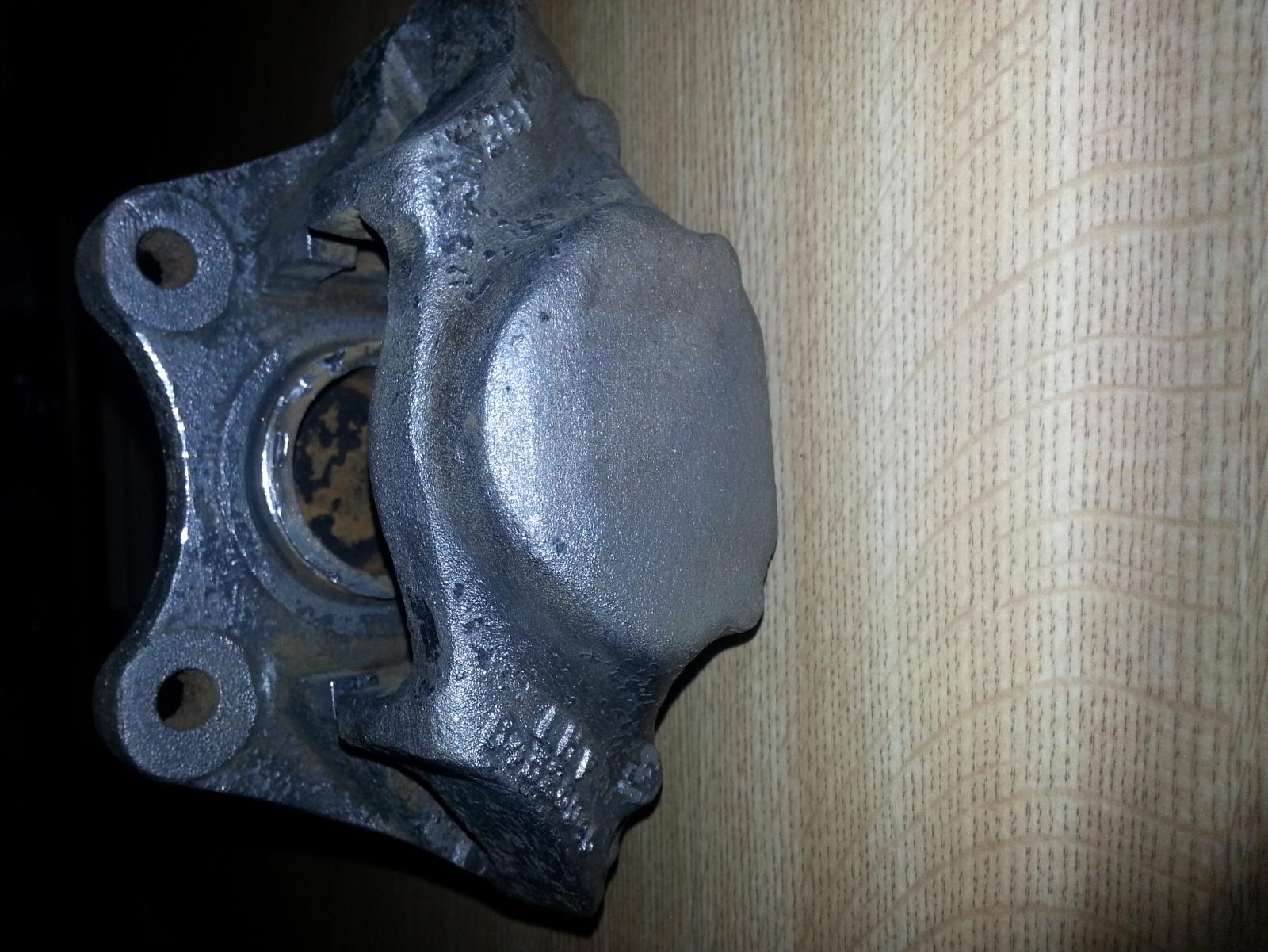

i scrubbed them both for about half hour, and left them to dry, while i had a cuppa.
then i was kicked out of the house and banished to the garage, where i got my cordless drill out and put in a wire brush attatchment and started to buff them up as best i could as it was bloody freezing.

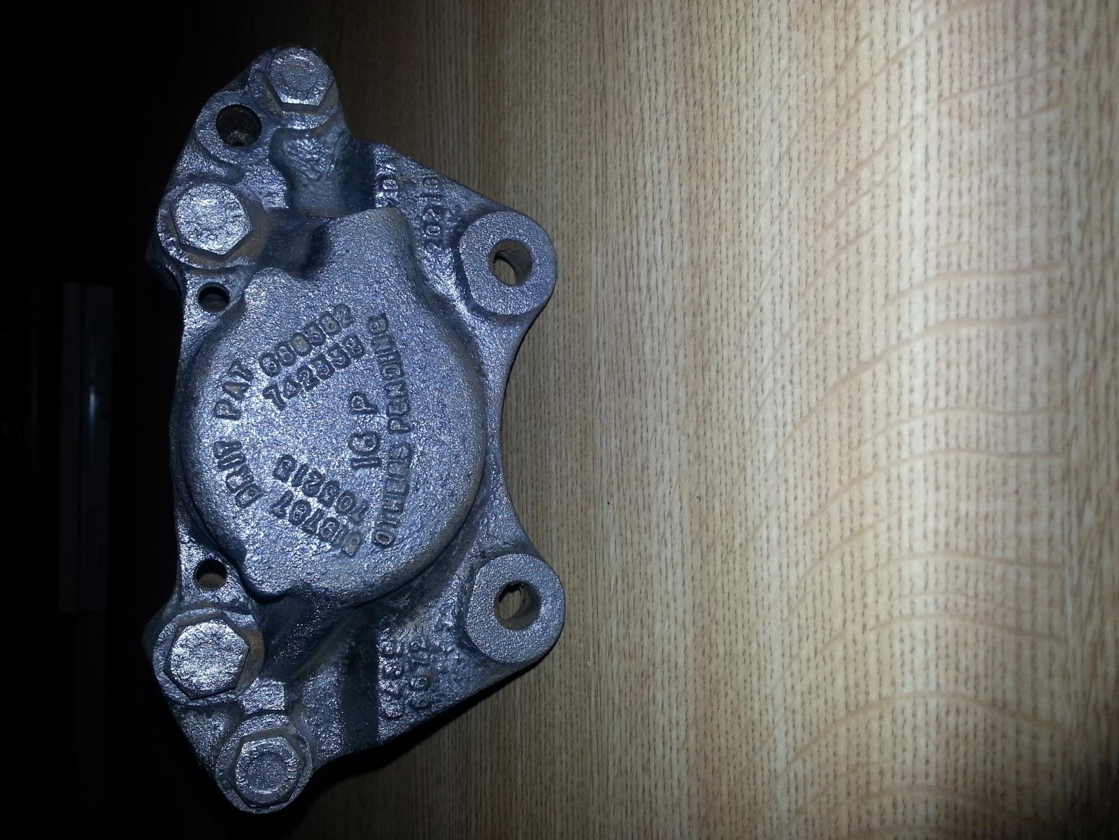

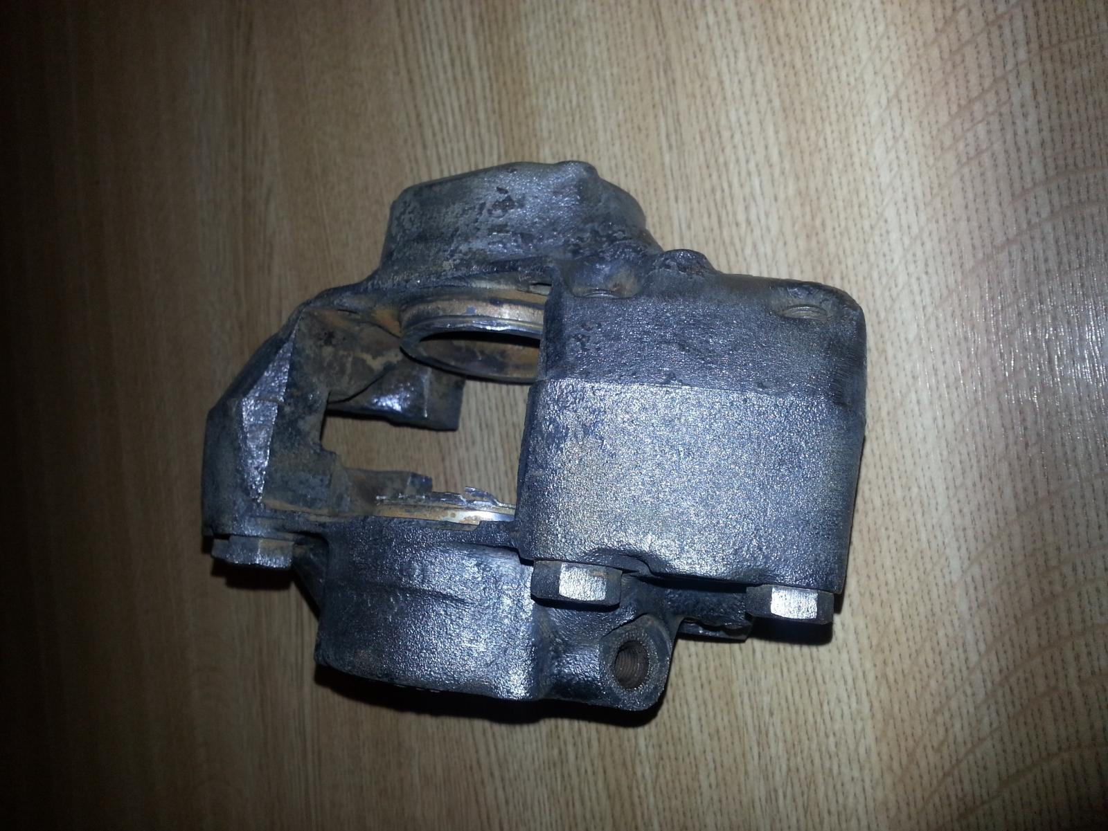

i couldn't believe it, the more i buffed them the better they got, which spurred me on to get the job done,
1 hour later and i was over the moon to say the least, the old boy was telling the truth after all, god bless him.
i was cursing him a few hours earlier and thought he'd been winding me up.
anyhow, thats the story and i thought i'd share it on here in the hope it will help someone else out with their rust woes.
here's the pics of how the calipers turned out,by the way, the black bits in the pictures is old paint and not rust either.
to be honest i felt chuffed to bits that i had saved a 50 year old pair of calipers that were destined for the bin.
i might even give james cameron a ring, if he ever manages to raise the titanic, then i reckon i could sort it with a few tins of treacle and a bucket of water :-o
i think you'll all agree they turned out all right in the end,  considering they were left for a year and not a few weeks lol.

Yes,but did it free up the seized pistons? And what condition are the rubber seals in,now?
Sod what they look like, it's the slidey bits that matter
If it gets rid of all that external rust it probably got rid of internal as well. Rubber seals probably ruined but I wouldn't use them any way After 35 years.

thanks, to be honest it was more of an experiment really. as i had nothing to lose, and thought i'd give it a bash for future reference. as for the pistons, they were knackered anyhow, and as for the rubber seals, they wern't even there. they had rotted off years ago. i dont know if i will be able to get the pistons out. that's the next step. if anyone's got any ideas i'd love to hear them.
Stick some fluid down the holes then attach a footpump or compressor line.
