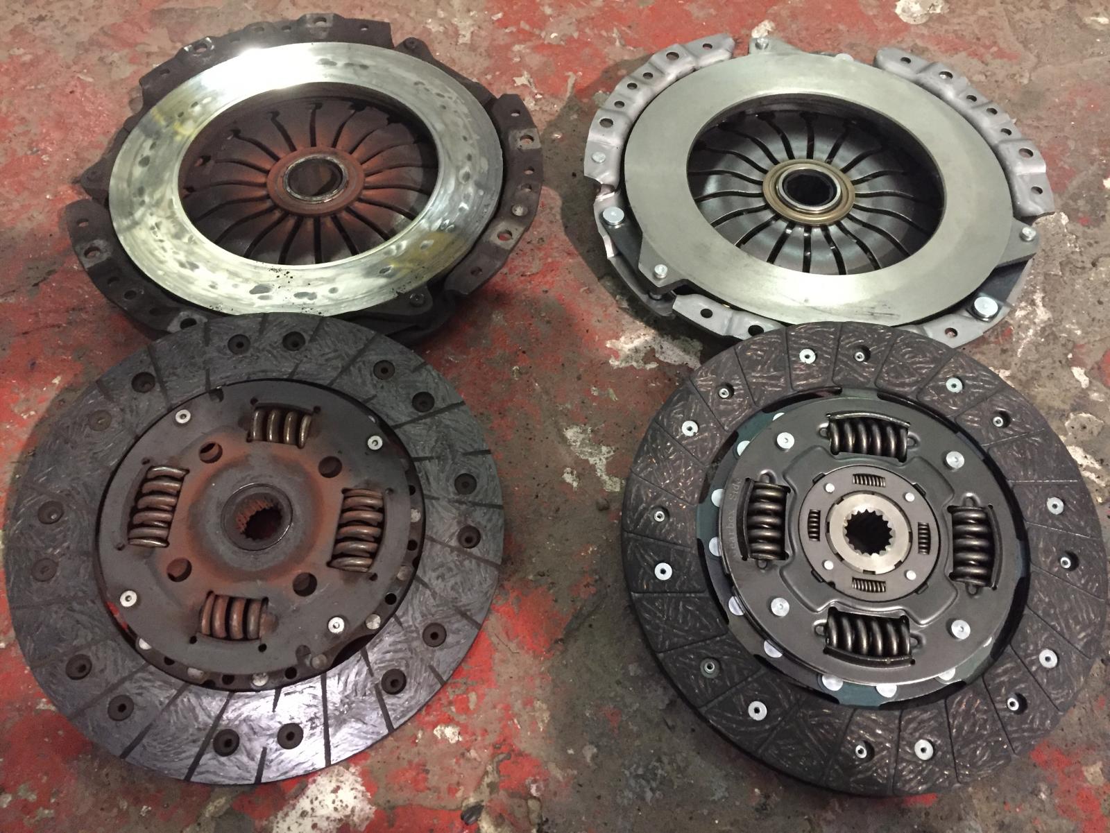

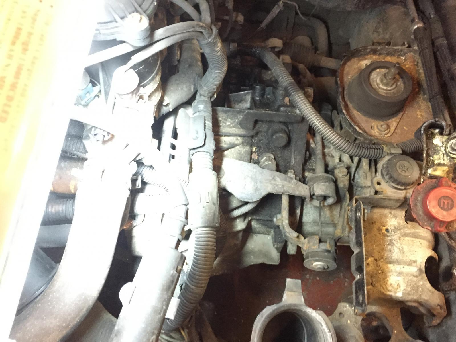

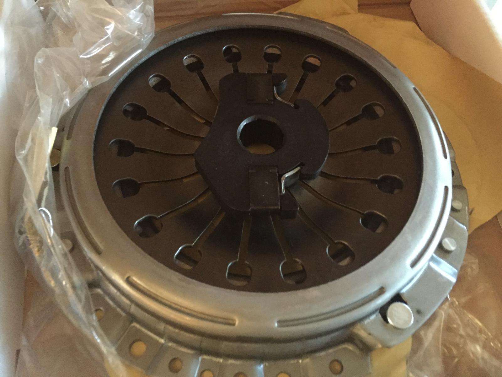

Hey all - I got the clutch for this. It looks like the pull type. I take it this is the wrong (frigging) one?
It only took a week to arrive.
That is indeed a pull-type clutch.
At least some of the 1.9TD 406's used that type of clutch though, so might well be correct.
If you can get decent look at the top of the box showing the clutch arm it'll be easy to confirm which type it is - the pull-type clutch (ie the type you've bought) has a bracket on the front of the box and pulls the clutch arm towards the front of the car as you depress the clutch, whereas the push-type clutch has no bracket and pulls the clutch arm backwards towards the bulkhead as you depress the clutch pedal.
This shows the 1.9TD gearbox with the pull-type clutch setup and the bracket I mentioned.

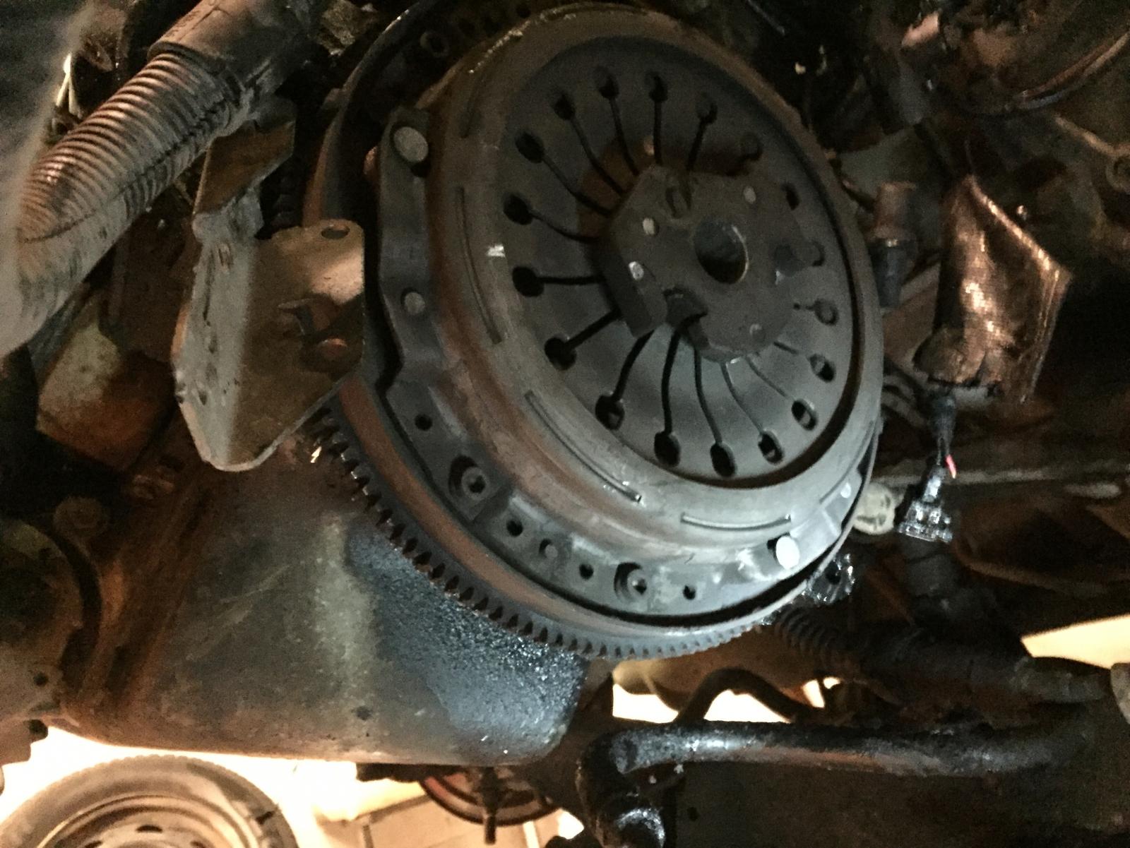

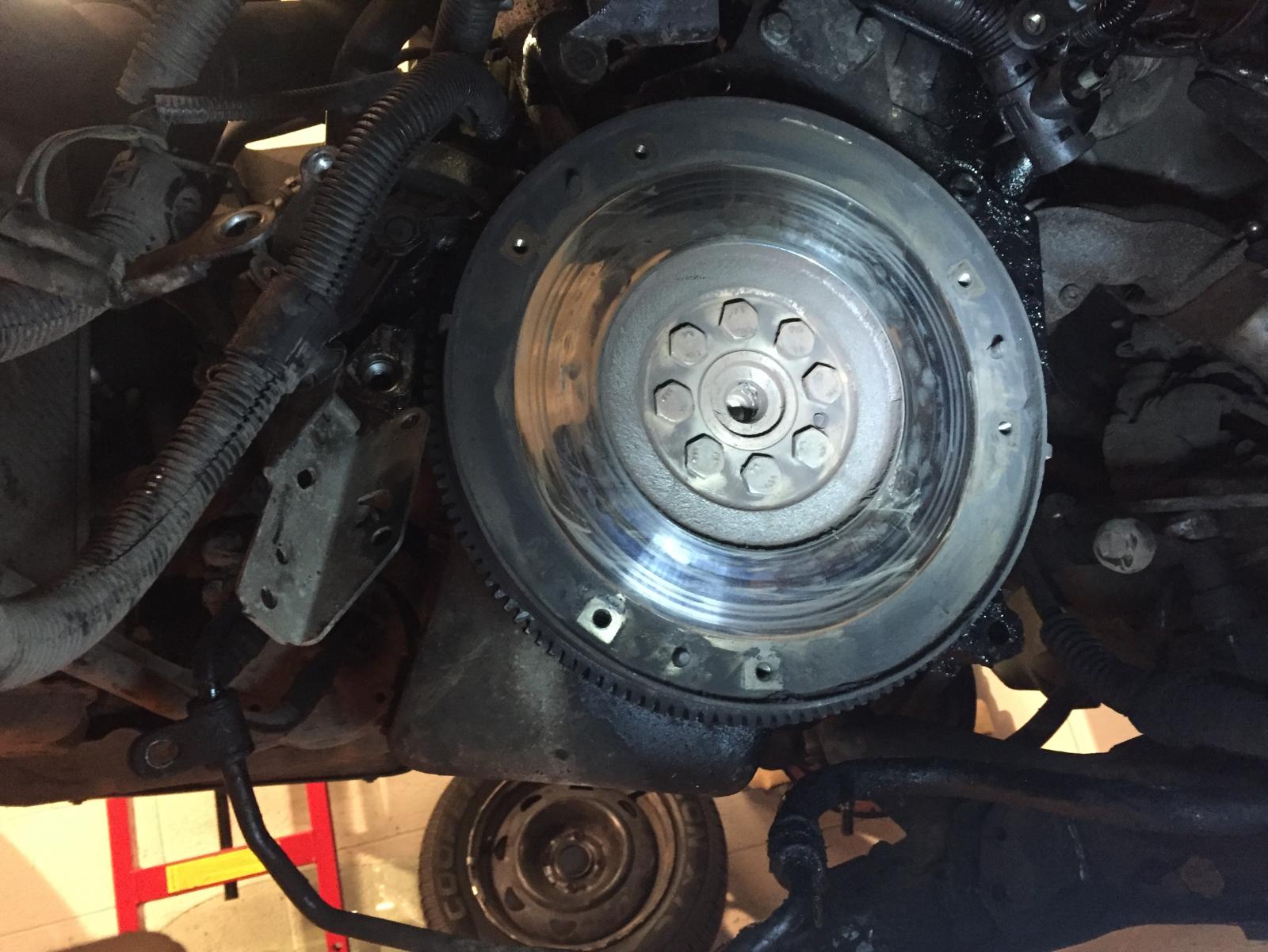

I've got everything off, which wasn't that bad tbh.
I don't think it's the clutch, but the intermediate bearing on the driveshaft mount. The fact there was a single ball bearing in it and it was seized solid makes me think about it being a bit Judders from a standstill. The flywheel and clutch cover plate are like mirrors, due to having to slip the clutch to get it going.

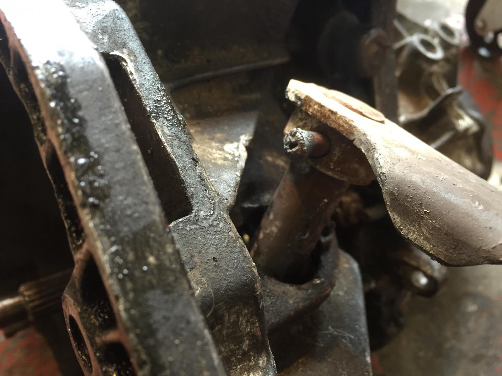

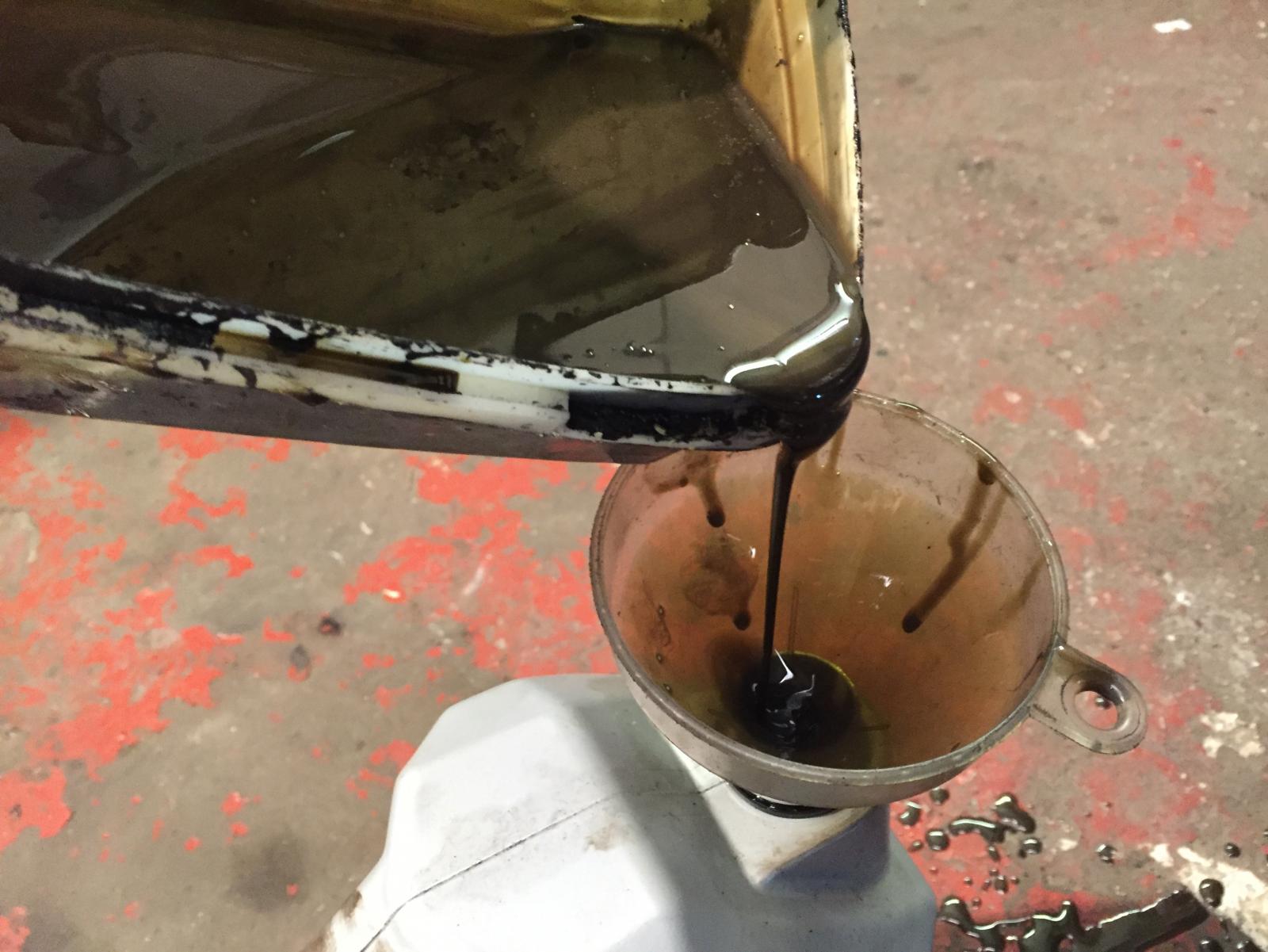

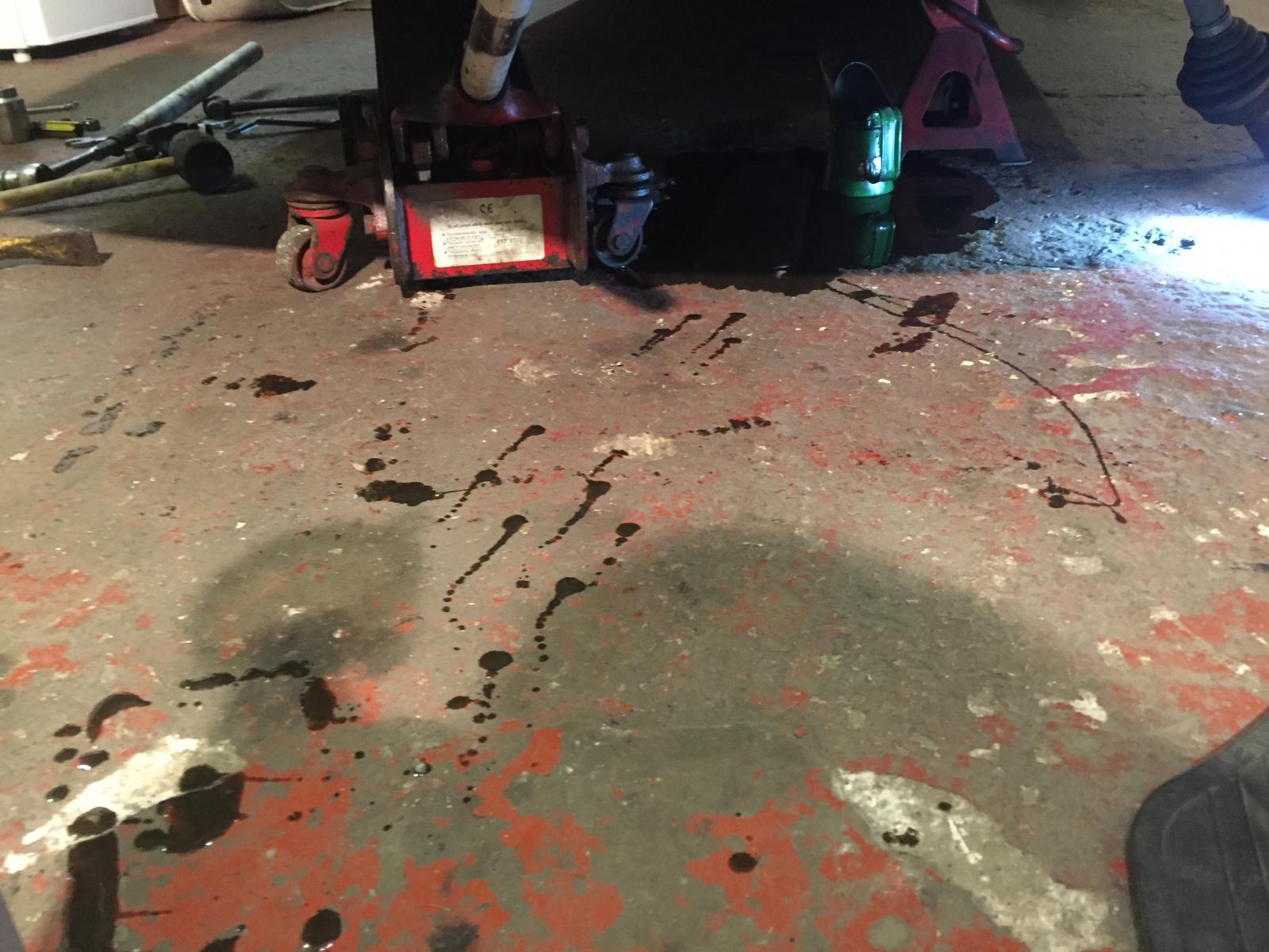

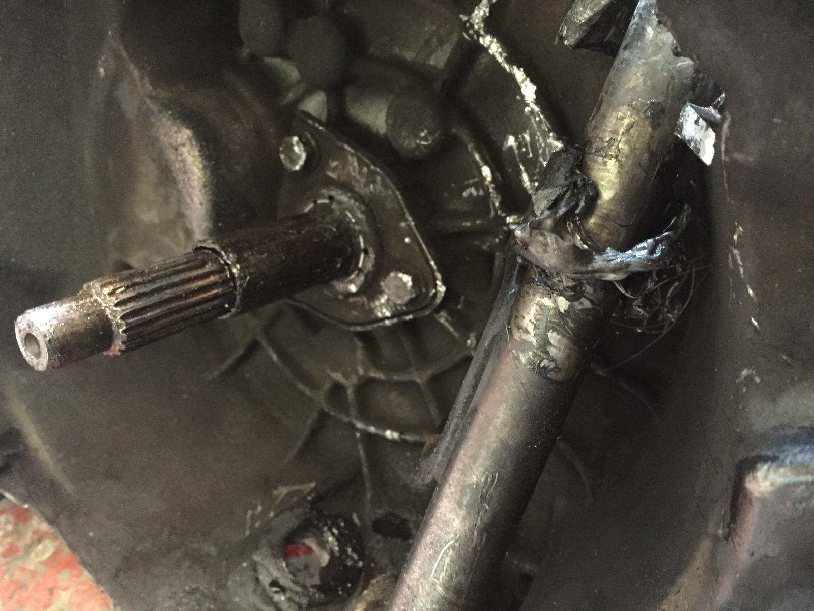

The photos show the pin on the clutch fork suddenly seizing and couldn't be removed with industrial sized heat, big hammers, welding, air chisel, etc. So much heat in fact it melted the plastic bush halfway down the shaft. As a consequence, no matter how much fluid I drained out of the box, there was always a massive puddle wherever I put the gearbox overnight.
I've since drilled the pin out, found the arm was also welded on (even though I've had both off several times during this particular clutch change), so I cut it off and put a new arm and pin in, and a brand new bush as well.
All three linkage ballpoint arms broke, so I changed them as well. Bolts on one of the arb links seized and span the balljoints, so I cut it off and put a new one on. Also changed the speedo cable because it was worn and catching at the throttle end.
Oh, something else which brought a tear to my eye - the speed sensor thing that plops in the top of the gearbox and sits over the flywheel teeth, it ended up trapped INSIDE the gearbox when I'd put everything back together again, which required me to take everything apart again. TWICE. I thought I'd leave it in and let it get devoured by the flywheel, but that probably would've broken something important. The sensor was also broken, so I etc etc etc
The culprit was the bearing on the driveshaft seizing, so the clutch change was completely un-fucking-necessary.
