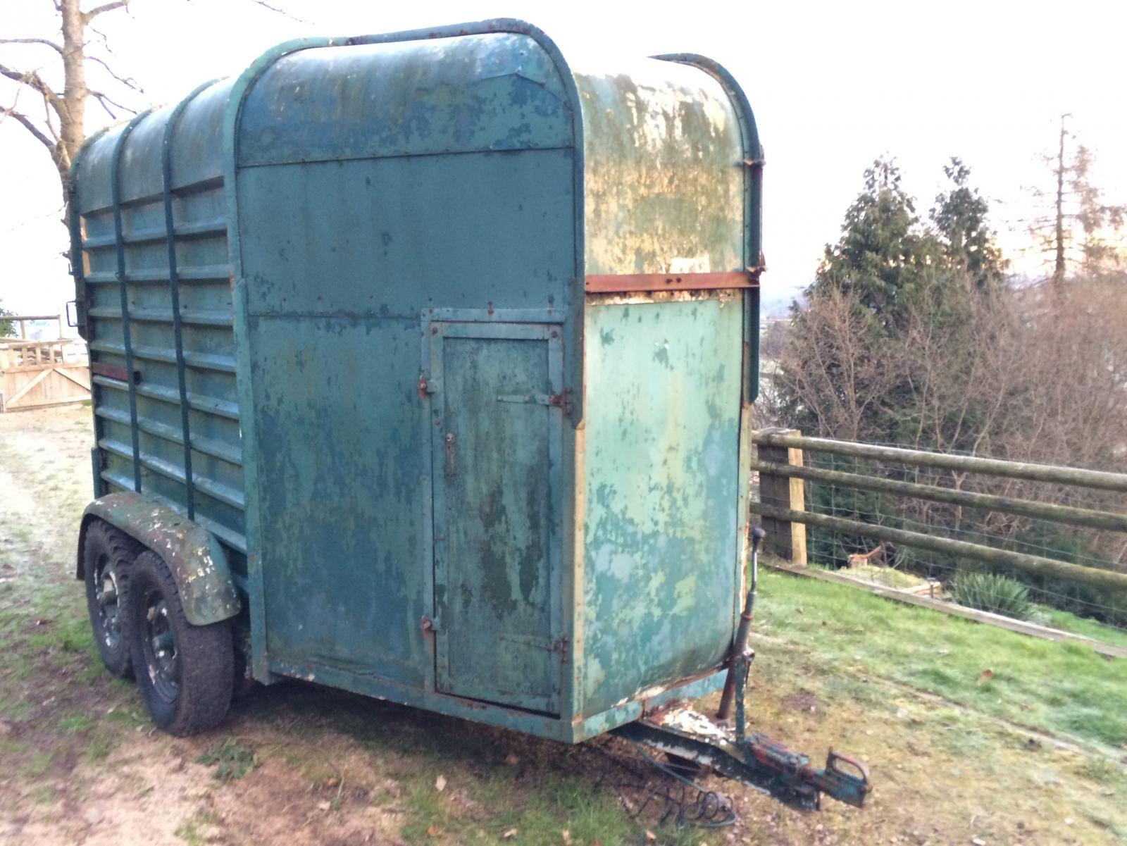

My mate Jim has won a Horsebox for £100. What could possibly go wrong?
Allegedly it's a Rice, each tyre is different and in a different stage of knackered, it needs a bit of welding, the brakes need recommissioning, possibly wheel bearing issues, needs a new floor, auto braking tow bar needs fixing possibly replacing, it needs re wiring and new lights on the mud guards where there are none presently.
Other than that, it's great, but it's been left on my lawn!
Secretly I am happy that it's here, I get to play with something that I don't think I can make worse!

It's going to cost a bit to sort. Spoke to local trusted tyre fitter. Budget ditch finders at £65 each fitted.
Need to get the welding assessed before anything is purchased. Hope to make a start at the weekend when I get it inside my shed.
If it all goes wrong it's destined to be a log store or possibly a chicken coop!
I found "debica" were the cheapest 8 ply I could get, I got them for £23+vat at trade, worth a Google
Good luck with that, I have one in at work that to be brutally honest looks way less awful than that, and it's bill for rectification is around £1,300!
That's 4 new tyres, 2 cables, 4 new brake sets & back plates (welded on FFS) a complete rewire and a few new marker lights.
I think these have the same unobtanium Rubery owen axles as my car trailer

It's really going to depend on whose axles live under it, the sheepshit transporter I'm working on has Knott axles with land rover looking wheels on...
Put some weight in it before you do anything else, it may tow OK and look fine but you need to see if the axle bushes are any good. If not then the tyre will rub on the chassis.

This is in leaf springs, which looked ok at s glance. Shackle bolts obscured by the wheels so again part of the reveal on Sunday.
Still workouts out as a cheap log store if it is a basket case!

It's a complete fail.
From the photos, it's a four pint'er. Looked ok until we got her home and saw her in the cold light of day.
Wheel nuts didn't want to budge without heat applied, so before it started to get serious, or bugger it so it couldn't move I started to poke around a bit more.
Chassis rails where the leaf springs are attached, rusty holes aplenty.
Wheels rusty, in the wrong places. No pic to explain this, will take one.
Body not attached to chassis in places. See if you can see where.

So not only is it full of shite, there is shite underneath. Bet it smells like a portacabin toilet as well, poor horses.
Today I waved goodbye to the box. Its gone to a friend of a friend, a farmer who likes to tinker with old stuff and has the time, space and a sparkle stick so he can patch it up.
Jim is under instruction, next time we go and kick the tyres before he purchaes blind.
