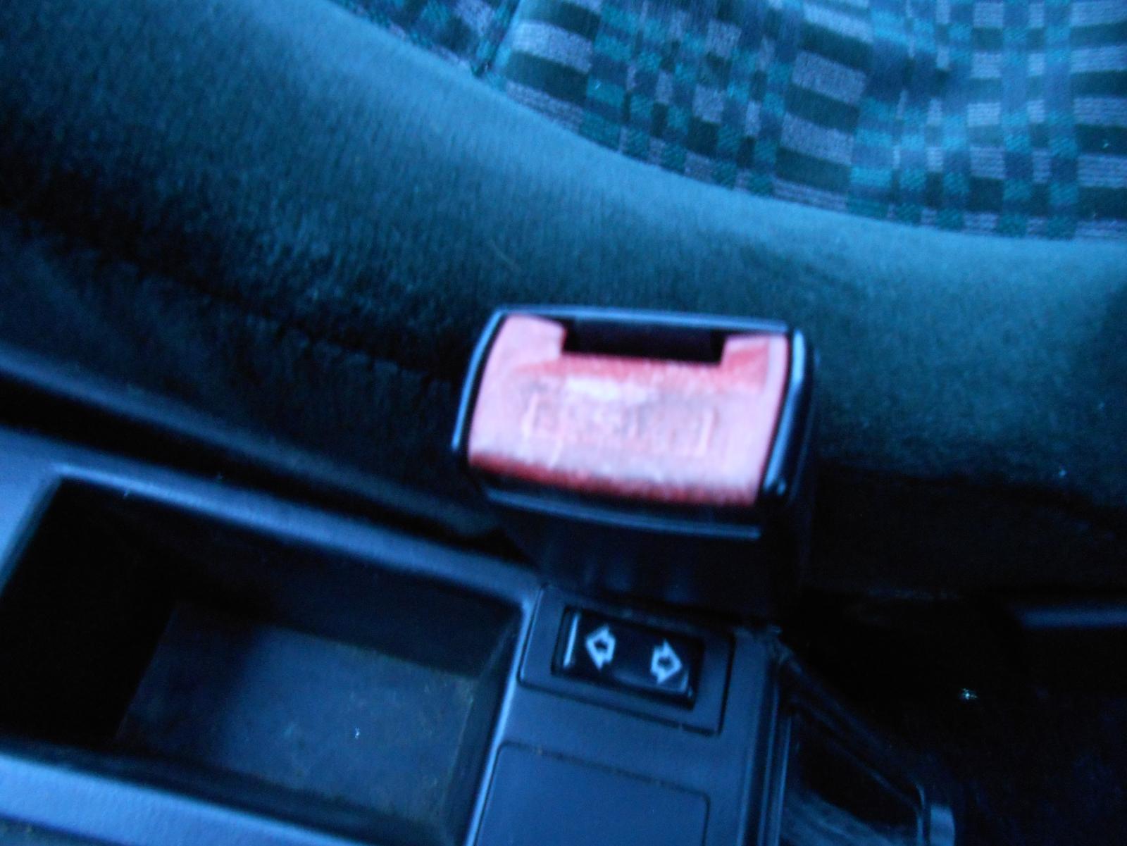

Unfortunately something that has gone wrong is communication between the Royal Mail and the Danish postal service, so the front seatbelt stalk I had on its way has now been returned to sender. Does anybody a bit nearer have the right one going spare? It's the later type with 'PRESS' embossed into it.
I did have some spare belts at one point. I wonder if they're in the bike BX part stash?

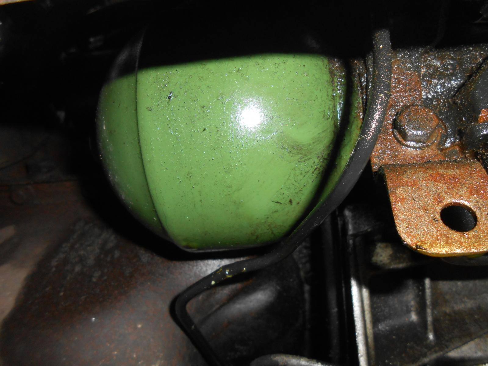

As for the accumulator sphere, it appears to have seized in place. A chain wrench, hammer and chisel and lots of WD40 have all failed to move it an inch. Bloody car.
Lump hammer and chisel has never failed me but it sometimes takes a canny bit of percussion...
Have you got a proper sphere removal tool? They can require several whacks with a hammer, but space is a bit tight around there. I assume the drill is the same as suspension spheres - ie crack it off under pressure then depressurise?

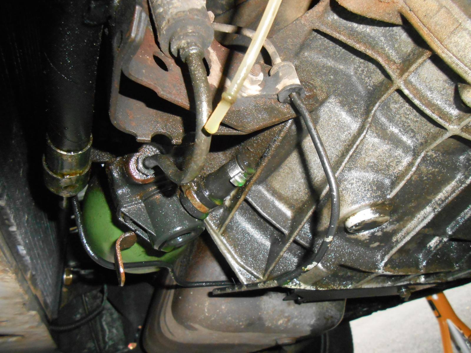

Pipe looks like a return pipe of some form. Can you see where it should go? Pipe bodgery is ok on low-pressure lines.
My first instinct was that it fits in the hole on the end of the pressure regulator from which LHM is also escaping but I'm not 100% sure. It doesn't seem to want to stay in there very much, but I have previously acquired a roll of Britain's strongest* gaffer tape which may solve this problem.
I'm going to have another try with the hammer and chisel in the morning, unfortunately I didn't get a sphere removal tool in the week and none of the local motor factors have anything suitable so more rudimentary implements are being used.
Procedure is delightfully simple really, loosen pressure regulator release screw slightly for a few minutes, whip sphere off, new one on, then much twirling of the release crew again until the rear suspension rises up to service high.

That pipe has probably blown off *because* the accumulator sphere is flat. Gaffa tape will not help you in resecuring it; you will need to remove the single use clip and replace it with a Jubiliee-type clip.

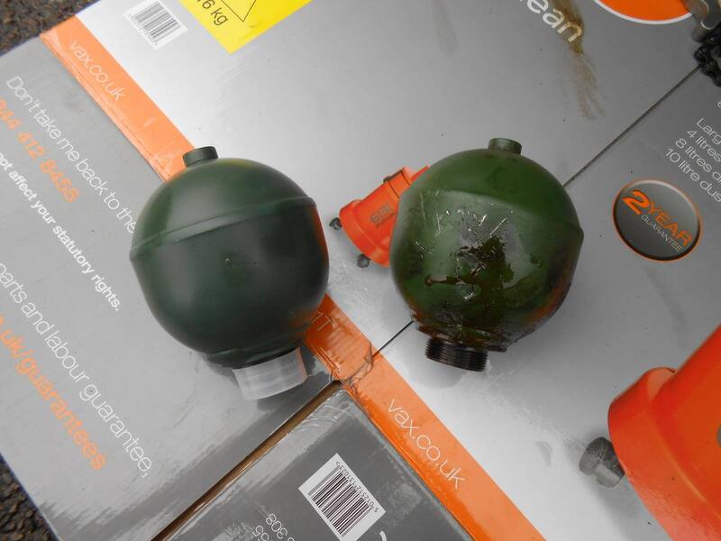

The BX now has one shiny new accumulator sphere. A pretty major improvement without having even driven anywhere, it now rises smoothly rather than in notches and without the excessive ticking and clacking of before. It's now rather boring timing the tick time as it doesn't happen for a good while.
Unfortunately nowhere that sells 6mm jubilee clips seems to be open today so I have done a guilty gaffer tape bodge  to that loose pipe just to keep everything fluid tight until tomorrow.

If you have a length of aluminium bar, give the alloy casting the sphere screws into a good rap with a hammer on tother end of the bar, in the area where the thread is. This is the recognised effective method of shifting a stuck sphere thread, it's never failed for me.
Also, DO NOT use anything other than hand pressure when doing them up. Like oil filters, one problem is people wanging them on with far too much force. 'Tight by hand' is fine.
