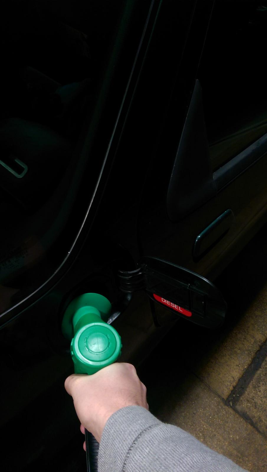

How coincidental!
Mine is running well on a high veg concentration (30l of veg to probably £10 of derv) after wills visit to Danny last week. It was running fine tbh, started fine as proven in the clag thread.
But, heeding advice on here I lobbed a tenner of this in on the way home
I'll brim her up with veg in the morning when I can see what I'm doing and not slop veg all over me/he car.

Do you ever folk saying you miss fueling the diesel?
I was the only one at the station, but I put it up on facebook and got a few people commenting 'oh noes' about it!
It did feel slightly odd I have to say, mainly because I make myself double check when filling up the meriva and my car one after the other occasionally.
