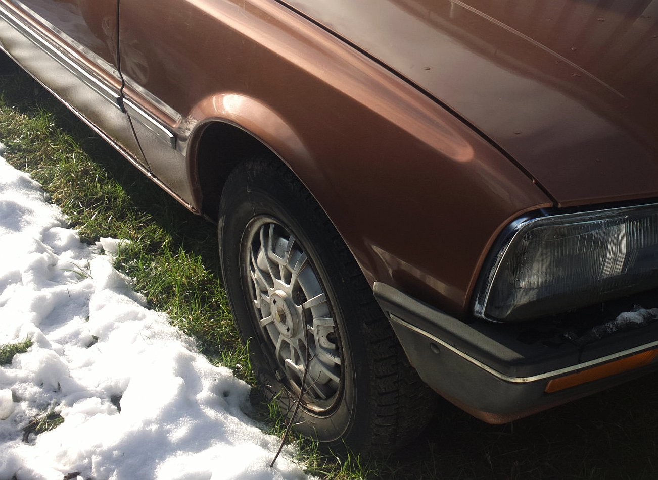

This was the plan:
- clean engine bay
- remove sparks
- check cylinders for visual damage with spy camera thingy
- fill WD-40 into cylinders and let work for a few days
- remove head covers, visual check camshaft etc, put some oil there.
- check electrics
- fill water, check for leaks
- check starter
- check ignition
- check spark plugs
- check oil
- clean carbs
- clean tank
- change fuel lines
- check fuel pump
- hook up battery
- slowly turn engine with ingnition coil disconnected get oil around and everything lubed.
- try a starting the engine
then a variant of shitefeaverish impatience set in, so this is what happened:
- clean engine bay
- remove sparks
- check electrics
- check starter
- check ignition
- check spark plugs
- check oil
- clean carbs
- clean tank
- change fuel lines
- check fuel pump
- hook up battery
- slowly turn engine with ingnition coil disconnected to get oil around and everything lubed.
- feed fuel from bottle
Please turn up your speakers, here comes the best sounding engine ever bursting into live after 24 years of silence:
http://www.youtube.com/watch?v=mRWkP7FiLmk

Ooofff!!! 1 sticky valve,that will go once run a few times. YUM YUM
That was hardly bursting into life, more like reluctantly chugging. Mixtures all over the place, maybe a cylinder down (stuck valve? Something was blowing when it was cranking) but, my god, after 24 years? Get the pope on the 'phone we have a miracle! :shock:
It endend up idling smooth, well... as smooth as an early PRV can. Don't forget, its a 90 degree odd fire with constant rumble being built in.
