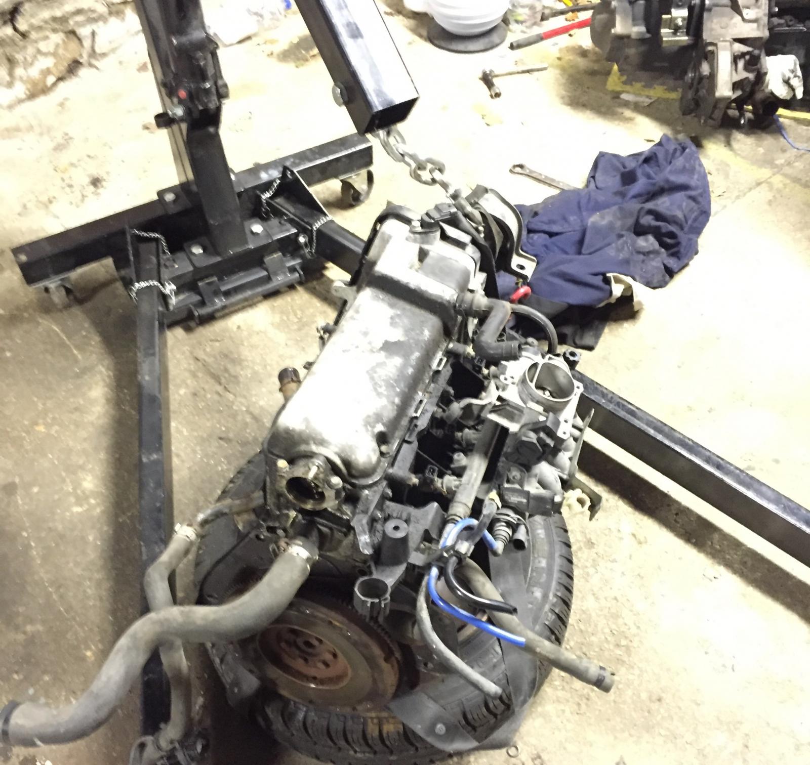

One engine
Seems to have an oil leak or two. Better sort it out and clean it up before fitting
New engine in all its oily glory
Clutch is date stamped 2012 and looks OK so I might get away without changing it although might still do so to be on the safe side
Need to replace the sump and rocker cover gasket. Not keen on the push fit oil filler cap on this slightly older engine but I don't think the rocker covers are interchangeable :(

Are you putting in another 1.1 or a 1.2?
Can't believe how tiny it looks!
Its a 1.1 and yeah so tiny - lifted it into the back of the Scenic between the two of us without using a crane

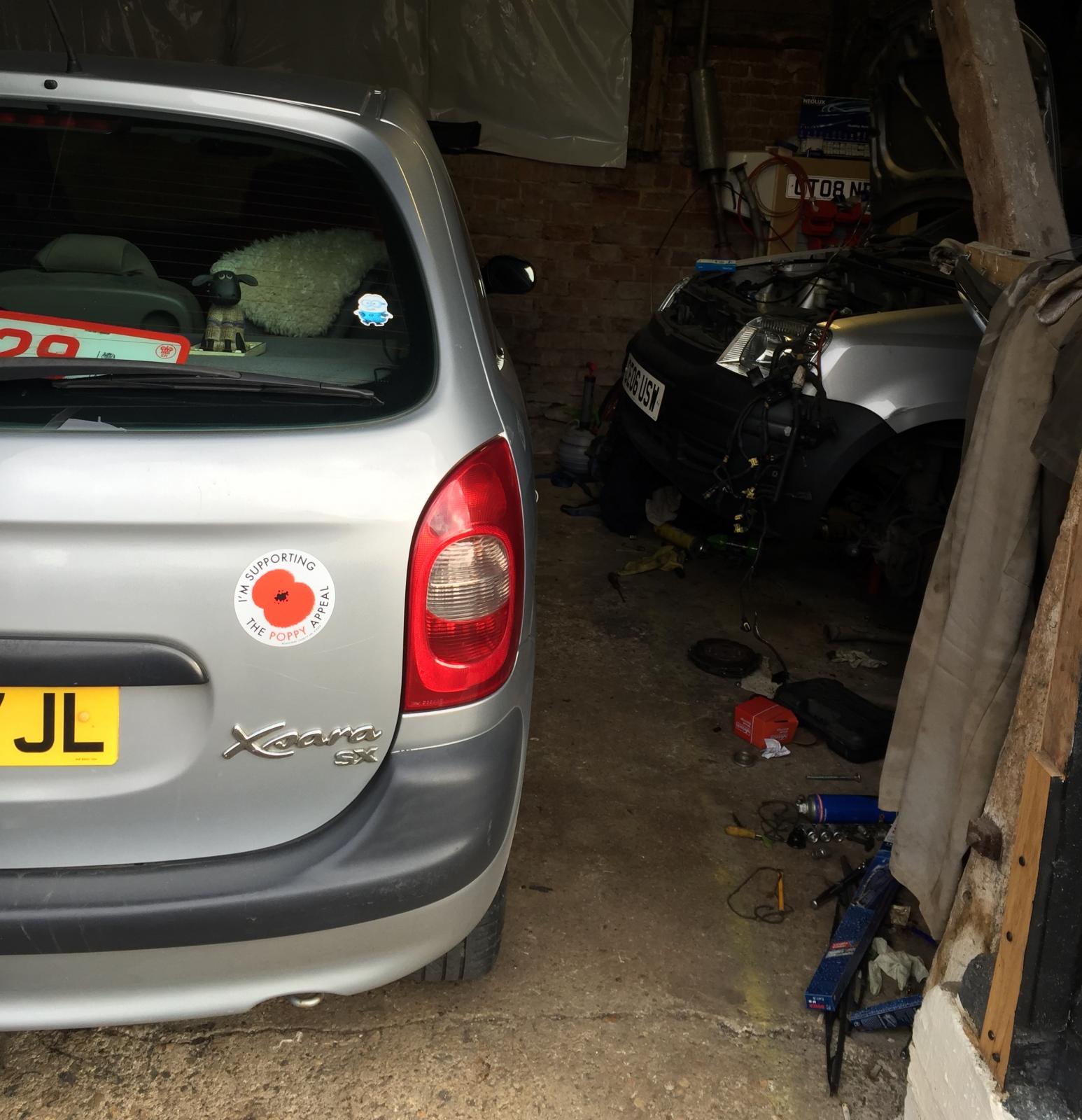

Haven't had time to look into it further - got a full house again fixing my FiL's Picasso ahead of a MoT retest next week
Fixed the only failure item in about 5 minutes (loose brake hose) but the exhaust is blowing slightly at the front. Fixings are bollocksed so I'll need to get new ones tomorrow
