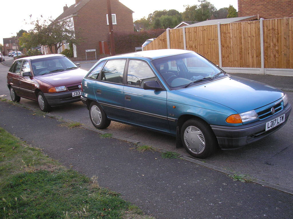

How odd, these are my mum's previous and current GLS hatchbacks, in the same colours. Red one was getting tatty despite stupidly low mileage and being garaged, so when she decided she'd go to driving an auto I was pleased to find an identical spec, equally low mileage one that a friend wasn't using. She'd bought it from another of my friends and never even driven it in a year of owning it. Turns out the elderly owner who'd had it from new before my friends had it lives in the same village as my mum, and they have met randomly and chatted about the car. Last in a string of tedious coincidences is that I owned L510LTW for a short time, a 1.4 3-door Astra I fixed after it burnt an exhaust valve

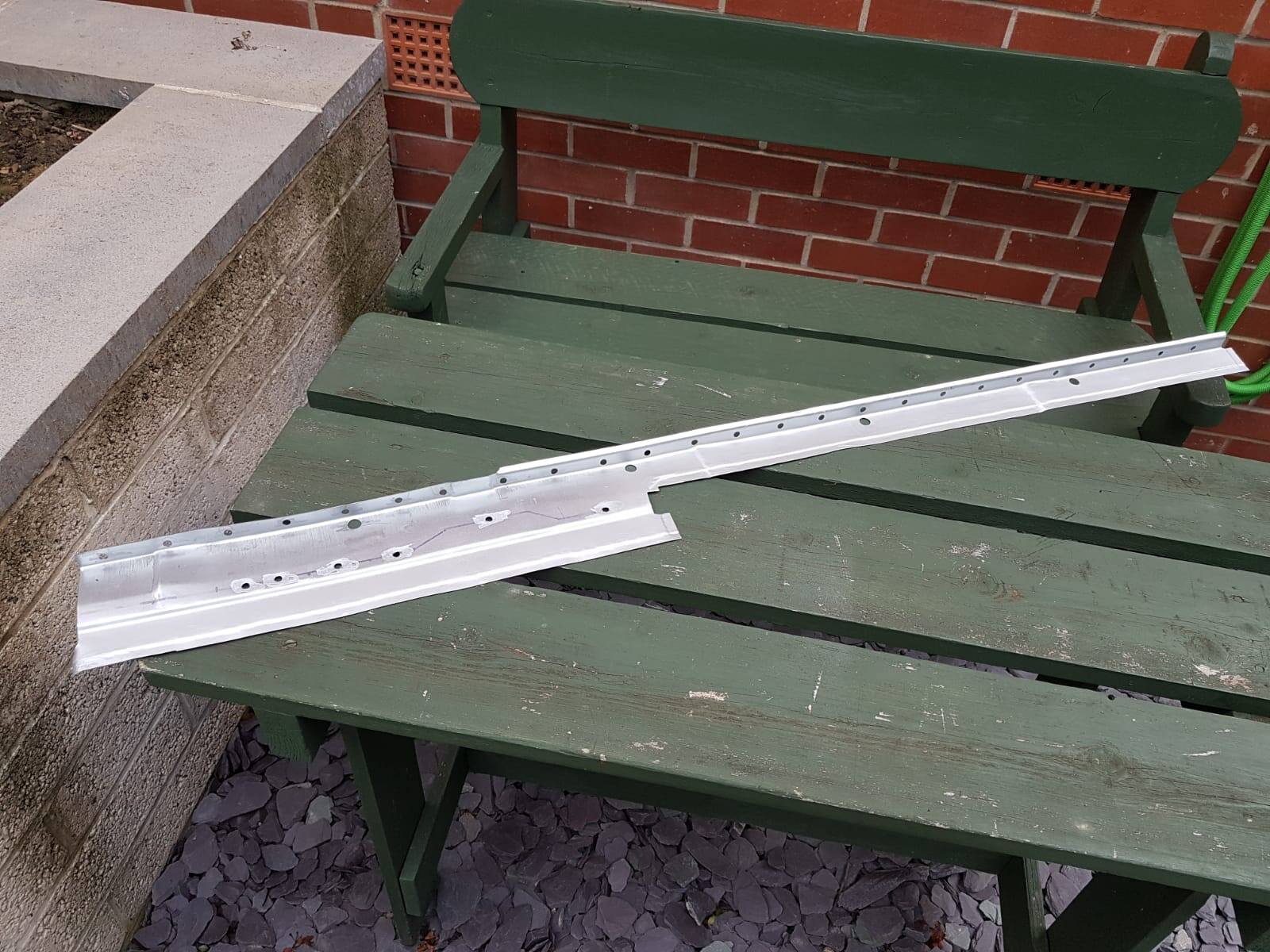

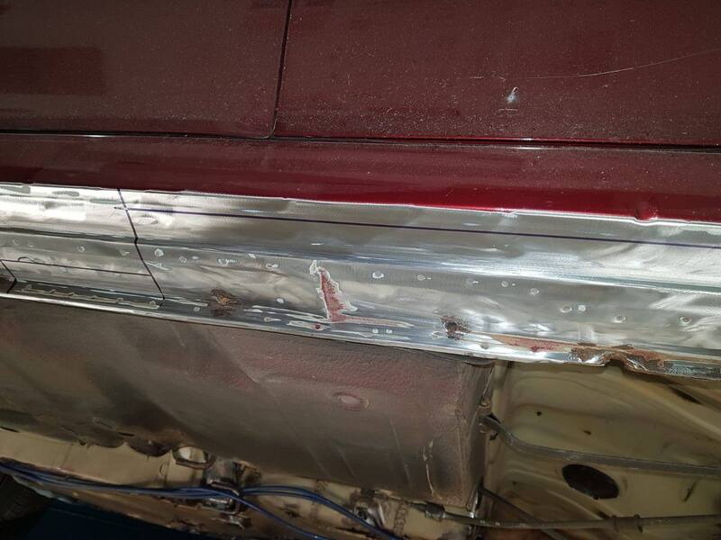

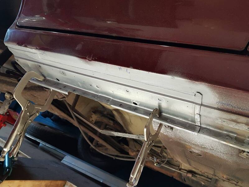

We had a weekend off as the arm on the linisher had seized and a new one had to be ordered. Anyway, to bring things up to date; the off side sill is finished. See below.

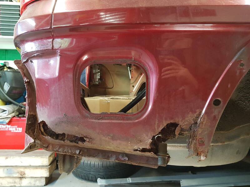

This weekend, work began on the bit that hides behind the rear bumper (and gets to rot away unseen!)

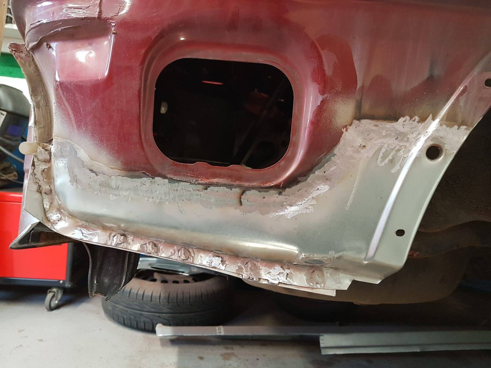

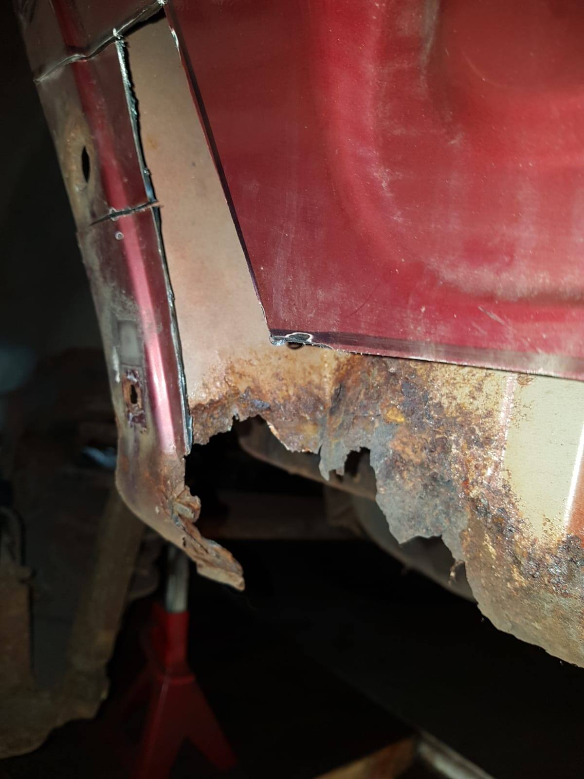

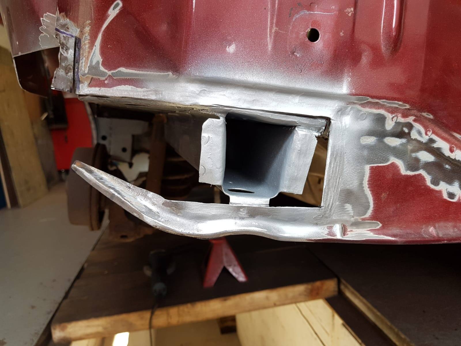

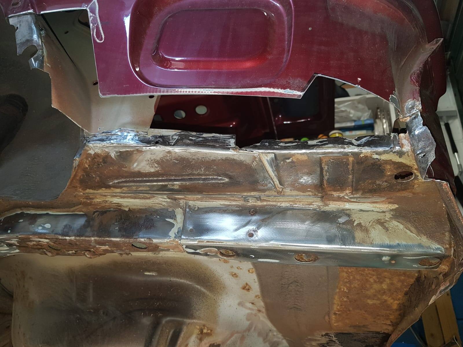

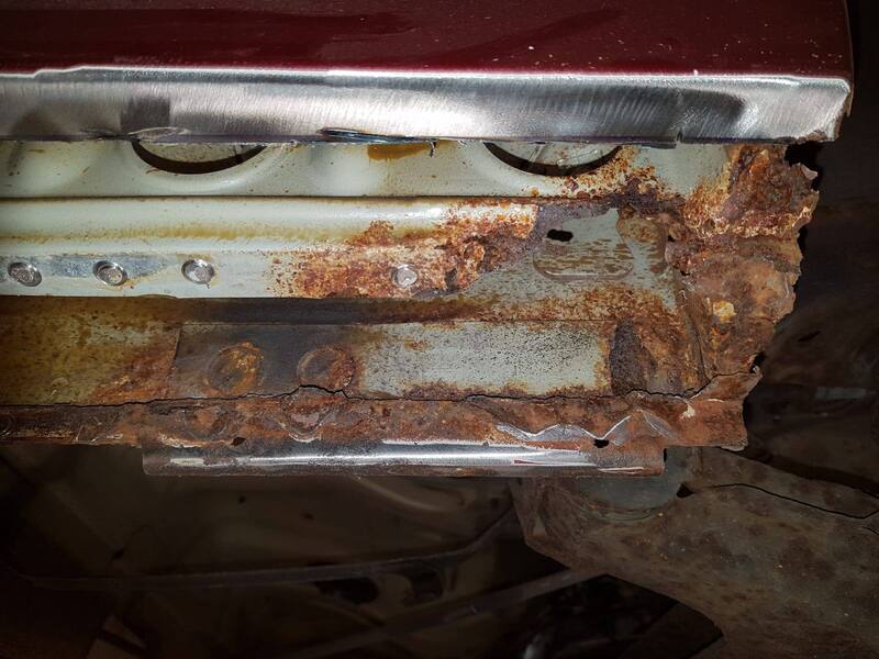

Remember that rusty rear quarter from above? Well, its solid again now. Just a little tidying up to do.
...and for comparison;
Holy cow
That's some epic rust
Great job with the welding ..Once it is painted it will look fantastic
Keep up the good work

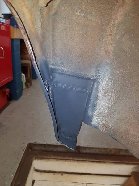

Today; closing piece for the rear quarter/wheel arch made and fitted. That's the welding done for the off side.
7 hours ago, sierraman said:
Love to see some good welding. What are you painting it with?
Just a coat of etch primer at the moment. There's seam sealer to deploy when all the welding is done.
That is fantastic welding. Is that a bought repair panel or do you have amazing fabrication skills and made it yourself? Either way, superb job.

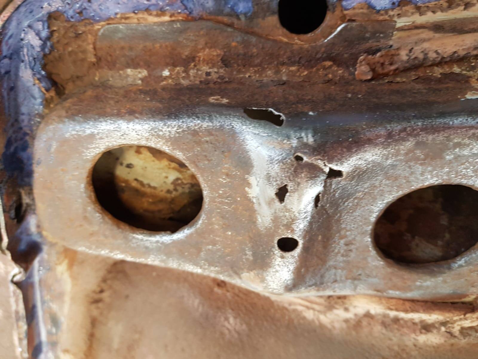

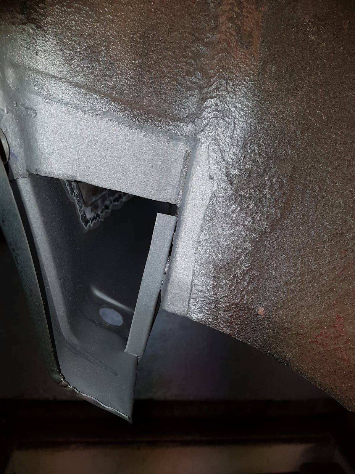

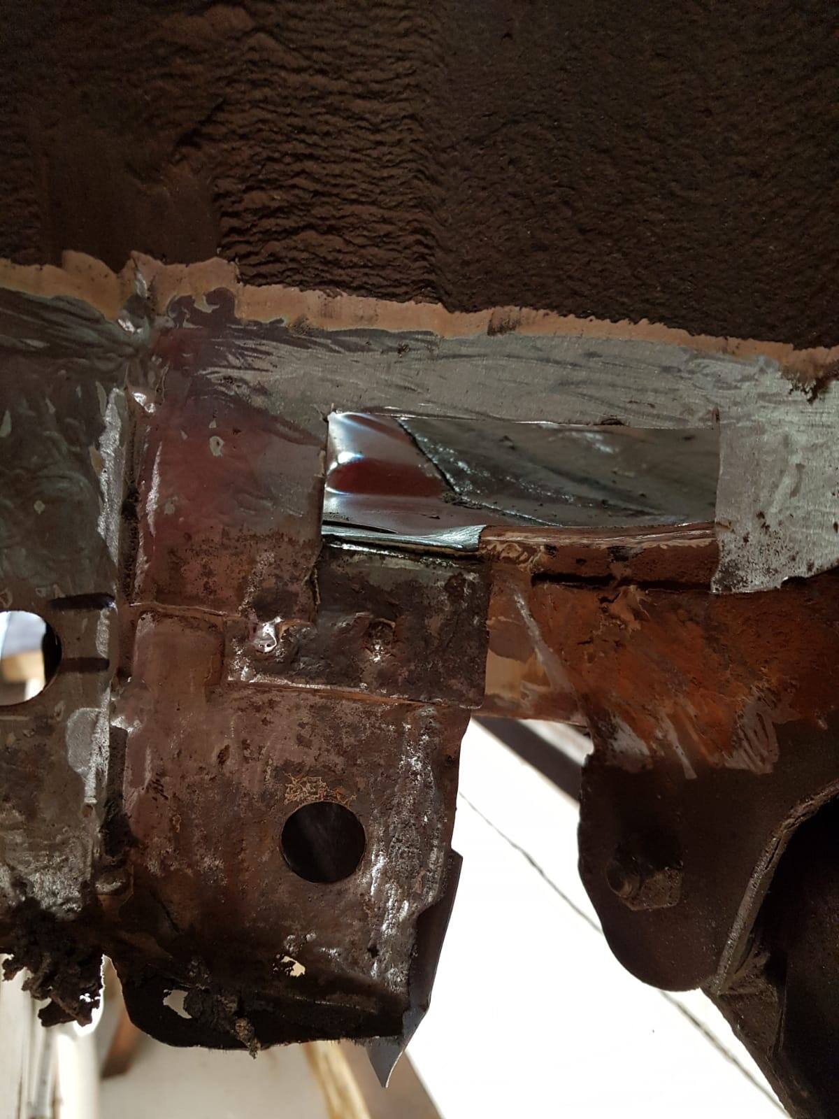

There was a little bit more welding to be done on the off-side after all. A couple of small repairs; In the fuel filler neck where a metal tab that supports the filler neck needed replacing, and the jacking point at the front of the sill.
Now it really is finished on that side! Today the driveway was emptied, I vac'd the dust off the Astra and a neighbour was roped in to push the car out the garage, down the drive, on to the road, turn it round and back up the drive and in to the garage. Time to do it all over again on the other side...

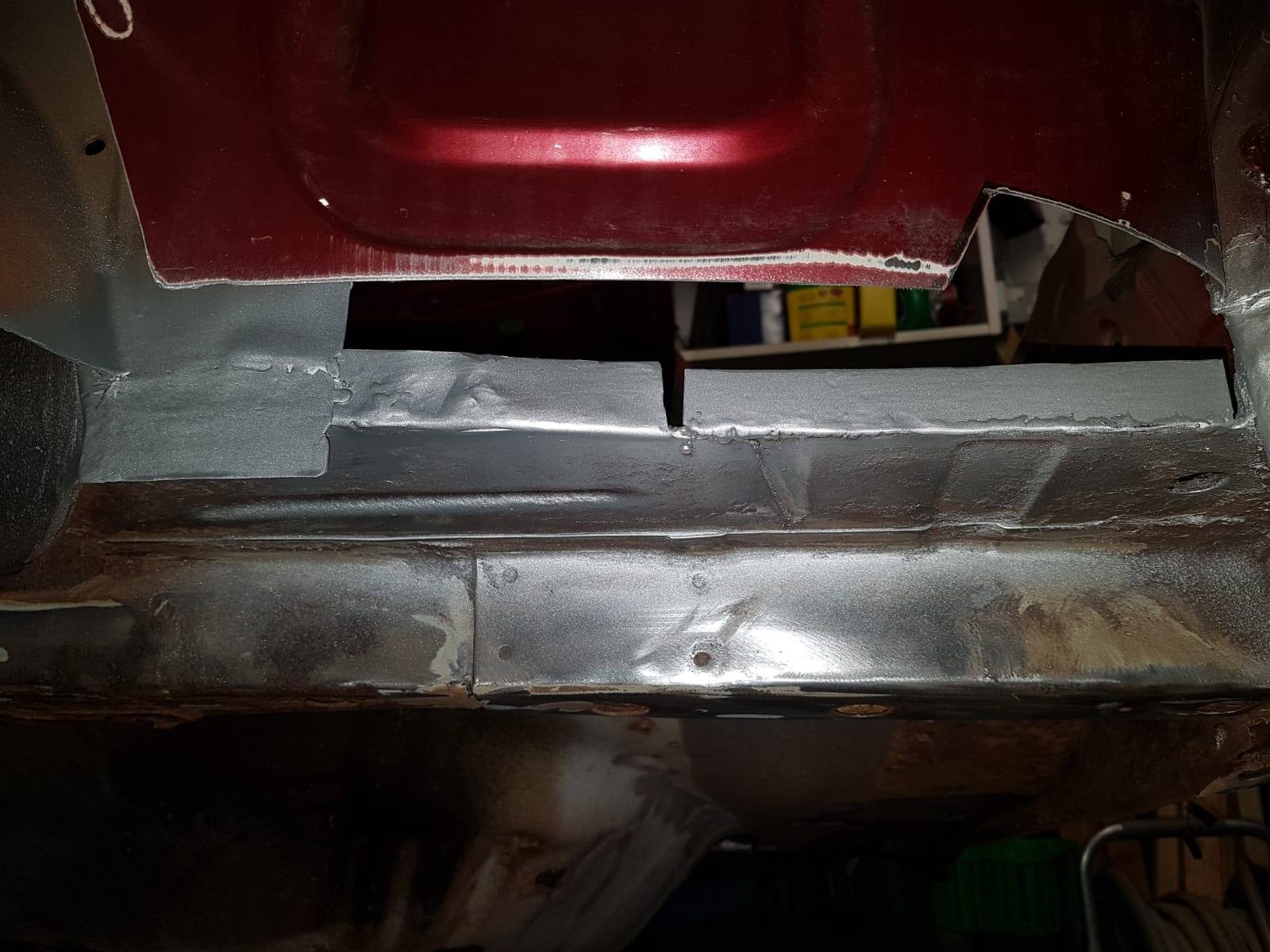

End of the near side sill completed. On to the sill itself, next.
Your fabrication skills are great. I wish I could make random panels like that lower rear quarter !
In the past week;

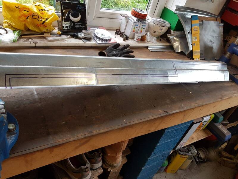

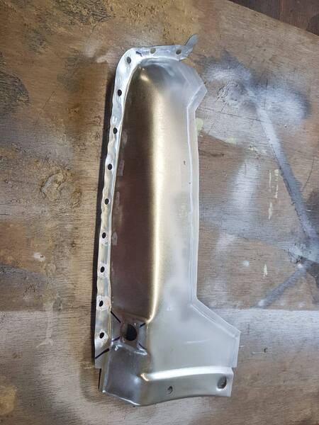

Patch for the sill marked out on the repair panel...
Cut out...
...and welded in...

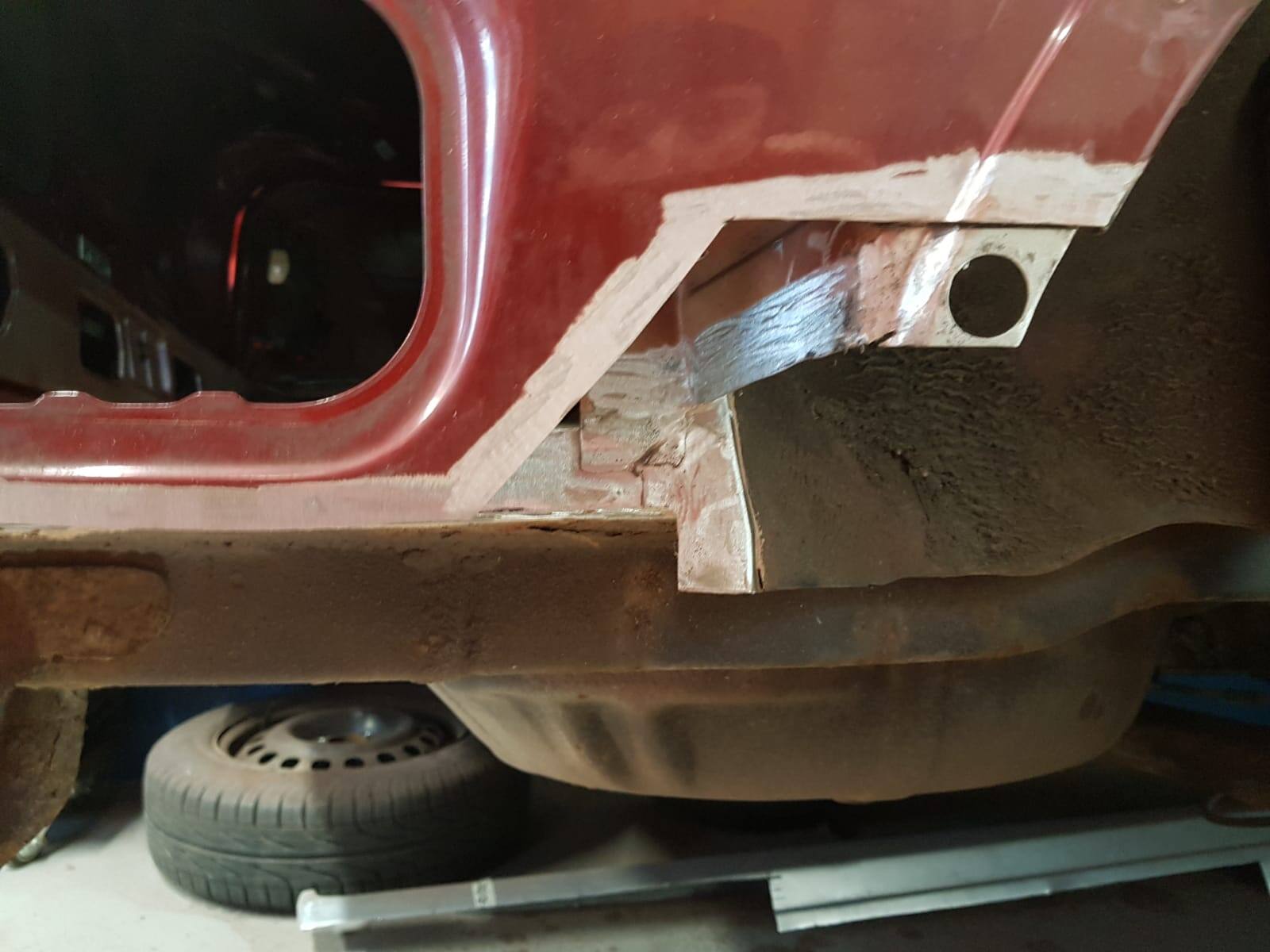

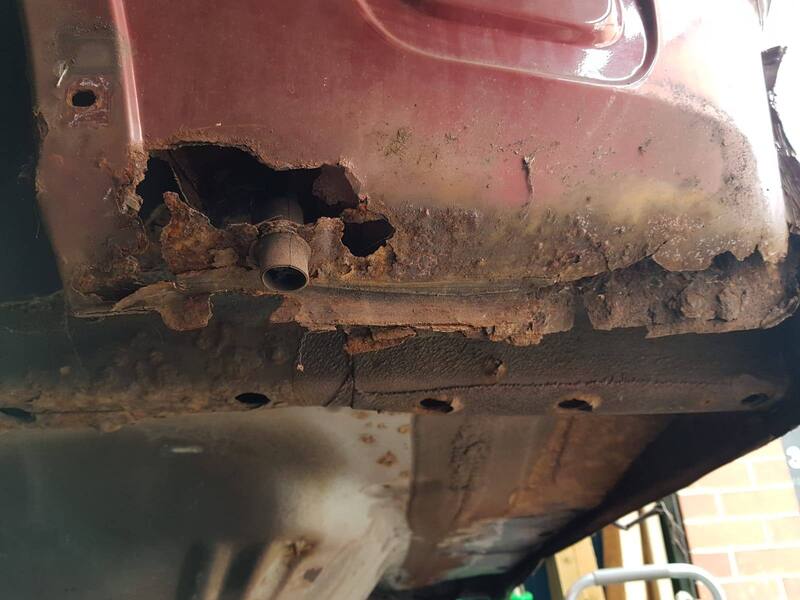

The past few weekends, things have moved on to the nearside rear quarter behind the bumper;

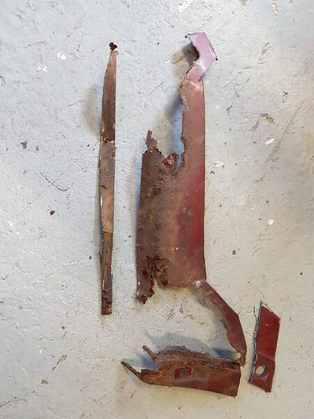

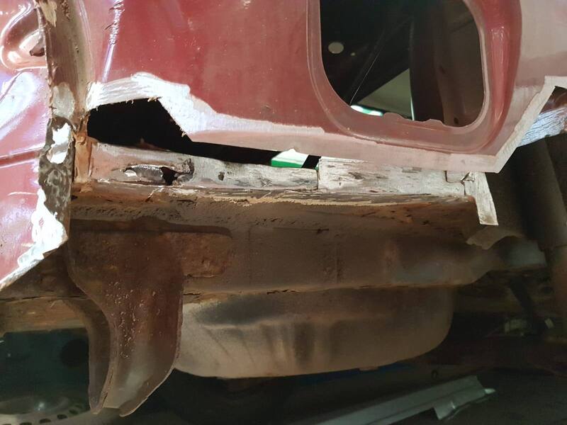

Cutting away the rot...

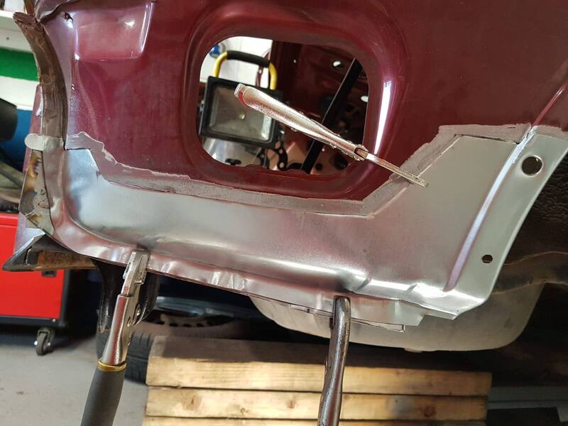

Here's what it currently looks like after some repairs...
There was also a bit of the back panel on this corner that needed work;
Ta-dah!

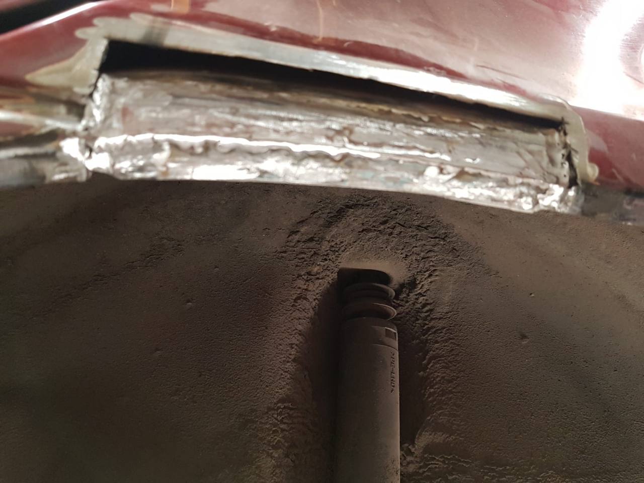

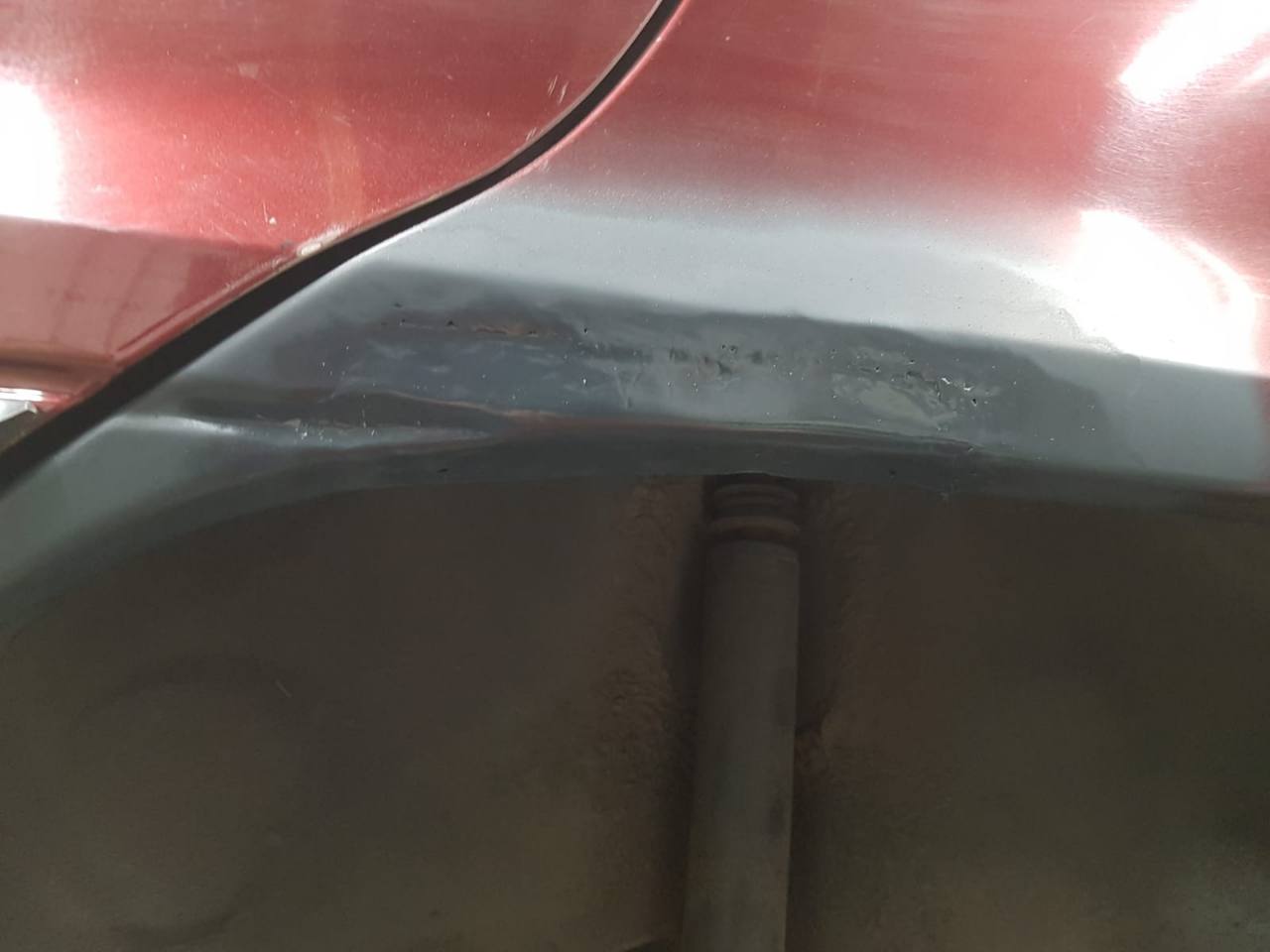

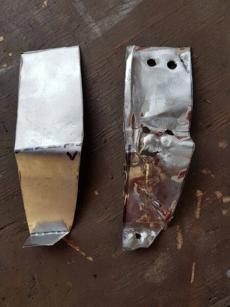

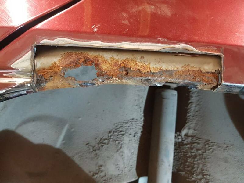

Weekend just gone, and work finally got round to the only visible bit of rot on the entire car (everything up to now is either too low down to see, or hidden by the bumper) and that is the nearside rear arch. It was only a small scab, and buying a whole wheelarch repair panel seemed a bit wasteful, so a bit of forming took place. It's not pretty, but it's nothing a bit of filler won't hide.
Excellent work!
This excellent work really encourages me to get on with my two cars, which are similar but haven't lived so close to the sea.
Be good if you could do a bit of a lesson on making panels up. Every time I knock something up it looks like I’ve formed it with a brick hammer.

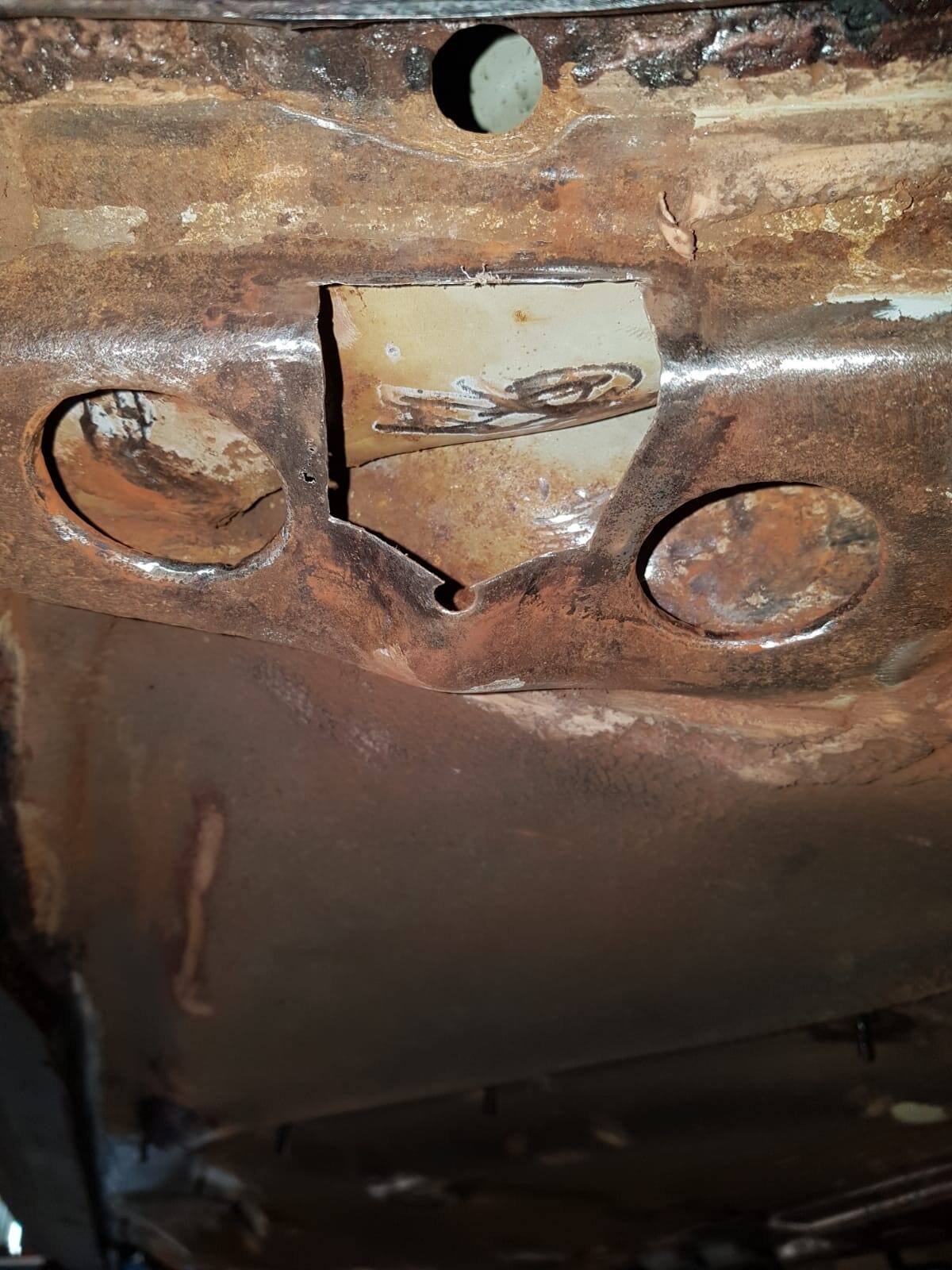

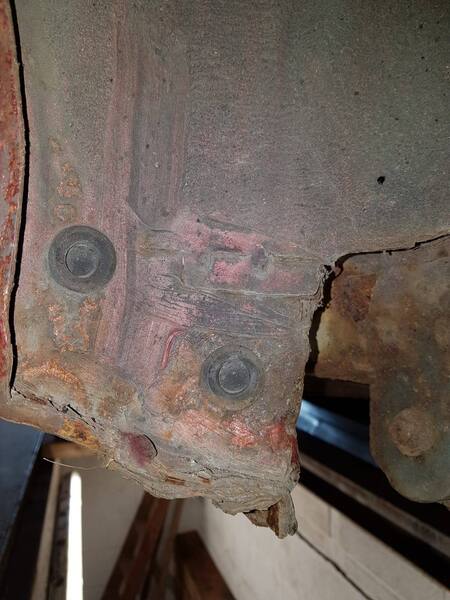

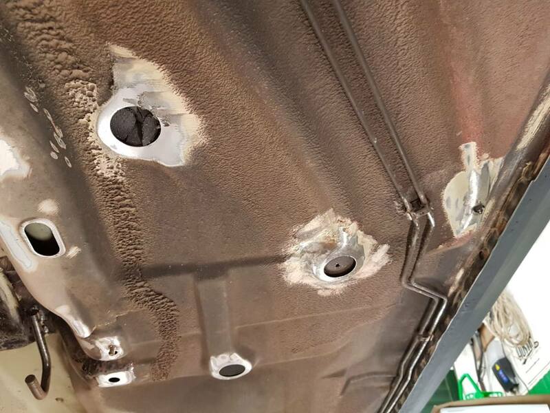

Today, all the nearside floor pan had anything scabby looking rubbed down and treated. No surprise welding found on this side, thankfully!

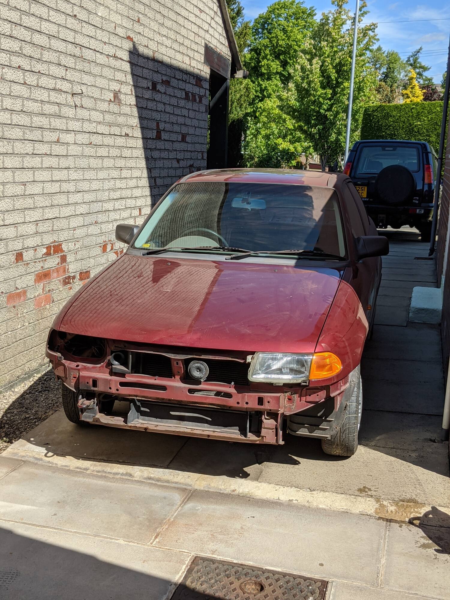

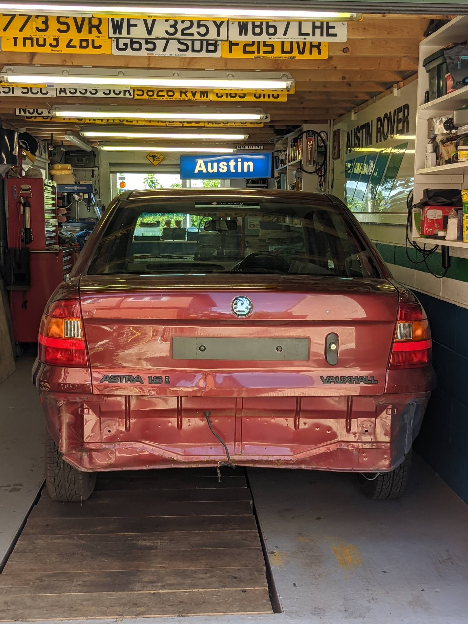

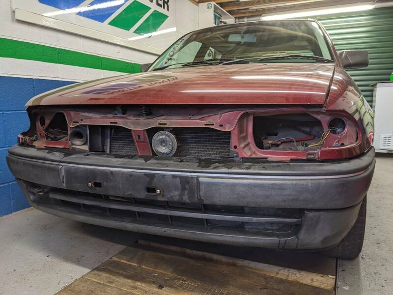

So, that's all the welding done! It's back to being a solid and usable shell for the first time in years! There's still the rear panel to straighten out (following being rear-ended on the M62. See further up the thread) as a 'big' job, but other things mean the Astra will have to go on the back burner for now. The day finished by reattaching the front and rear bumpers (They're self-storing that way!), getting it off the axle stands and vacuuming the dust off it.
It's being moved outside next weekend as there's two Rovers that both need attention for the MoT, and they're currently 'bed blocking' on the driveway. So, this is likely to be the last progress report for 2020.
