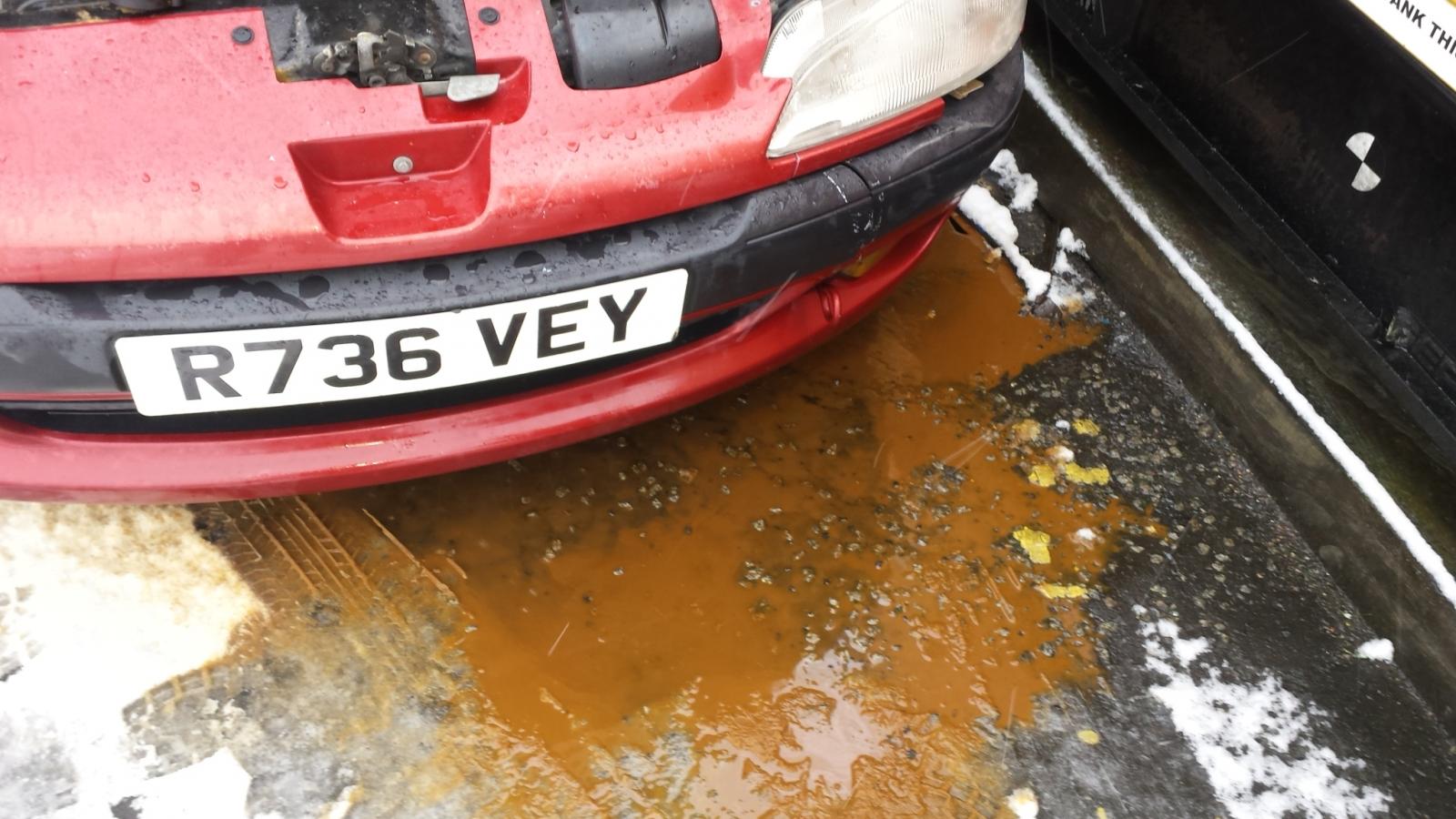

Back at base, it was time to strip it down and flush out:
I applied a hose strategically, and marvelled at the abundance of rusty water that flowed forth.
BE WARNED, these pictures are not suitable for viewers of a sensitive disposition!
**Viewer discretion advised**
Many, many minutes passed, and lo, it did run almost clear. But it was not a pretty sight
