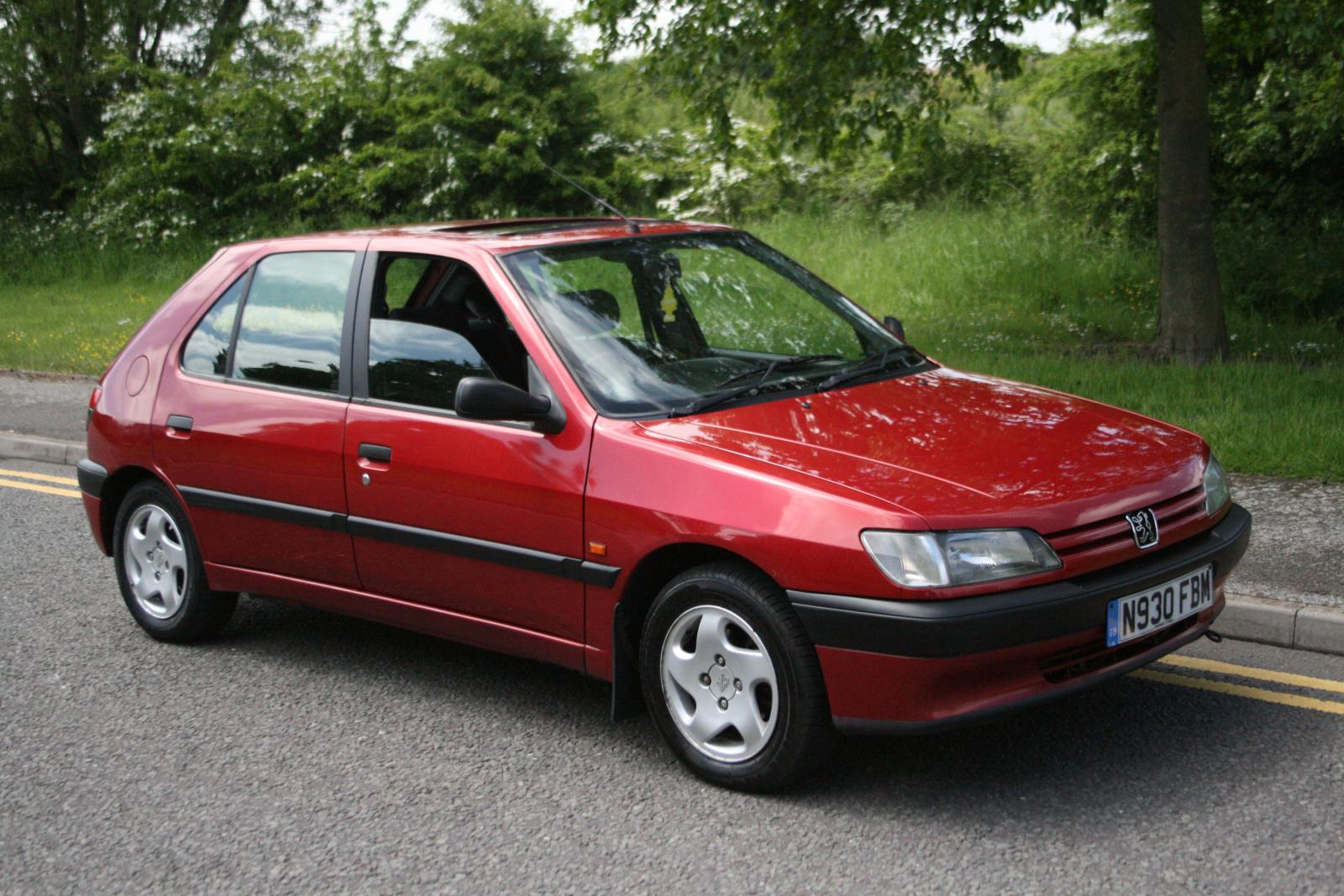

These are ace!!! I had the powerhouse n/a version. I frigging loved it, I spent a fortune on bits for it that it probably didn't need.
I did 15k in mine over a year would always do 45-50mpg all day long.
Would have another 132%
^^my paint is nowhere near as good as that:)

Seeing this pic reminds me how much Diablo red suits these 306s, especially when clean!  405s too.
We had a similar vintage 5dr DT in Diablo a few years back and it sorely tested my love of all things Peugeot.  Virtually everything which could have gone wrong did, think we had a rogue example.  When going OK displayed the usual Peugeot benefits of marvelous ride, handling and steering.  Agree with one poster about the narrow power band; the equivalent Citroen ZXs seemed to go a bit better than these, perhaps they were lighter.  Heavy clutch very common, often on its way out.  Think I've still got a wooden dash panel for one of these somewhere.
