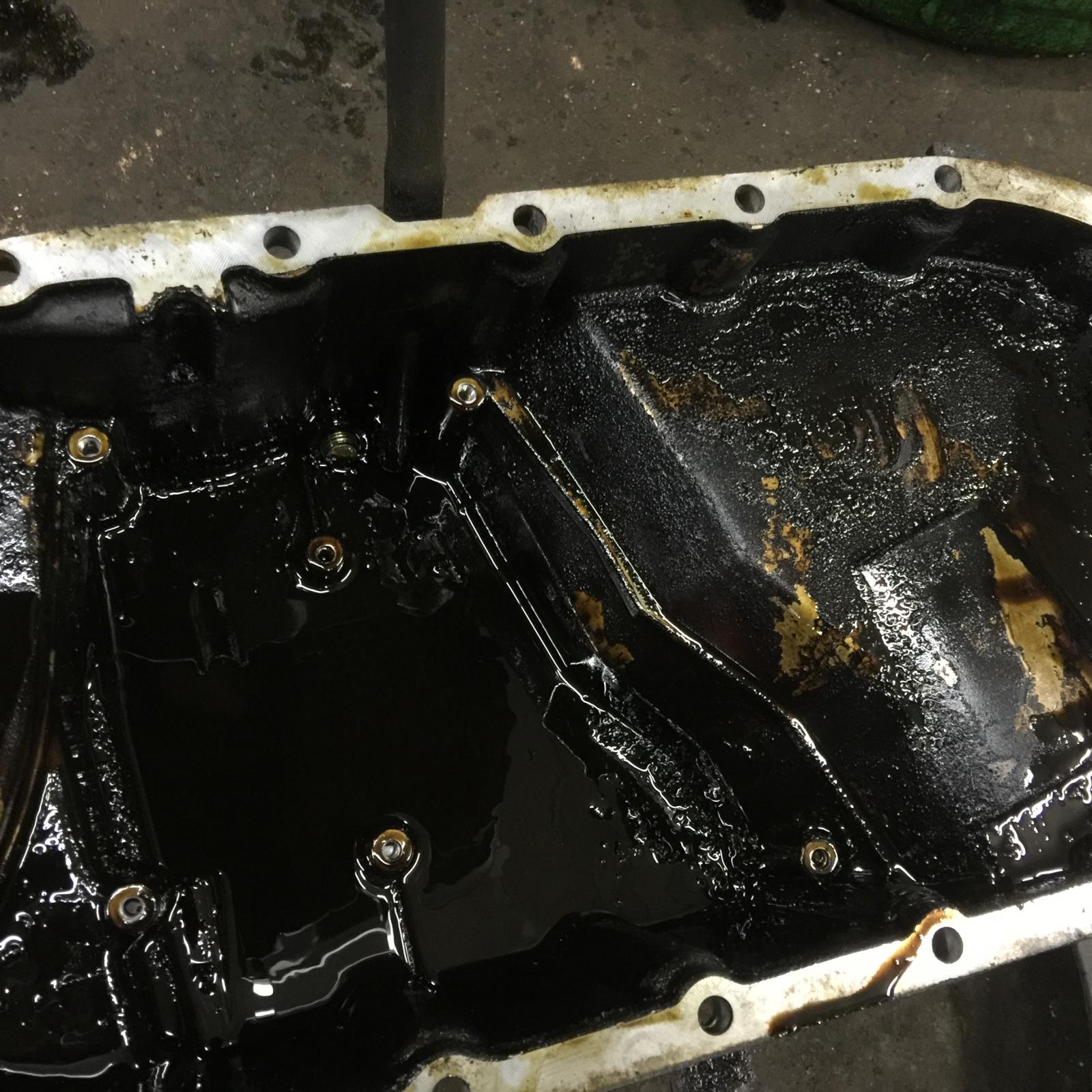

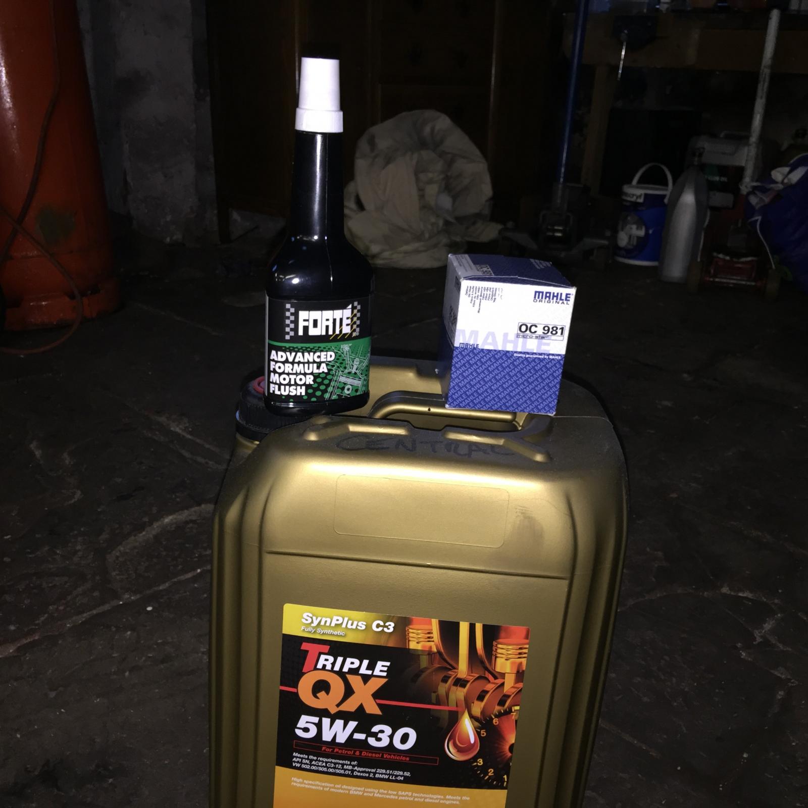

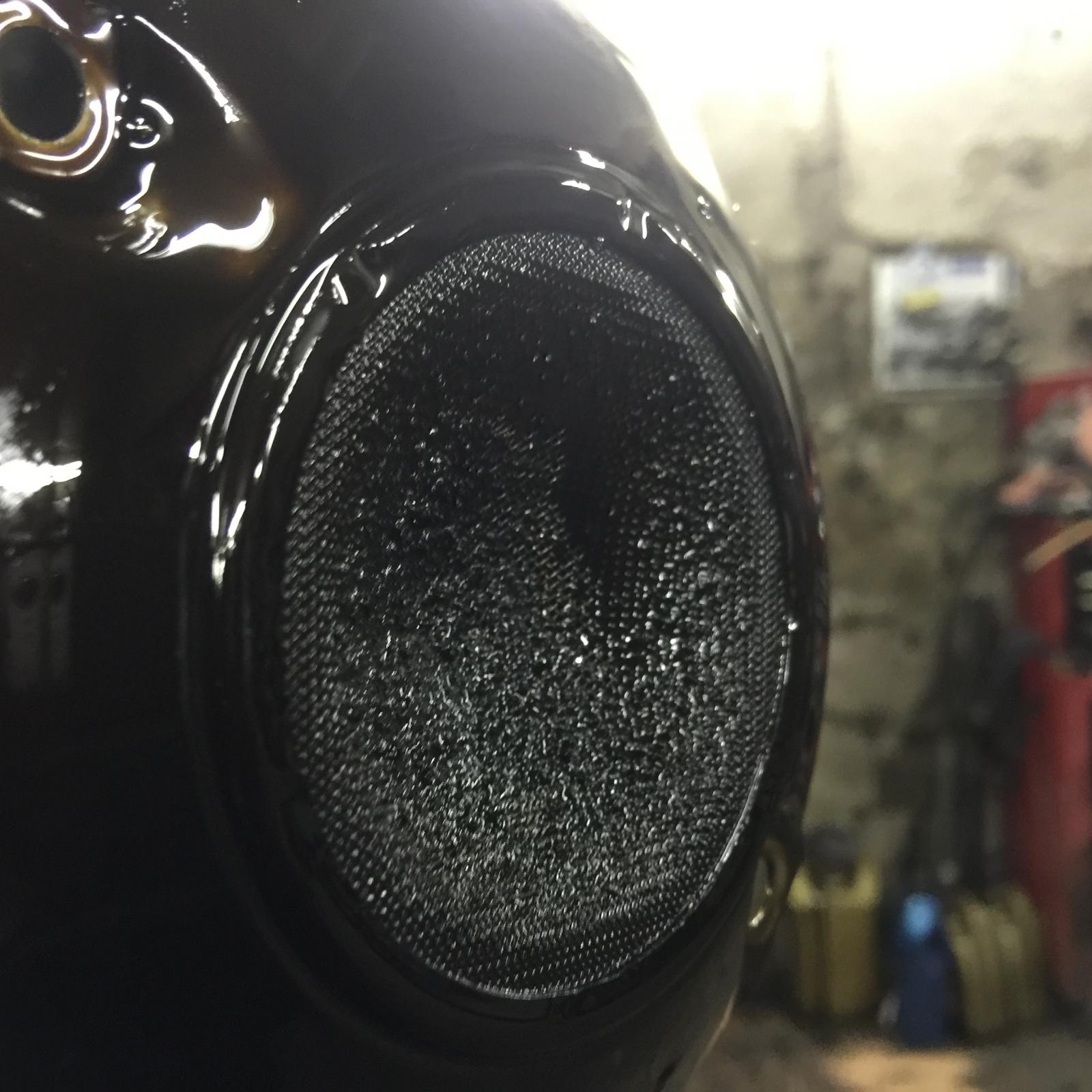

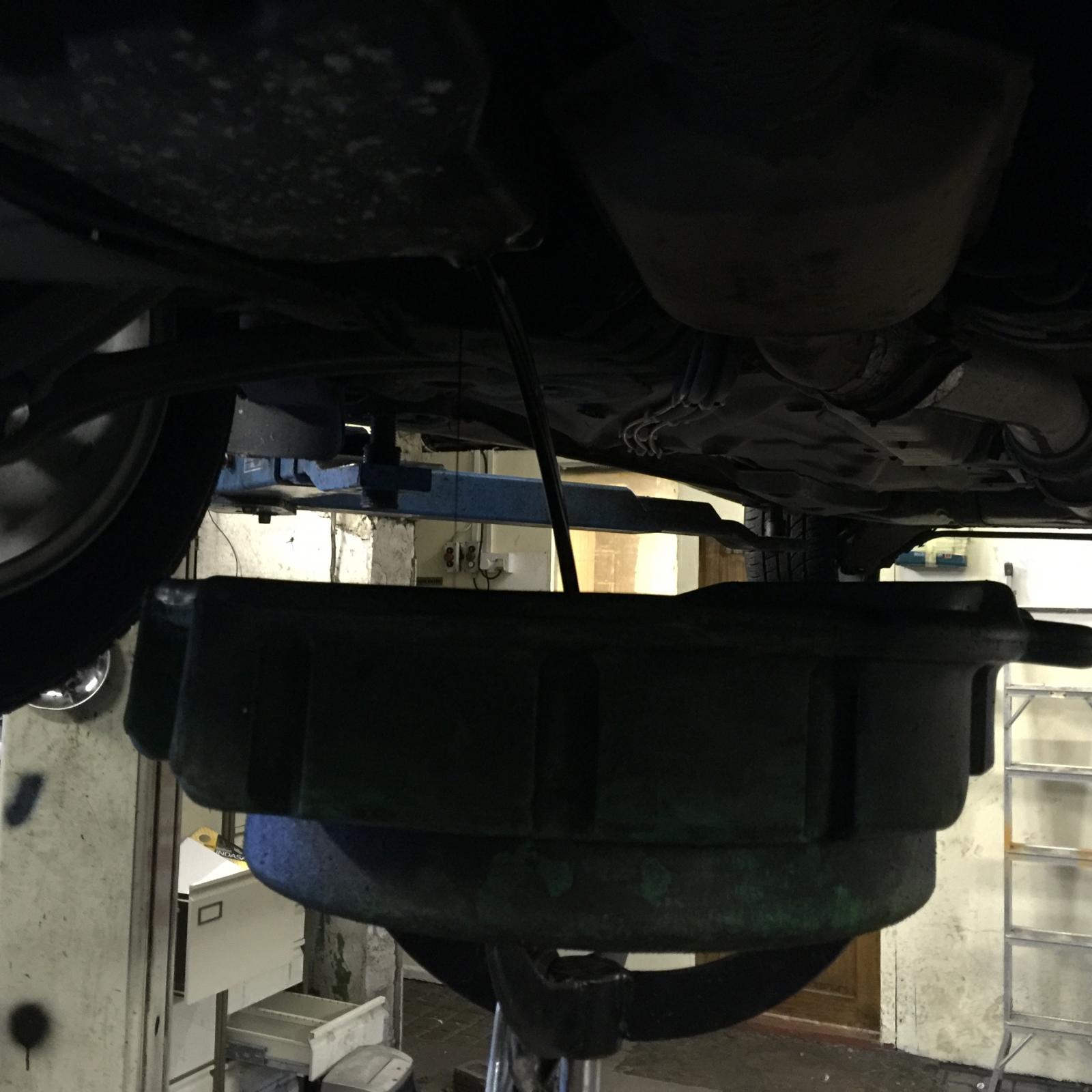

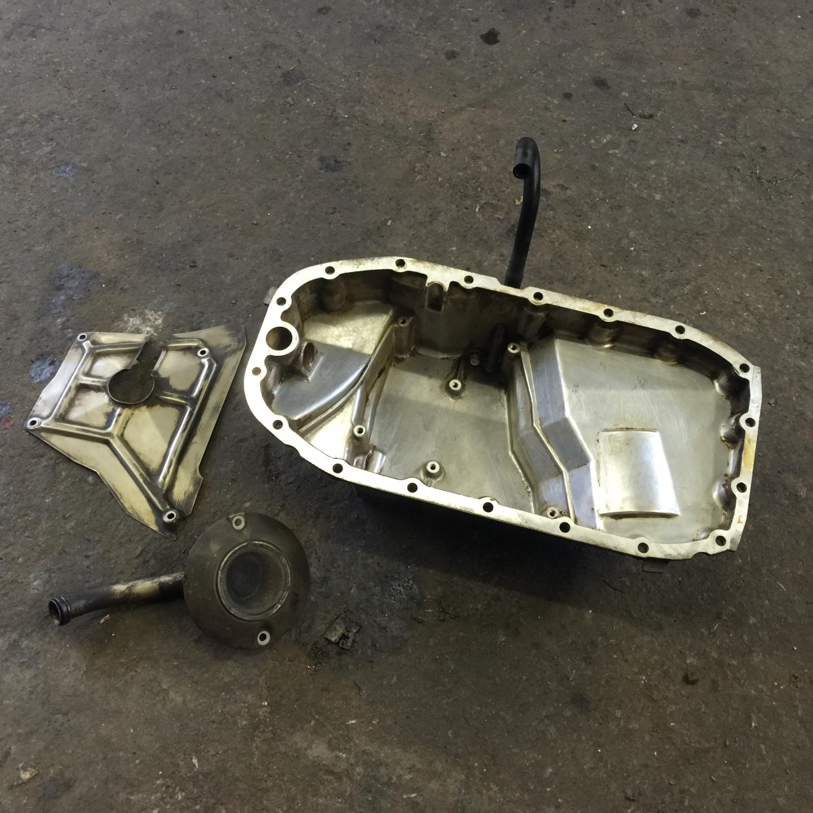

NorthernMonkey Posted January 5, 2016 Posted January 5, 2016 Got back late on Sunday after an uneventful trip back up north in the torrential rain and parked up in the workshop. Finally got around to giving it some attention this morning....first job was a oil change and sump clean. Not a moment too soon... The sump was thick with gritty sludge in the bottom and the pick up strainer was almost completely blocked!It's had plenty of servicing during its life so it goes to show how critical it is with these engines. Anyway, a good session with the marigolds and a drop of unleaded and we are looking a whole lot healthier in there... A new Mahle filter and some of ECPs finest fully synthetic later... It now sounds....exactly as it did before, quiet as a church mouse! At least it should last a bit longer. It's also going to need a couple of bits of welding for the next MOT...nothing too much but I'm going to crack on with it this week whilst it's in the workshop. No pics of that yet as I needed it off the ramp to put some paying jobs on but I'll take some this weekend when I tackle it. Other than that,it's absolutely brill! It pulls like a steam train, everything works as it should and mechanically, it seems spot on. I've ordered a steering rack brace to tighten things up a little and hopefully prevent any future damage to the bulkhead...it may also get some uprated springs and dampers at the front as the general consensus is it eliminates the bit of scuttle shake that is synonymous with these but all things considered, it's one hell of a lot of car for the money Fat_Pirate, Pillock, Jazoli and 2 others 5

twosmoke300 Posted January 6, 2016 Posted January 6, 2016 It's also the low friction piston design and a poor ( now updated) pcv system that causes sludge .
Fat_Pirate Posted January 6, 2016 Posted January 6, 2016 How difficult is it to remove the sump? I'm picking up a 2001 9-3 for Mrs Pirate on Saturday and this is the first job I want to do. I don't have a fancy ramp, only axle stands and excellent swearing skills. Do you need to partially lift the engine for access?

twosmoke300 Posted January 6, 2016 Posted January 6, 2016 You need to either drop the subframe a bit or raise the engine . It's a messy old job and important to order the correct anerobic sealer and a few o rings . Neo bros does a kit with all you need I think . A few aeros ( 9-5 I think ) require holes to be drilled in the sumo bracing to get to 2 bolts but these are rare . It's worth making sure it has the latest #6 pcv kit on it ( white markings on the hoses) Fat_Pirate 1
